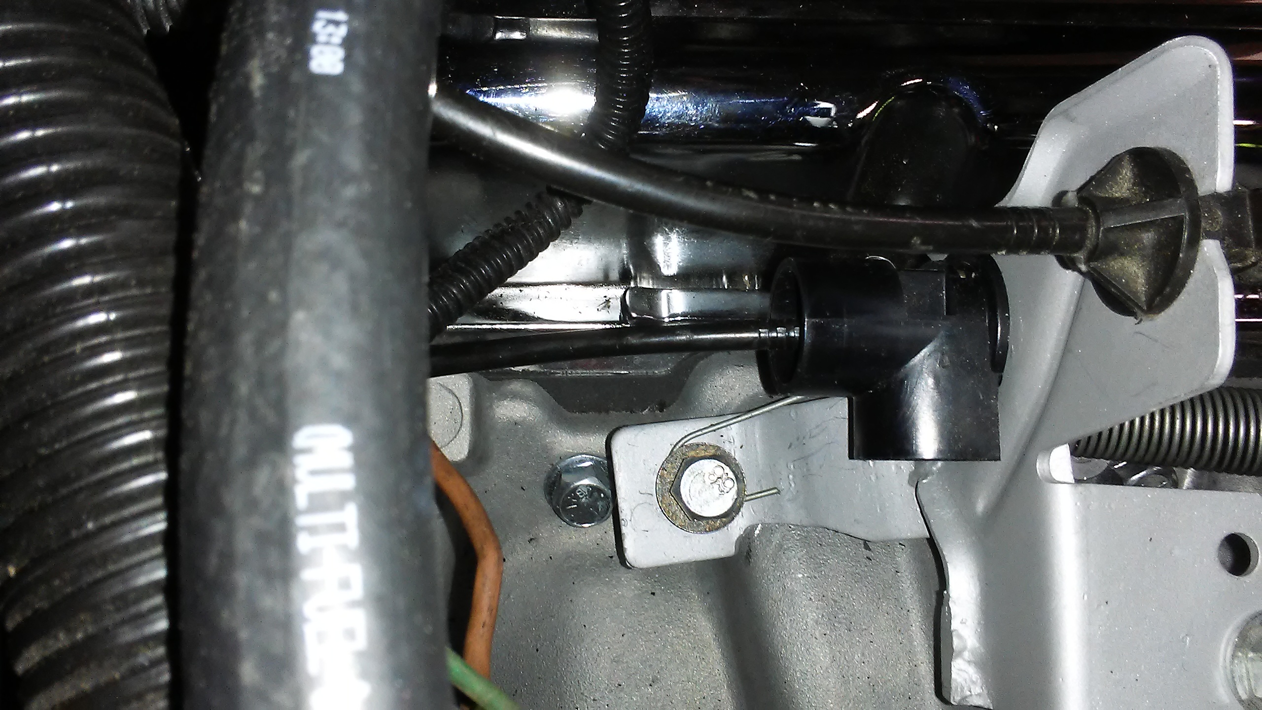

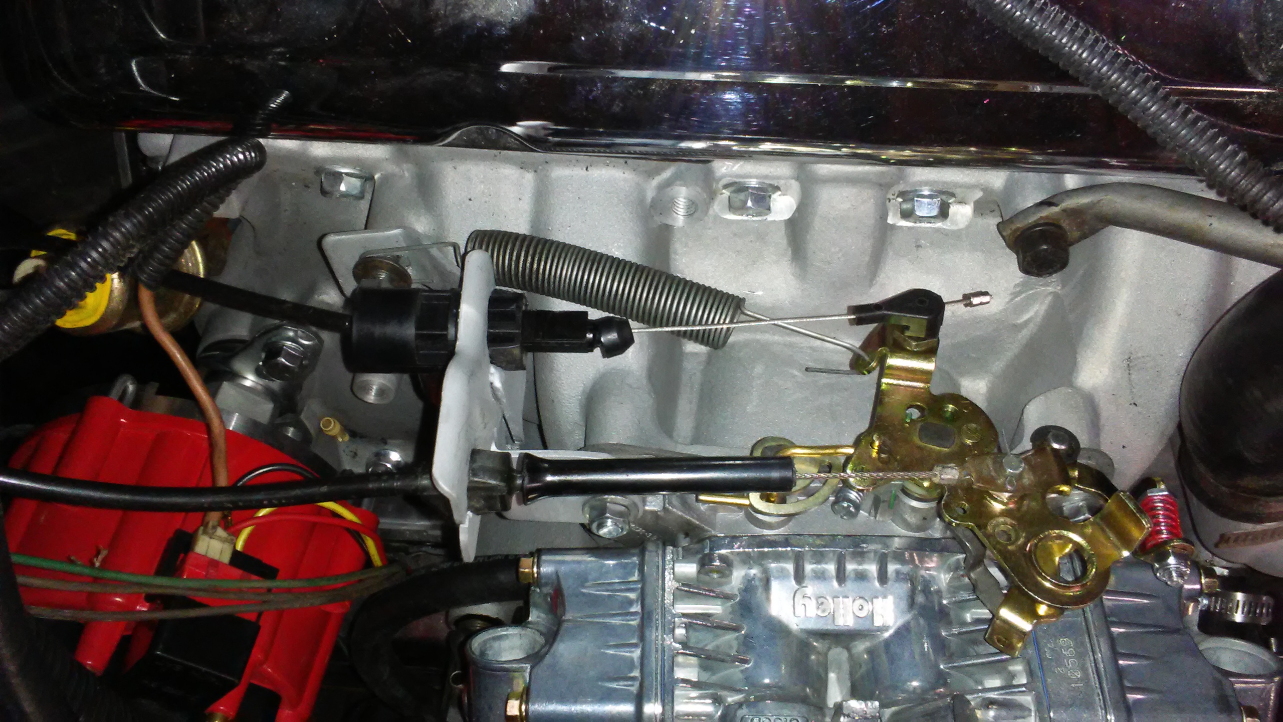

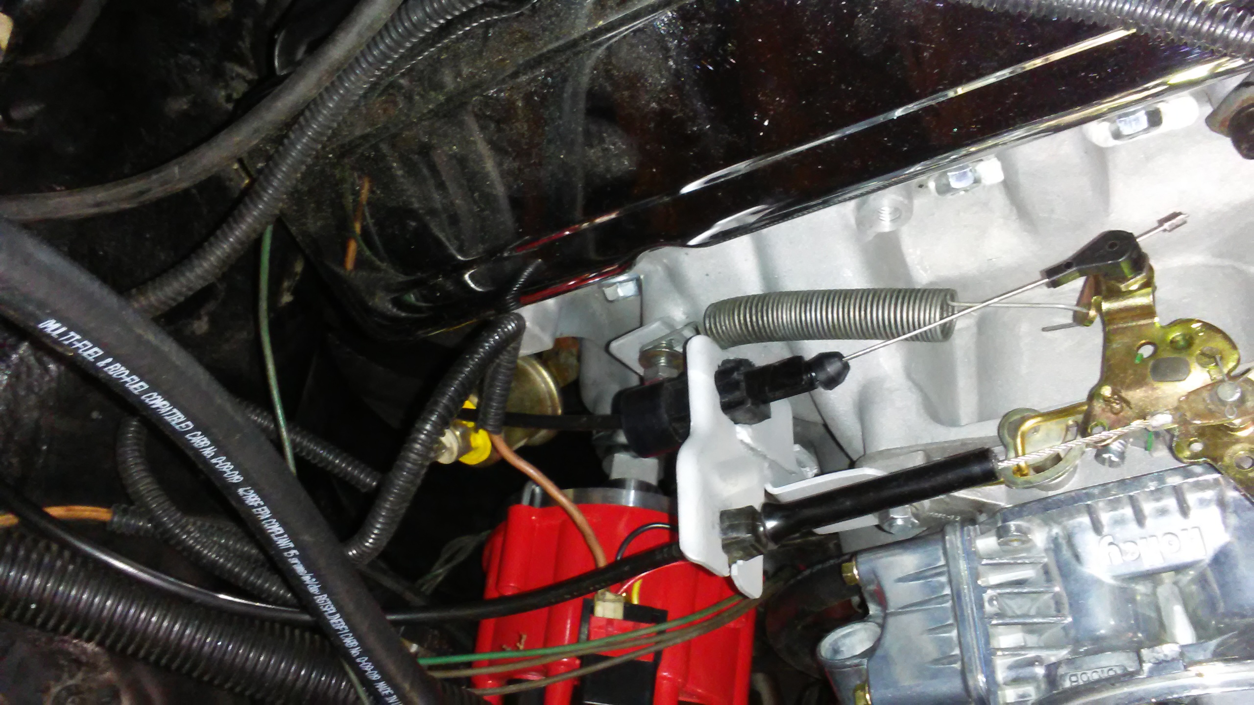

I've been really confused about the "TV cable" that came on the car.
Not only is that a TV cable but the bracket that came on the car looks like the aftermarket brackets for transmissions that use a TV cable.
Now, I know the transmission is a TH 350 by pan shape, bolt count, and the TH 350 replacement pan fit.
There are lots of posts online about adjusting the TV cable and other posts about adjusting the kickdown cable on a TH350. So what's the story?? Some TH 350s have kickdown and some have TV cable?? Don't think so. Think all TH350s use a kickdown cable and some of the posters are using the terms incorrectly. I believe I have a TV cable operating the kickdown.
Good news is that's one less job to do. I"m no longer planning to test transmission pressures to ensure the TV cable is adjusted correctly. Kickdown cable is set.

At first glance, it looks a lot like a TV cable, because of the way it is connected to the carb. But that's a TH350 *kickdown* cable. The visual difference is in the part on the rear of the bracket.
https://www.summitracing.com/parts/atp-y228 -- this is a TV cable. See the half-moon shaped adjustment button? That's the difference. Yours doesn't have that.
TH350's dont have a TV cable -- a TH350 will function fine without the cable hooked up (except, of course, for kicking down a gear when floored). I drove mine around for years without it hooked up. But a 200/700 will not upshift correctly without a properly adjusted TV cable. TV cable directly controls line pressure.

That's what caused most of my confusion. It does have that half-moon adjuster (which I love). It's on the back side of the cable in that picture so it doesn't show. Here's a shot that shows it (and, incidentally, the addition I made to the bracket to stabalize it since the Edelbrock intake only mounts it with one bolt).
The "Applications" of that Summit cable includes transmissions that use a kickdown cable and a TV cable. Guess it works as either. So much GM stuff to learn; so little time ...

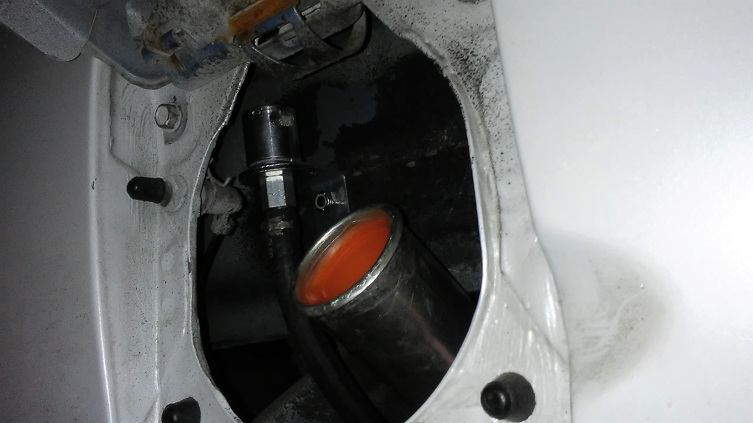

Got the new fuel tank in and hooked up. Fuel system is now new from sock to carb. Installed the Tanks, Inc vent with roll over protection behind the fuel door.

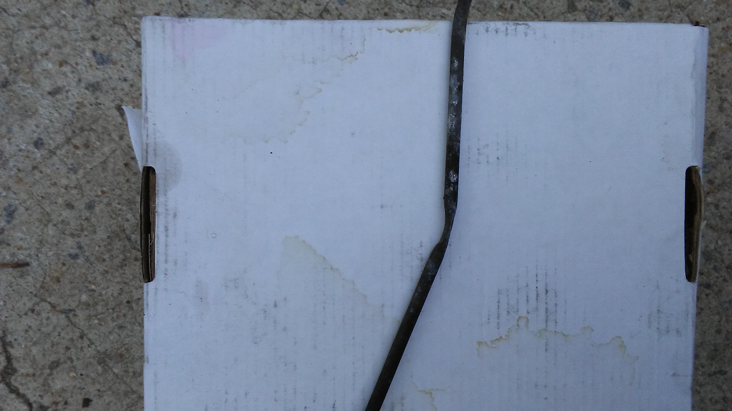

Replaced the crushed left rear brake line.
I don't know if the crush was deliberate or unintentional.
It looks like that 3/16" line is completely pinched off but I can blow a little air thru it. I suppose that brake was working if the pedal was held down long enough.
