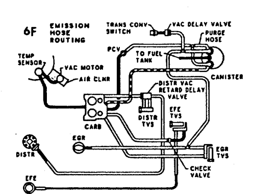

Now have the new fuel tank, sender/pickup, and straps. Time to figure out tank venting. I'm considering two options: plug the tank vent line nipple and drill a vent hole in the cap or figure out how to use the carbon canister. I've been reading how others have handled the issue. There is a LOT of confused ideas out there. One post included a link to vacuum diagrams on autozone.com repair manuals. This one is for an '81 EC with 305 automatic. It lets me know what all the nipples on the canister are for.
Originally, the canister purge line gets restricted vacuum from the PCV line. An alternative someone used is to run the purge line to the air cleaner to get a gentle vacuum for purge. Like that idea but I haven't settled on an answer yet.
The Lincoln tank is not vented and the gas cap got a small vent hole. There is some minor gas smell but nothing too bad.

Save yourself all the aggravation, get a vented cap and call it a day. Getting rid of that emissions nonsense will simplify the whole thing IMO. The best part of having the older car is not having to worry about that stuff anymore.

For my Trans Am I put an old school inline fuel filter on the vent hose. The paper filter would allow air in or out as needed but slow down the gas vapors. Probably not emissions legal but it worked and I never smelled gas.

I like Andy's fuel-filter solution. I also favor getting rid of the charcoal can stuff.

I'll mount this http://www.tanksinc.com/index.cfm/page/ ... /prd98.htm near the top of the filler tube. That should be easy, cheap, get rid of the canister, avoid dips in the vent line, and provide roll over protection.
