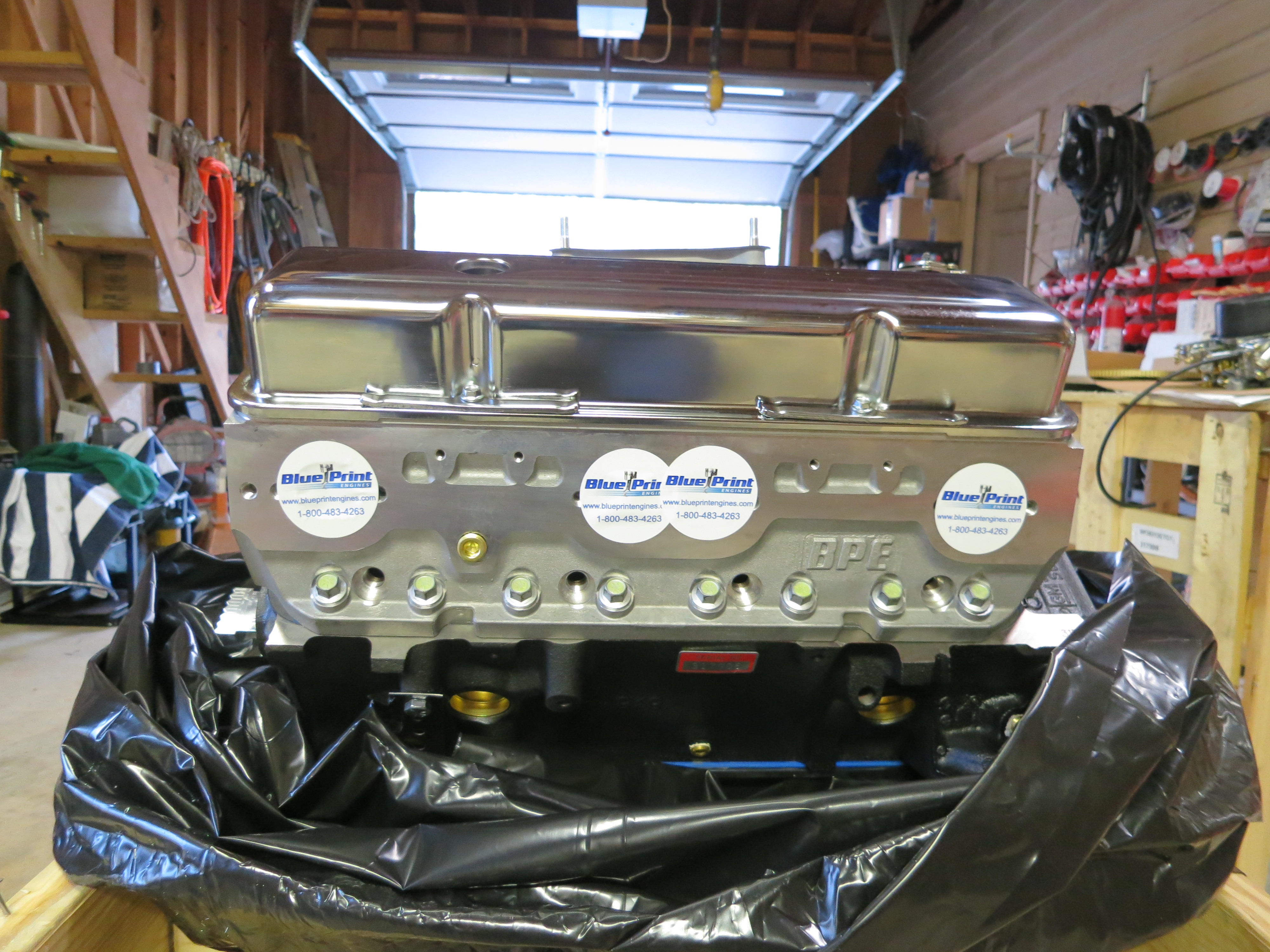

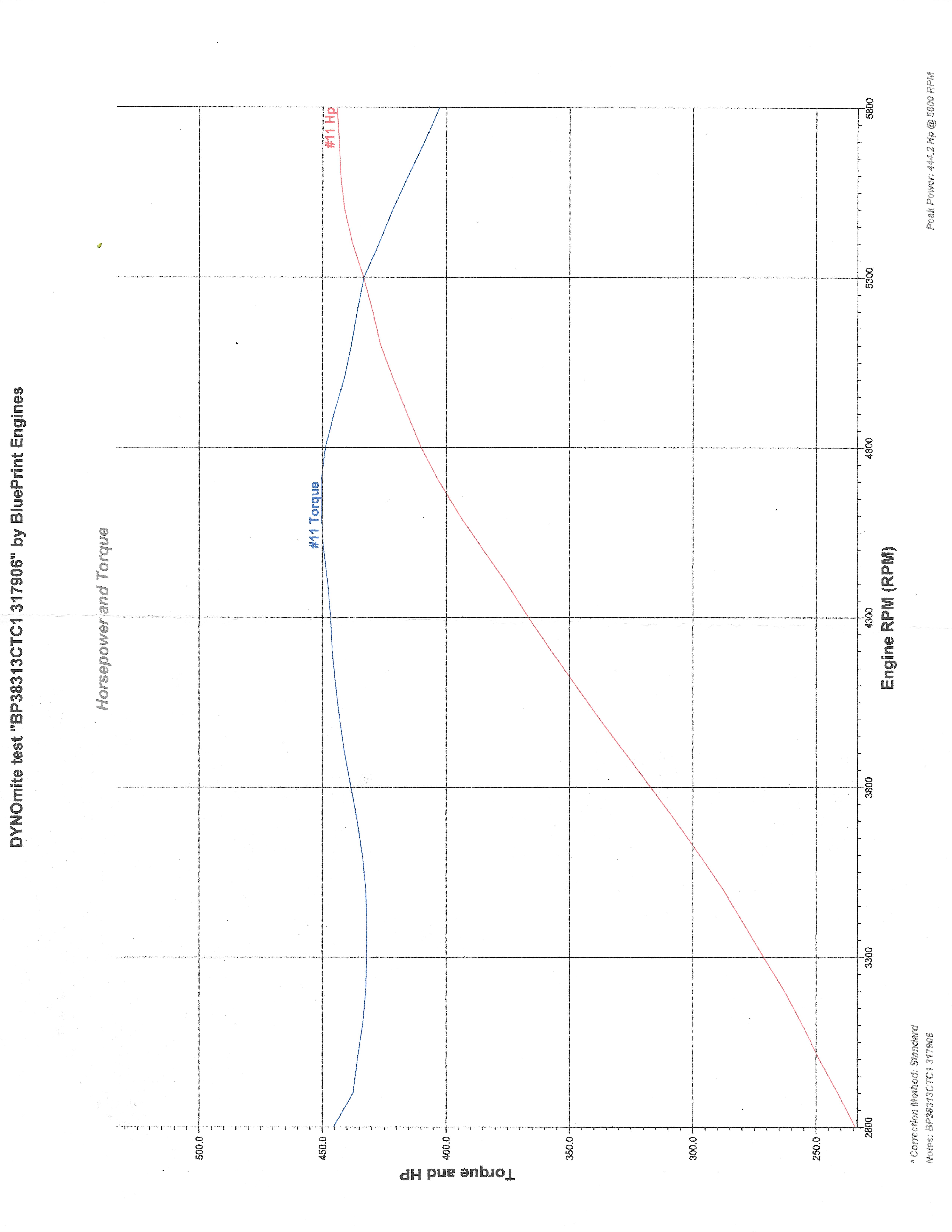

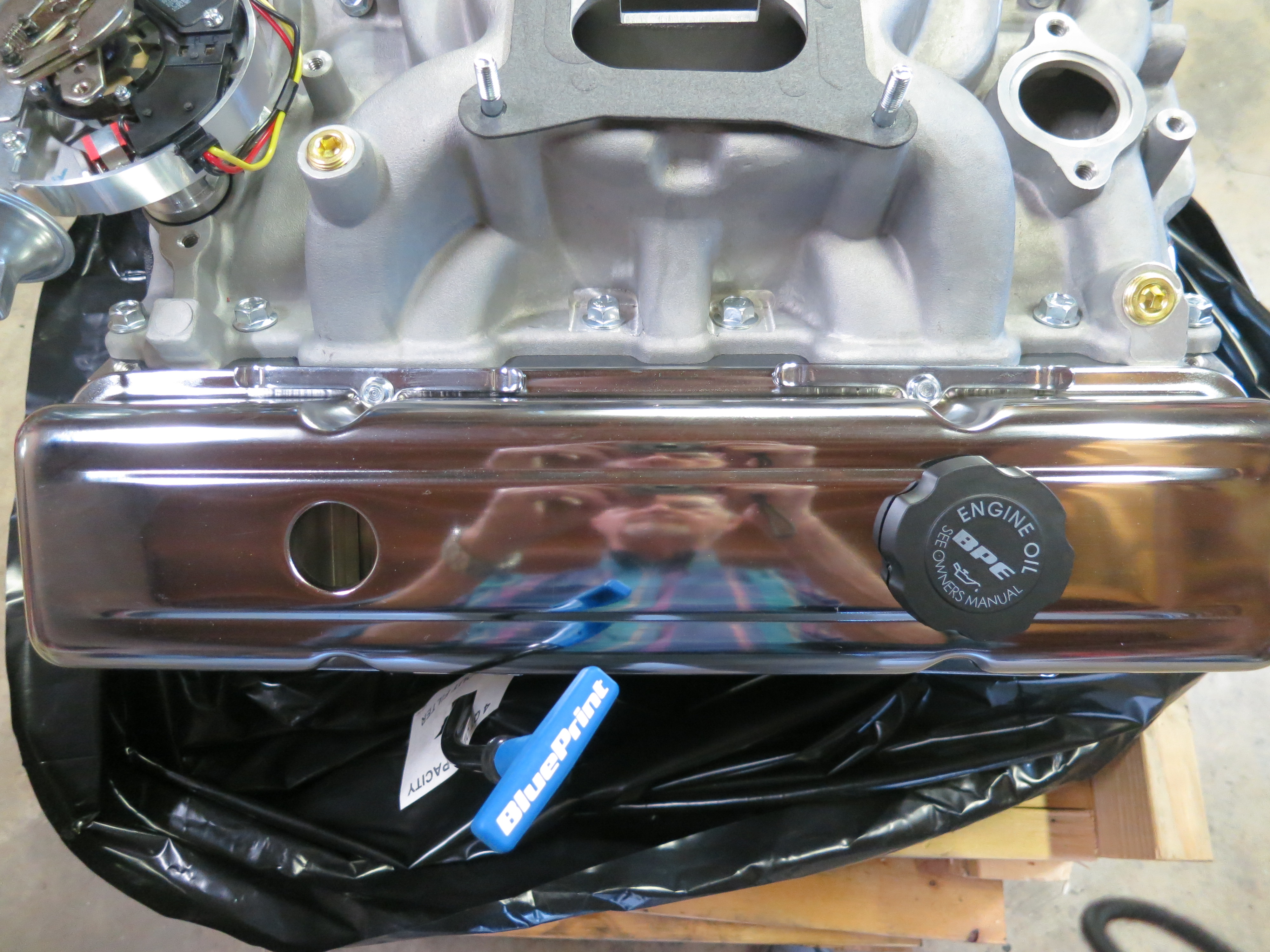

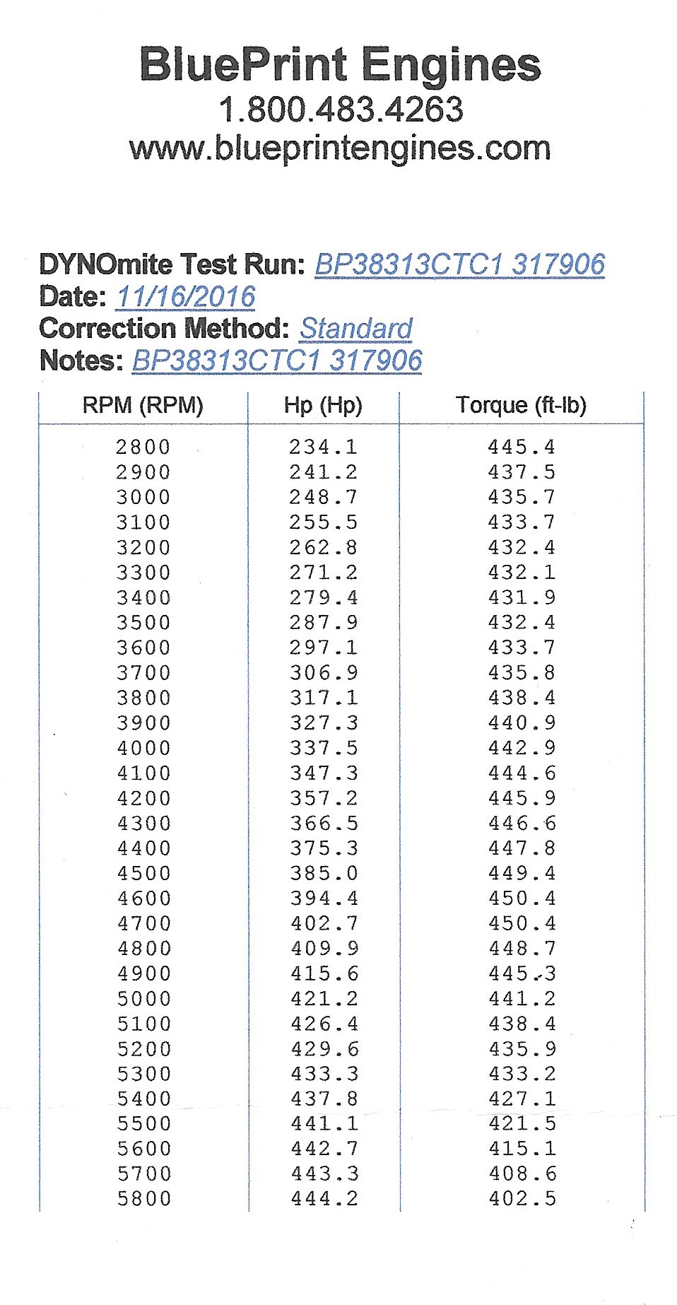

The Blueprint 383 arrived early this afternoon.
Ordered it Mon night; arrived Friday at 1 PM. Pretty amazing. NICE NUMBERS!!
NO debate about shift points -- HP is still climbing at 5800. FLAT torque curve.
WXO came over and we uncrated it and put it on my big dolly. Checked out a couple of things. Starter mounting bolts are SAE. I've read that some are larger metric and if a starter is used with mounting holes for the metric bolts, special bolts with metric shanks and SAE threats must be used to keep the starter in alignment. I'll order a mini starter to get some clearance from the headers. Looking at this one. https://www.summitracing.com/parts/pwm- ... onte-carlo I like that it comes with bolts. If it has the larger, metric bores for the mounting bolts, the bolt shank diameter should be correct. Rated for 14:1 CR so it should be plenty strong.

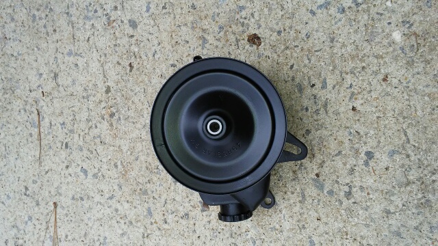

Cleaned up and painted the PS bracket and pulley and got them mounted on the rebuilt pump. No biggie but its fun to take a nasty part and make it look good.
