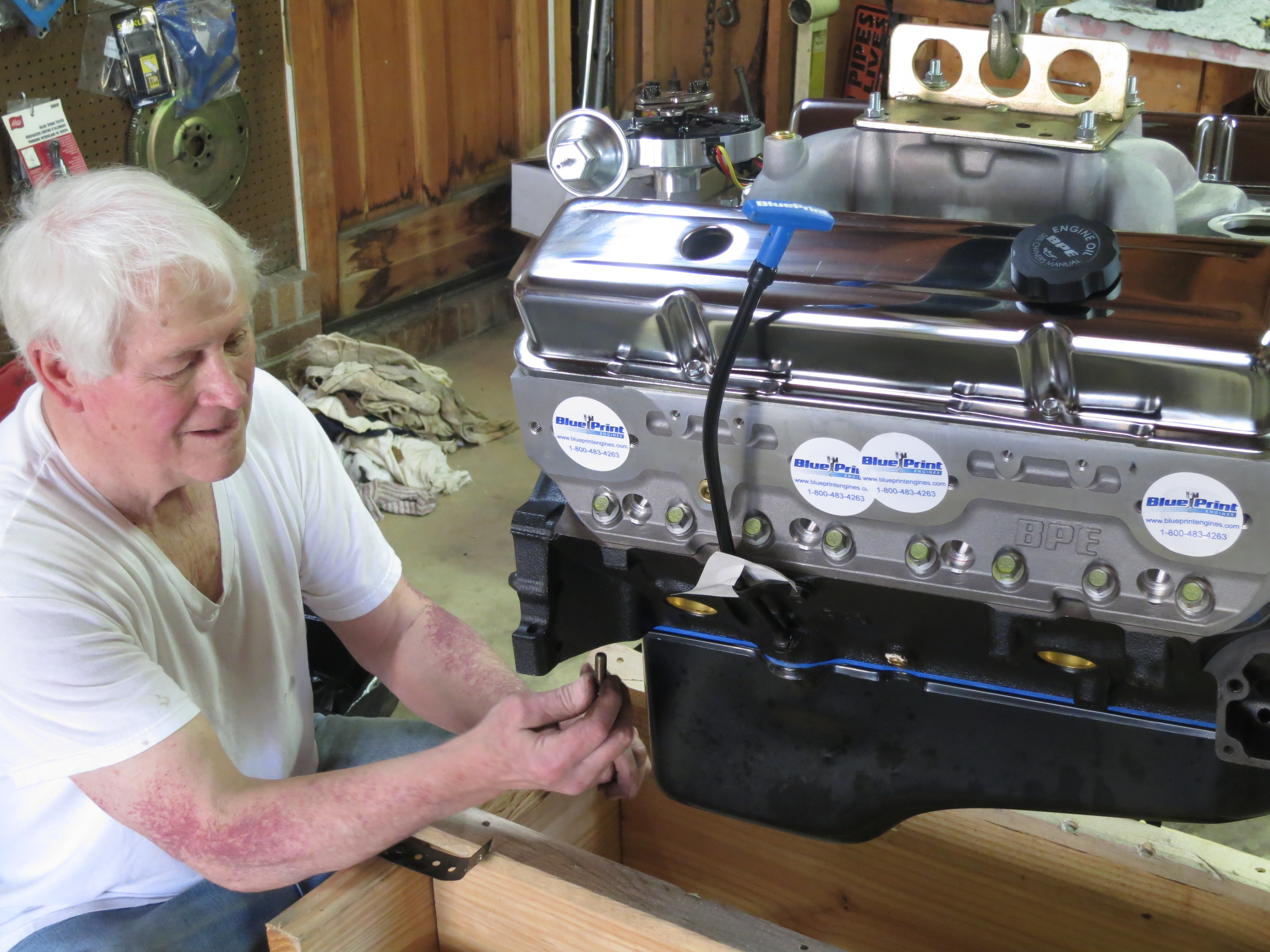

The Blueprint 383 arrived early this afternoon. :D Ordered it Mon night; arrived Friday at 1 PM. Pretty amazing. NICE NUMBERS!!
NO debate about shift points -- HP is still climbing at 5800. FLAT torque curve.

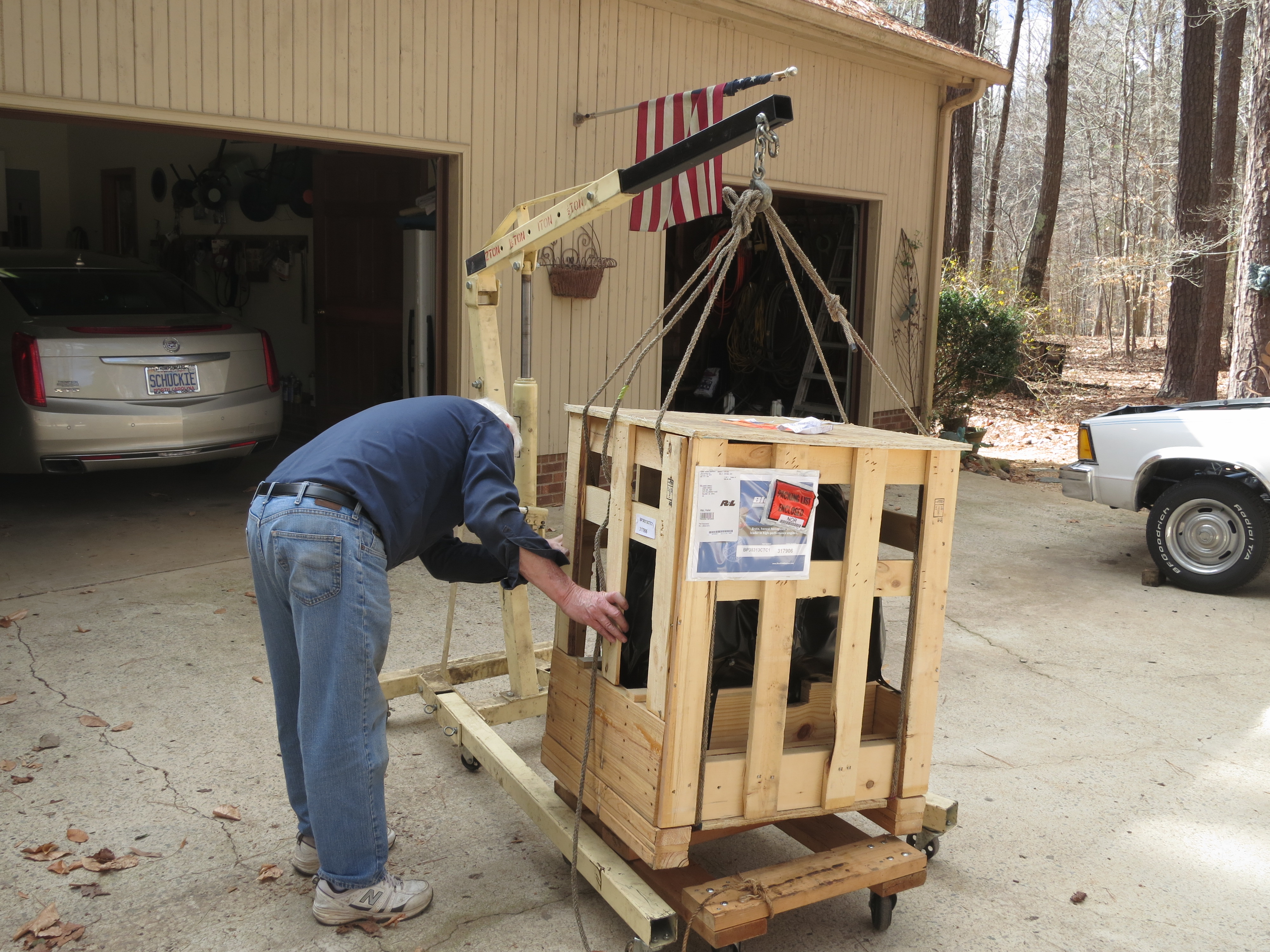

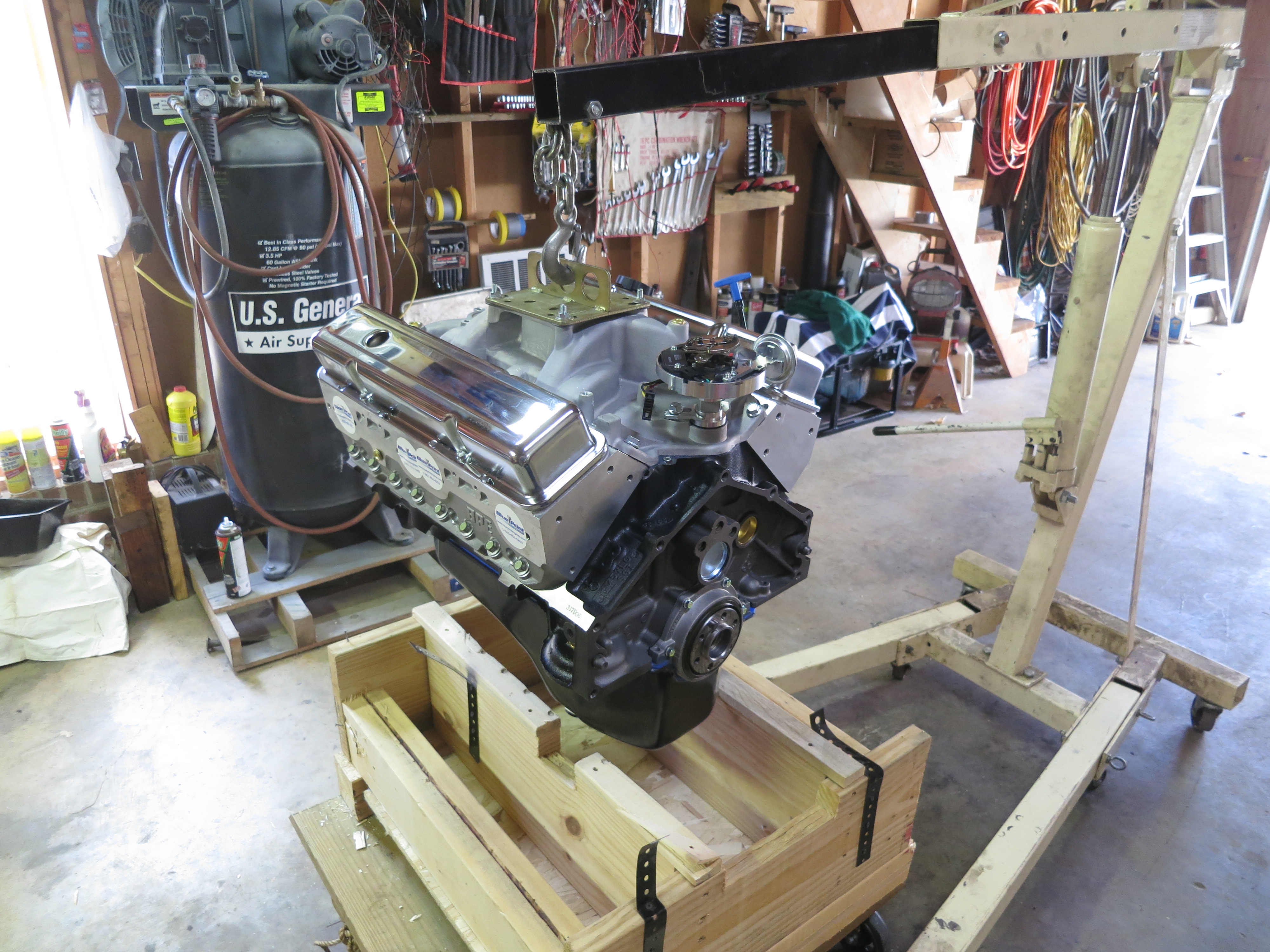

WXO came over and we uncrated it and put it on my big dolly. Checked out a couple of things.
Starter mounting bolts are SAE. I've read that some are larger metric and if a starter is used with mounting holes for the metric bolts, special bolts with metric shanks and SAE threats must be used to keep the starter in alignment. I'll order a mini starter to get some clearance from the headers. Looking at this one. https://www.summitracing.com/parts/pwm- ... onte-carlo I like that it comes with bolts. If it has the larger, metric bores for the mounting bolts, the bolt shank diameter should be correct. Rated for 14:1 CR so it should be plenty strong.
Need a 2000 stall TC. Looking at this one https://www.summitracing.com/parts/hup-gm20 I've read good things about the Hughes converters and it has great reviews. I'll have to think about a trans cooler to go with the stall converter.
Ordered and have a Summit flexplate https://www.summitracing.com/parts/sum-g104sfi Flexplate has 6 mounting holes for the TC while both the old TC and the Hughes TC only use 3. Guess that's OK.
