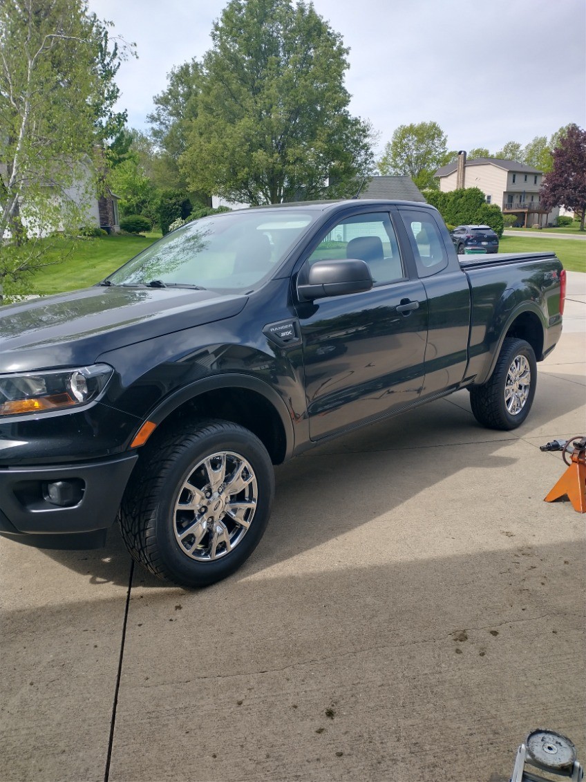

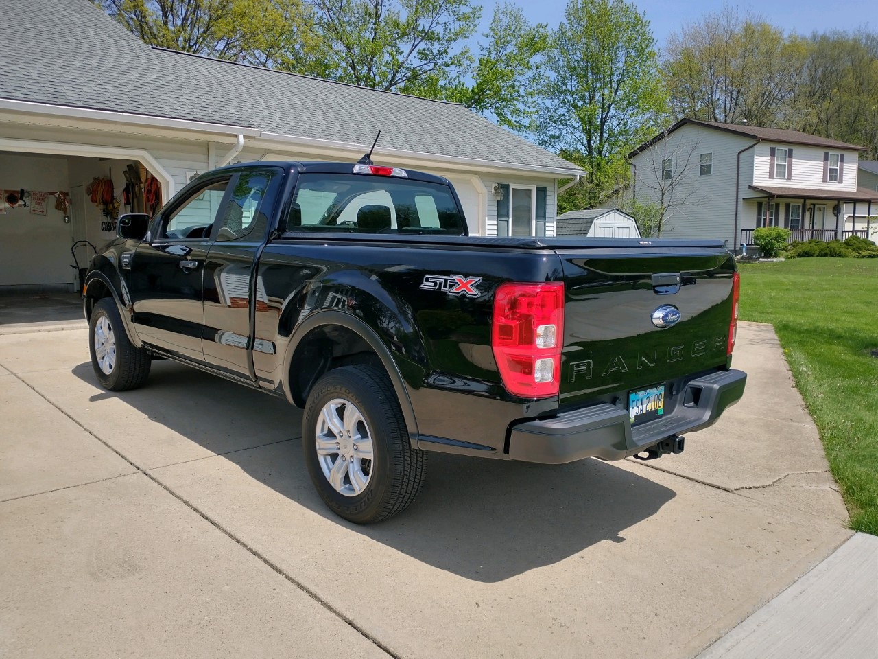

No doubt about it, when it's clean Black is the most awesome color!
The Ranger looked ok before it was washed, but now it's one sweet lookin' ride!

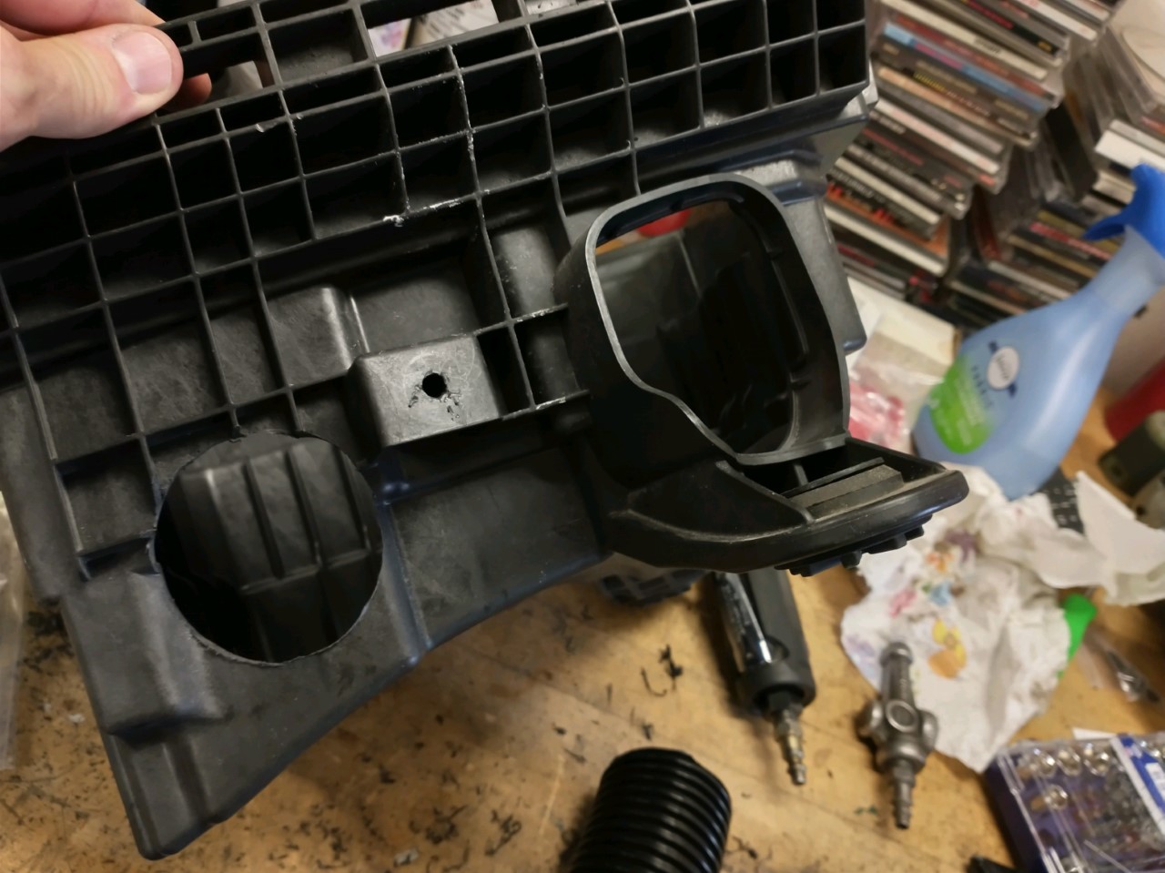

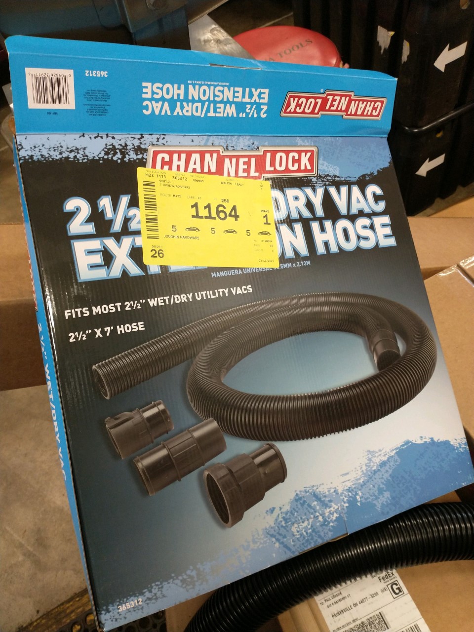

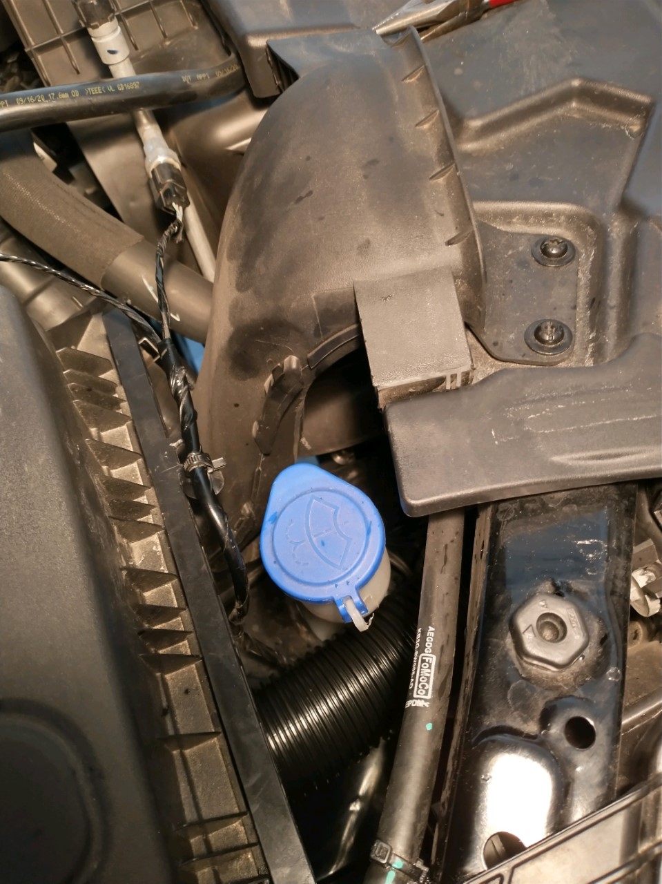

Then today I went and bought a performance air intake kit from the hardware store, in the form of 2.5" shop vac hose. The stock factory air inlet at the airbox brings in fresh air, but is about half the size of the hose that takes the filtered air into the turbo system. So I figured if I just increase the amount of air going in, things would get better, and I was right. The truck feels WAY better now. So between the intake and exhaust, it's much happier IMO. We'll see what the tale of the timeslip says, but I'm expecting to be in the 14.1x's somewhere if I can still get it to hook up. Best so far was 14.44.
To make my little creation, all I did was poke a 1-7/8" hole in the box, then open it up slightly more with the die grinder, just enough for the flexible hose to go in. Then I cut about a 15" piece of hose and ran it to a place behind the headlight away from heat where it's getting basically fresh air, and put it all back together. Doesn't make any more intake noise, but I heard my turbo working under load for the first time, so I'm guessing it likes it. I wish it wasn't wet out today, cuz I couldn't keep traction anywhere in 2nd gear, and that's never been a problem before, even in the wet.
This should keep that pesky GMC Terrain off my back for awhile...

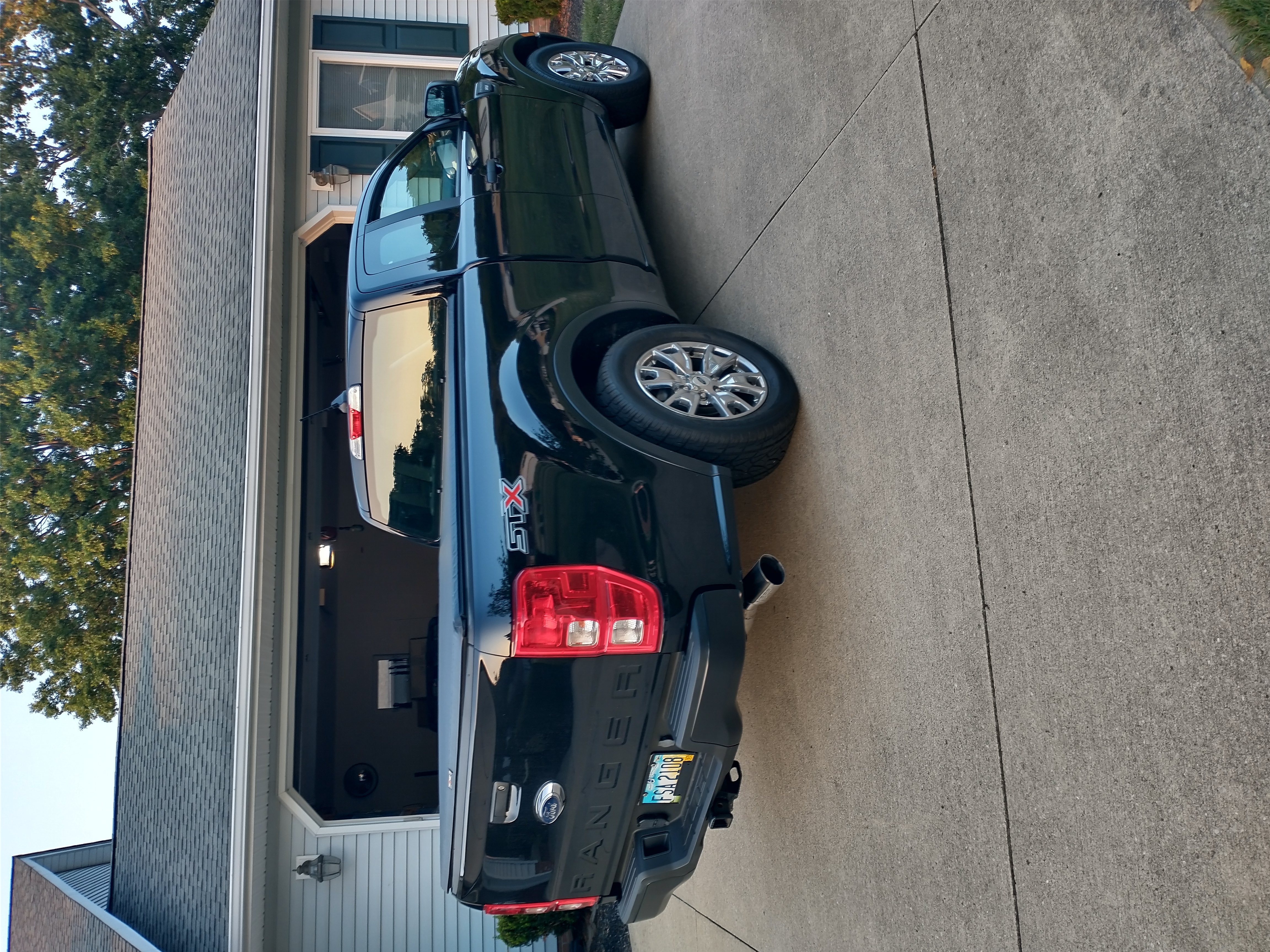

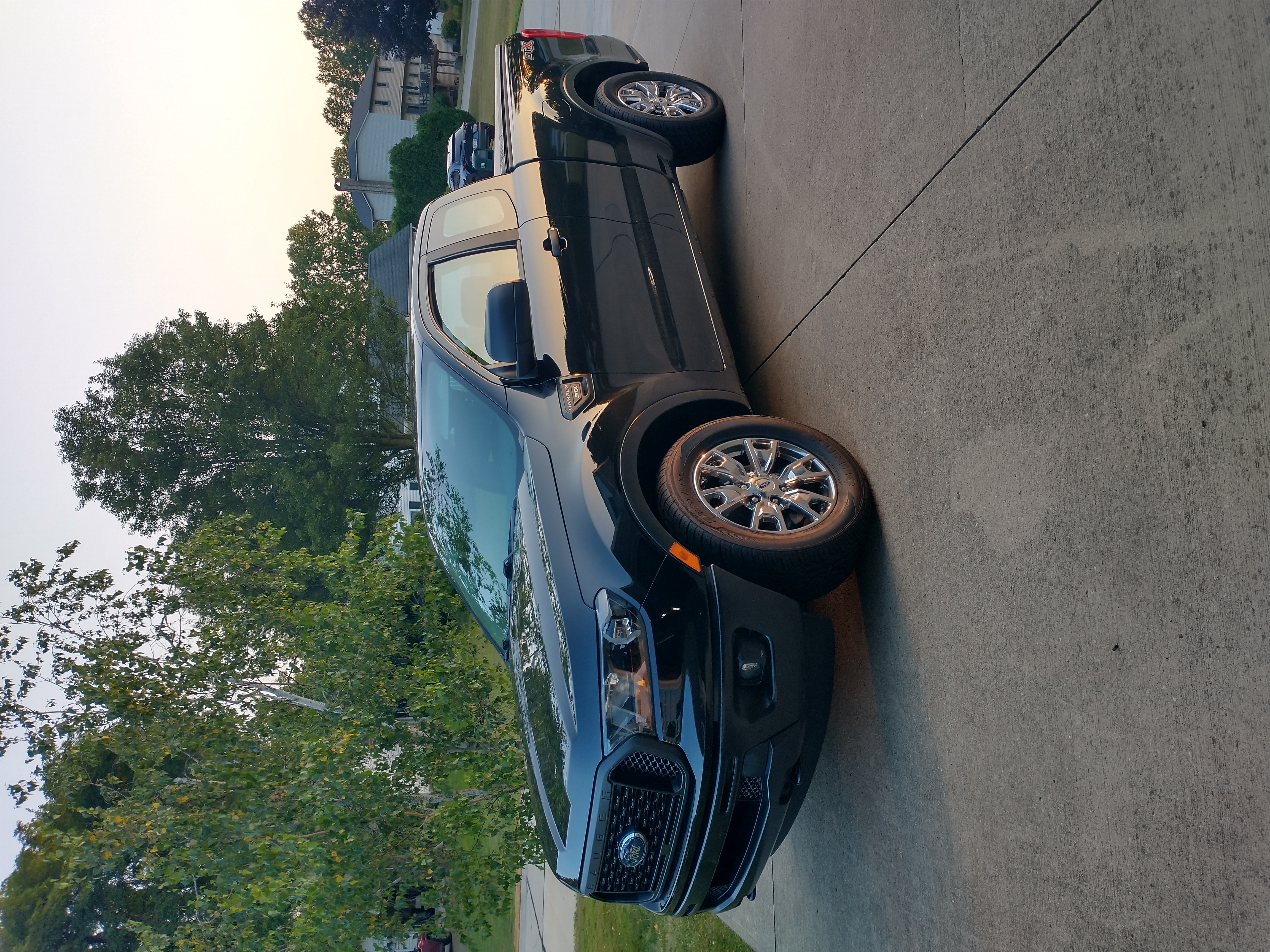

Well, we were finally able to get the lowering kit installed on the Ranger. I think it looks so much better. Having everything lower makes this truck so much more operator friendly too. Easy to get in and out of, loading in the back is almost as low as my S10, and I don't think I'll need a ladder to wash the roof. It rides a little more firmly, which is to be expected, but there's no ridiculous head toss anymore and it handles way better.
The factory rear shocks were already leaking, and although the front were holding their fluid, they were cooked too. I need to set up an alignment for my next step as the camber is a little out of whack. Otherwise it drives straight and true. Bob was real good about putting it back as close to spec as he could. He had to modify the tailpipe exit too, but did a nice job there too.
So far, pretty satisfied with the product.
