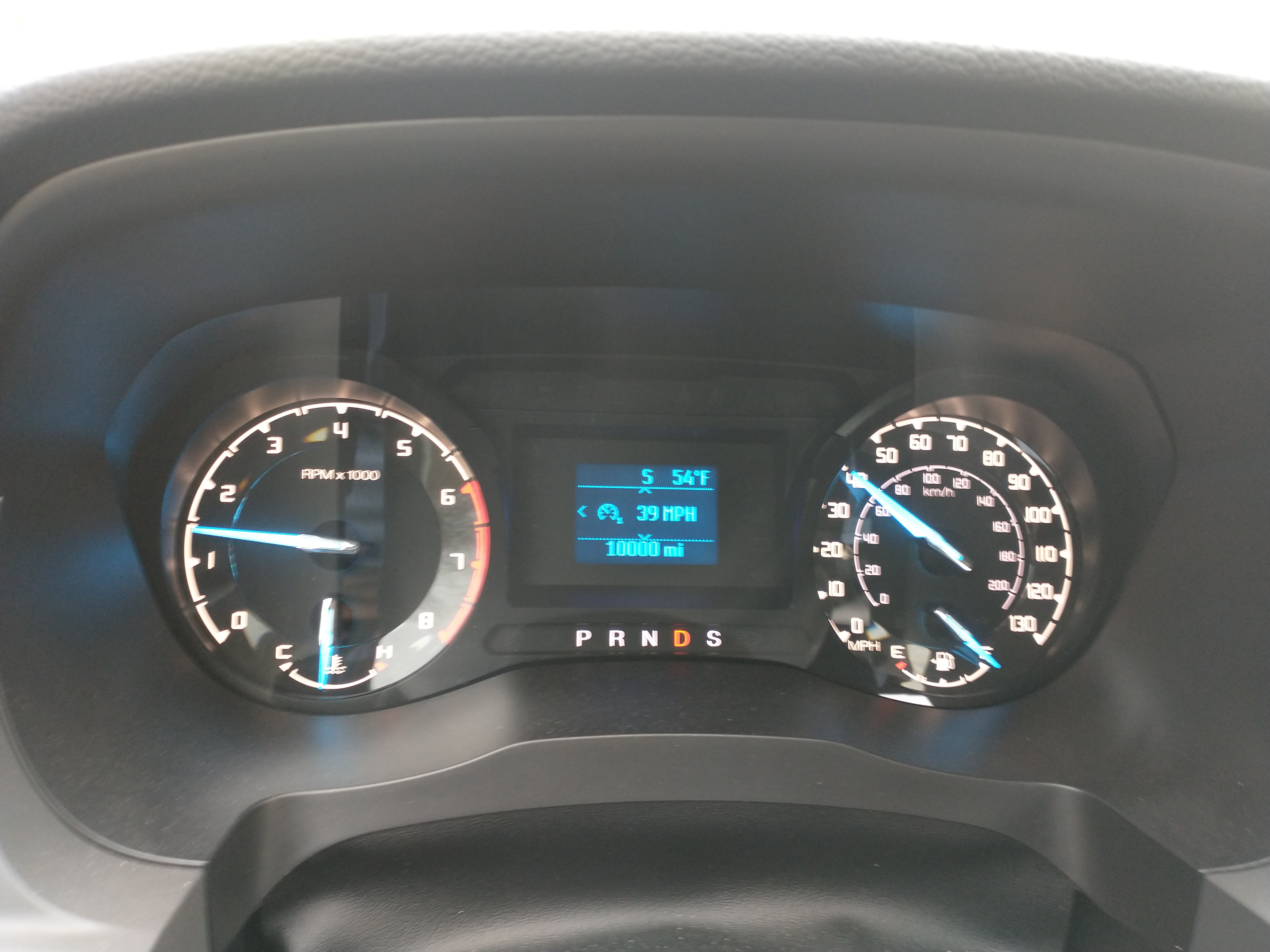

The Ranger turned 10,000 miles yesterday. So far it has been basically trouble free and has done a great job being a real truck. I regularly carry 1200-1500 lbs in the bed and it does an amazing job towing also. I've only had one tank under 20mpg and that was towing the Firebird to Mid-Ohio and back (19.9mpg).
I am contemplating getting the factory performance upgrade once I'm done with the storage bays. I've also considered buying a new Maverick too, but at their best will only tow 4000 lbs which won't pull a car. I like the slightly smaller size though. I'll probably just keep it as it really seems super capable for it's size, and with the tune should be in the 13s which is super strong.

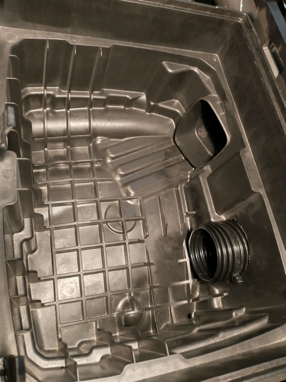

So on Sunday morning I went to Kevin's to install the new MBRP exhaust. It went on as designed in a little more than an hour. The only issues with the install were that the band clamps were bent weird at the ends and I had to really crank down on them to be able to get them tight around the pipe. Then after I drove it a couple times I had to tighten them down again with a warclub to get them to finally be tight. I also had to trim a piece of steel off one of the side hangers that was hitting the frame. It sounds as expected with a little extra noise at idle and at WOT, but under normal cruising you hardly even notice, which is perfect. All by itself though, I didn't really feel much of a difference performance wise, but the mileage on the truck has already begin to get better, which I read would happen based on some owner's reviews.
Then today I went and bought a performance air intake kit from the hardware store, in the form of 2.5" shop vac hose. The stock factory air inlet at the airbox brings in fresh air, but is about half the size of the hose that takes the filtered air into the turbo system. So I figured if I just increase the amount of air going in, things would get better, and I was right. The truck feels WAY better now. So between the intake and exhaust, it's much happier IMO. We'll see what the tale of the timeslip says, but I'm expecting to be in the 14.1x's somewhere if I can still get it to hook up. Best so far was 14.44.
To make my little creation, all I did was poke a 1-7/8" hole in the box, then open it up slightly more with the die grinder, just enough for the flexible hose to go in. Then I cut about a 15" piece of hose and ran it to a place behind the headlight away from heat where it's getting basically fresh air, and put it all back together. Doesn't make any more intake noise, but I heard my turbo working under load for the first time, so I'm guessing it likes it. I wish it wasn't wet out today, cuz I couldn't keep traction anywhere in 2nd gear, and that's never been a problem before, even in the wet.
This should keep that pesky GMC Terrain off my back for awhile... :mrgreen:

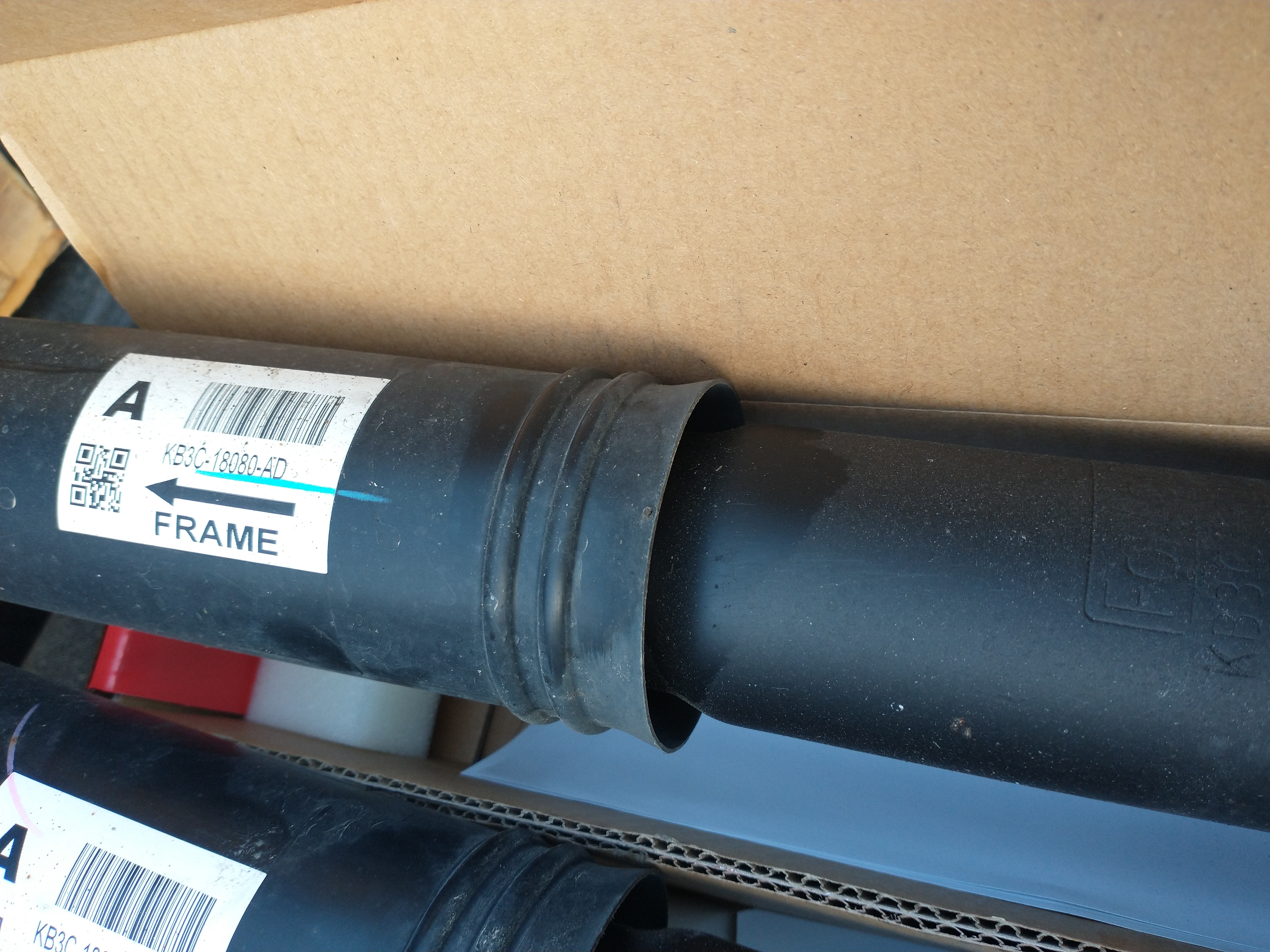

The Ranger is around 30500 miles right now and is about six months out of bumper to bumper warranty. Drivetrain goes to 60k I think. I tend to get antsy after this period for a new ride and came close to buying a 2024 Durango RT. I just couldn't swallow the $33k difference in cost between the two vehicles. Not yet at least, so I decided to keep the Ranger and do a couple upgrades. Last night I ordered this for it:
https://www.summitracing.com/parts/BEL-1044SP
Lately the truck has been SOOOO wallowy driving around so I was going to do new shocks and struts as I'm sure the factory ones are garbage at this point. Then it hit me that they might finally have a lowering kit available (which they didn't for these trucks when I bought it) and they do. This should definitely stiffen up the old Buick ride and make it look like it's not driving downhill everywhere I go. The added bonus will be for loading and unloading as my tailgate right now is basically at 3/4 ton height, which is annoying.
