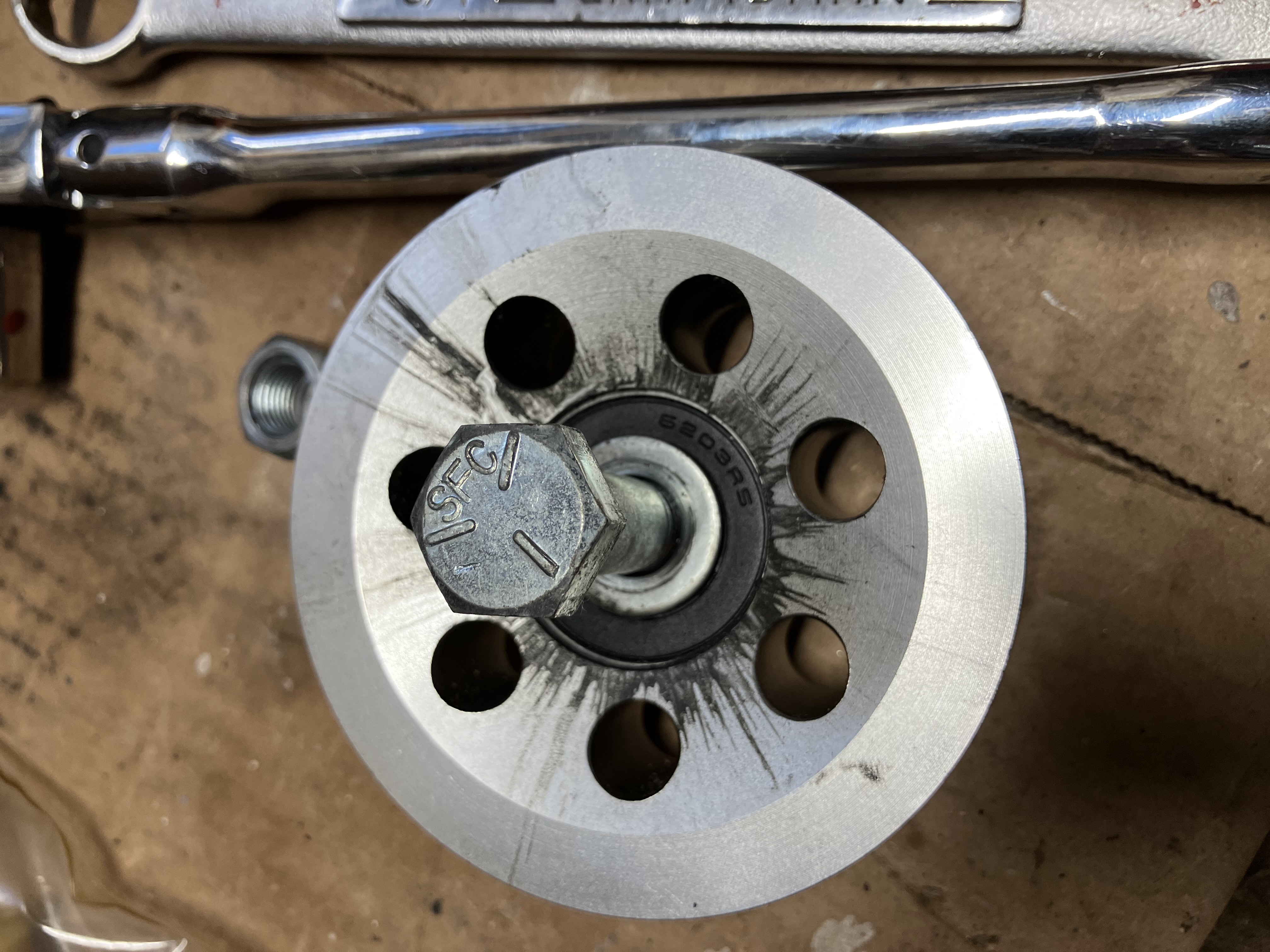

idler pulley has a few thousand miles and is already leaking out grease

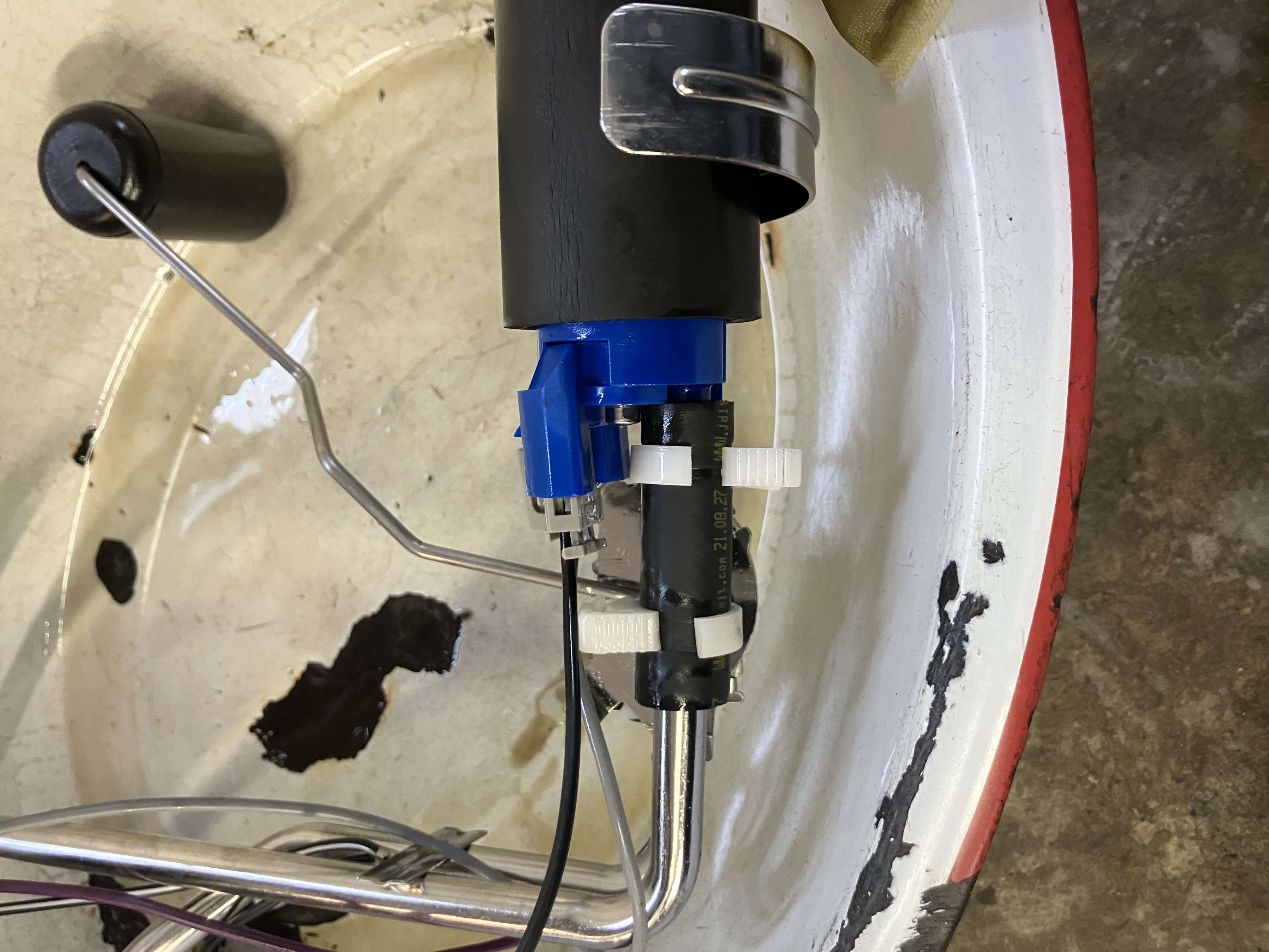

1) Fuel pressure issue is resolved. I removed the fuel pump/sending unit and found the plastic clamps on the hose connecting the pump to the sending unit to be broken.

bad clamps on newer unit - no way these are 3 yrs old

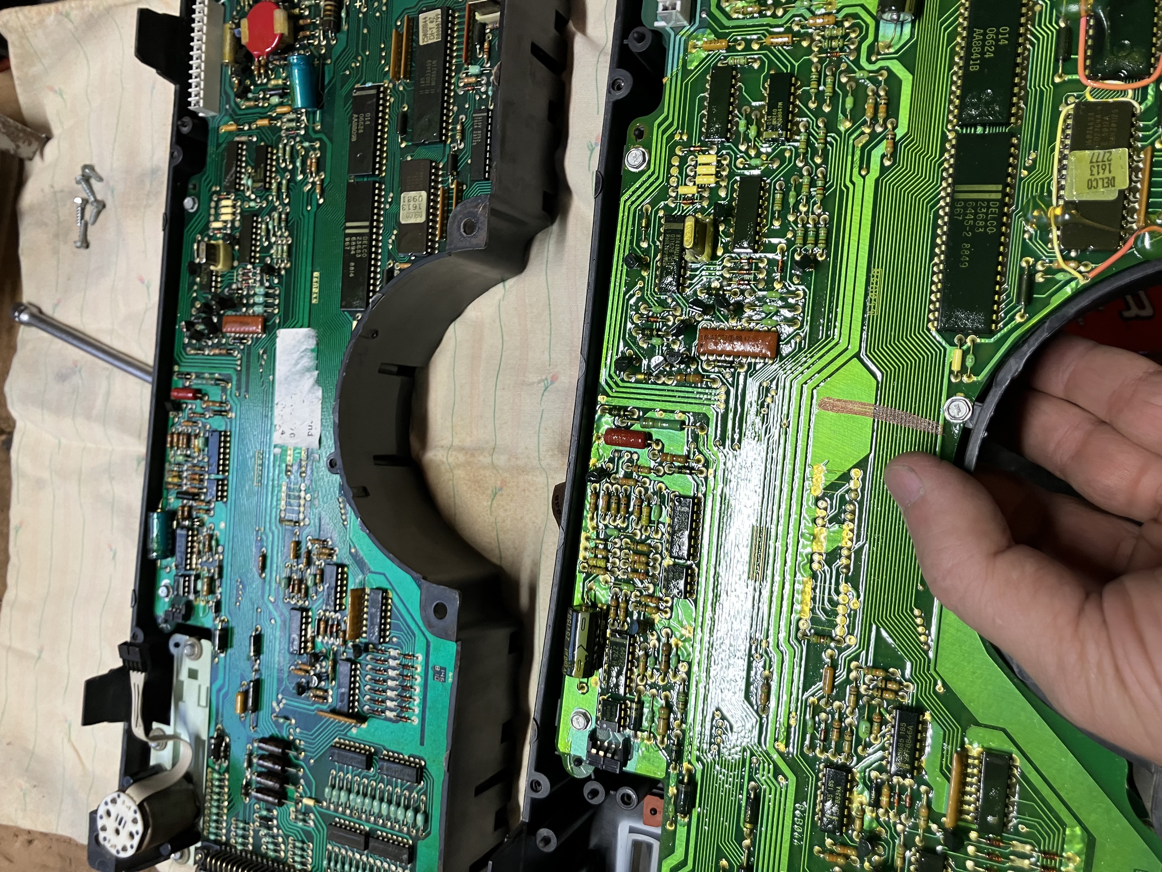

1) The rebuilt gauge cluster finally came in and got installed. It looks good.
surprised the color difference in cicuit board the old one looks quite faded.  seller said he repairs them does not replace the board

1) still has a sketchy idler for the serpentine belt. I have the air pump it might be best to turn it into an idler or possibly find a replacement pulley
