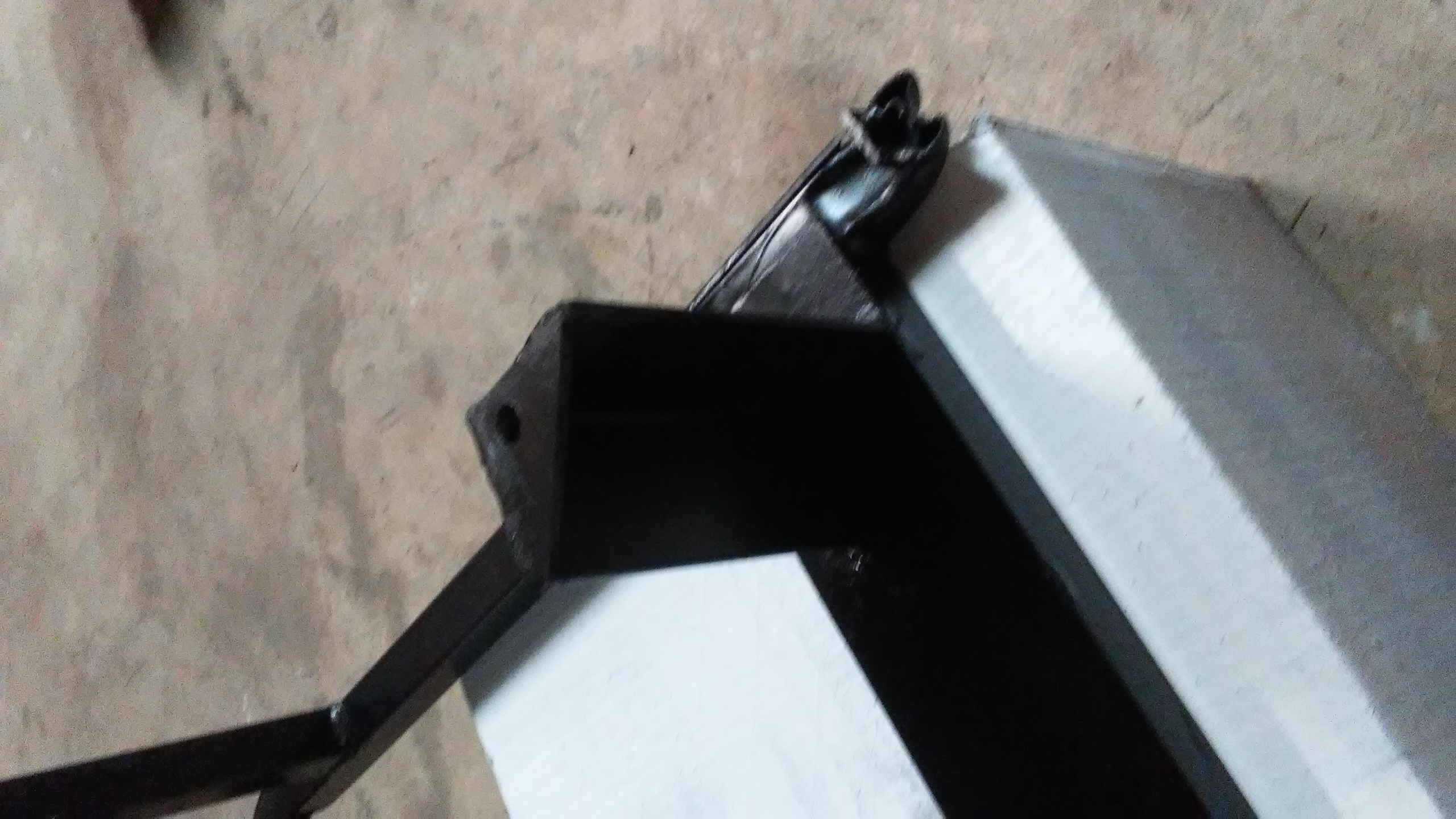

The first attempt for a right, rear leg on the engine cradle that doesn't interfere with the starter or header
was abandoned (it interfered with the header) and replaced with this.
This one, made from 2X1/8" angle iron, attaches to the inboard starter bolt.

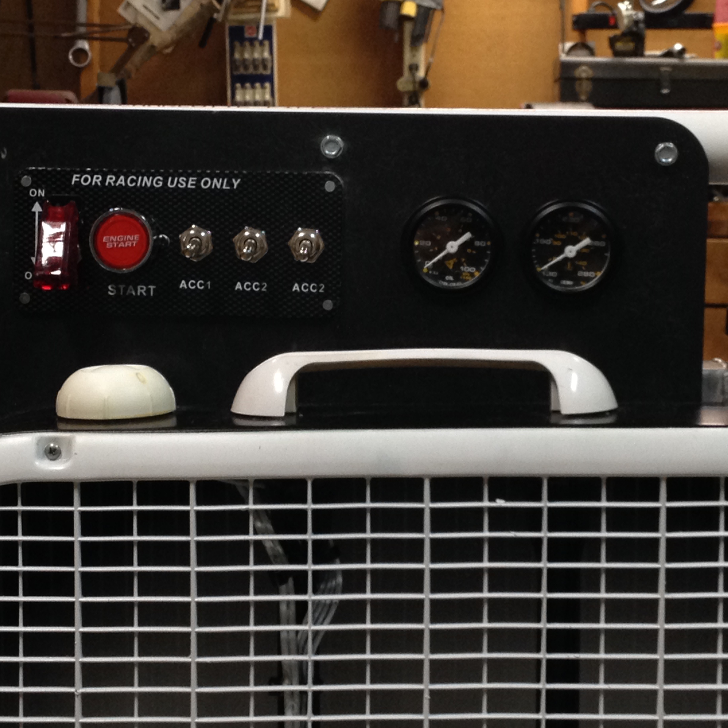

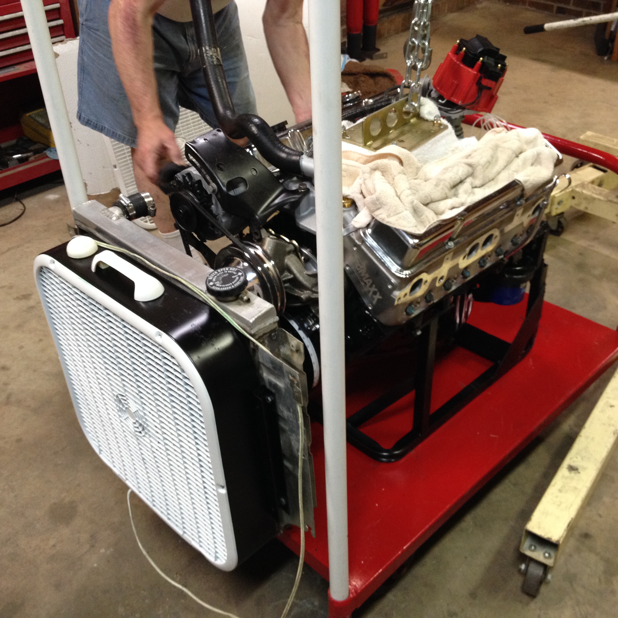

An old 20" fan was cleaned, painted and attached to the radiator. A NASCAR-like panel with start button, ignition switch and other switches was attached to a fiberglass sheet. Oil pressure and coolant temp gauges were also mounted on the fiberglass. That control panel and the radiator/fan were then attached to 1.5" PVC pipes that replaced the handle on one end of the cart. The headers and Cherry Bombs, with restrictions added to the mufflers to force most exhaust thru the fiberglass packing to quiet them down, were successfully test fitted. Good clearance with the cradle legs, cart and handles. We made a upper radiator hose by cutting an unused new hose from the stash. A lower hose will be be made from a 12" 1.5" ID flexible hose, a 1.5-to-1.75" exhaust adapter, and a 13" 1.75" ID flexible hose.

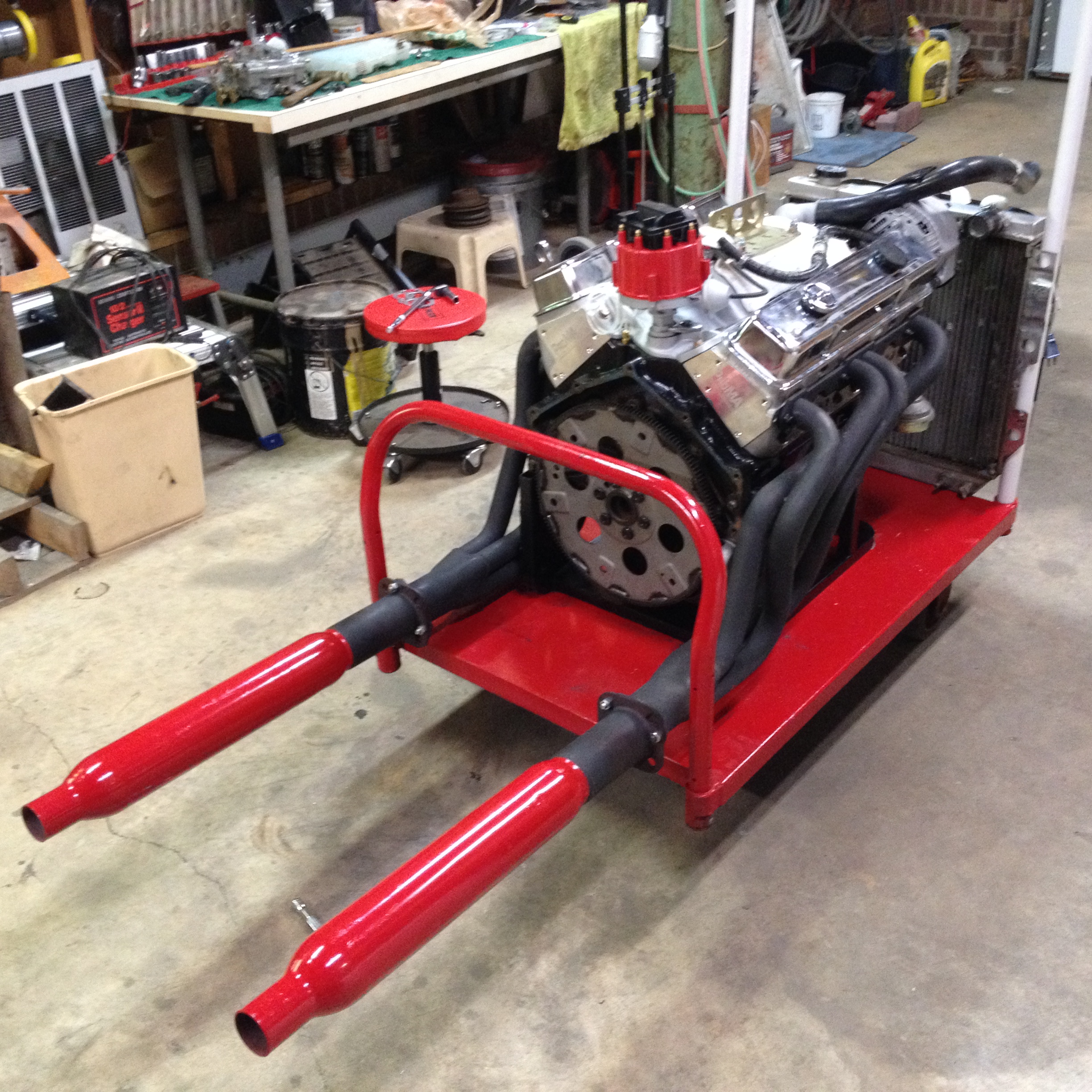

Thats a really nice looking setup. All the fun of putting together an engine and starting it without all the installation hassles. What's sticking out of the passenger side cherry bomb?
Re: SBC 350 + Test Stand
I think its a socket and extension but, whatever it is, its on the floor and not attached to the muffler.

Got the wiring for gauges, ignition, and start button done, installed the lawn mower throttle cable, bolted the engine cradle to the cart, finished installing the headers and mufflers, filled the radiator and cranked it. The $13 flex plate sits 1/8" too far back and hits a washer on the nose of the starter. Angle grinder removed an unused part of the teeth on the ring gear and it's ALMOST fixed. Could use a little more trimming. Cranked it again and, ...
IT'S ALIVE!!! Without changing the initial stab of the distributor or touching the carb adjustments it purred. Then, it died and wouldn't start.
No spark. WXO took the HEI module to AutoZone and, along with the counter guy, read the manual and learned how to test the module on their machine. Module failed the test and an old one he took along passed. The failed module is the same one used for the trip from NY. So, why did it fail almost immediately in the rebuilt engine? WXO bought a new module, with lifetime guarantee, put it in and it starts instantly and runs smooth and quiet. Readjusted the lifters with the engine running.
Caps in the Cherry Bombs make it quiet as a kitten. My old, cheap 20" box fan isn't providing enough air flow to cool the engine, even on idle. We shut it off when it hit 210*. WXO is checking to see if he has a flex fan in his stash.

Woohoo, first fire up is always fun! Regarding the fan, do you have it configured to pull air through the radiator? (not push)

The fan is pushing. WXO found his flex fan so maybe that will fix it, even without a shroud.

Change the fan to pull instead of push and I'll bet you'll have better cooling. Flex fan without a shroud won't be better. That's how my Blazer was when I first got it. Drive-thrus were a no-no because of no air-flow.
