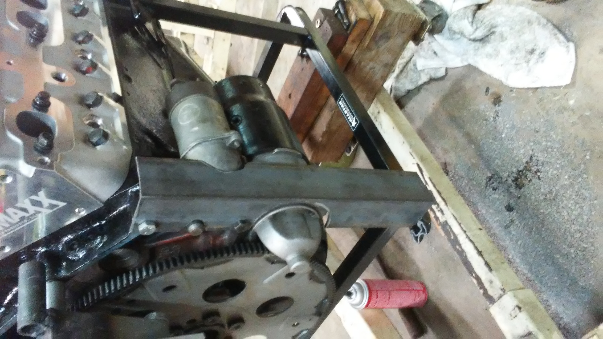

The first attempt for a right, rear leg on the engine cradle that doesn't interfere with the starter or header
was abandoned (it interfered with the header) and replaced with this.
This one, made from 2X1/8" angle iron, attaches to the inboard starter bolt.
