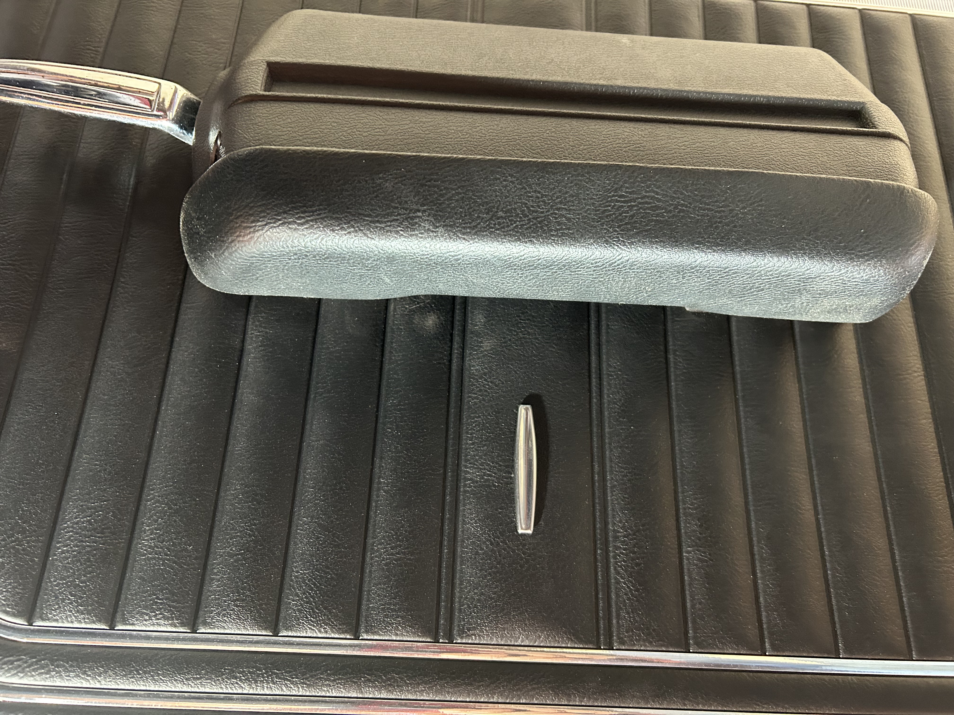

I think I put the door medalions in your ashtray when you were doing the paper work in the "office".....but I could be wrong. Regardless, they have been found and look great.

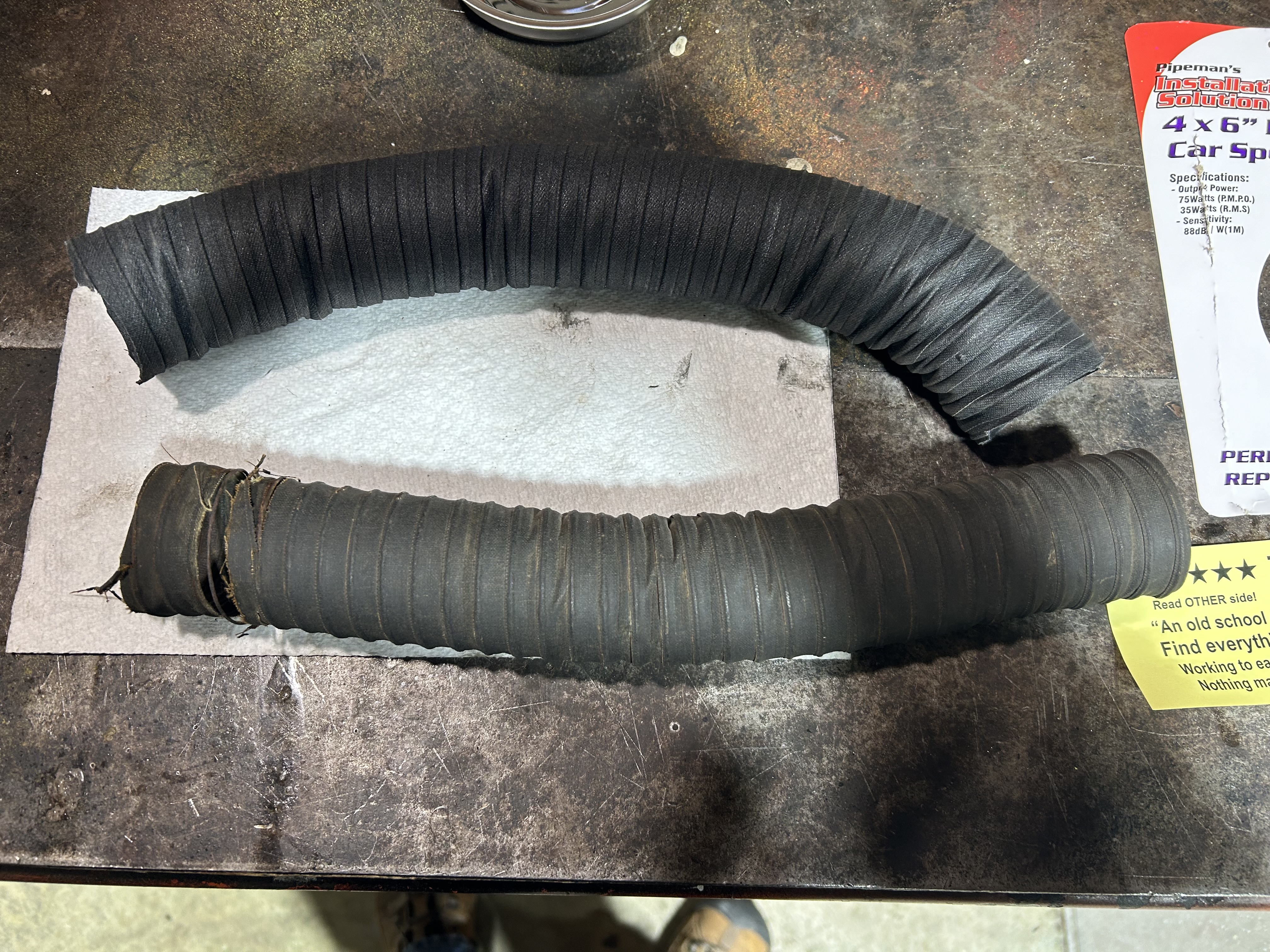

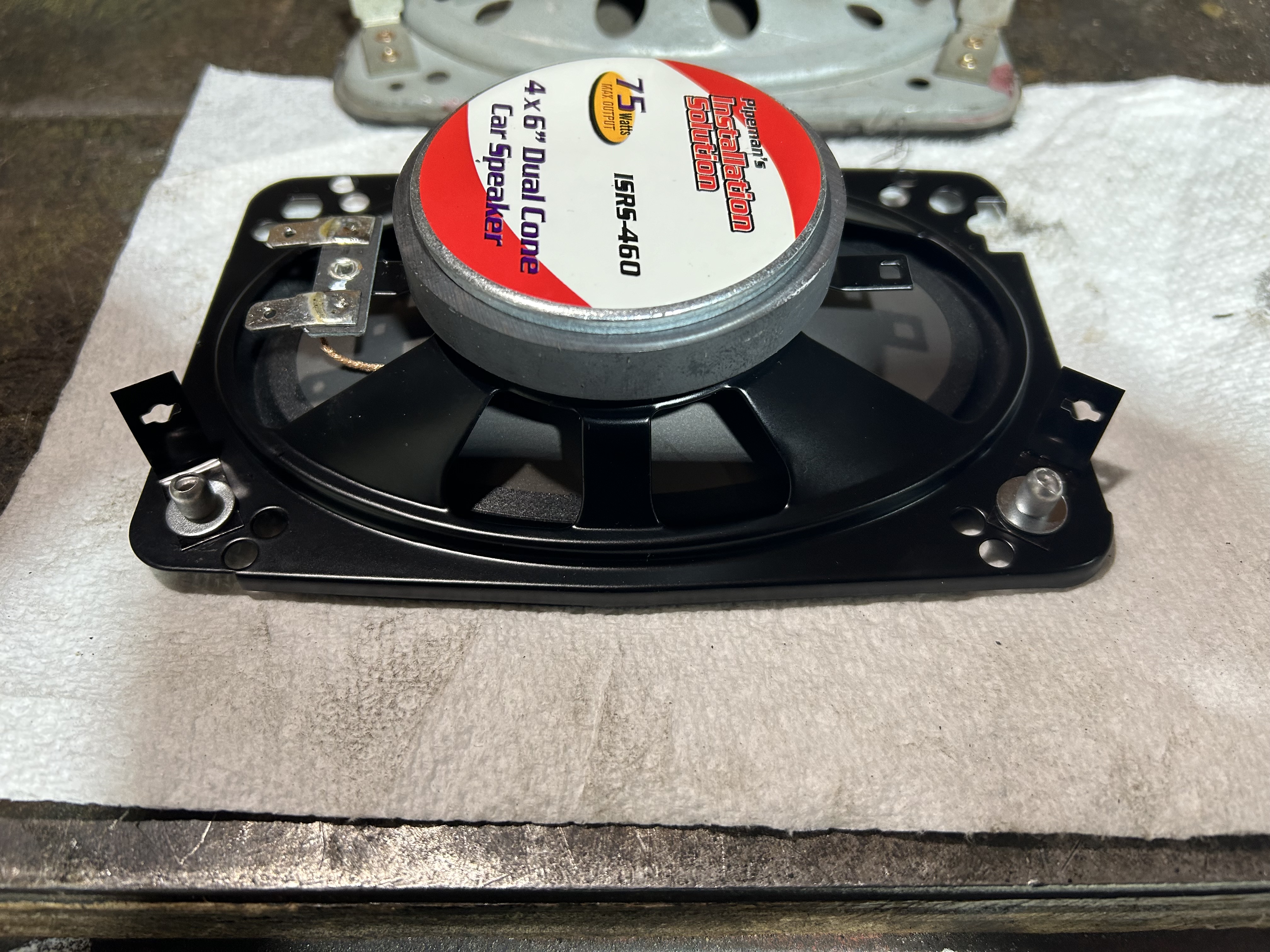

I went out today to see how much of the interior I could tie up. Things went pretty well, I think. I started by mounting the speakers up. The driver side was the more difficult of the two, so I started there first. I used a 4”x6” speaker that was pretty similar to what came out of the car. The speakers came with little mounting tabs that I riveted to the speaker frame so I could mount them exactly the way the old speakers were mounted. The driver side has to contend with the light switch, so it’s pretty tight over there, but it went right in. The passenger side was even easier. After a short sound check that went as I hoped, I was on a roll. I finished up straightening out the radio wires (I retained the factory harness and connector) and tied them up neatly under the dash. I was then able to reinstall the hvac system ductwork. I purchased new small tubing and cut the two pieces to the correct length. After this was bolted up, I finally got to put the dash pad back on. With the tach (Autometer #2892) mounted and wired (except for hook up to coil) and the mechanical Autogage oil and water temp gauges (Autogage kit #2392) wired (not yet hooked up under hood) I called it a day, but a very good day. It was nice to see several projects get tied up. To finish off the interior, I have to figure out the spare tire and mount and put in the seat. More to come.

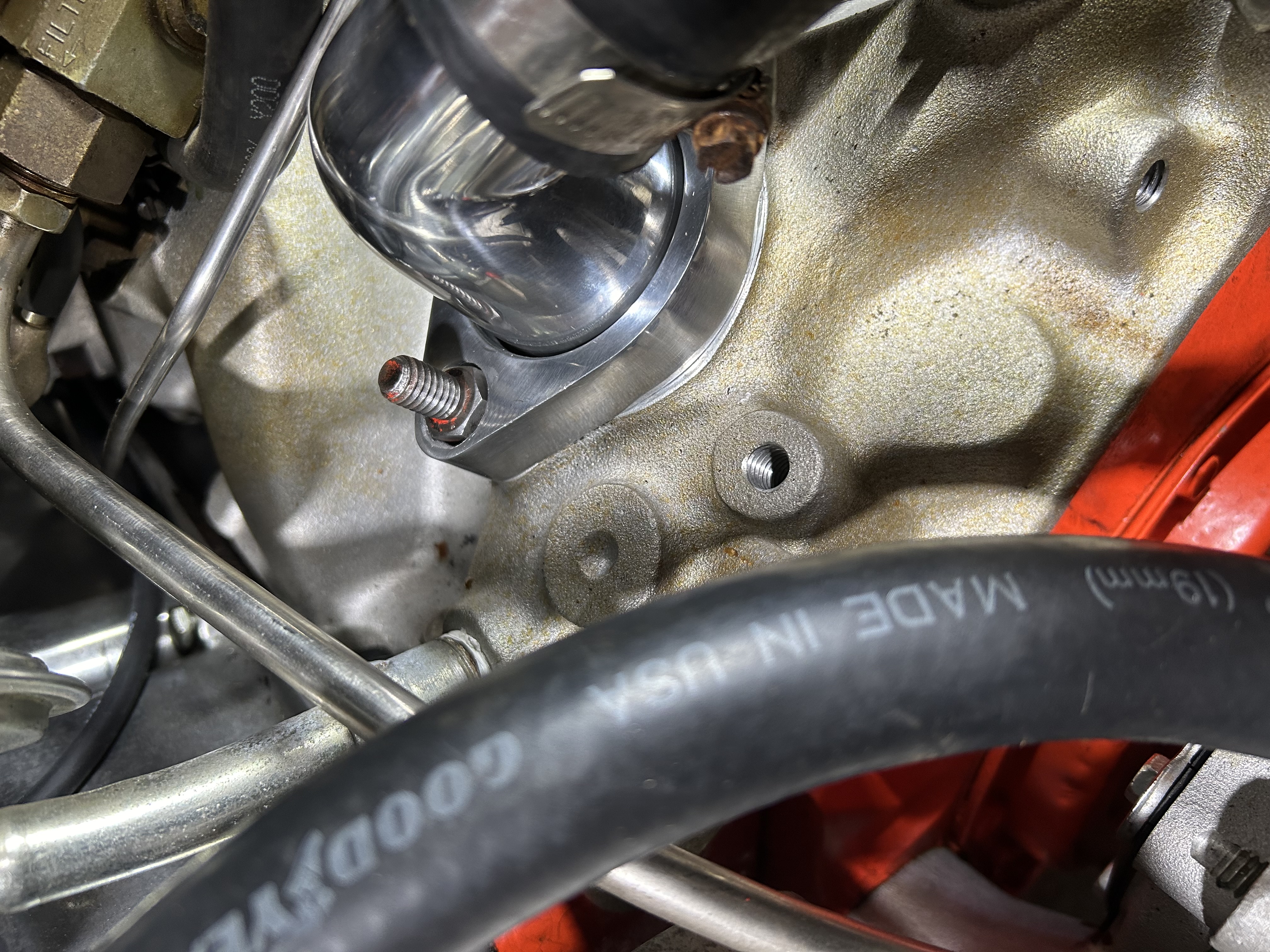

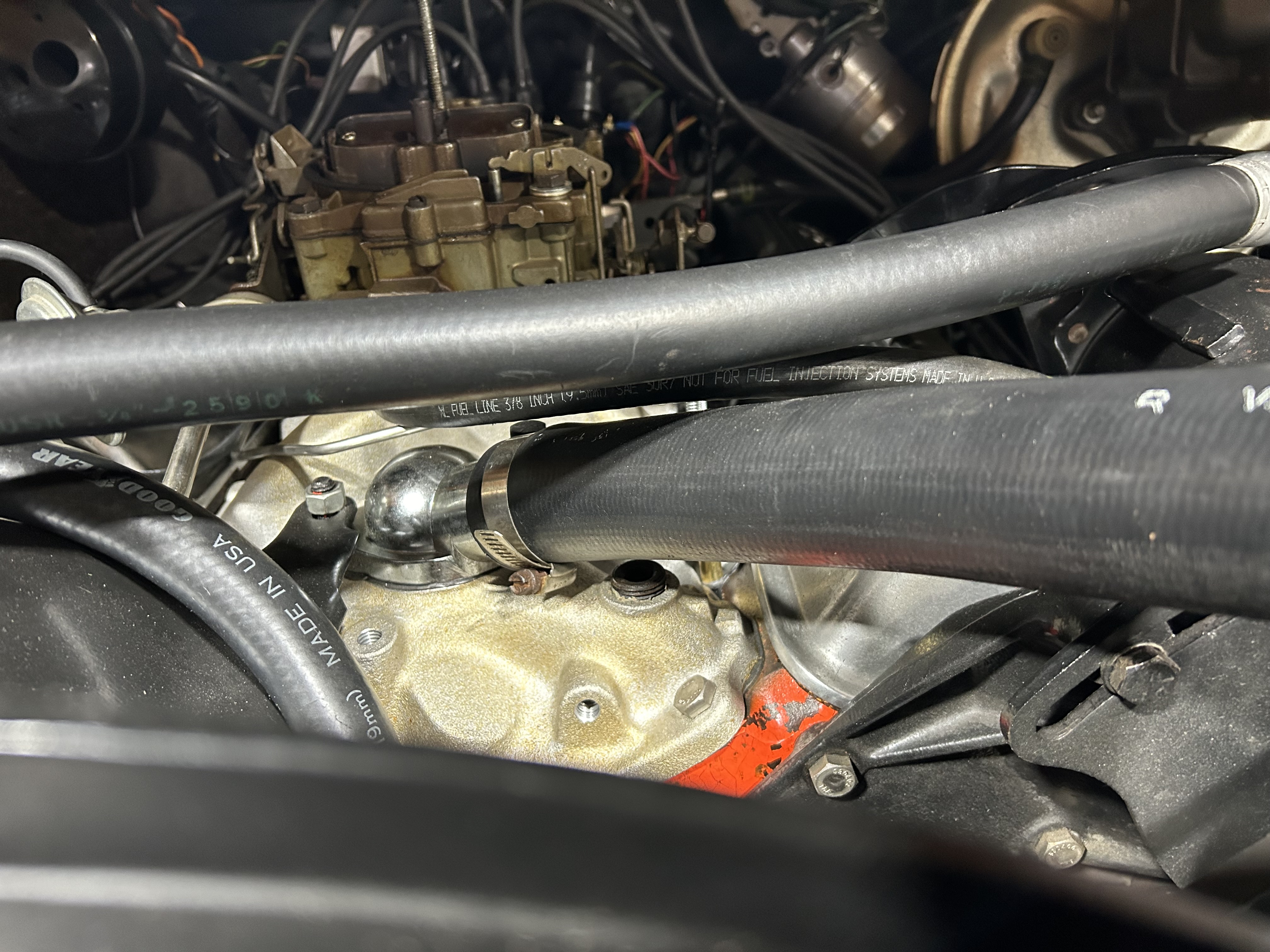

I think I have the spare tire mounted how I want it. The spare is a donut spare with two separate lug patterns on it. At first I wasn’t keen on it, but being that I had to live behind the passenger seat and it’s lighter than a full sized spare, I decided to keep it, at least for now. There’s also a scissor jack that came with the car that worked just fine. I’ll use it too. I need to procure a lug wrench. I will. After fiddling with the spare, I went into the engine compartment. I started by hooking up the tach wire. Then I drained the coolant so I could hook up the mechanical temp gauge. The big issue with this project was that the upper radiator hose was routed right over the hole in the intake for the temp gauge bulb. I bought a Summit Racing 45* swivel water neck to cure the problem. I overthought the issue and the neck had too steep of an angle for comfort. I decided to make the trek to Summit and exchange it out for a 15* swivel neck. Way better! After some engineering that was required to make the alternator bracket stud work (the stud is recessed in the water neck. The bolt hole in the neck had to be opened a bit to accommodate the stud, and the stud was double-nutted so I could torque on it.) I was able to put the new 160* thermostat in, finish mounting the water neck and put coolant back in. I saw no leaks, but I was pretty beat and opted to not start the car. That’ll be next. I think the seat is ready to go in also. To keep from scratching the door sills, I need my wife to assist. More stuff behind me.

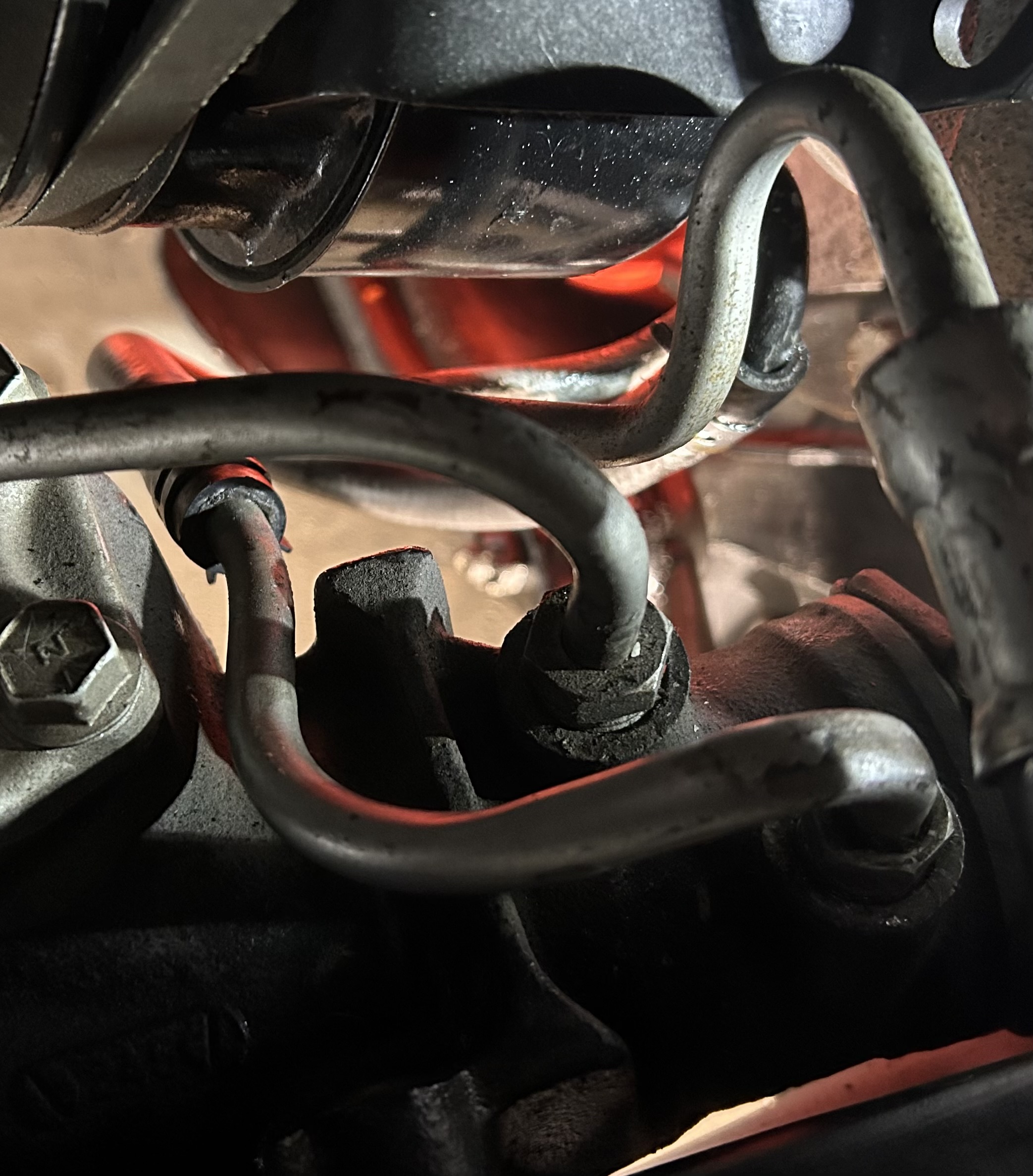

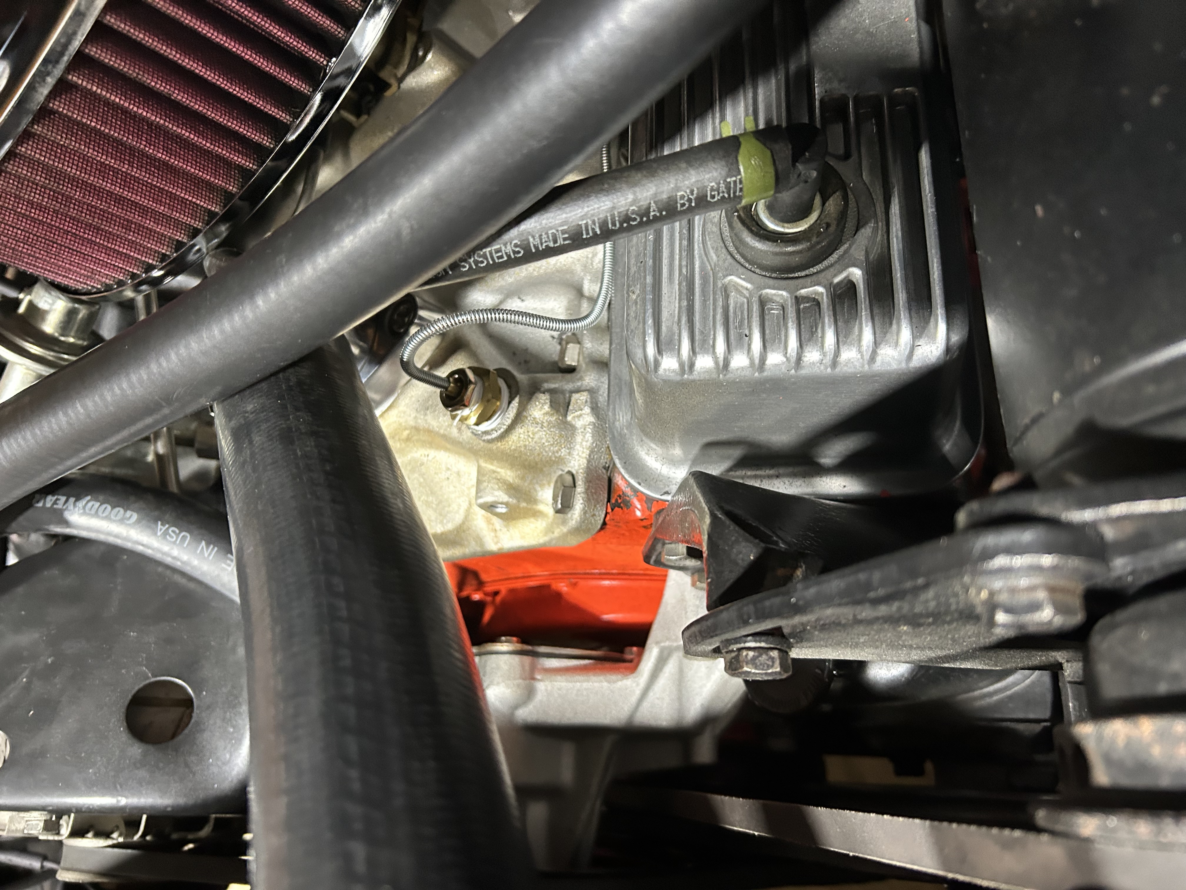

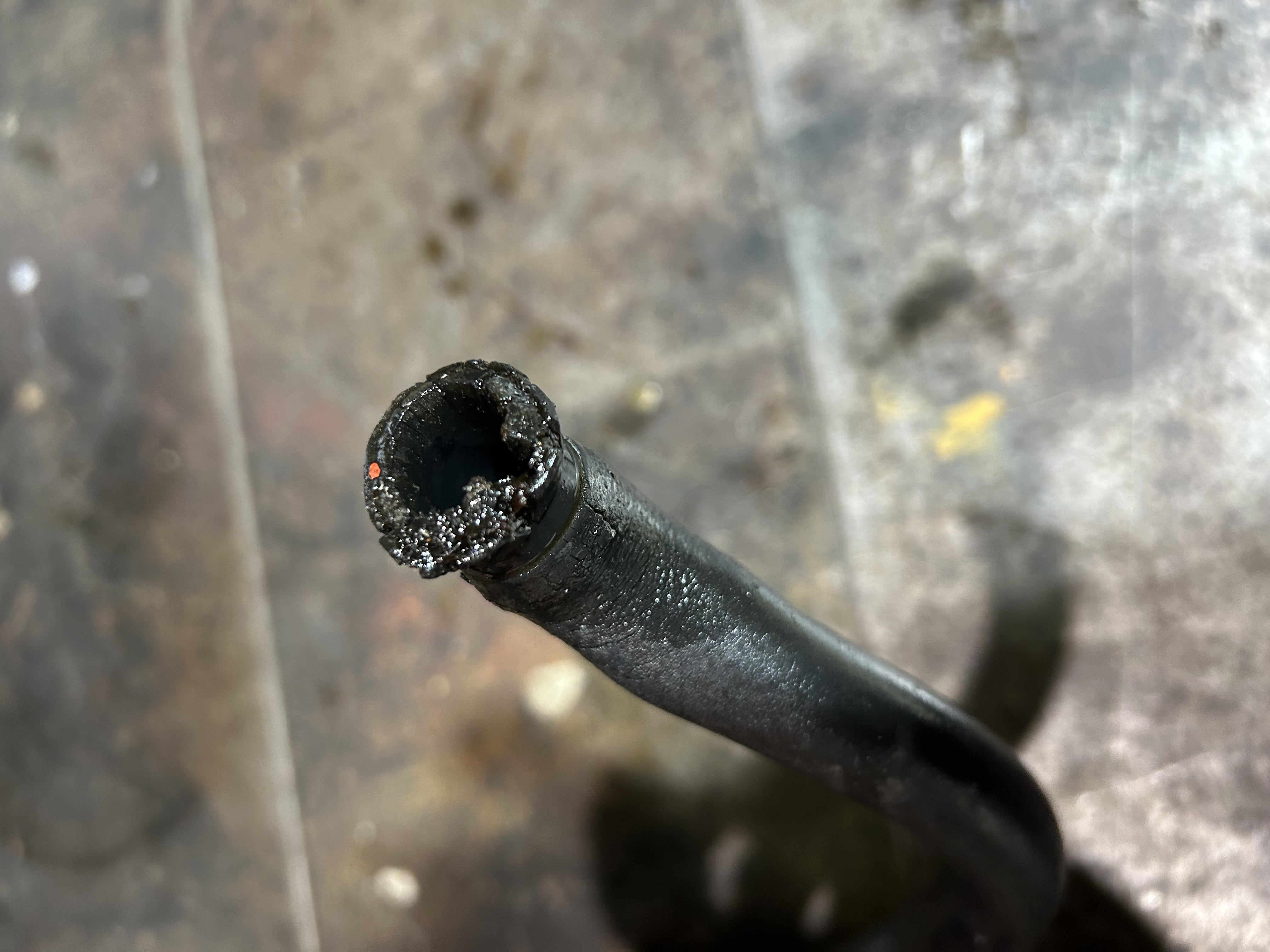

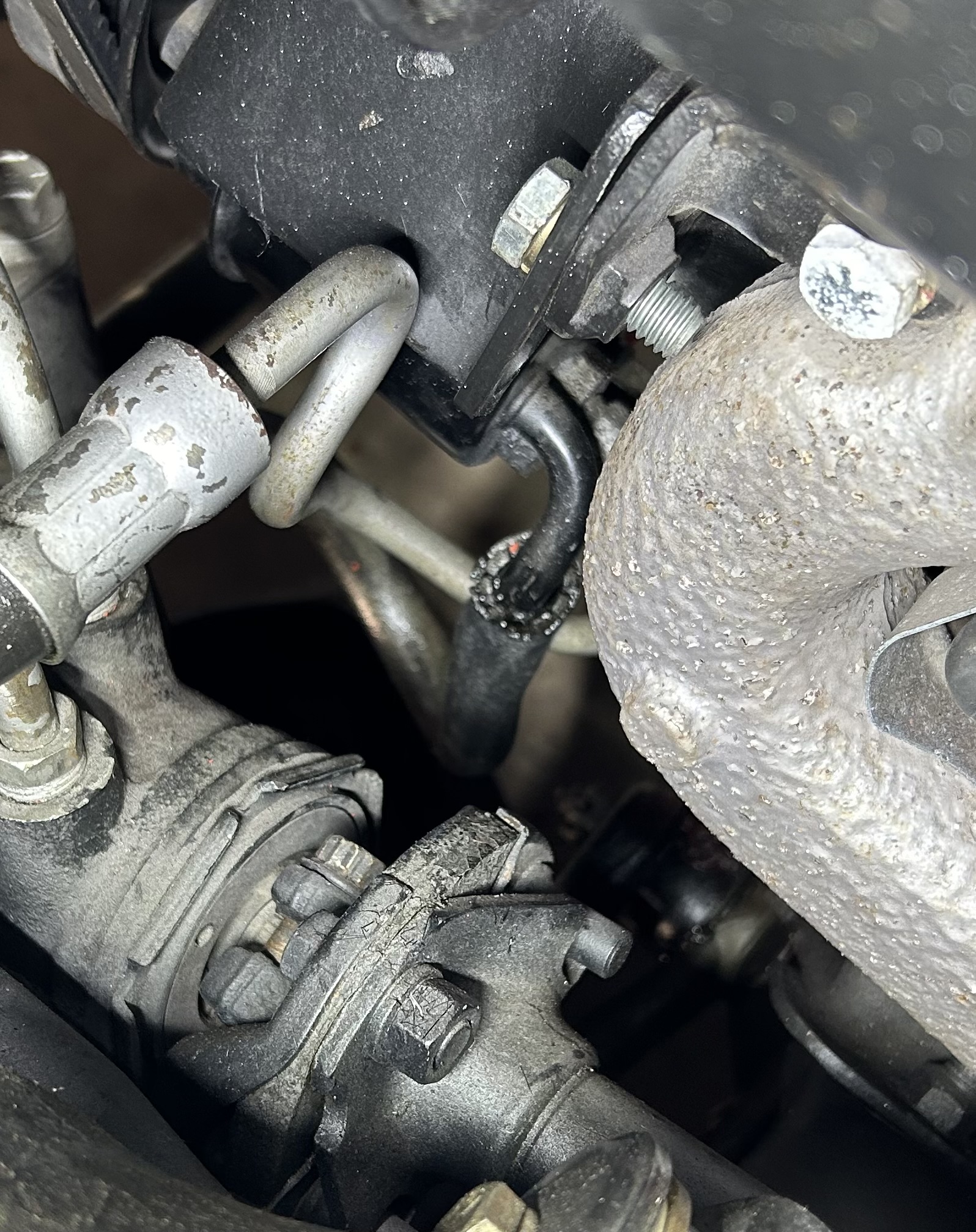

3) Remove old power steering return line & drain power steering fluid
4) Install new power steering return line, straighten return line on pump for clearance
5) Refill power steering pump with new ATF
6) Replace leaking radiator drain plug with brass petcock (plug has leaked since I got the car)

Old return line
Old return line
Old return line
Old return line
Return line - old with NO CLAMP!
Return line installed

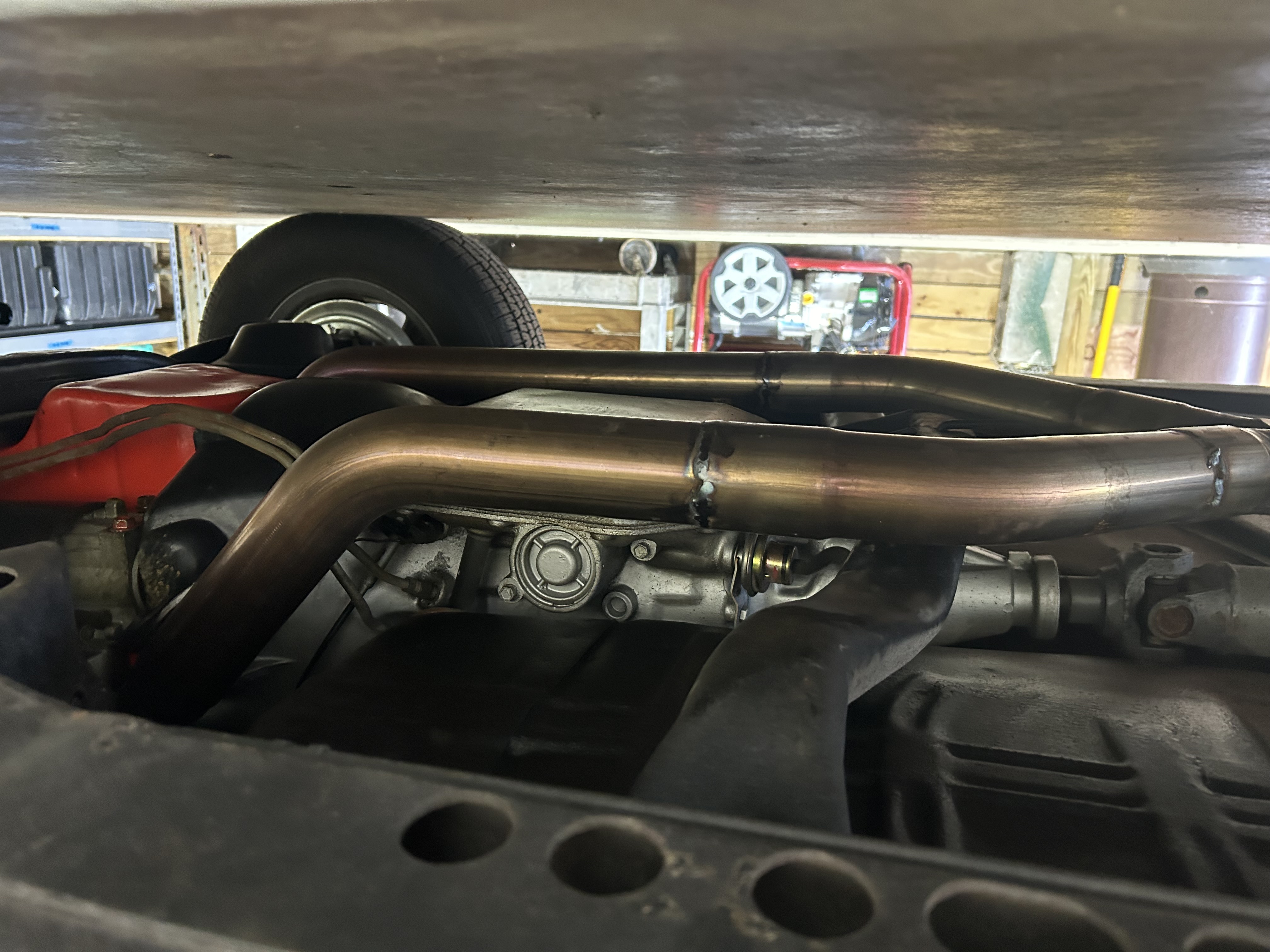

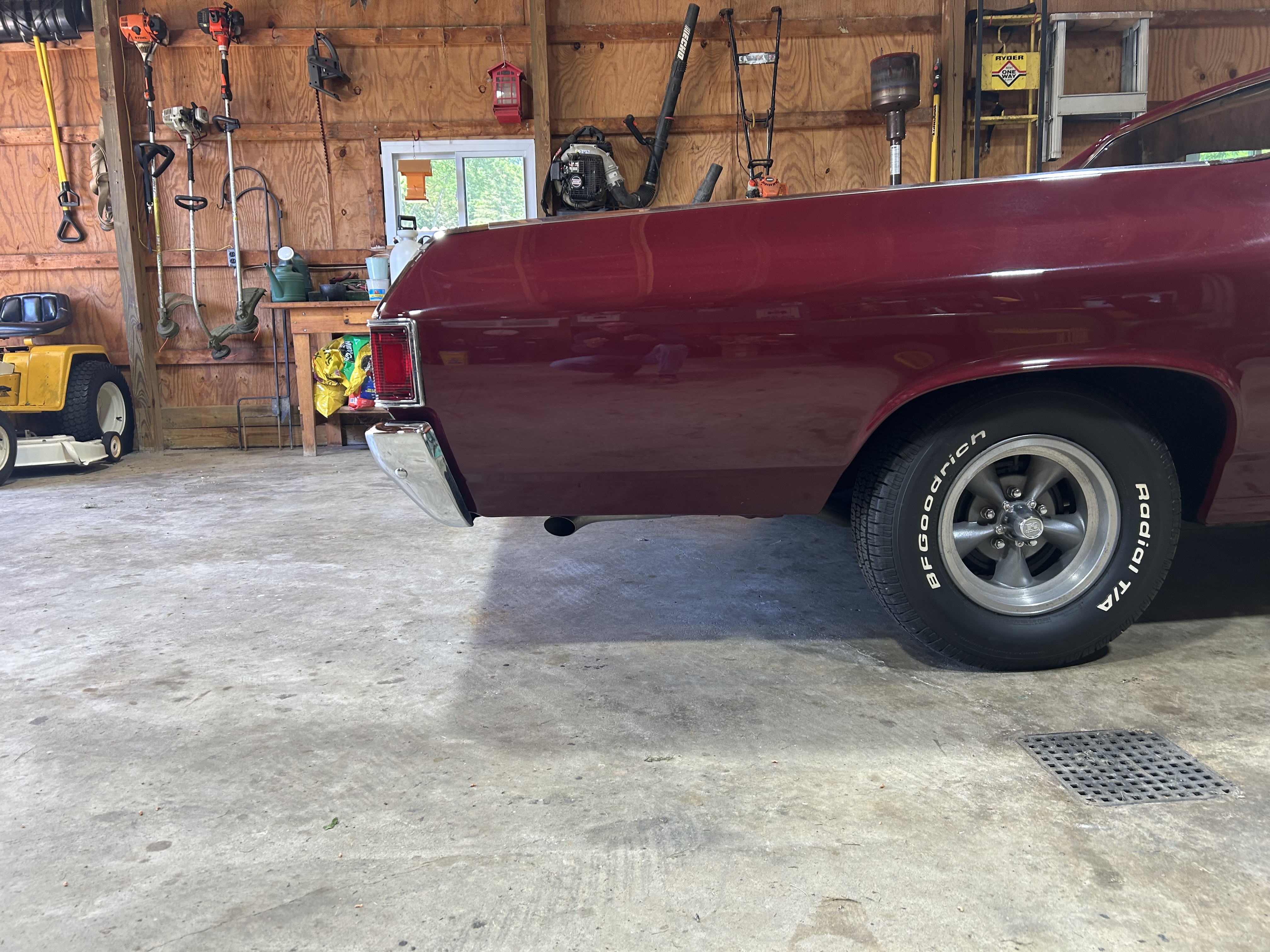

Exhaust System

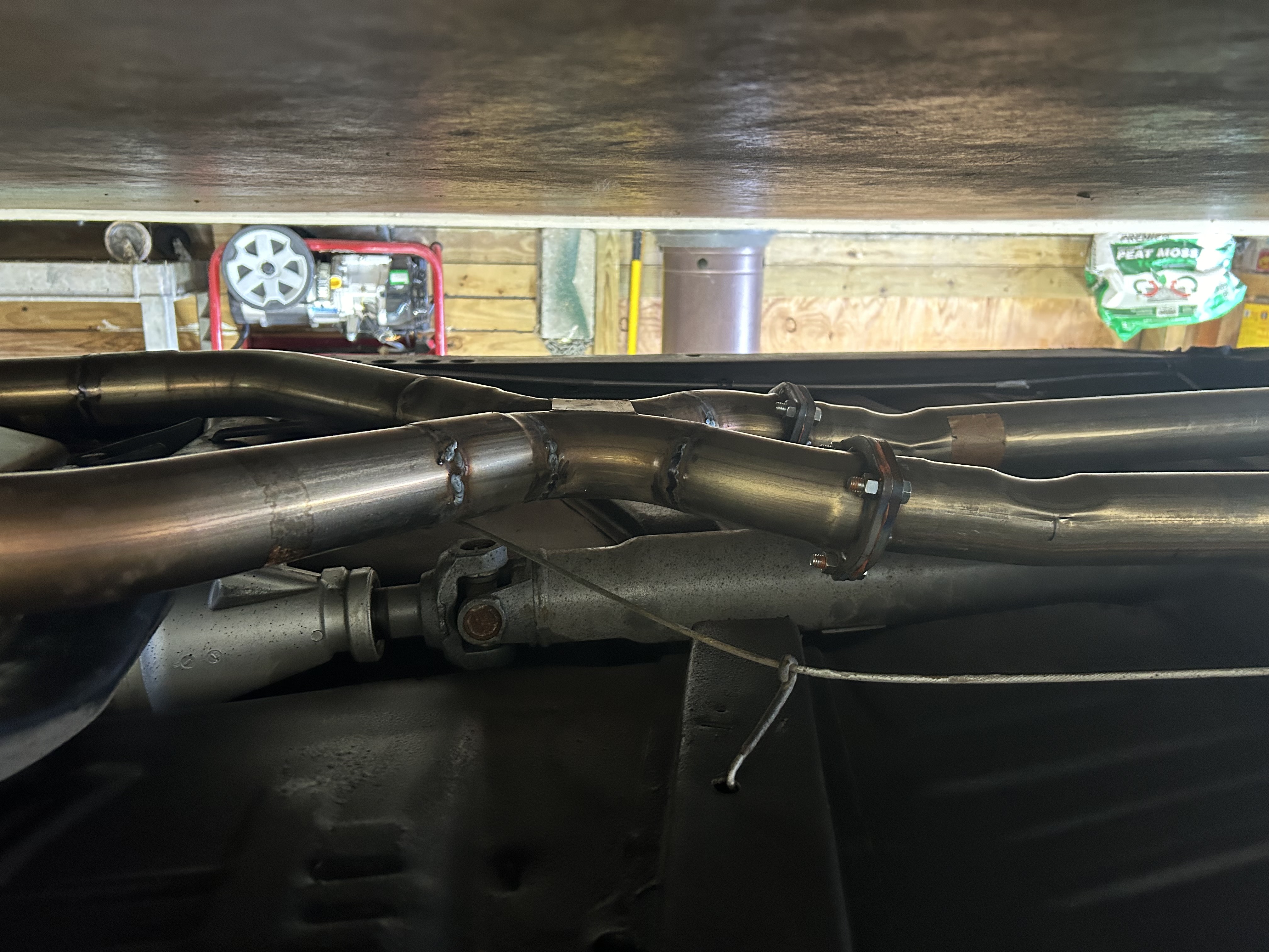

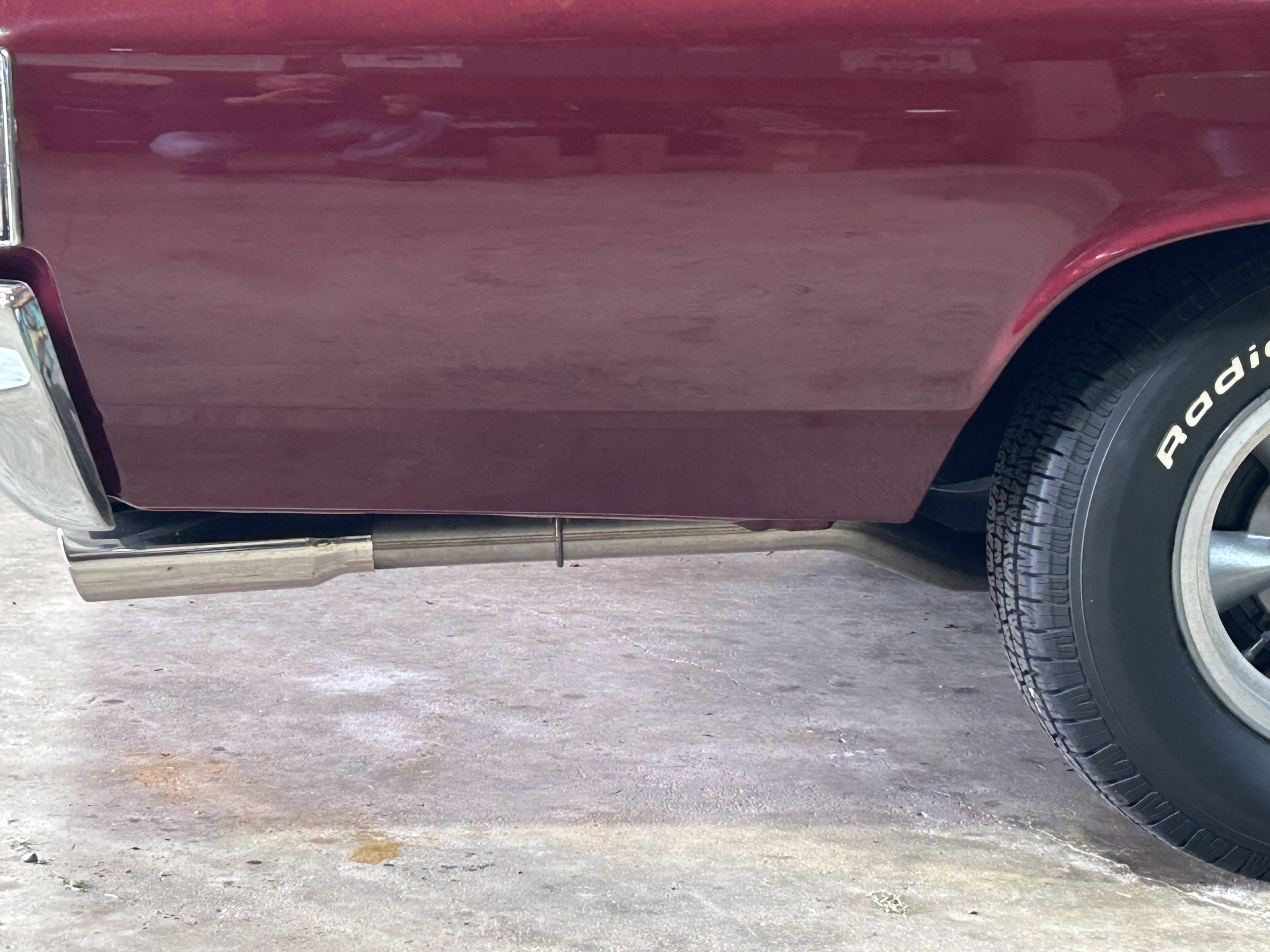

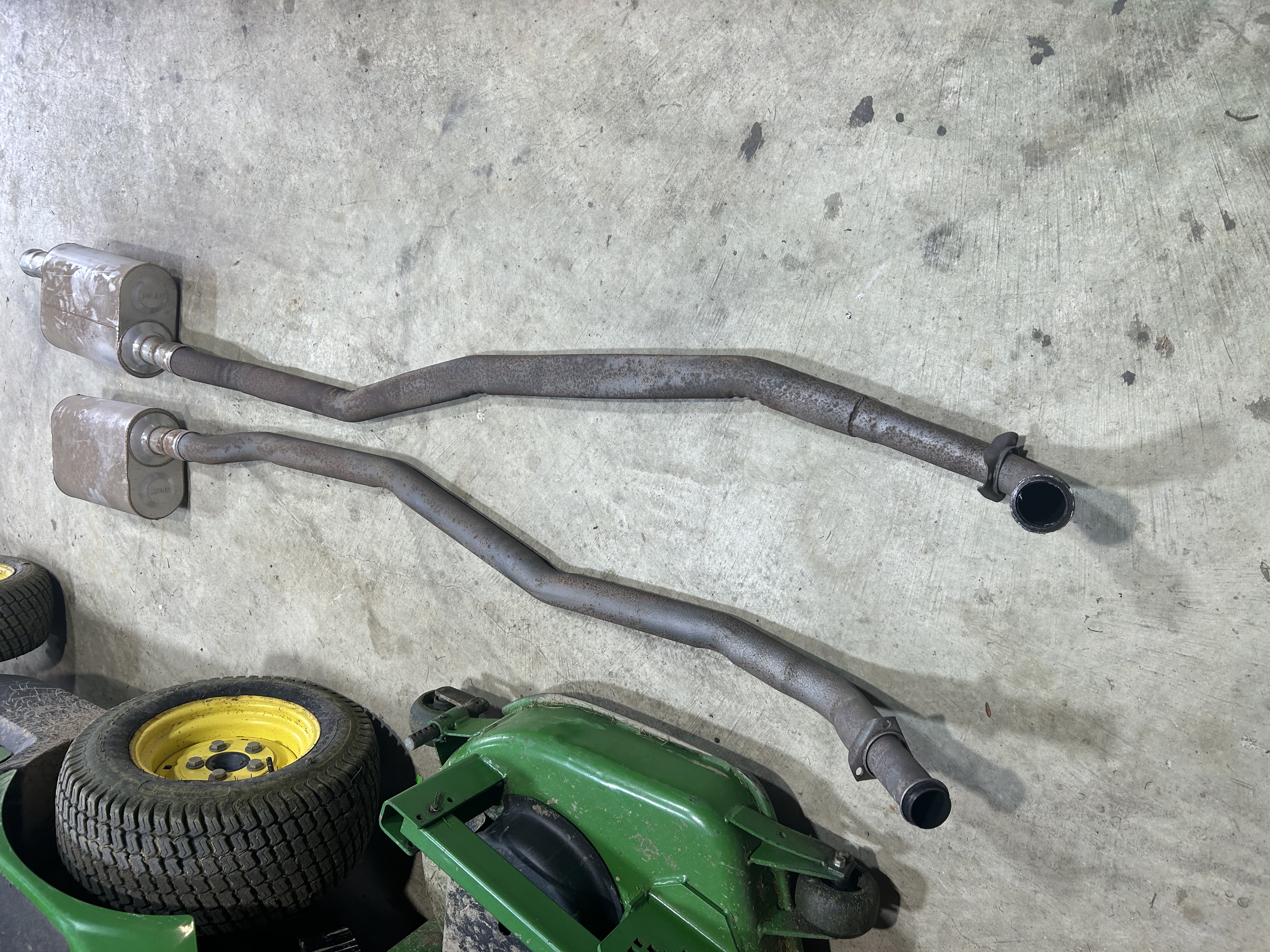

It’s been forever since I posted. The exhaust work has been done, but the car was at the shop for four weeks. It’s a long story not worth going in to, but it definitely cut into my driving time for sure. On the bright side, the old, cobbled-up, super loud system has been removed and a new Pypes-based system has been installed. Factory hangers were used for a stock look, and Walker/Dynomax Super Turbo mufflers have been installed to take the noise. I also went the route of doing my best to hide the exhaust tips for a cleaner look. I’m happy with the outcome and the car is way more pleasurable to drive. You can now actually hear the radio and the stupid pipes with gigantic tips are a thing of the past! What was salvageable of the old system was sold on Marketplace to help defray the cost of the new system.

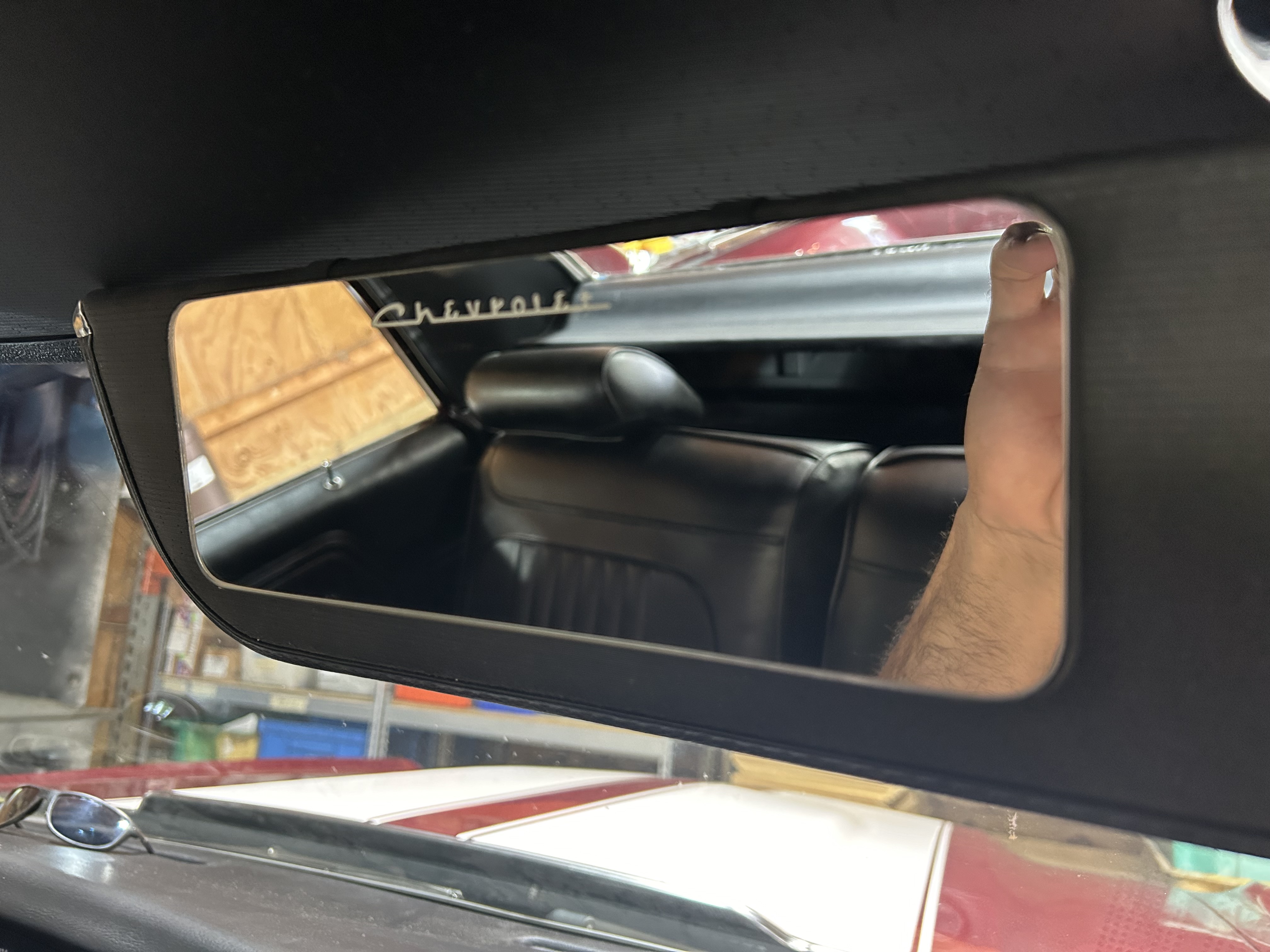

Vanity Mirror
Fred32V and Mom hooked me up with a vanity mirror for a birthday gift. I had him order a mirror for an older Chevy truck and I custom modified it so it fit the needs of the El Camino. It came new in tan color, and I used Sem Landau Black interior spray to make it satin black to match the cab. It turned out sweet!

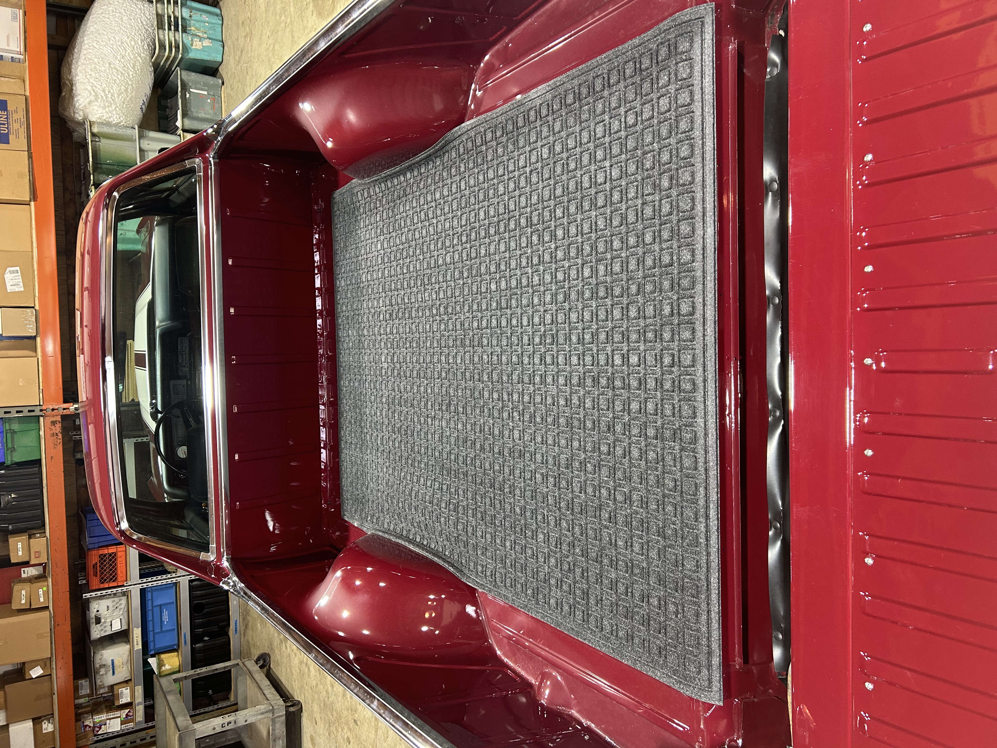

It’s not my objective to use the El Camino as a hauler, but in a situation where I want to do a light haul (golf clubs maybe) I didn’t want the bed paint to get all scratched up. To avoid spending $200 on a rubber mat, I took to Home Depot and found a 4’ x 6’ heavy rubber backed indoor/outdoor carpet that is going to work just fine. I road tested it at 70 mph last night and it didn’t blow out, so I think we’re good. The charcoal cold is a good match to the wheels, so it almost looks like it belongs there! The best part is I can remove it and install it in 30 seconds.
