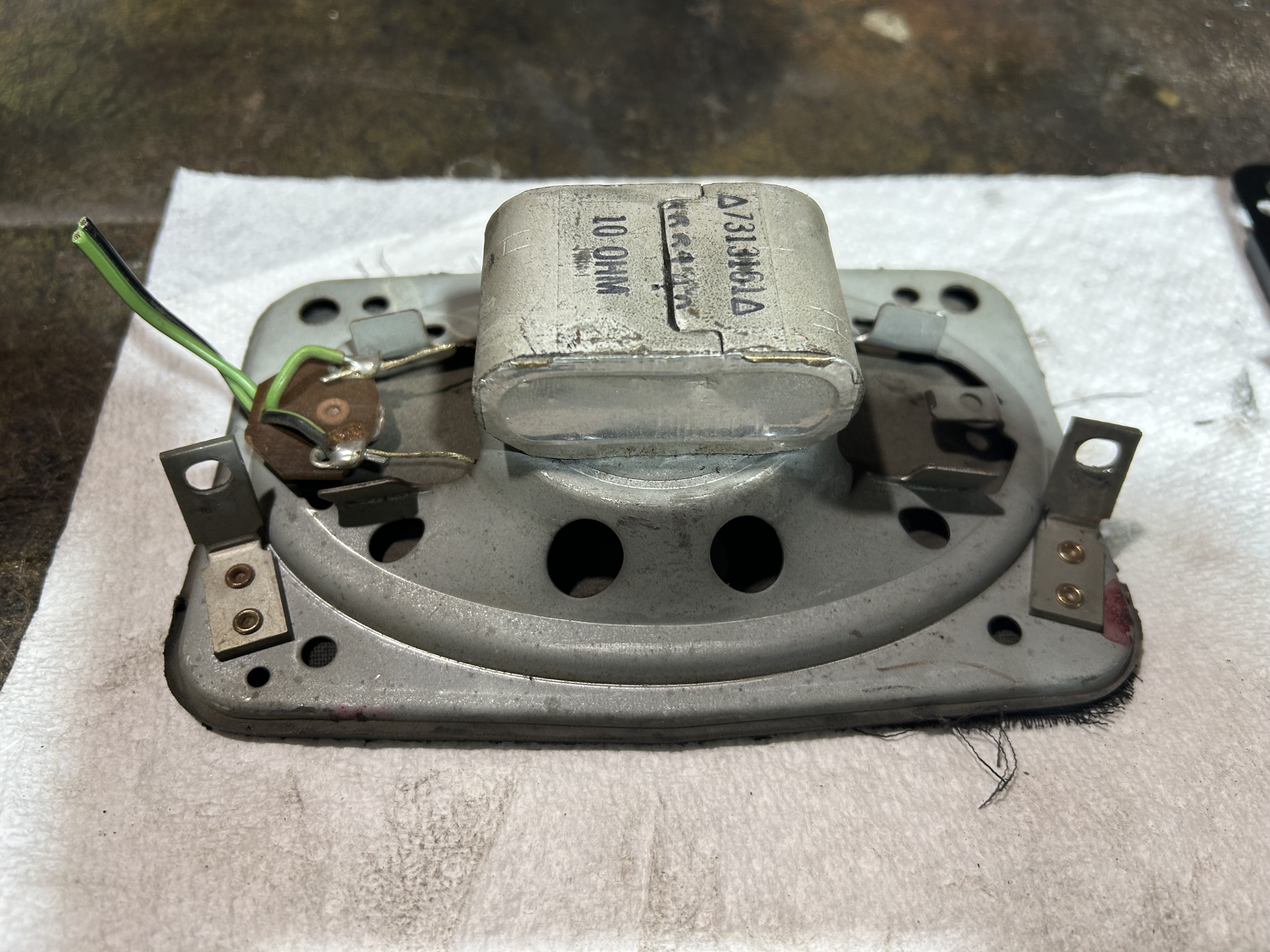

I think old speakers are four ohms while new speakers are eight ohms. I think they old ones will be fully usable if you stick a 2 ohm resistor in the mix....but they probably won't sound awesome b/c they're.....old.

The ohms of the speakers makes sense now…. Mostmint hooked me up with a Mopar speaker as a test unitBlue_69_malibu wrote: Fri Nov 24, 2023 11:55 pm I think I put the door medalions in your ashtray when you were doing the paper work in the "office".....but I could be wrong. Regardless, they have been found and look great.
Keep on rocking that Elco!!
and the radio plays as it should. New speakers are on their way! Thankfully, this worked. I had the unit
wired real well and the unit mounted to the dash plate real well. The holes for the radio mount had been filed
a bit, but my washer configuration (coupled with the fact that the radio barely weighs a pound) worked
real well and we have a solid install. I wasn’t in the mood to undo all my work. After the radio test, I

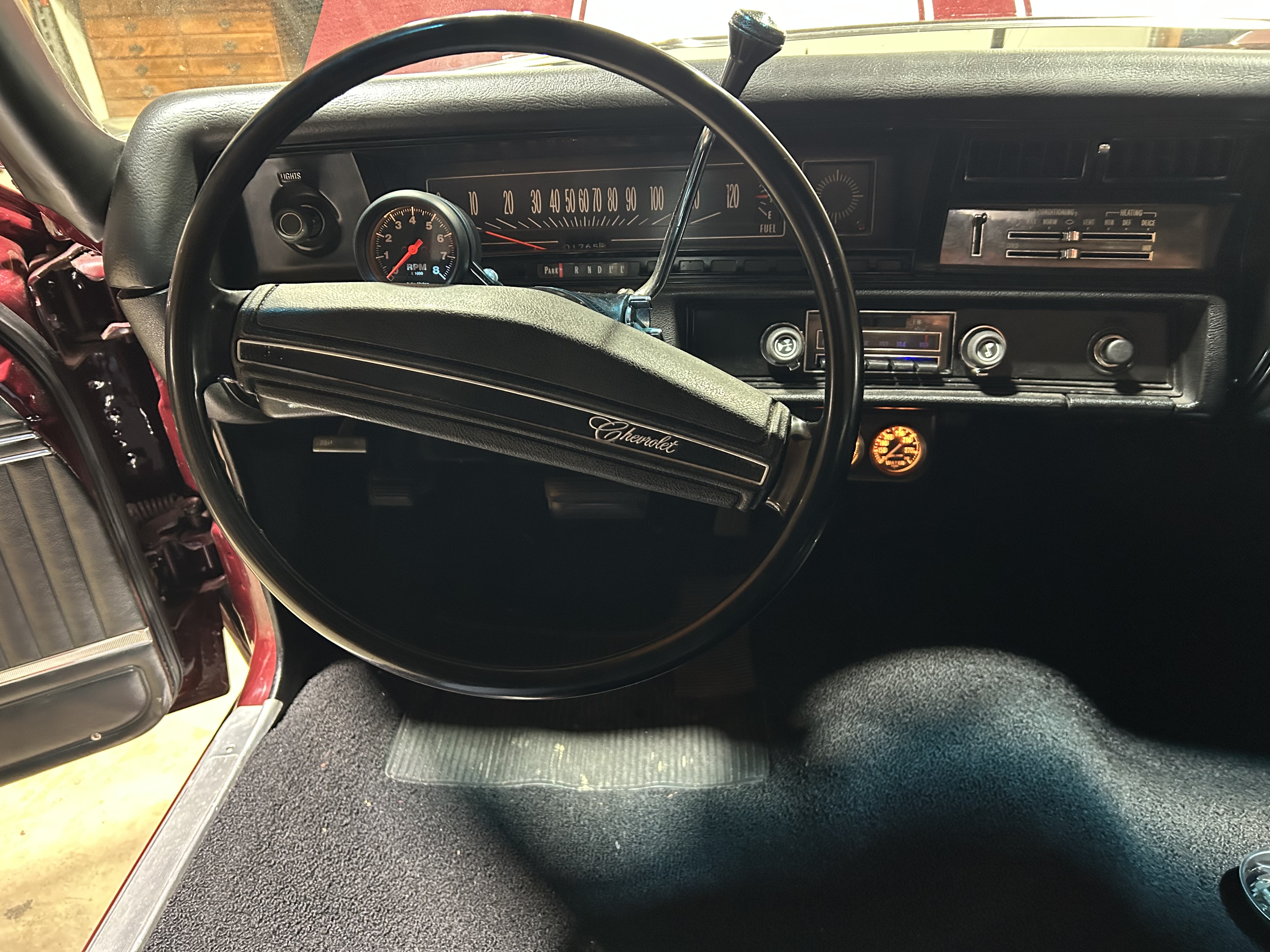

removed the old water and oil gauge and began the install of new mechanical gauges that better match
the dash. A tach is also going to be installed. Hopefully, in the next two weeks or so I will have the interior
all tied up and ready for spring. More to come.

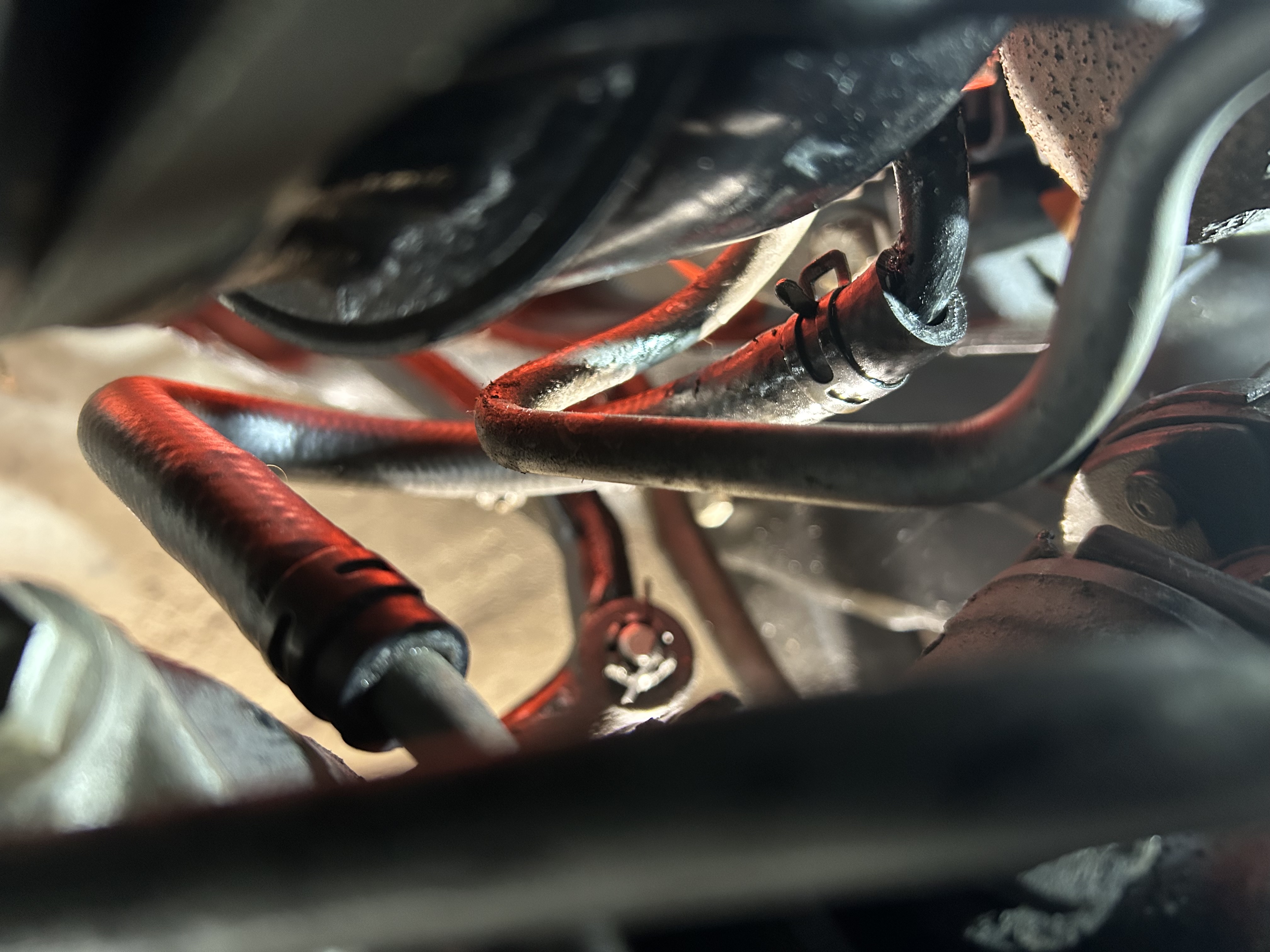

2) Install AUX to lightening cord on back of radio to allow Iphone connection - line-in

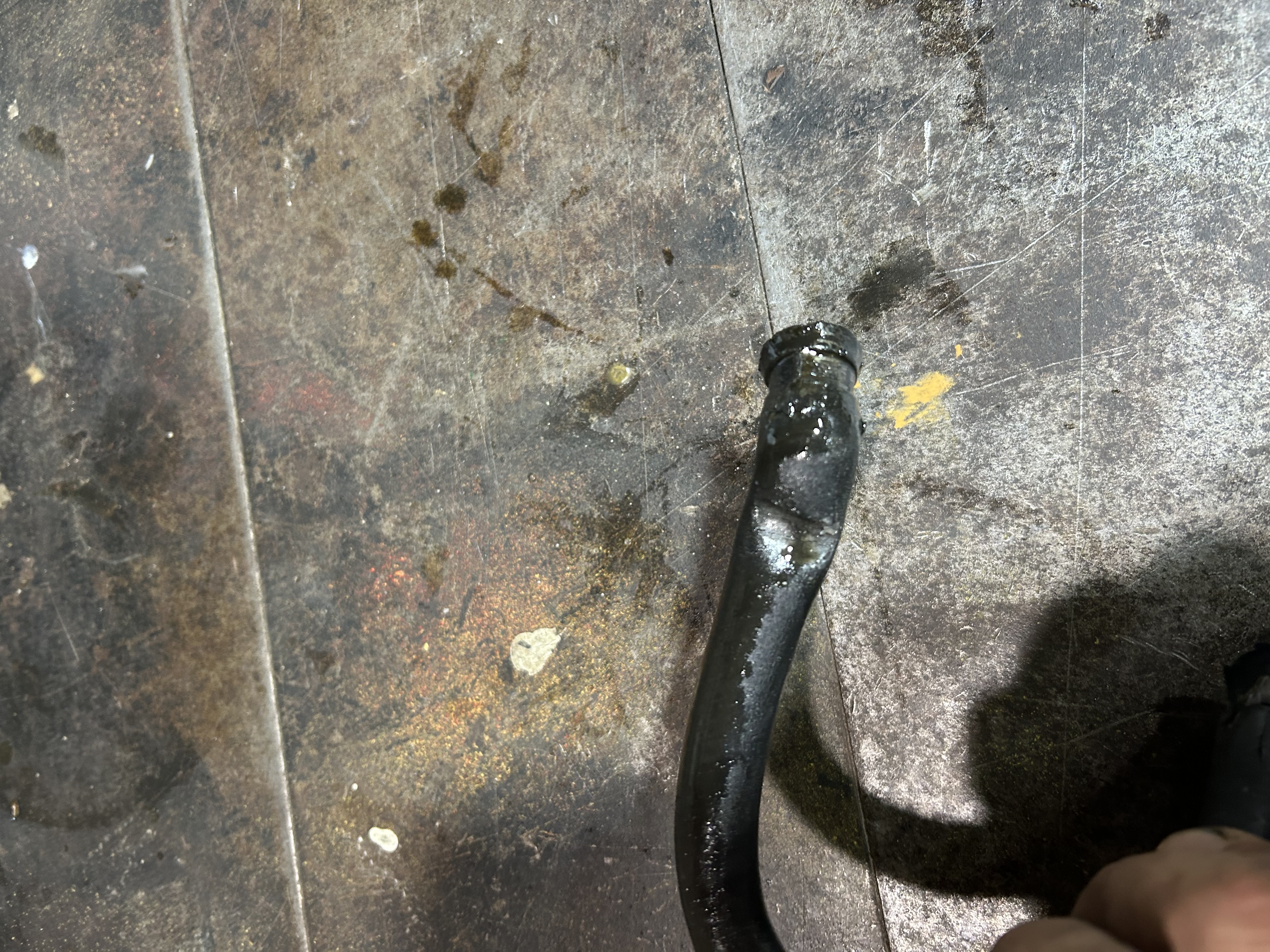

3) Remove old power steering return line & drain power steering fluid
4) Install new power steering return line, straighten return line on pump for clearance
5) Refill power steering pump with new ATF

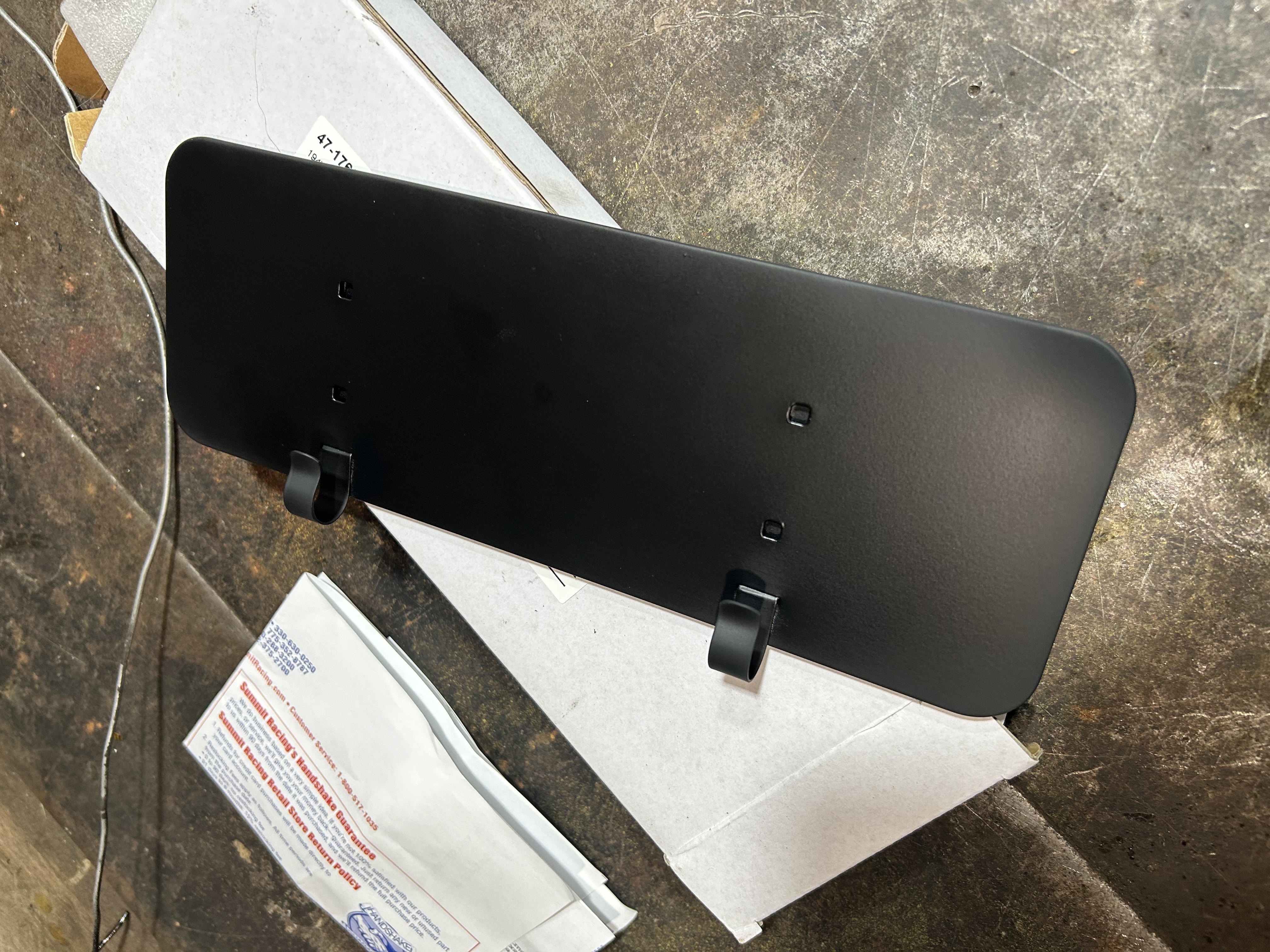

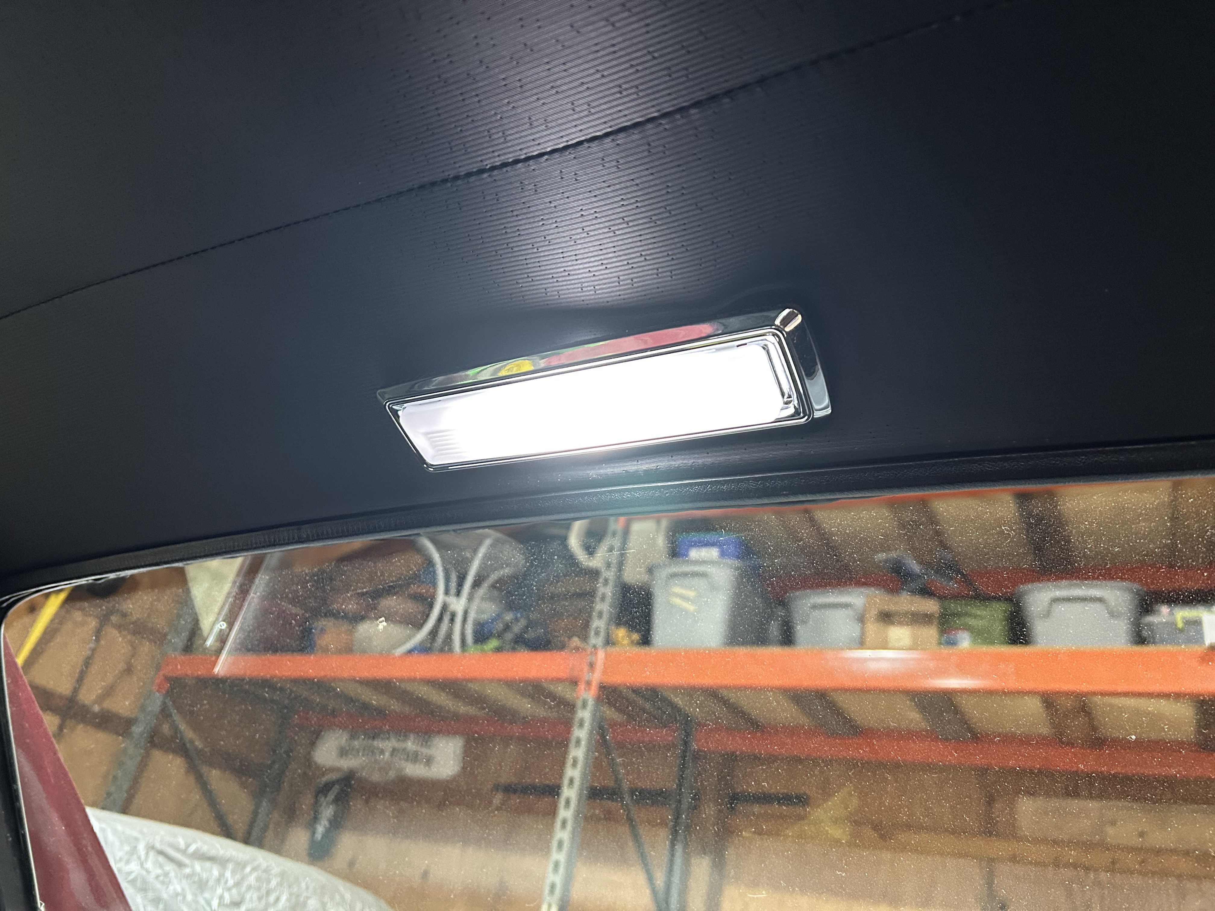

Vanity Mirror
Fred32V and Mom hooked me up with a vanity mirror for a birthday gift. I had him order a mirror for an older Chevy truck and I custom modified it so it fit the needs of the El Camino. It came new in tan color, and I used Sem Landau Black interior spray to make it satin black to match the cab. It turned out sweet!
