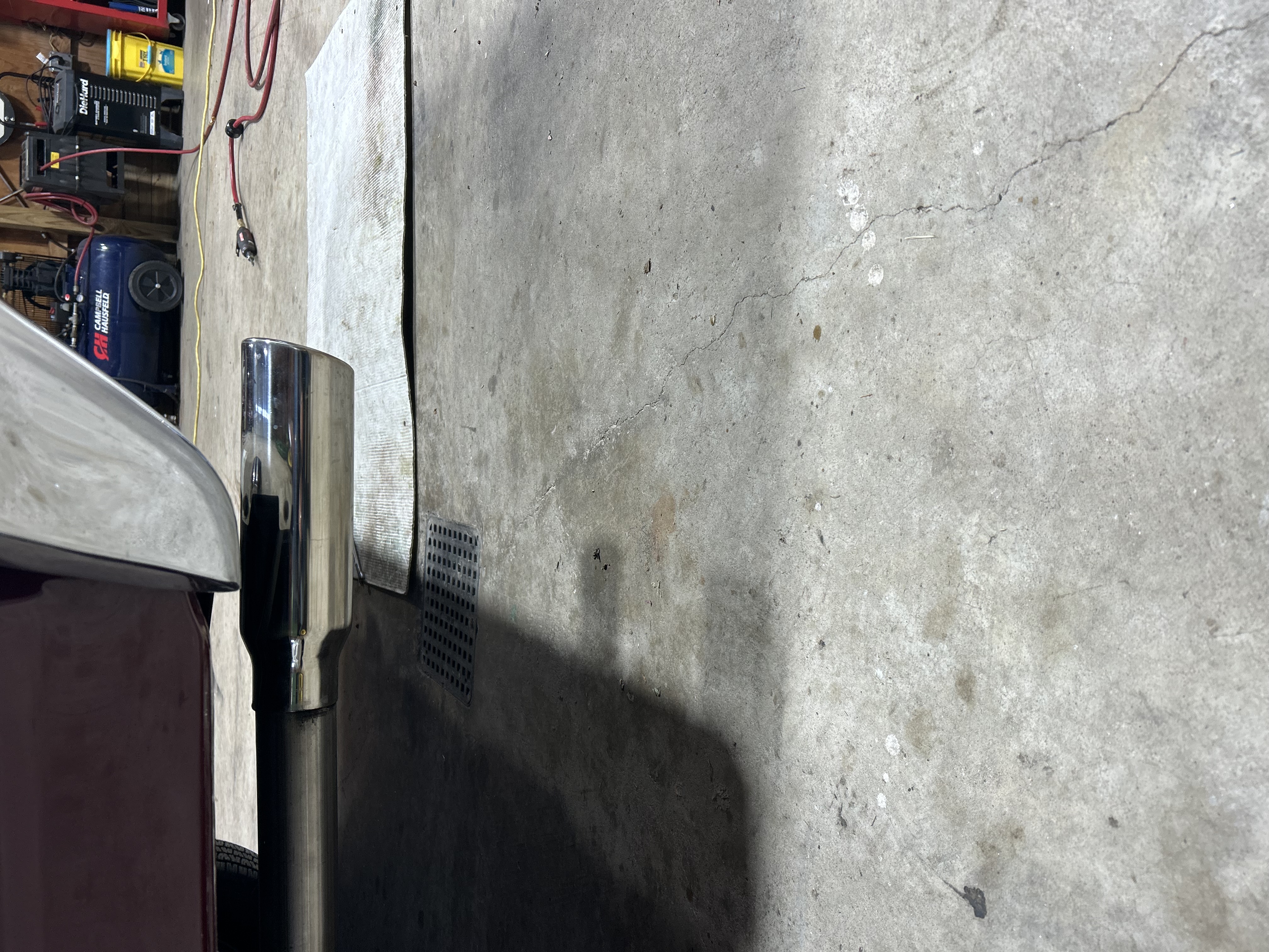

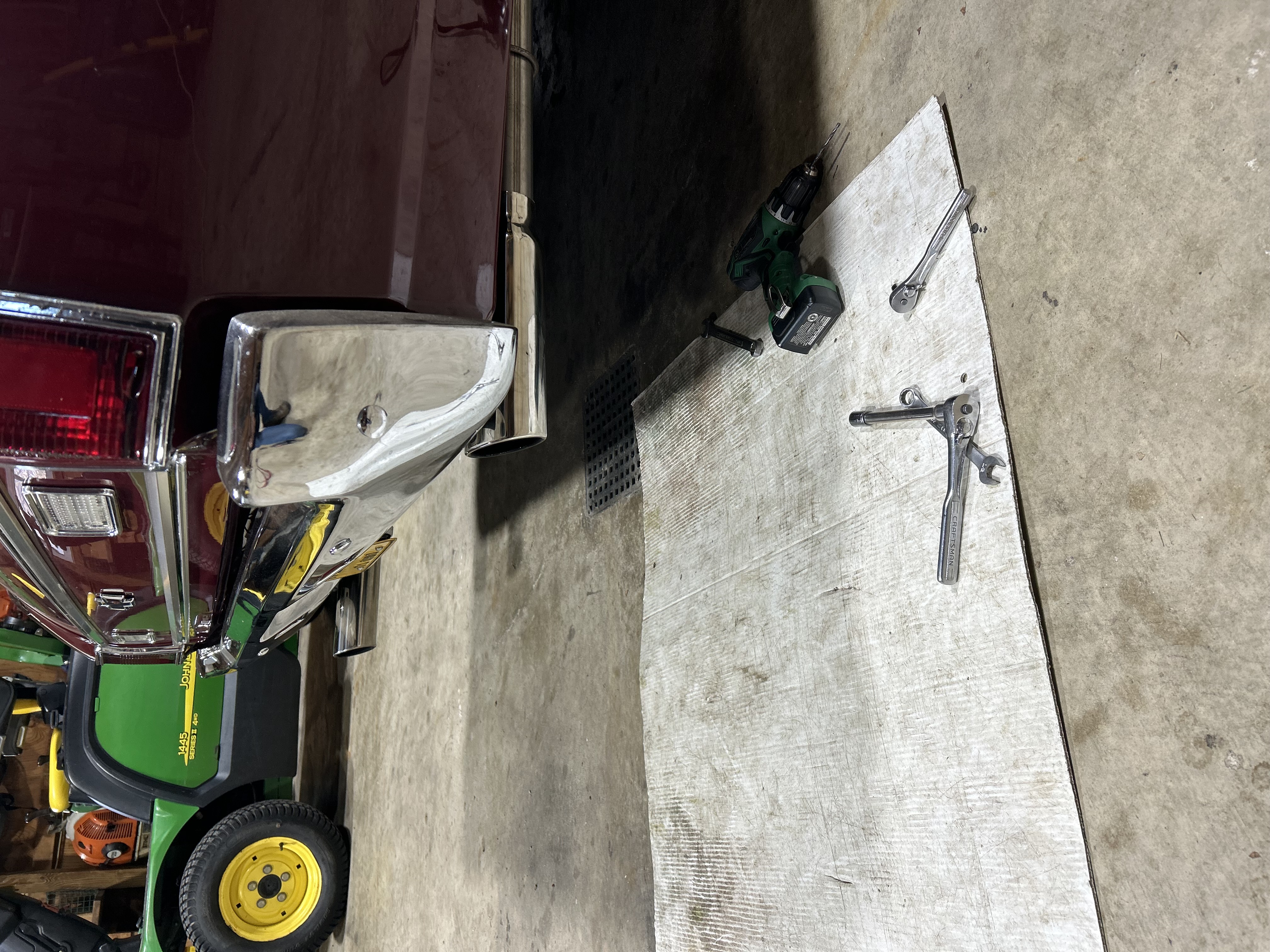

This weekend, I took to assessing what I have and working on easy and required fixes. The first was the glove box door. It seems like a minimal issue, but you had to slam the glovebox door to get it closed. The latch mechanism was loose on the door. About an hour later the door works. I had to remove the door all the way and get the lock barrel out to accomplish the task. YouTube was my friend for this. I also repaired the hood latch. Literally, you couldn’t get into the engine compartment without using a screwdriver to jimmy the latch to open it. Turns out a couple of screws were stripped out and the bracket was bent keeping the latch from being able to fully engage the lever to open the hood. All fixed up… I also did a bit of exhaust work. The chrome tips were sticking out about 4” past the end of the bumper. I have them now tucked up tight to the bumper and only 3/4” sticking out past the bumper. I also washed off about an inch of dust off the car and test fit my car cover. Plenty to still do and I’m starting to make a laundry list of the things required before we hit the road in the spring.
Before exhaust tip
Before exhaust tip
After exhaust tip
After exhaust tip

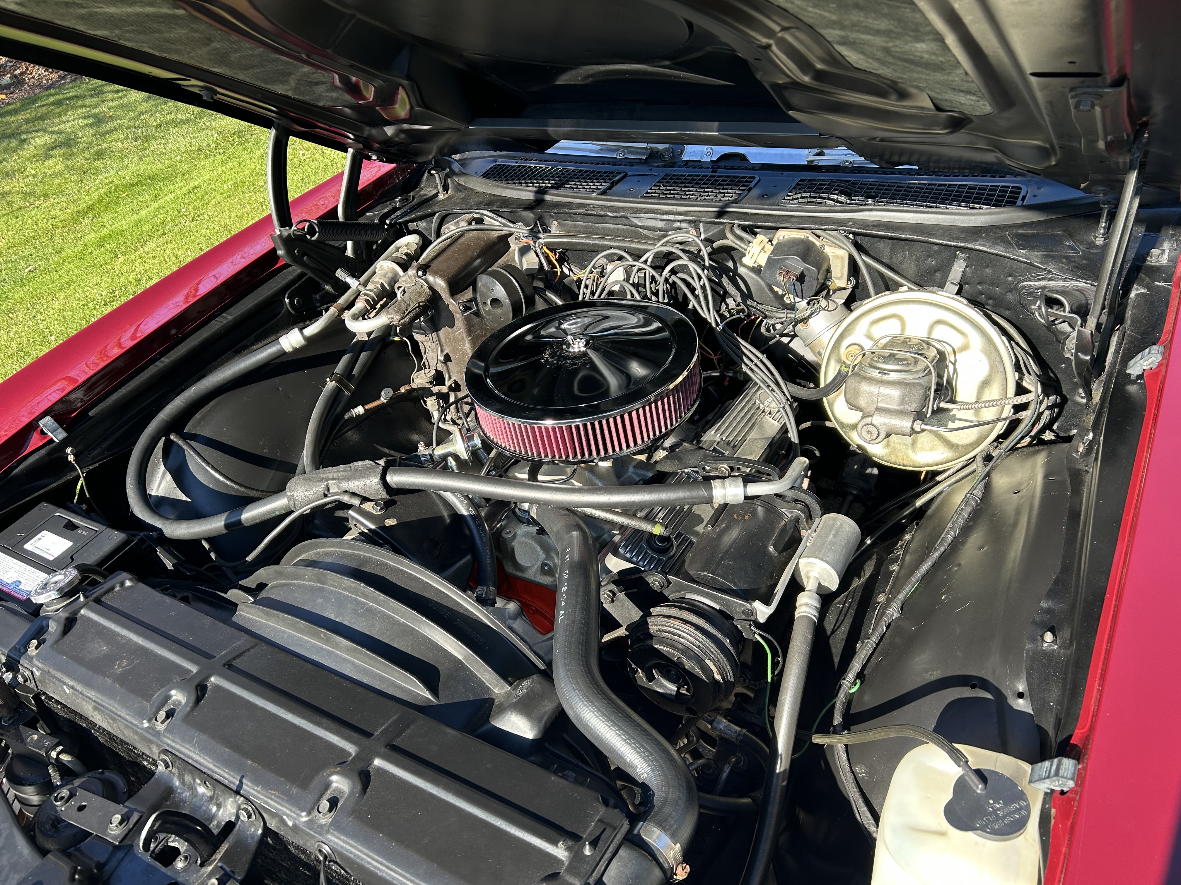

OK… From what I know now ( sometime in the future I get more detailed )
the El Camino has the original 350 motor and turbo 350 trans. It has a 12 bolt,
non-posi rear axle ( unknown gear ratio, but assumed highway gears based on
the mph achieved on the ride home ), power steering, power brakes ( discs on front ),
functional A/C, clutch fan & quadra-jet carb. The car is largely stock, which is what
I wanted. It has a better than stock cam ( spec sheet came with the car ) and roller
rockers, but goes through cast manifolds for stock look. From the initial ride home,
I know it can easily smoke the right rear, but I also know the car isn’t achieving
WOT, so that needs to be fixed. I’m still in the “assessing what I have” stage,
and I’ve gone around the car three or four times searching for issues to fix and
I’m starting to make a to do list. The good thing is, the majority of what the car
needs is detail work and smaller projects so there shouldn’t be any huge projects
on the horizon for it. We’ll see if this holds true!

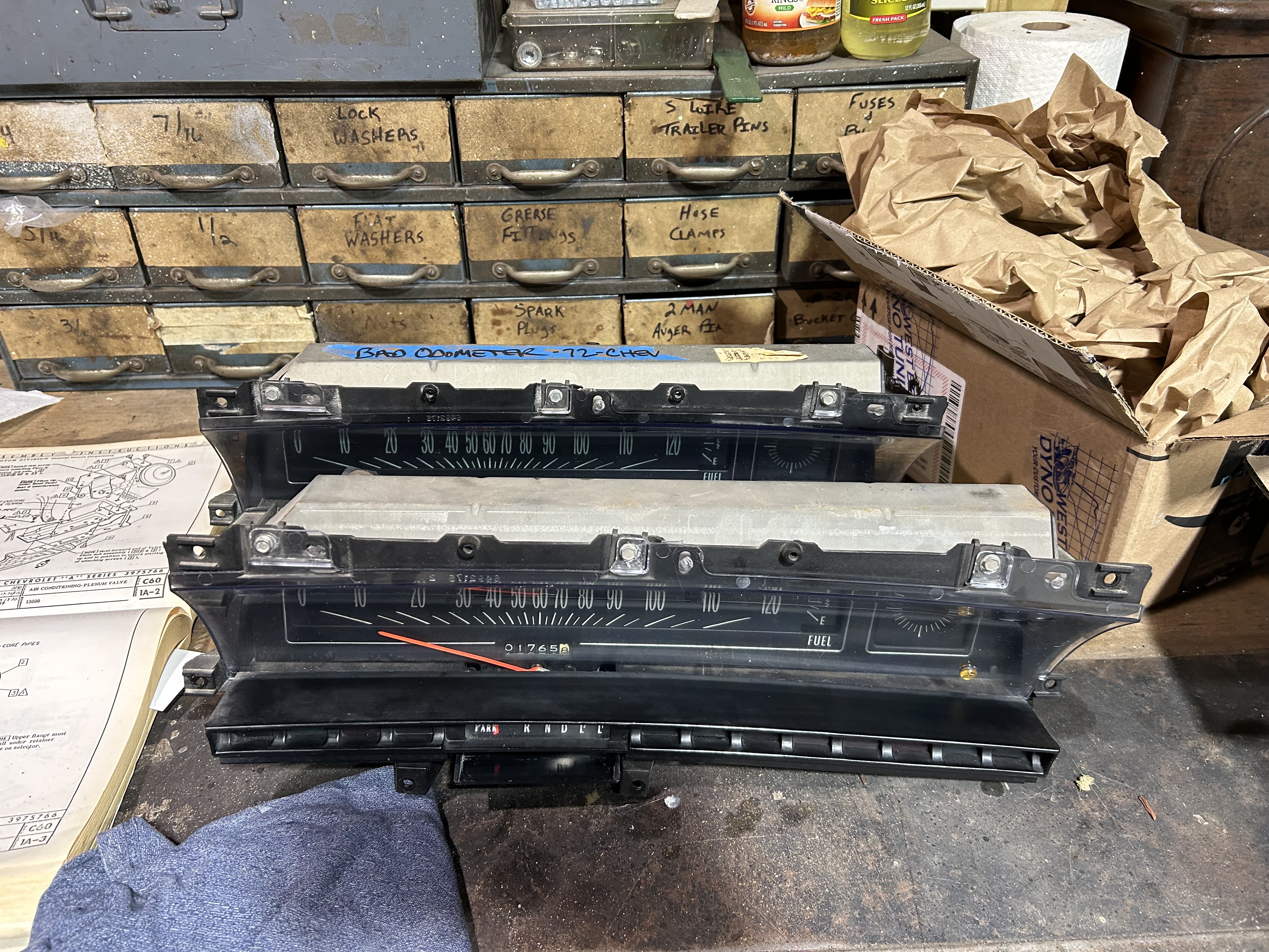

7) remove speedometer cluster and repair with used speedo cluster found on FB Marketplace. ( issue with speedo was loose change has found it’s way into the cluster — no idea how this could’ve happened - change jammed mechanism up and stripped the odometer gears )

Completed speedo & donor unit
Disassembled
Disassembled
Disassembled
Disassembled
Odometers pre-work
Odometers pre-work
Loose Change in Speedo

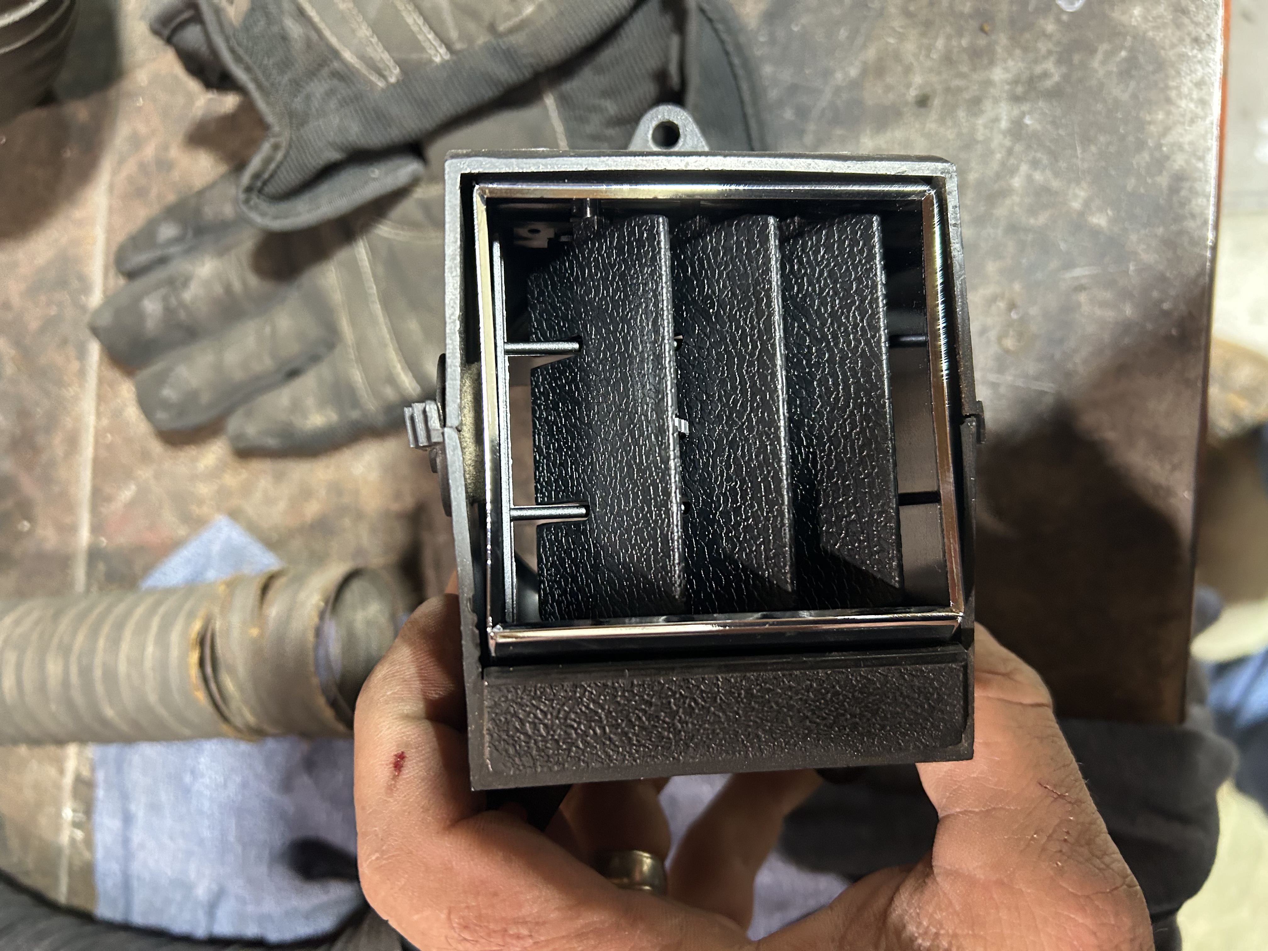

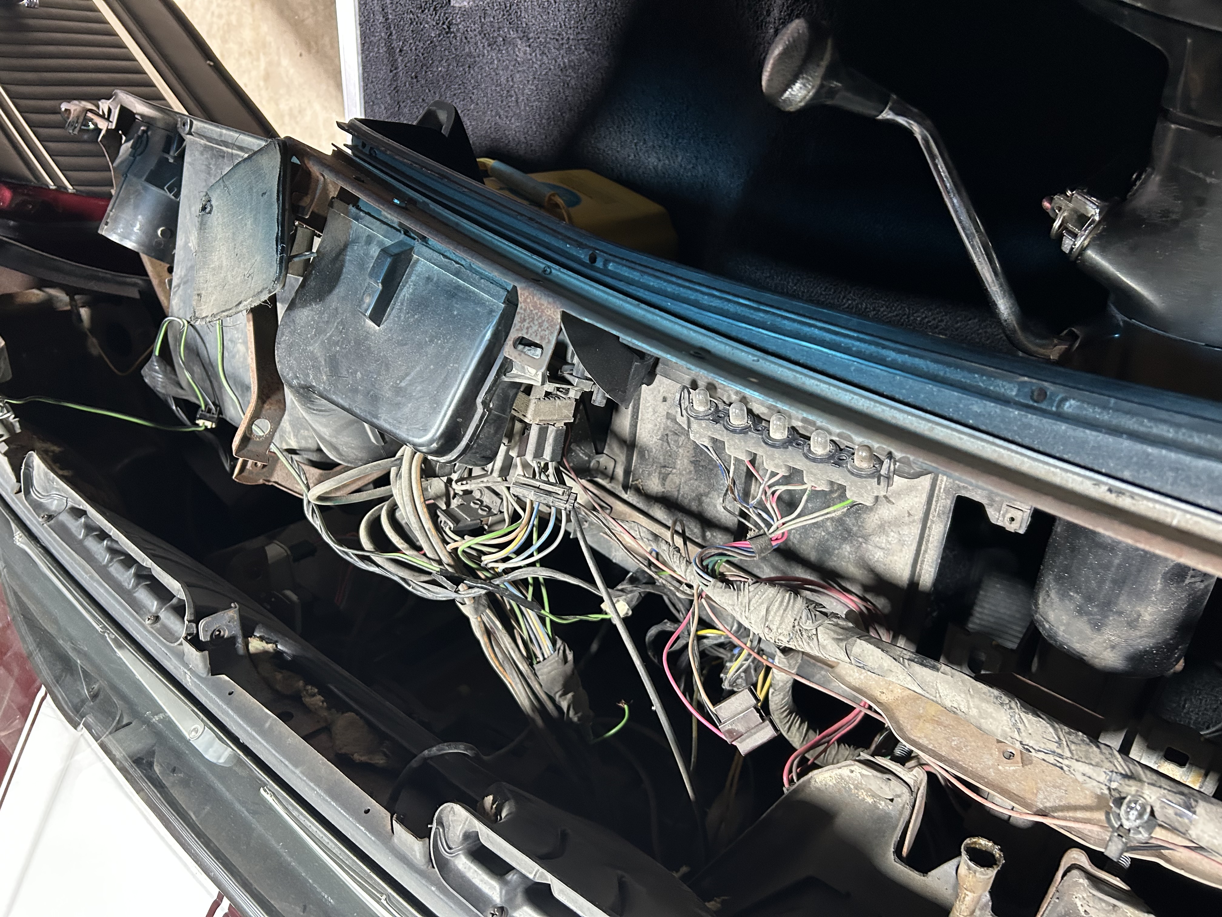

I felt pretty positive about yesterday’s work. I started the day by blowing out and vacuuming more sand from behind the dash. This finished it off and I’m pretty pleased with the outcome. There might be some sand left behind the dash, but very little. ( I’m thinking of naming this car “Sandy”) With the dust settling, I got to changing the vent louvres on the left and right of the dash. That job was pretty painless. The only hiccup came with the re-pop vents. There’s a small felt disc on the end of them that fits in the vent housing and keeps them centered. The new ones were too small and allowed the vents to wobble in the housing. The old vents had good felts on them, so I superglued them to the new assemblies and I was on my way. I then took to finding the annoying vacuum leak and no heat situation. To make an extremely long story short (about 2 hours of chasing vacuum hoses), the previous owner had plugged a vacuum supply line and left it on the motor. This line was to go to the vacuum canister on the firewall. The heater control valve hose was plugged into the vacuum canister and the heater control valve had a vacuum hose coming directly off of the carb. Basically, someone didn’t label the hoses and reassembled them incorrectly. Being in the garage with the door closed, I didn’t run the car to get it to feel heat, but I was able to watch the a/c vent door move as I moved the lever and the leak sound is gone. I moved forward after this. I got the speedo back in and, reassembled the duct work. All of the duct work was blown out with the air hose and wiped with rags as far in as my hand could go. All dash lights now work correctly and all go the switches were lightly lubed and blown out as well. ( 6 hours worked ) For reference, here is the schematic I found on the internet to help me diagnose my issues: http://thepartguy.com/diagrams_chevelle.htm
And the link to the 1971: http://thepartguy.com/diagrams/chevelle ... agrams.pdf
Old vent
Old vent
Vent part number
Vent part number
Rebuilt vent
Rebuilt vent
