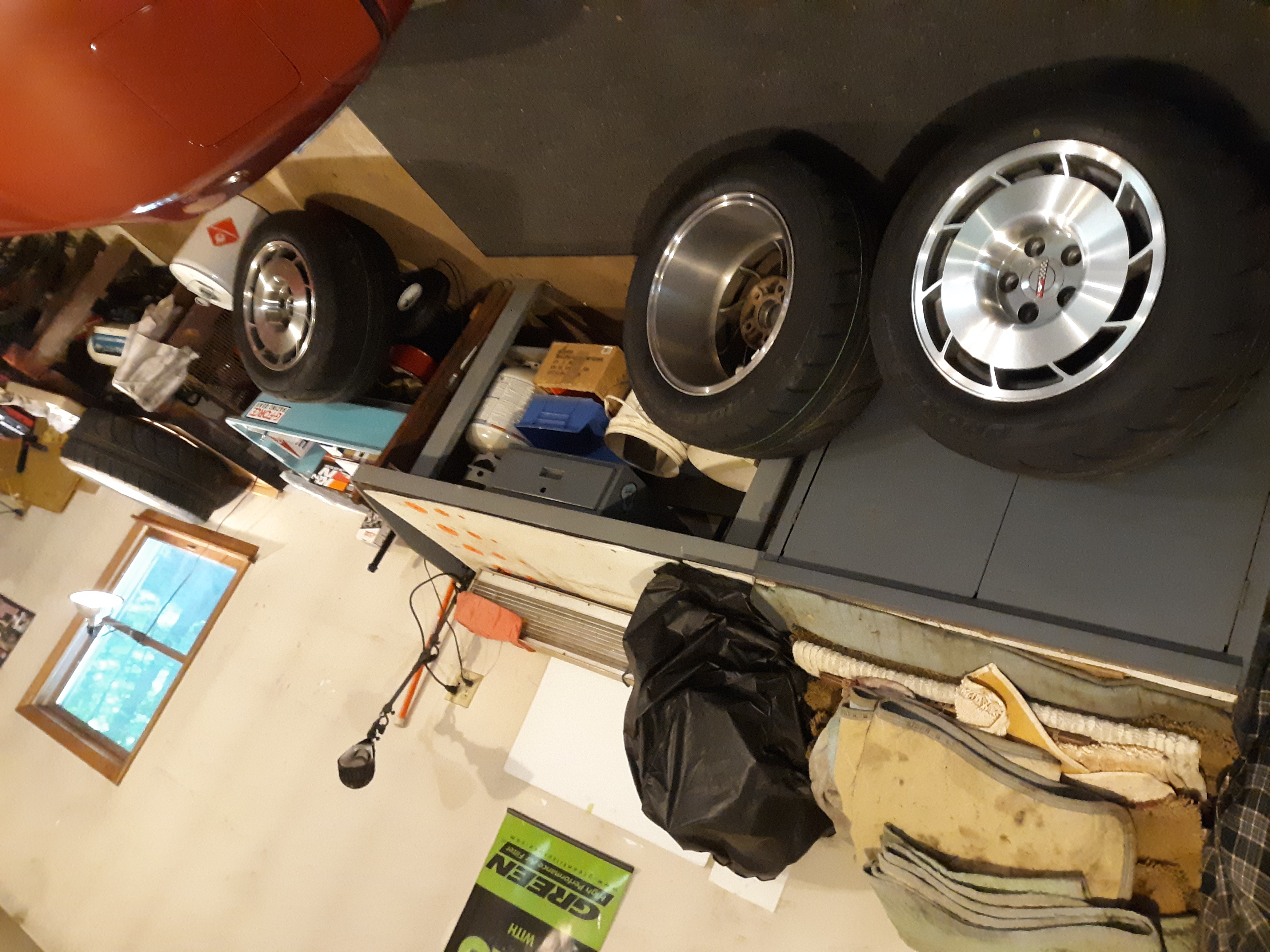

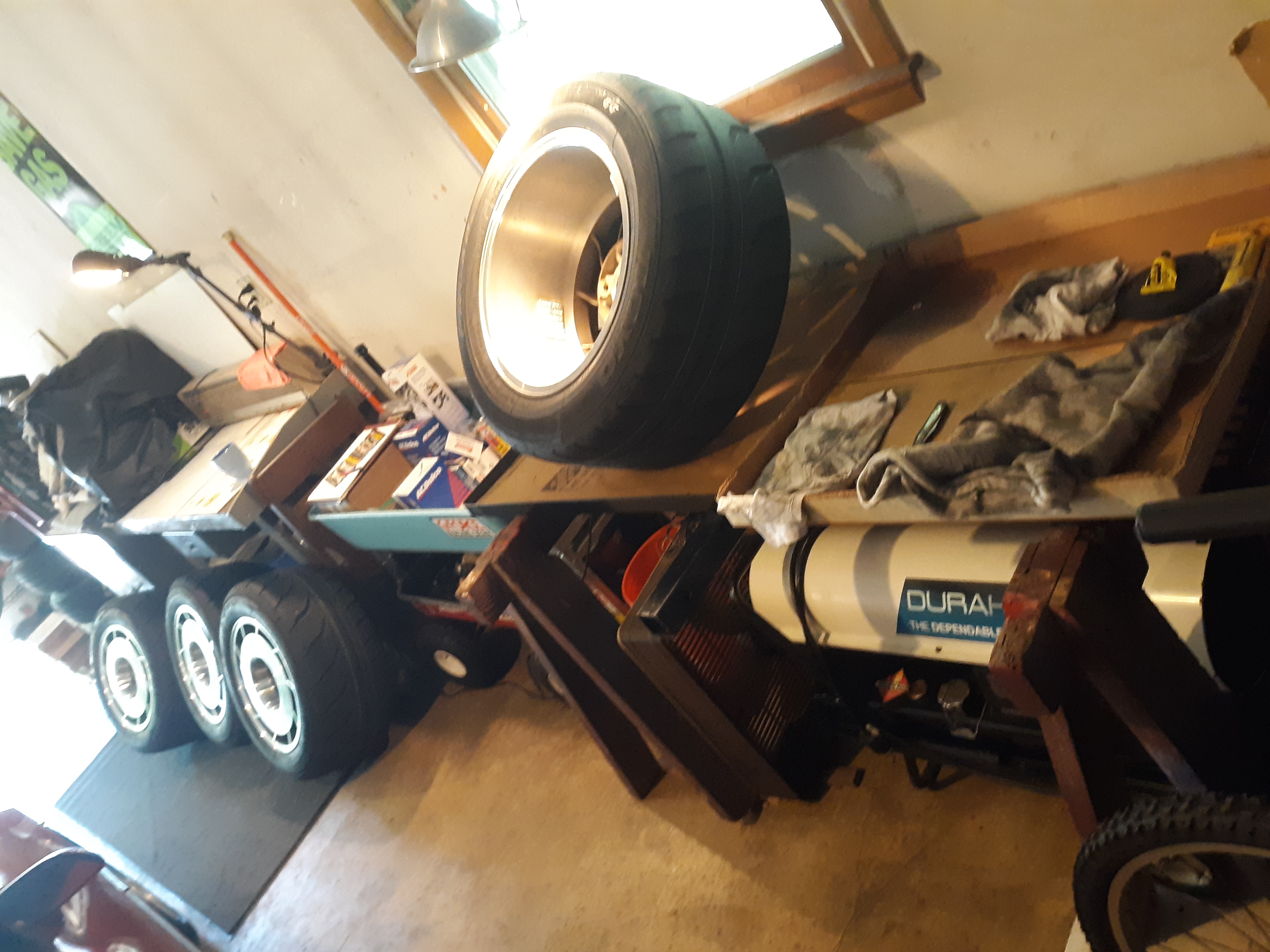

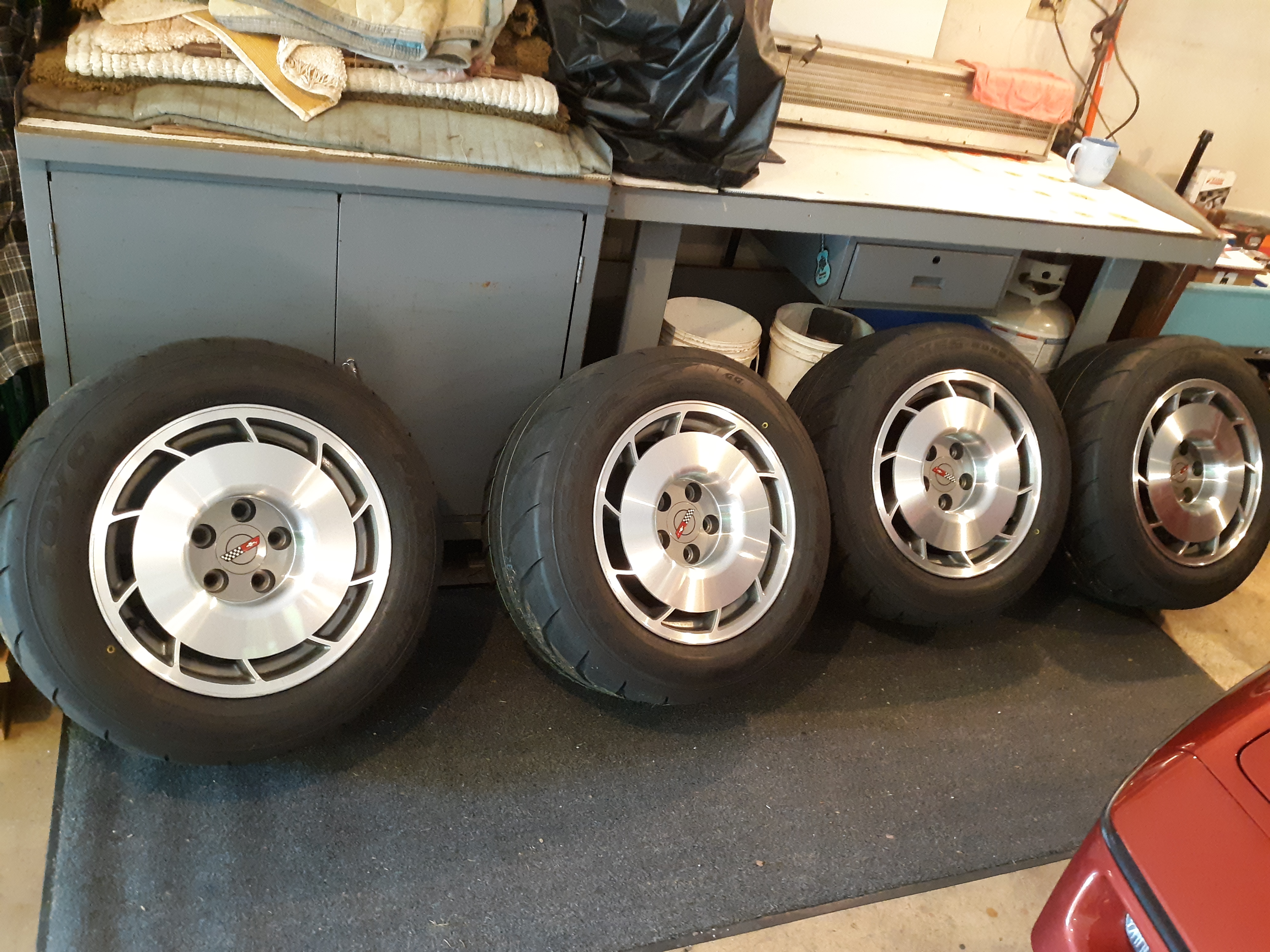

In the meantime, BP suggested that the new wheels could be cleaned up.
I spent time better organizing the 32V Garage creating places to set things
for when we really begin to take the C4 apart.

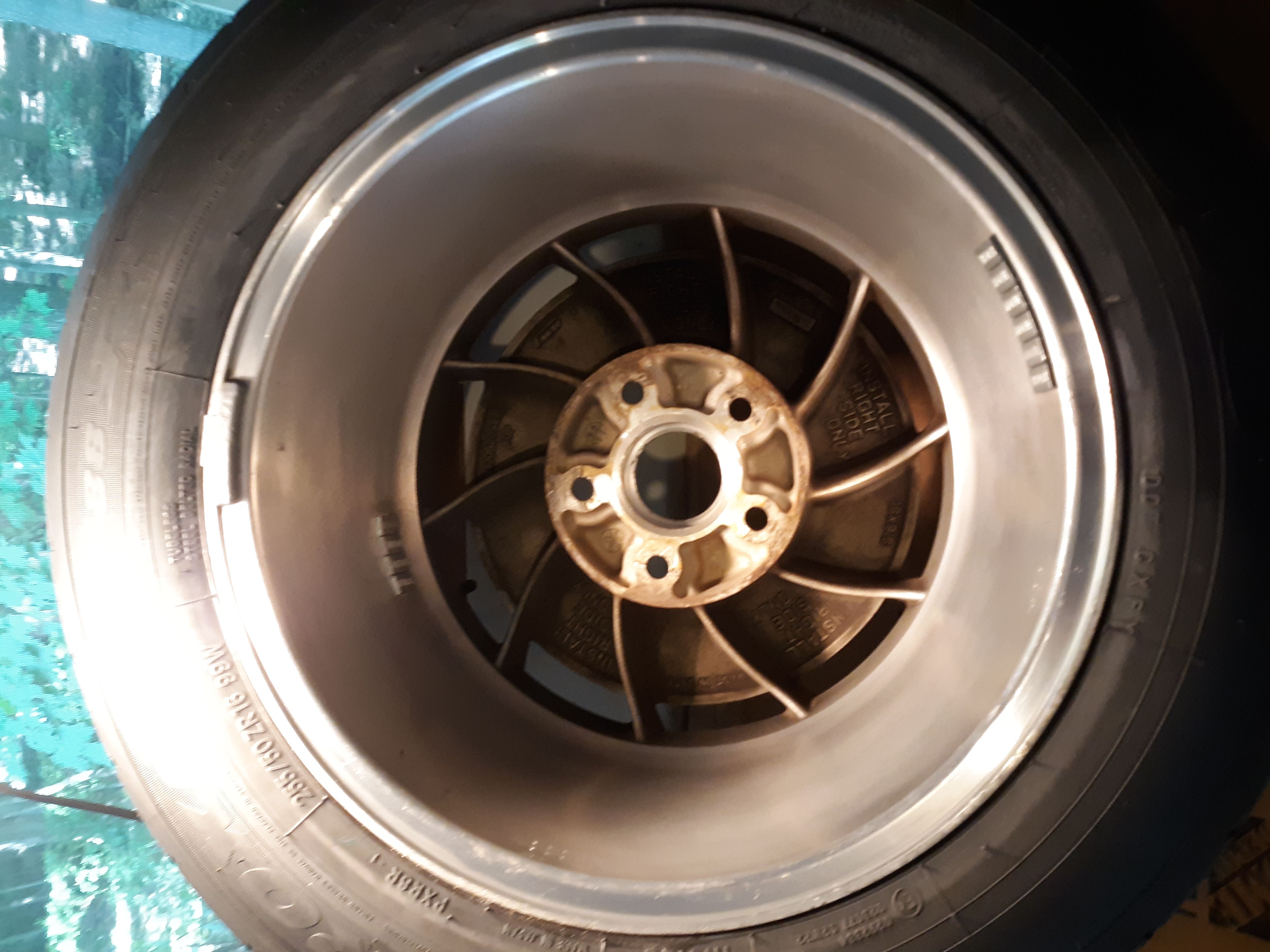

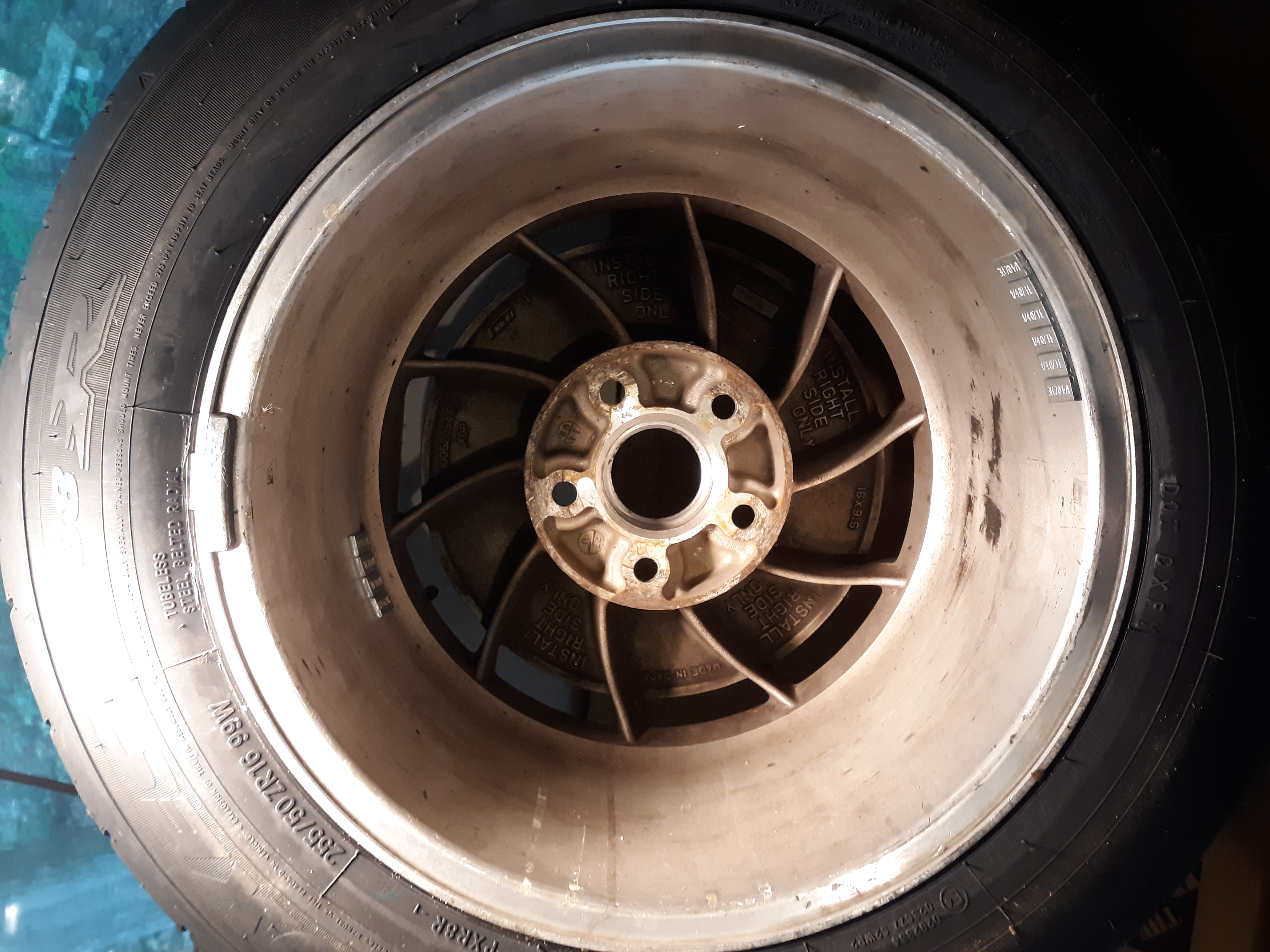

In the meantime I did take some time to polish our newly acquired wheels. I was surprised to see an old weight on that last wheel with new weight on the opposite side,
wish I would have noticed that before I gave them that wheel so I could have removed it.
The wheels were pretty rewarding, they came out looking really nice considering how old they are.
At my old consulting rate of $200/hr. this was a $1,000 polishing effort, worth every penny!

Re: 1987 Corvette Z52
If that wheel balancing was done at Newbury Tire I would take it back and get it rebalanced. Someone might learn something about balancing a tire

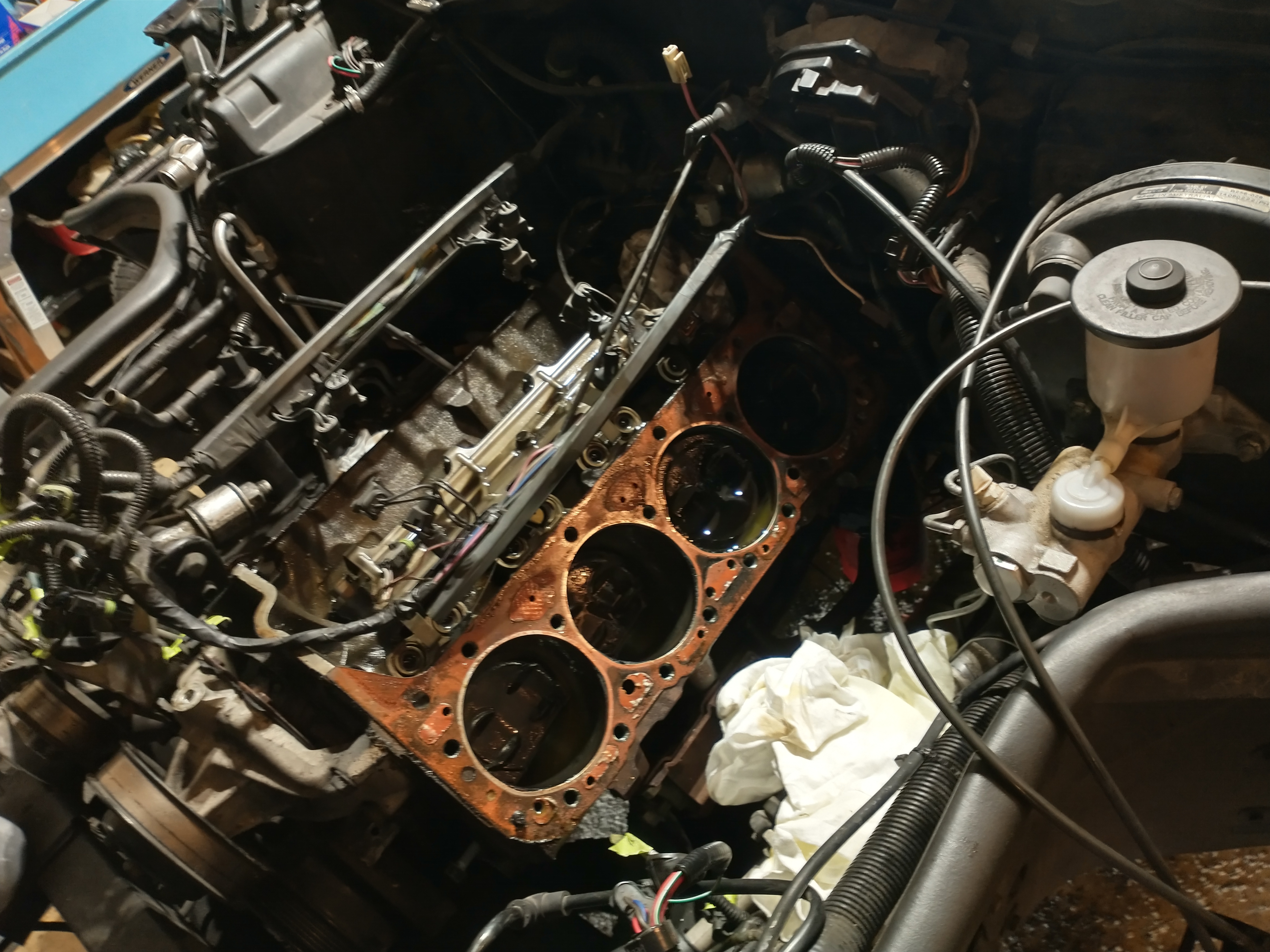

- Posts: 3682

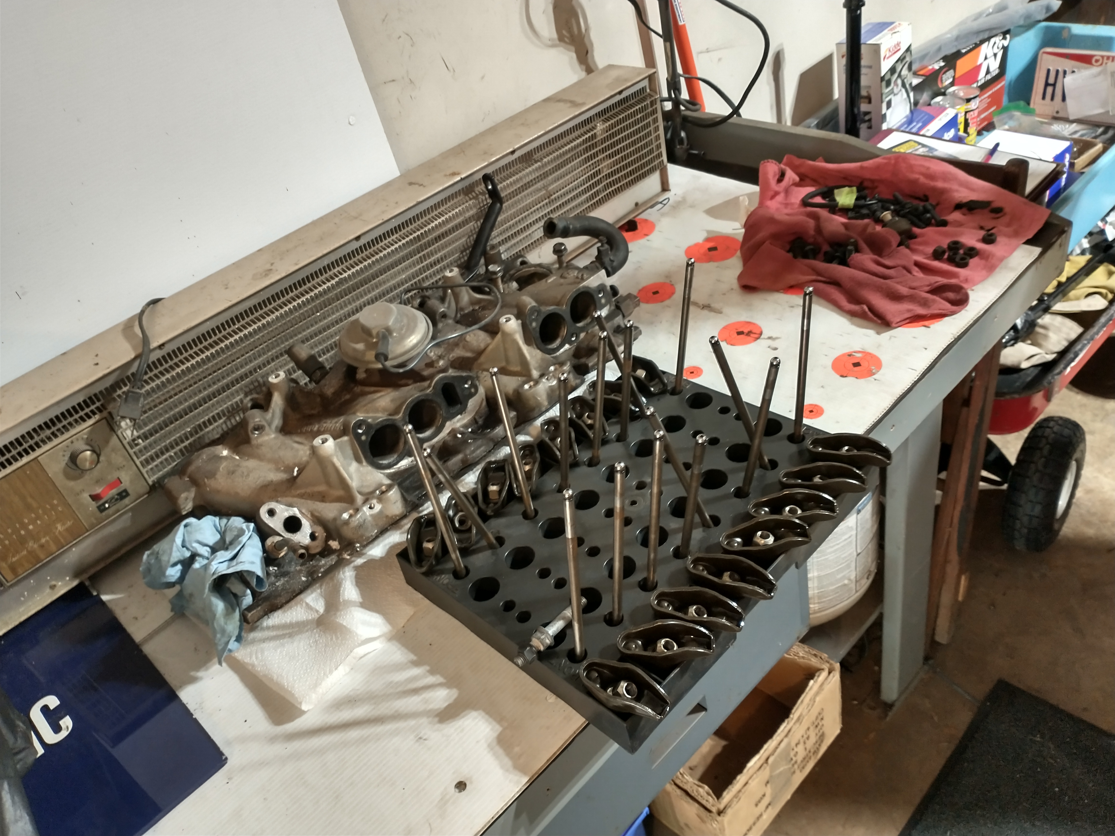

Over two Saturdays we were able to get the cylinder heads off. No major surprises here. I didn't see any smoking gun in the driver's side head gasket, but it didn't come out in one piece, so it was hard to tell. The valves in number 8 looked a little lean and clean though, so I suspect some coolant was in there.
So now I'll find a place to straighten up the heads and do a multi angle grind and just give them a once over.
The manifolds need welded up where the emissions tubes were, and since none of the emissions stuff is going back on... There's lots of clean up work to do too. We also need to order a bracket to replace the smog pump. I also plan to pull the front y pipe and make sure the two existing catalytic converters are gutted.

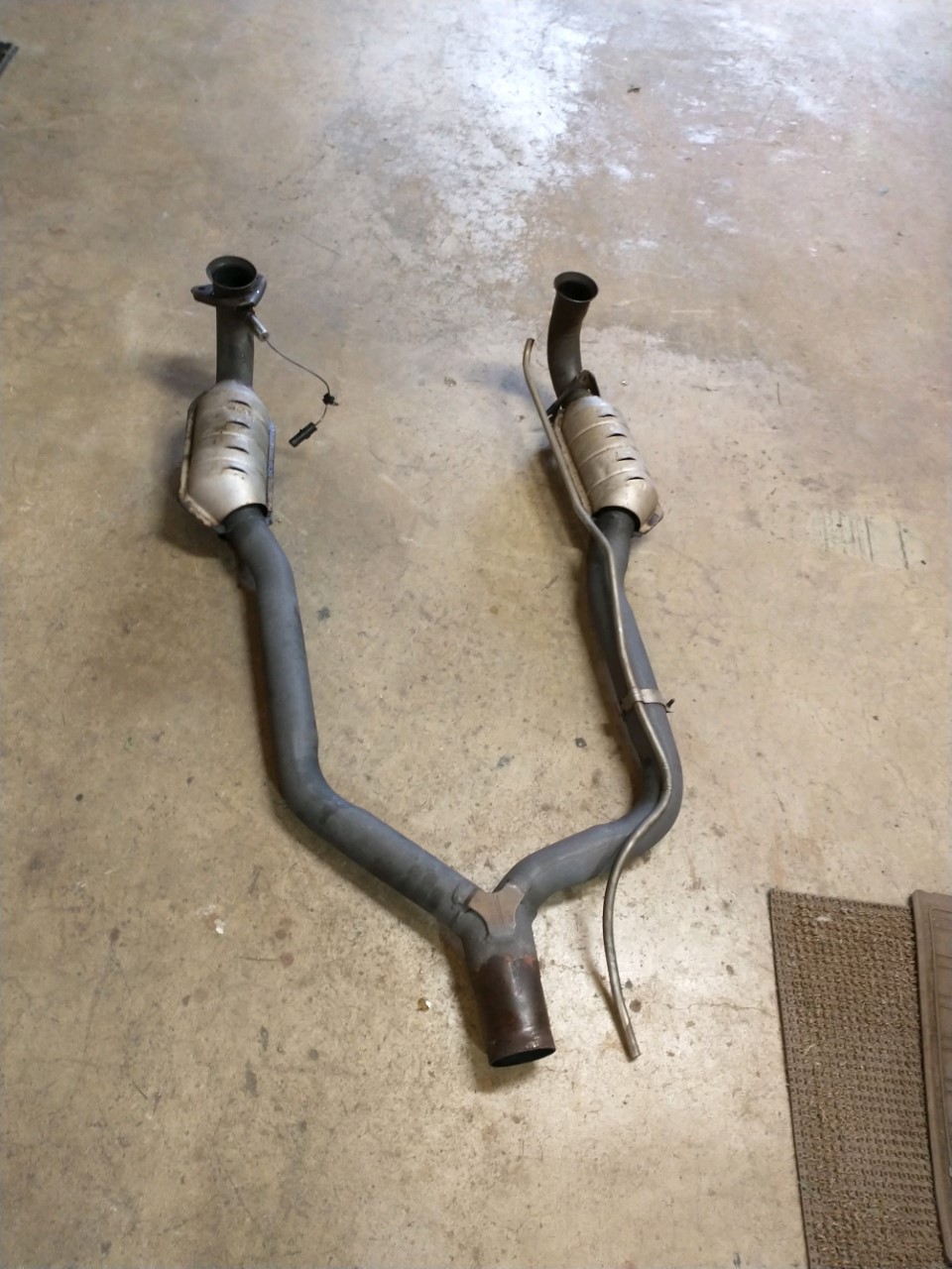

Today I went over and took the Y-Pipe off the Vette. Like I figured, I had to peel back the pipe it was slid into so I could wiggle and twist and spray my way out of it. I plan to get a band clamp to go over it all, so it should be fine. I removed it so I could bring it home and gut the converters. This will require a cut and re-weld, and my welder is here. Plus I have to do the welding on the exhaust manifolds anyway, so I can do it all at once. I also need to order a new 02 sensor since I'm staring right at it and there's only one on this car.

FWIW the pre-cats were gutted on mine with no evidence of welding. If you have not done so already be sure to put a coat hanger or something in there to confirm those cats are still in there
- Posts: 3682
We'll do. With the main cat missing, that's a possibility. The pipe is relatively heavy though, so we'll see tomorrow.
