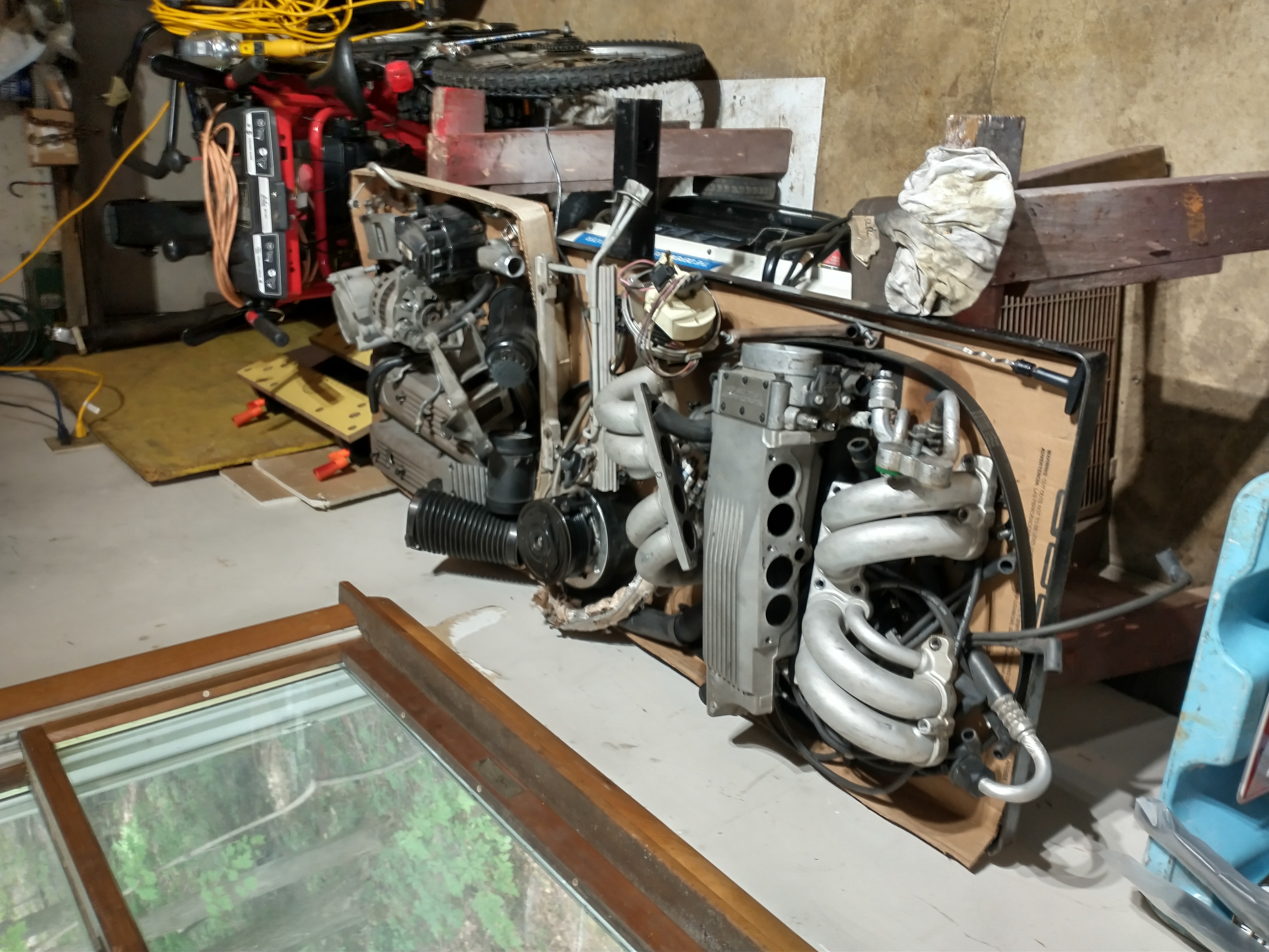

Over two Saturdays we were able to get the cylinder heads off. No major surprises here. I didn't see any smoking gun in the driver's side head gasket, but it didn't come out in one piece, so it was hard to tell. The valves in number 8 looked a little lean and clean though, so I suspect some coolant was in there.
So now I'll find a place to straighten up the heads and do a multi angle grind and just give them a once over.
The manifolds need welded up where the emissions tubes were, and since none of the emissions stuff is going back on... There's lots of clean up work to do too. We also need to order a bracket to replace the smog pump. I also plan to pull the front y pipe and make sure the two existing catalytic converters are gutted.
More to come...
