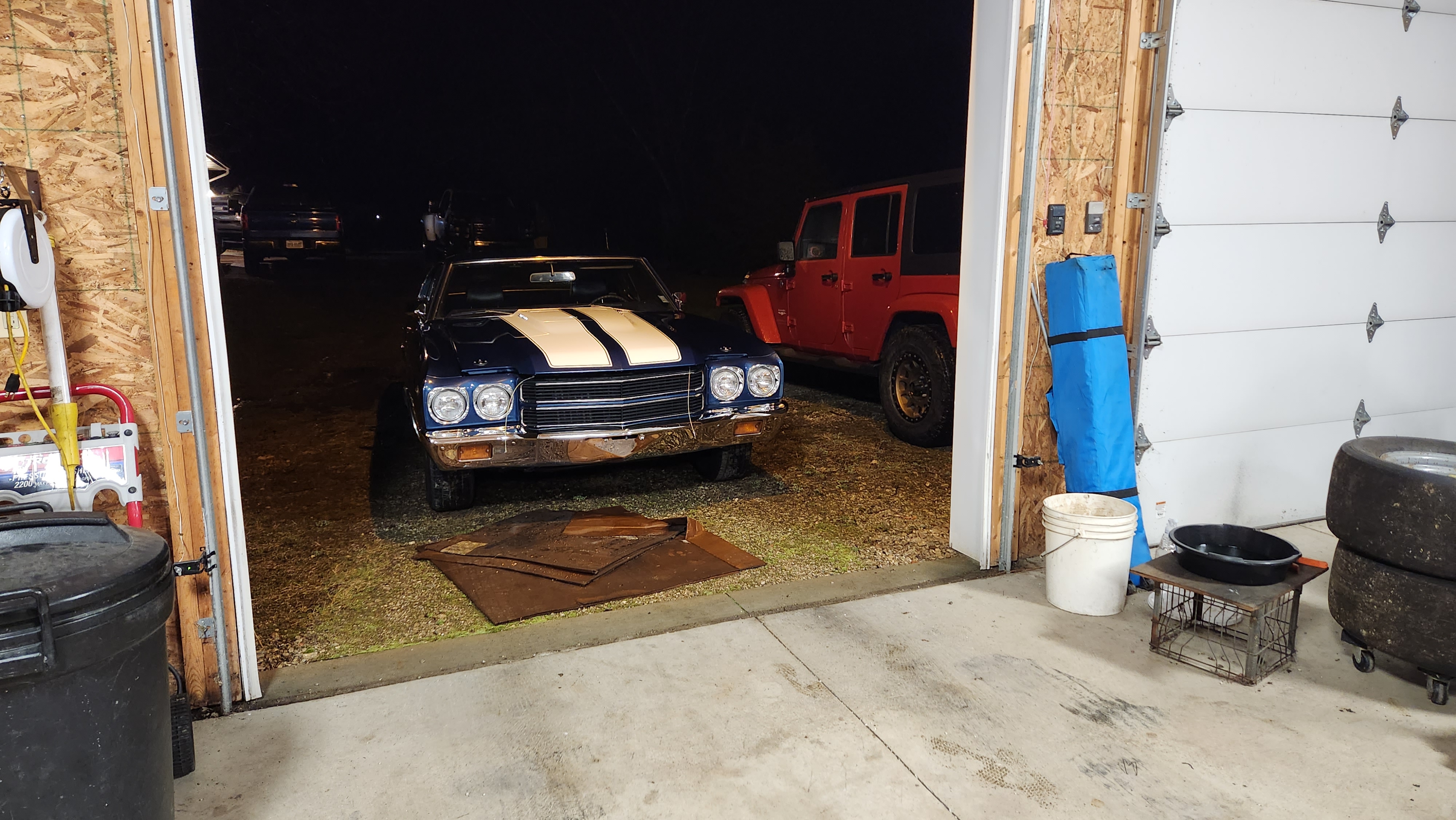

It runs! Friday night, I went out in the garage and got busy. I replaced the GM factory flexplate wiith one of my new $10 expired-SFI flexplates from Summit. Used a set of new ARP flexplate bolts, torqued to 65 lb-ft. I was able to get Jerry's transmission jack again, and with the help of my friend Jered's son Charlie, we lifted the trans up on it. They held it secure while I installed the torque converter. Jerry's transmission jack really makes this job easy.
After that, it was just bolting it all together. Everything went back together very well. It was one of those satisfying times where the first time I started it, everything was right. I put it in gear, sorta ciringing/waiting to hear a noise, but there was none! I put it in reverse, gave it a little throttle, no noise. Put in in Drive. Throttle. No noise! woo hoo! It was 11:30pm, it was wet/drizzly out and such, so there would be no test drive, but I did move it up to the front garage. If you look at the front garage pic, you can see test results.. haha

The bottom picture reminds me of "It's a red car, Reverend"......
Is Jared wearing a Beastie Boys t-shirt?
