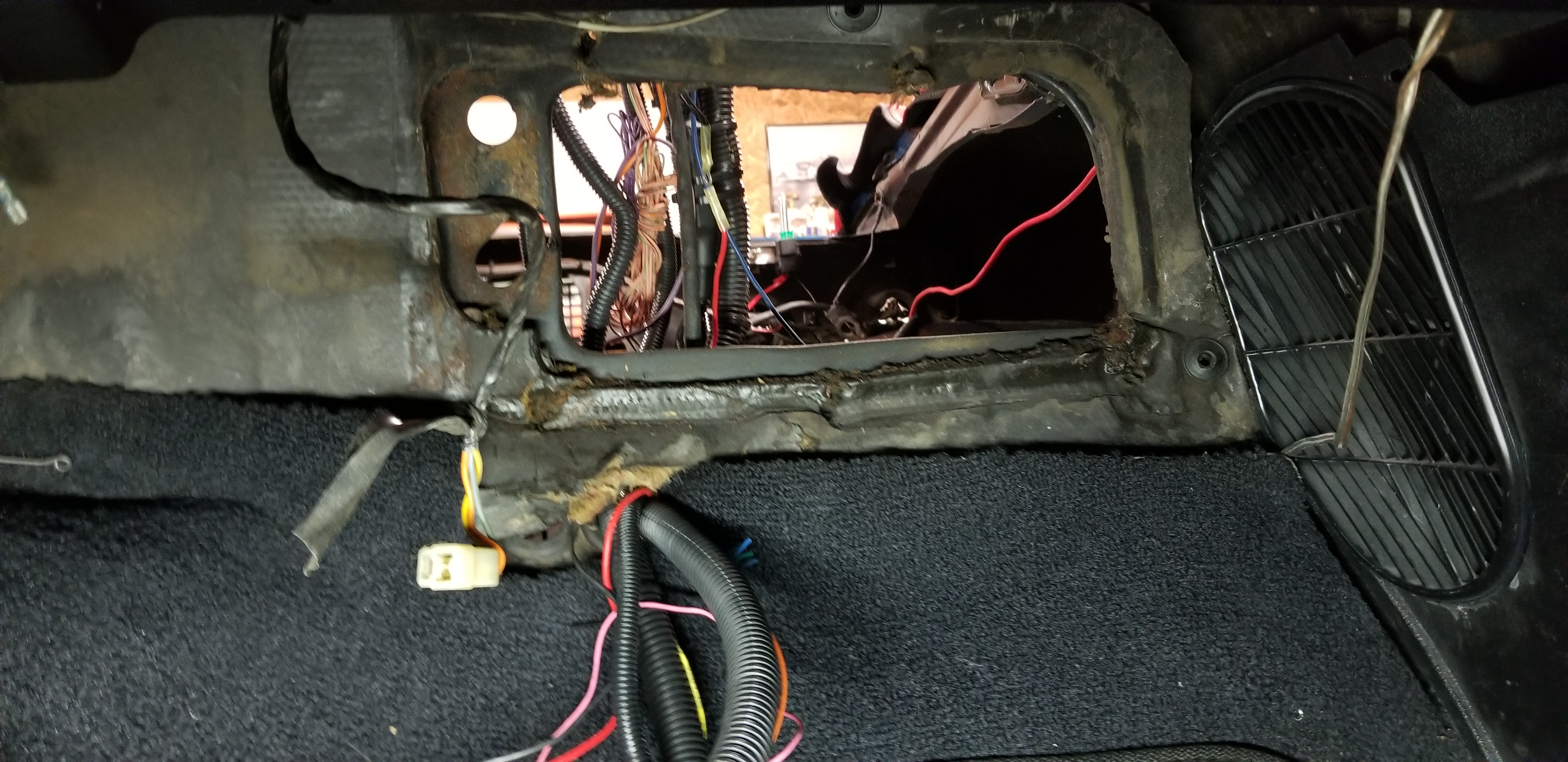

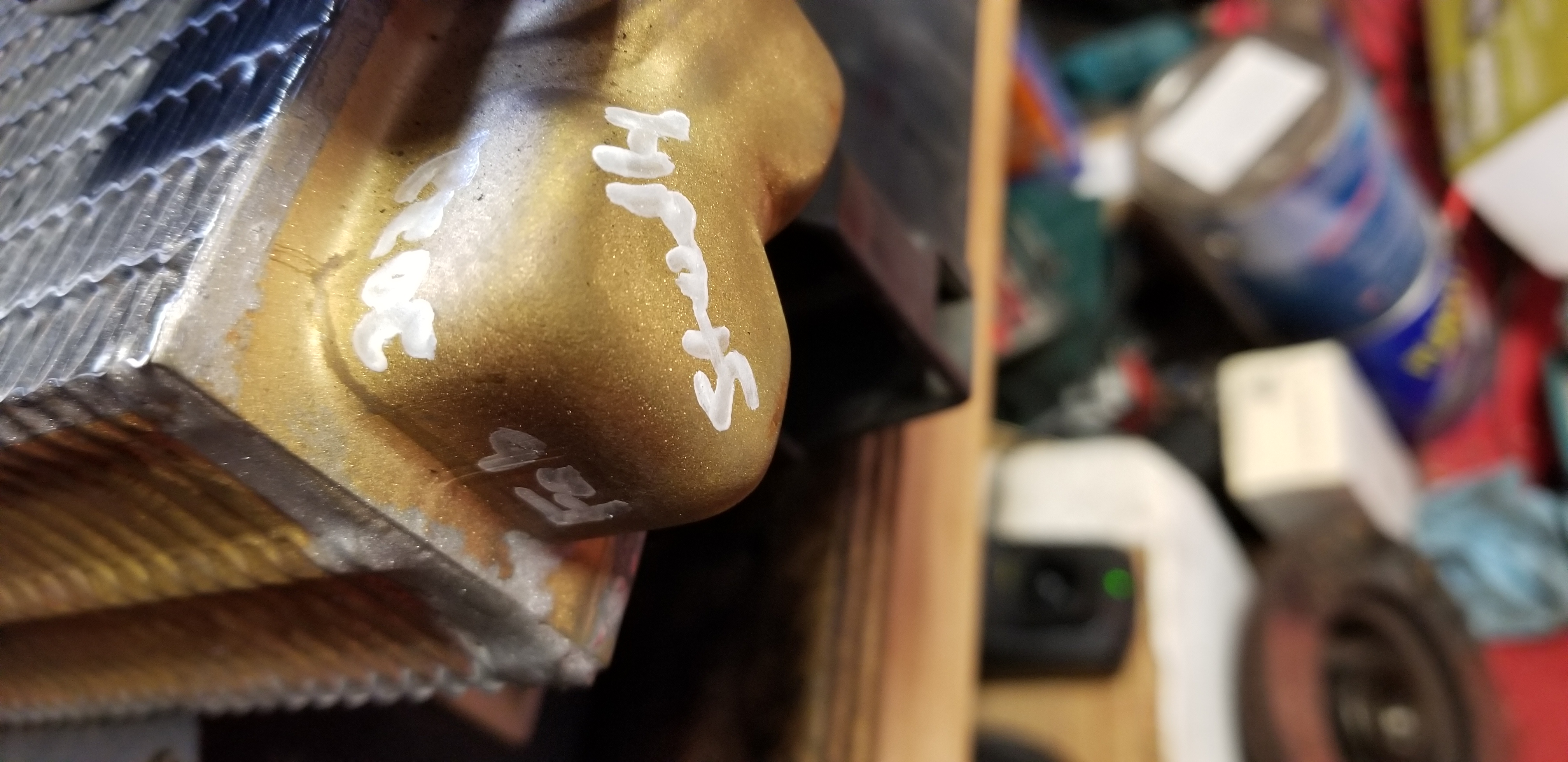

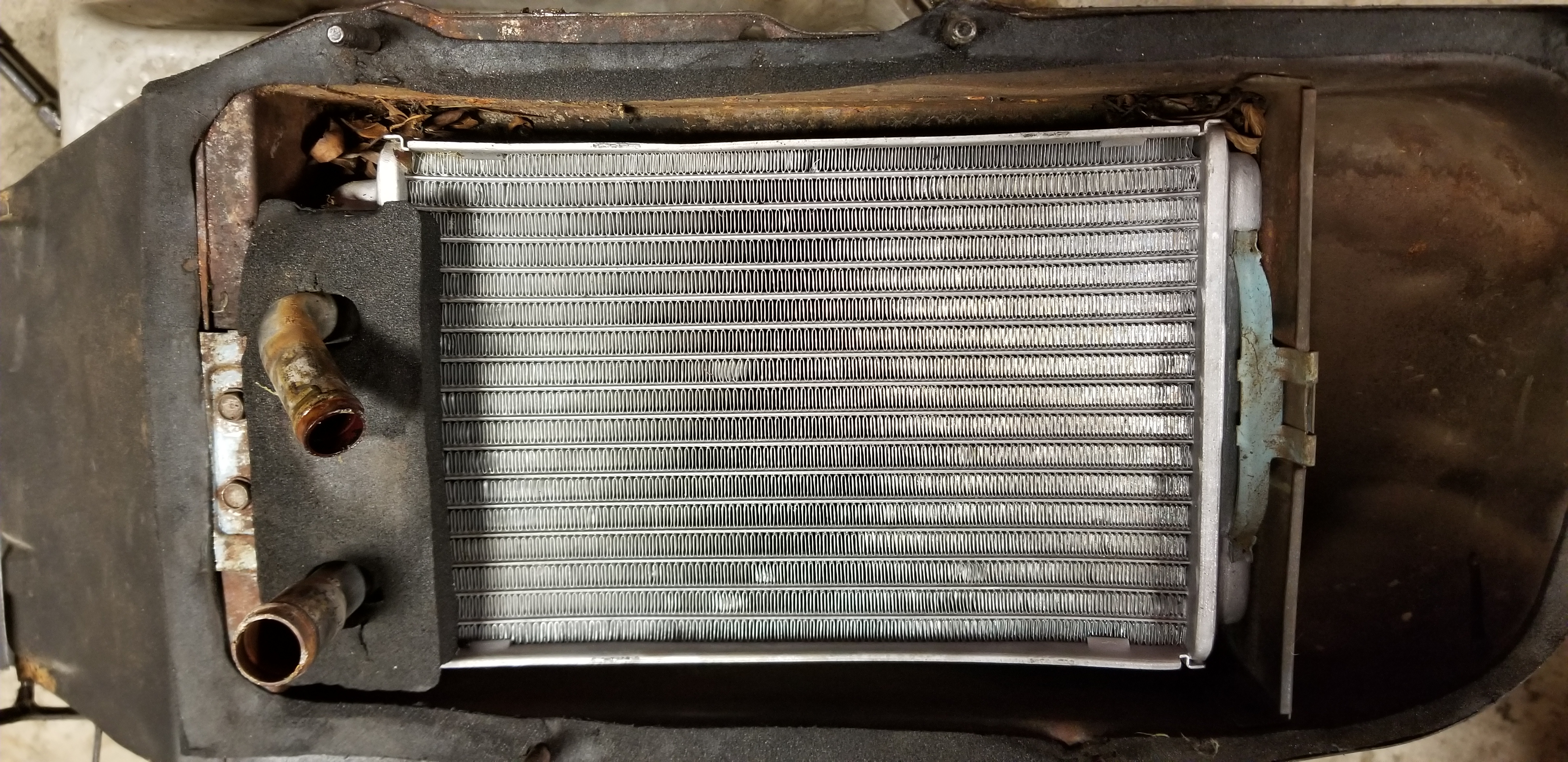

At the end of '21, the heater core started leaking. I un-plumbed it from the system and quickly realized how much it's needed. So tonight, for what I'm pretty sure is the third time in my ownership, I tore the heater box out. I've gotten increasingly efficient every time I do it.. :-) Pulling the inner fender makes it pretty painless. We'll see how it all goes back together. Tomorrow.

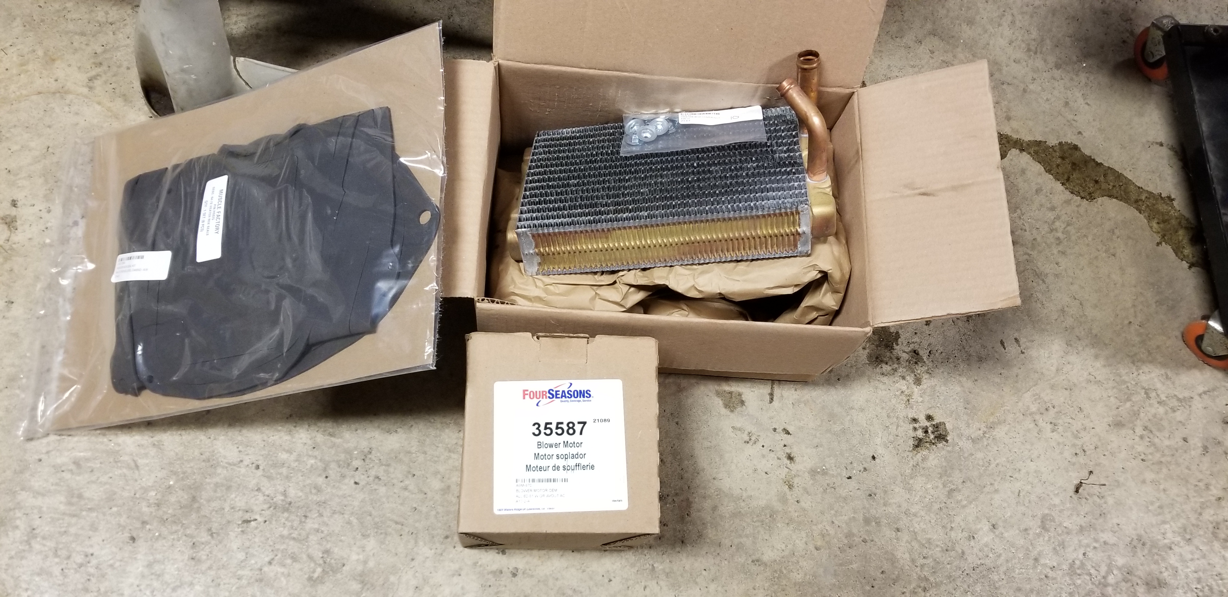

Got the heater box re-installed yesterday, along with the inner fender. I put in all new gaskets, including one which acts as damper on one of the vent doors that I'm sure I used to hear ting-ing around ever now and then. I repainted the box in the engine bay, but skipped repainting the heater box inside under the dash. That was too much of a make-work project for the moment. I also replaced the blower motor, just because the other one is 50 years old. With this side project complete, I can get back to putting the engine back in.

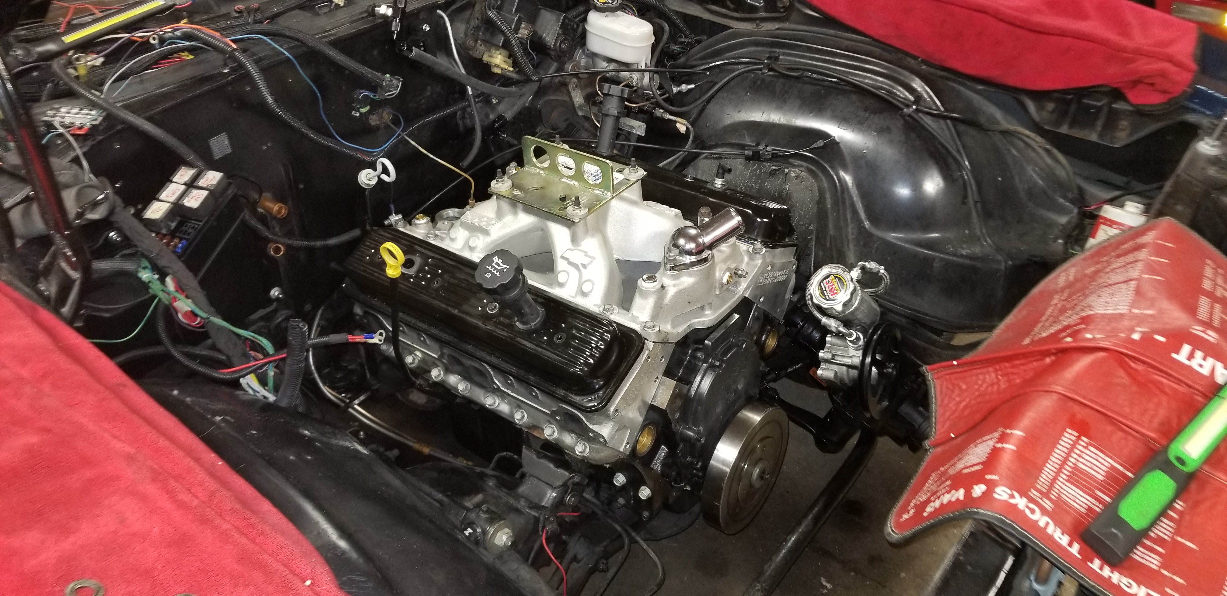

Tonight I got the ZZ383 set back into the engine bay. It took a little more goofing around than usual to get everything lined up, but it's in! Now I can pick at it all week

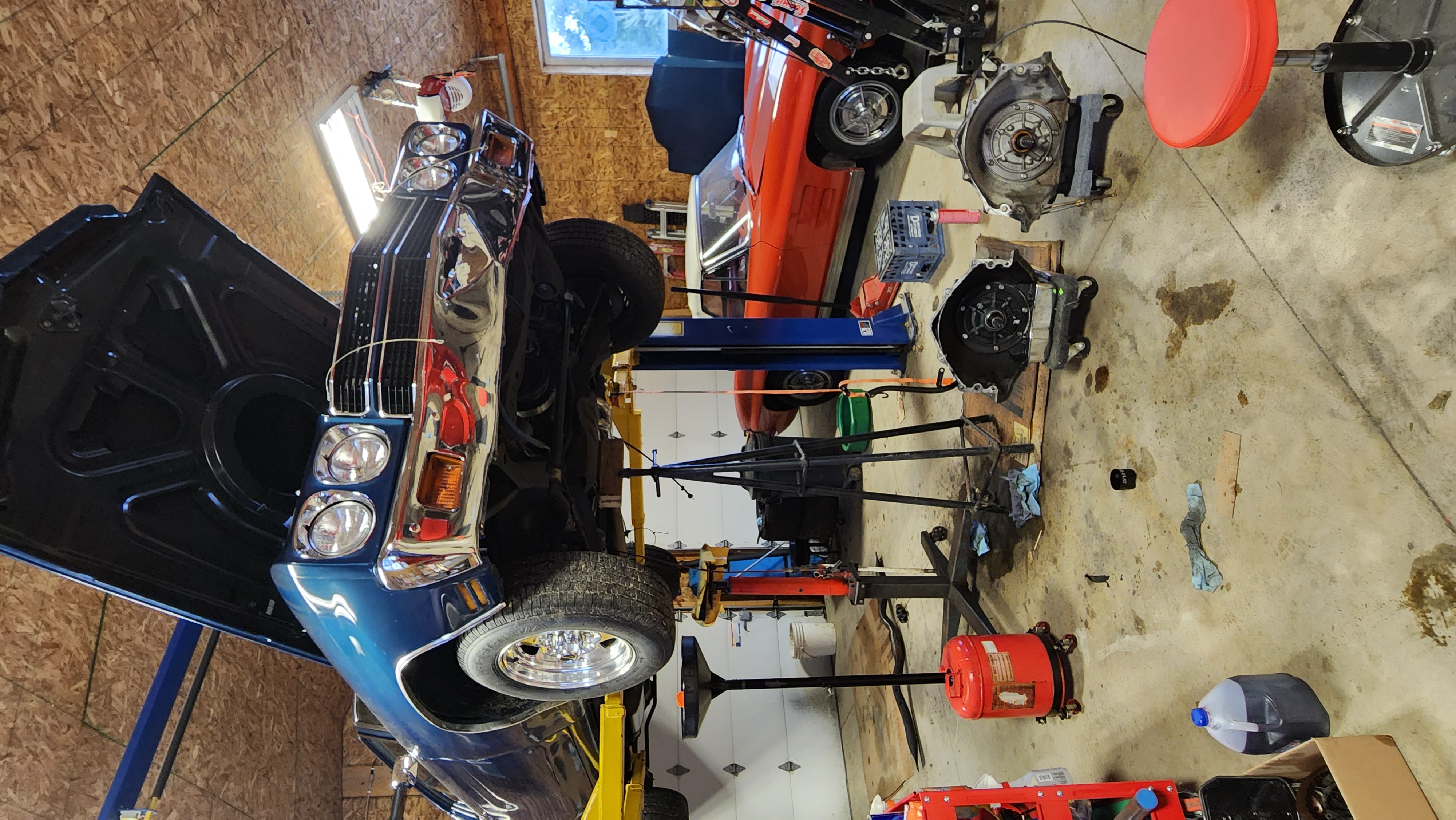

Well, the engine is all back in, and the hood is back on! Yay!
But I gotta dig into the key switch again, it has failed more times than it has worked the past couple weeks.
The diff cover has been leaking steadily this winter. I pulled the cover last night and saw nothing out of sorts at all. Previous gasket was neoprene and it looks totally fine. New gasket is paper-ish (FelPro). Once I put the cover on and re-fill, I'll be ready for a test drive. More importantly, I'll have my lift available for the Maliboost.

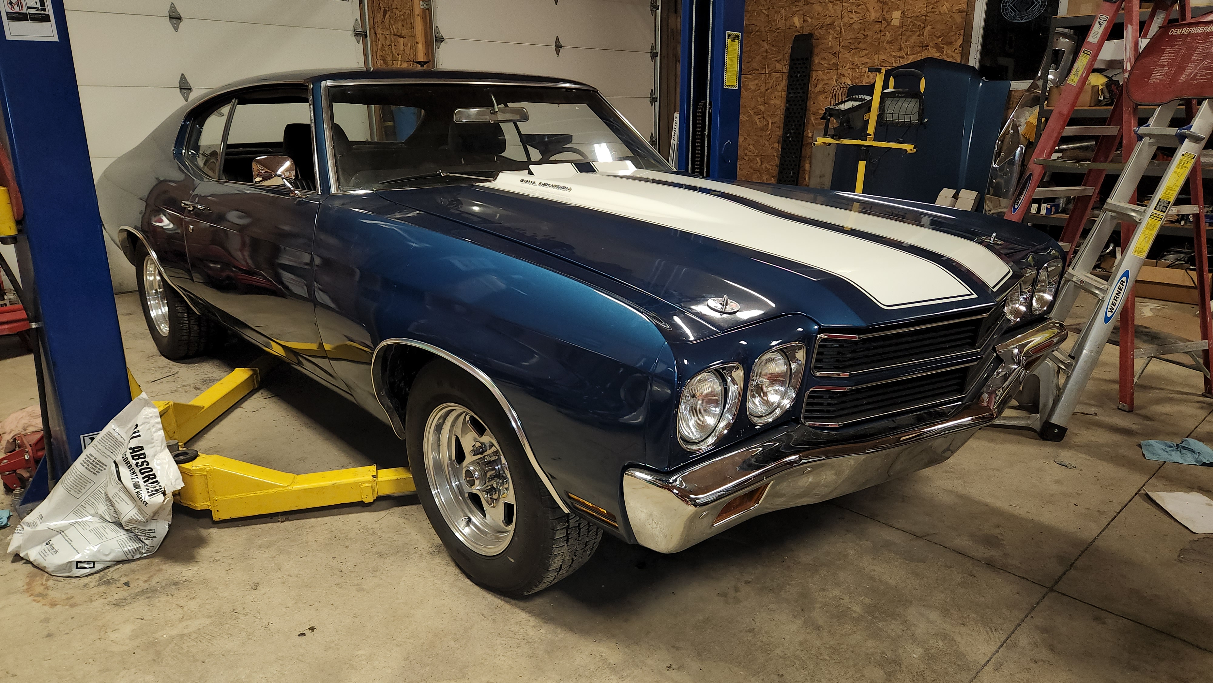

In that picture, you can't see any barbeque sauce on the hood....so we must have done OK. :mrgreen:

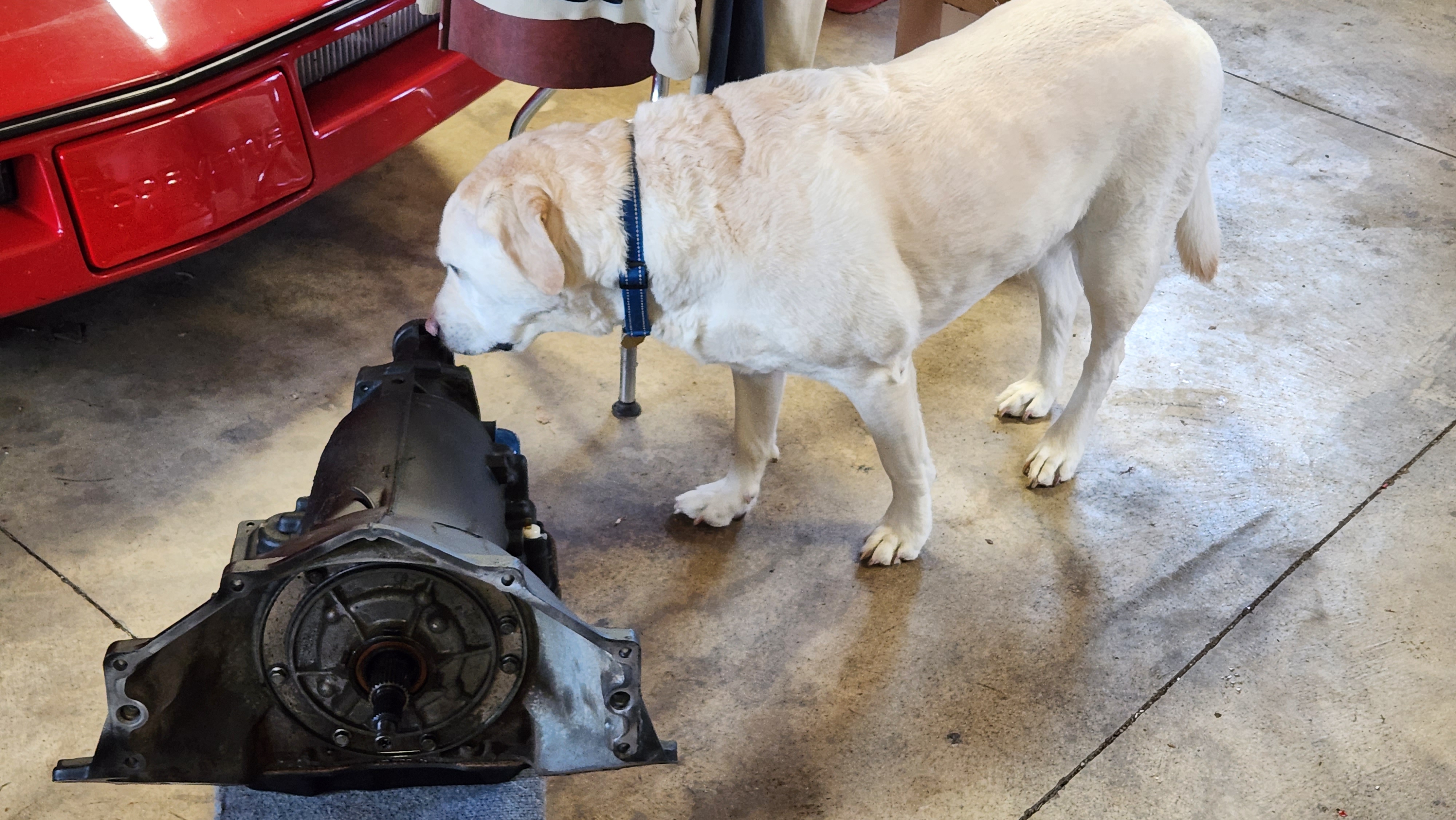

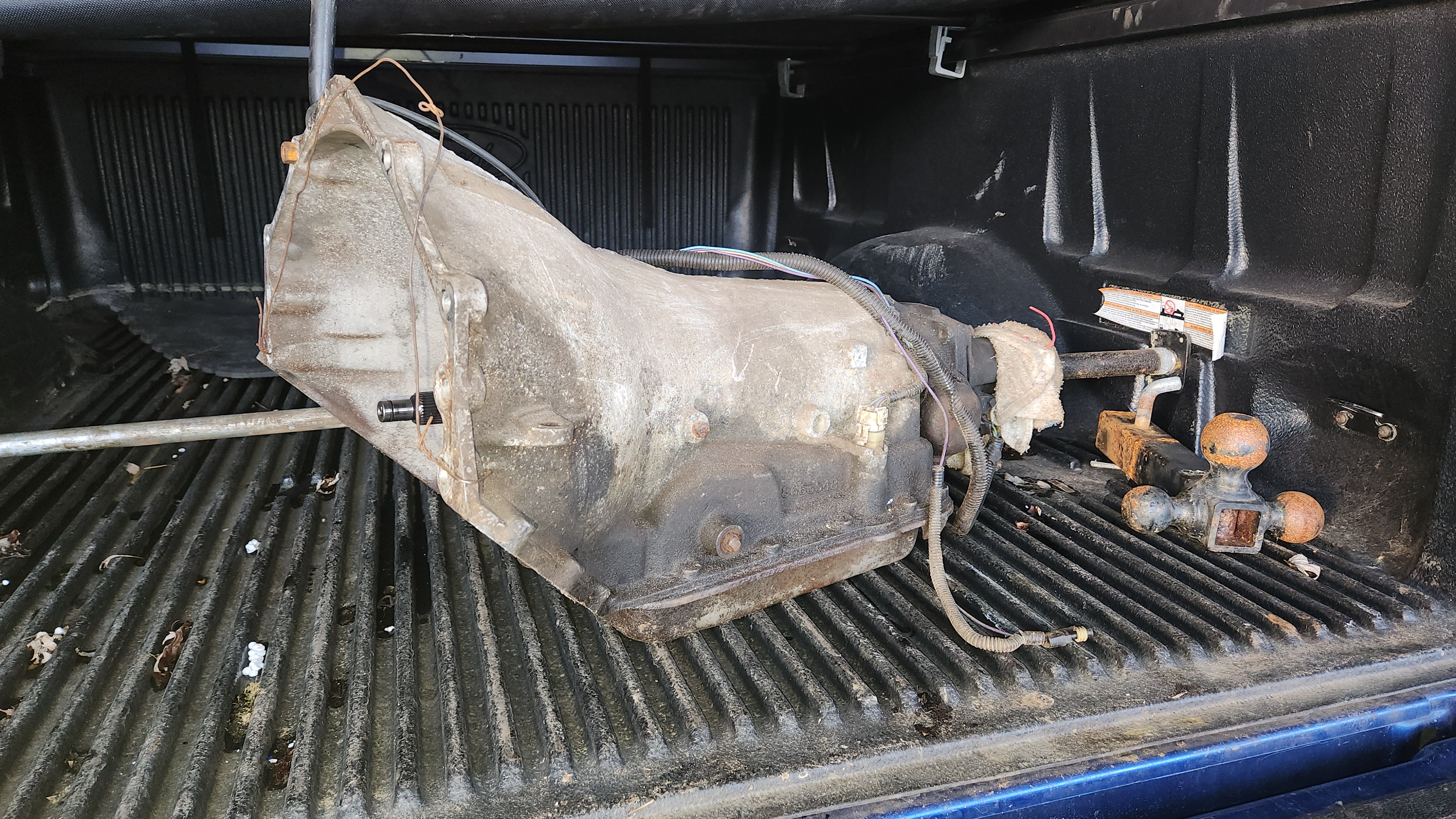

Core acquired from FB marketplace:
I bought a core trans (which he said looked real good when he tore it down), so that I can hopefully do and remove/replace in one day. We shall see..

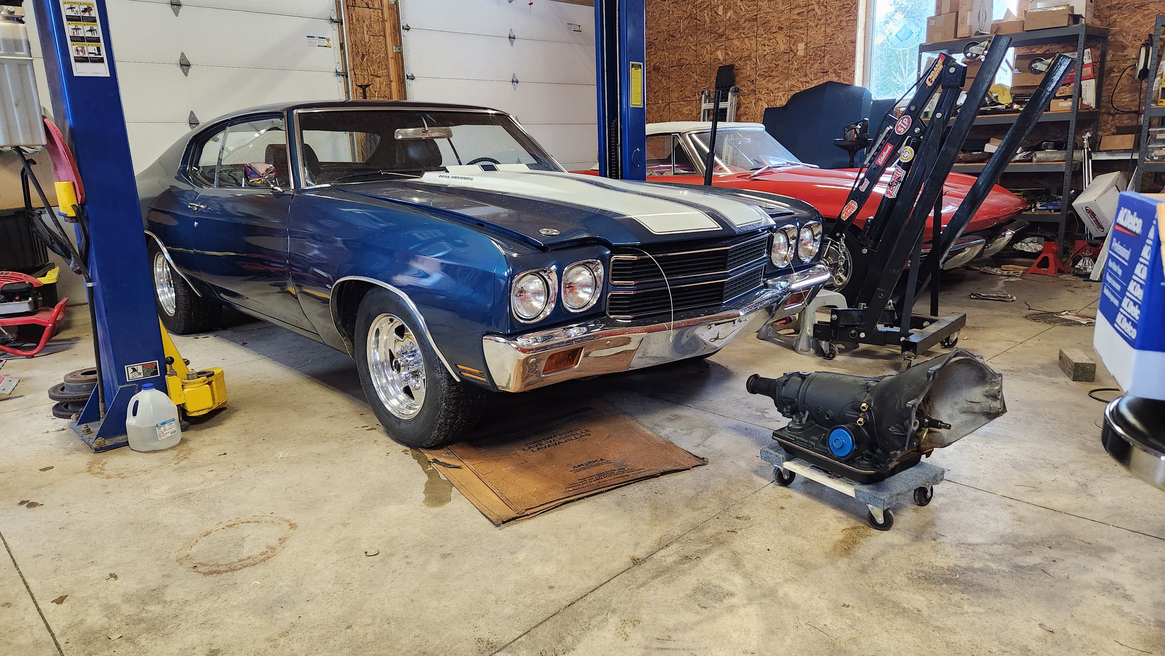

Re: Chevelle Projects 2022

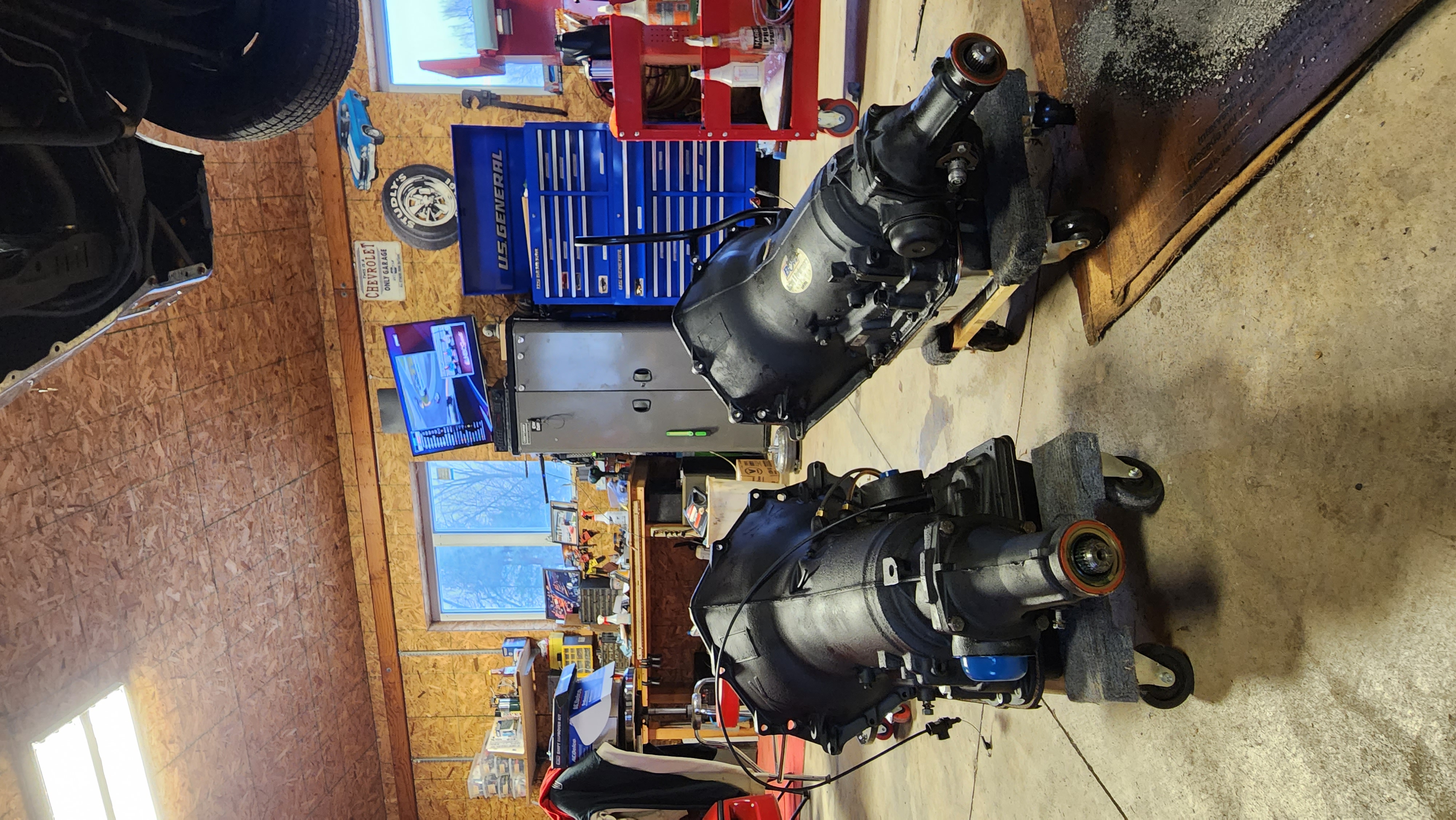

I took my core out to Bill at The Transmission Shop on Rt 307. He did the 700R4 in my Blazer a few years ago and I was happy with how it performed. He turned it around in a just a few days. I'm swapping my Edge Racing converter over, my governor, and debating on whether to change over to an aluminum pan.
Chris came over and we pulled out the old B&M 700r4 that I bought from Andy years ago. It has served me very well and isnt catastrophically broken. Next door neighbor Jerry's transmission jack really makes this a pretty easy job. Tony was over a week or so after that and we put the new unit up into the car. I still need to finish tightening and connecting everything, but its bolted to the engine and the crossmember is in. So far so good...
