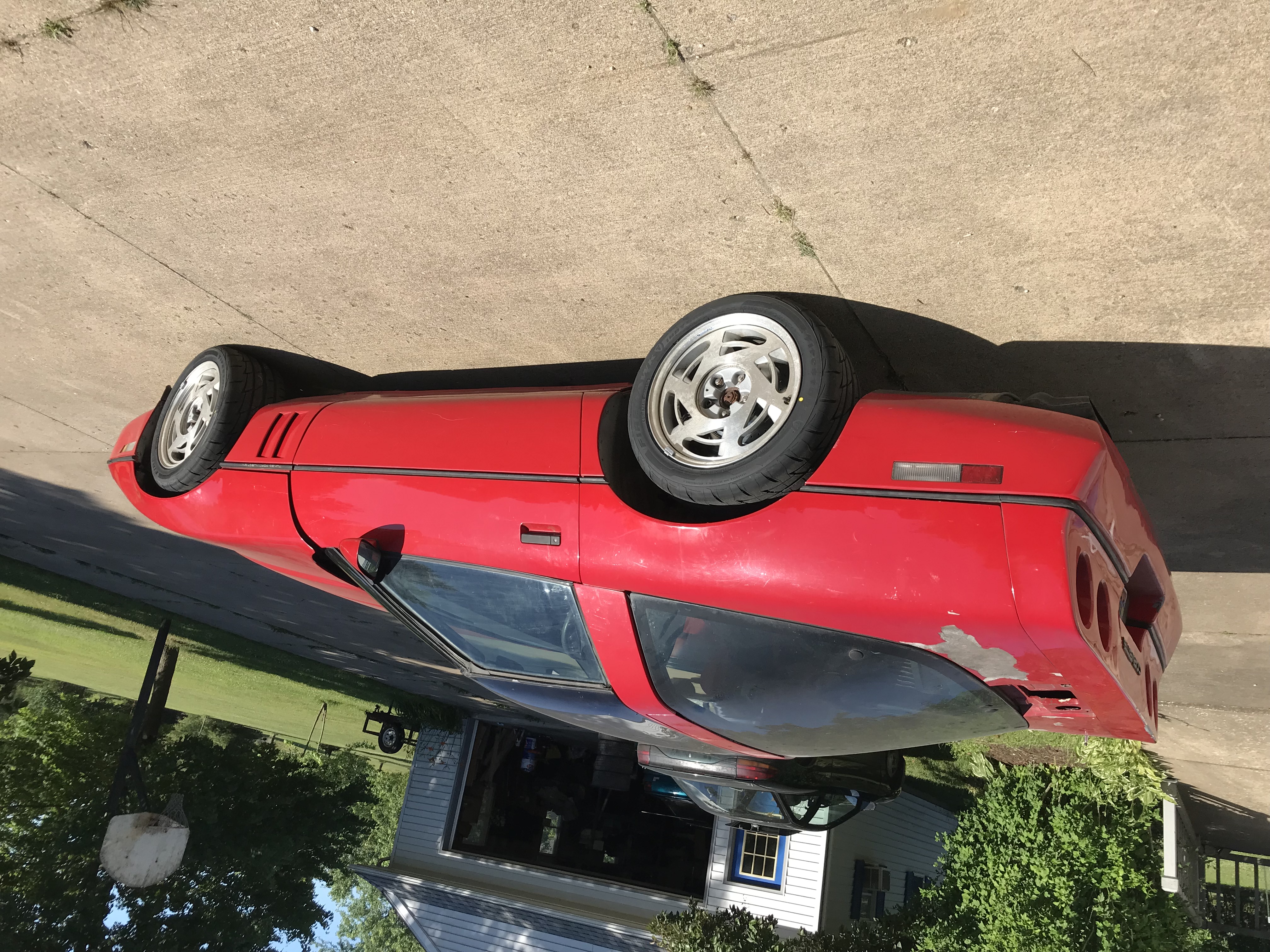

Today this car came home. It needed some air in the front tires, and it had a little bit of a time trying to move without stalling but went up on the trailer under its own power. Kurt is interested in driving this car so it seems it will get a bit more TLC and assuming nothing major is wrong, it will be on the road.
Loaded up and ready to leave Fred32V's place:
I took it down the drive and through the yard a bit and it shifts through all the forward gears.
Posts: 3051
Re: 89 Corvette Mostmint #43
Took a little test drive in the yard today lol. First we topped it off with radiator fluid. It still idles a bit rough, but after a couple minutes it idles on its own. Once it warms up it it pretty crisp on the throttle, I can only guess the plugs/wires/cap/rotor are the source of the miss. The car has the auxiliary cooling fan up front and it was kicking on at about 210 and off again at 200. Rear brakes are quite noisy due to rusted rotors. All the running lights, directionals and headlights work, though the pop up function need some TLC.

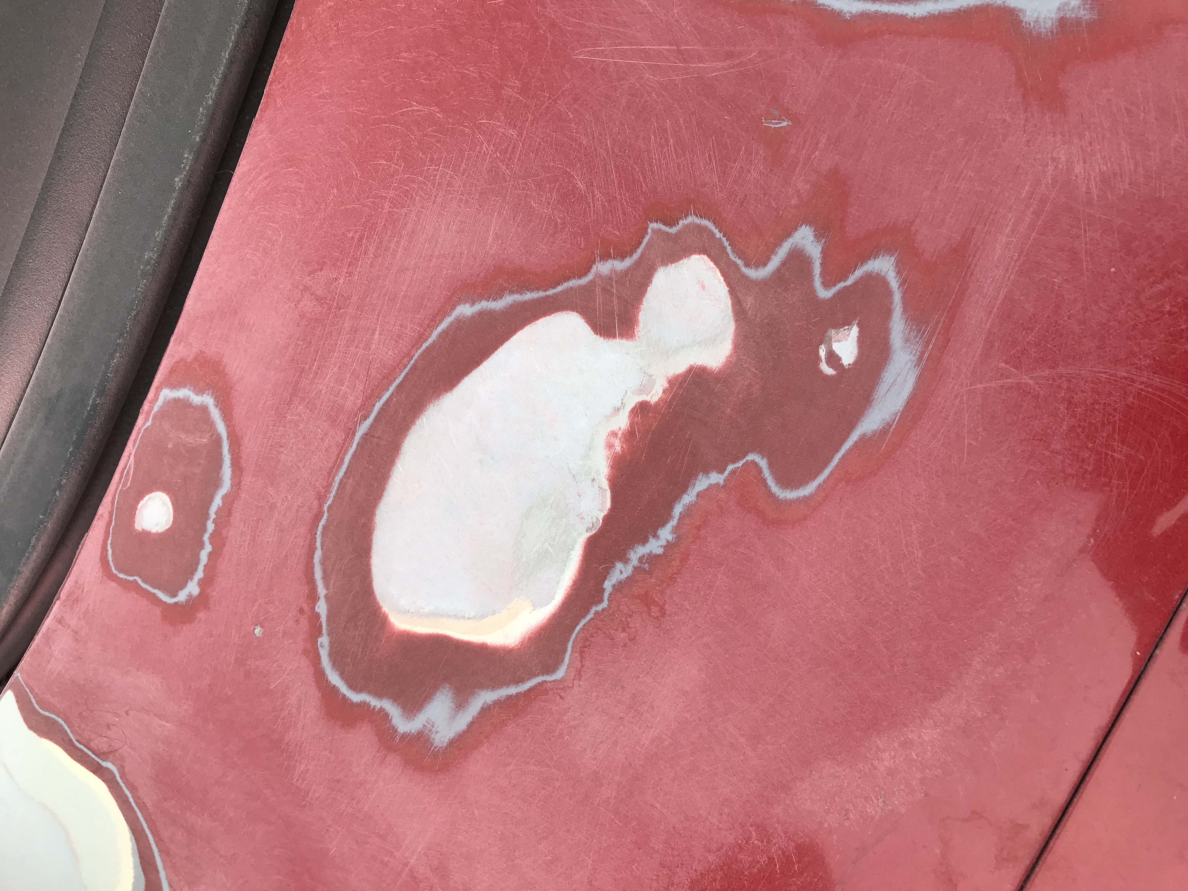

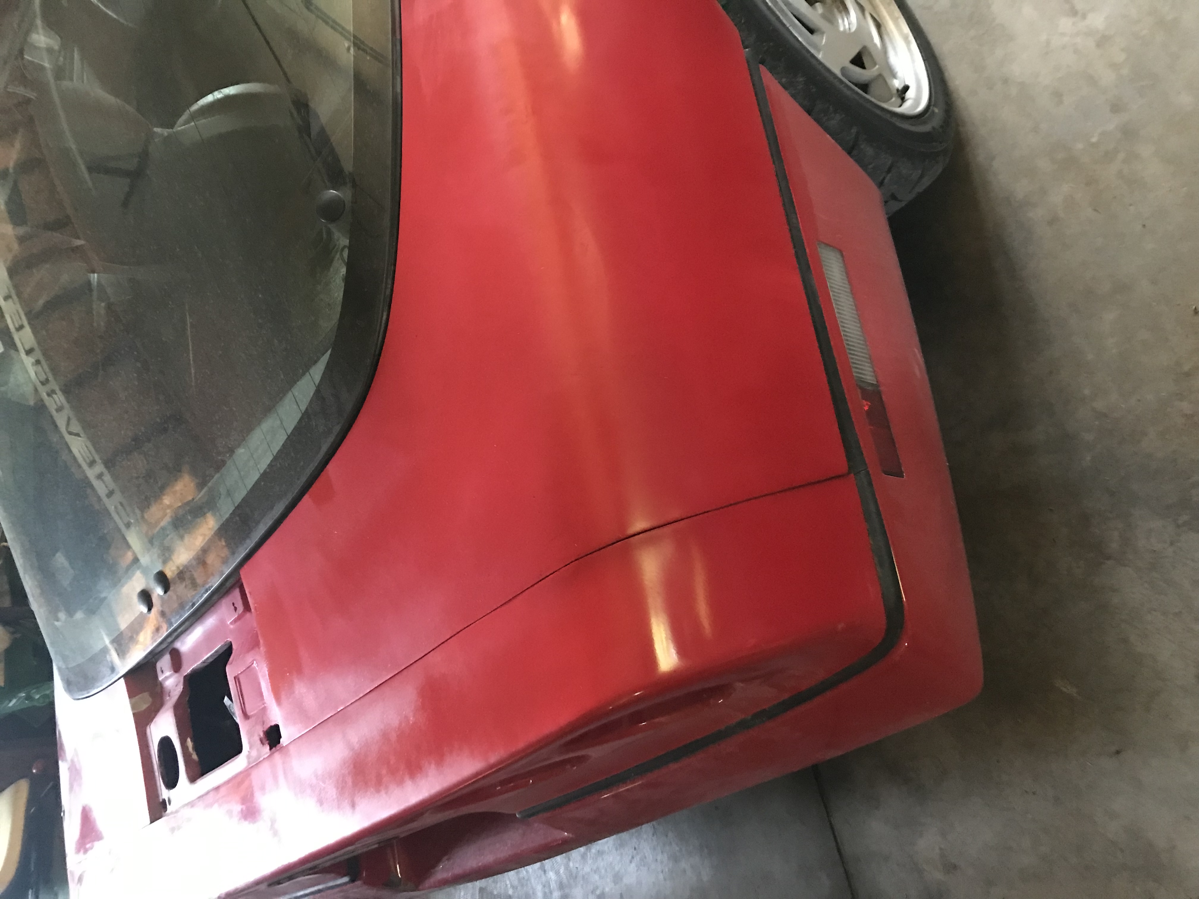

Kurt is going after the peeling paint in the back. You can see the car has been painted at least twice before it showed up here.
It’s not perfect but should look good in the on track action shots. If he cares it will get some clear on it at the end. The color match is good

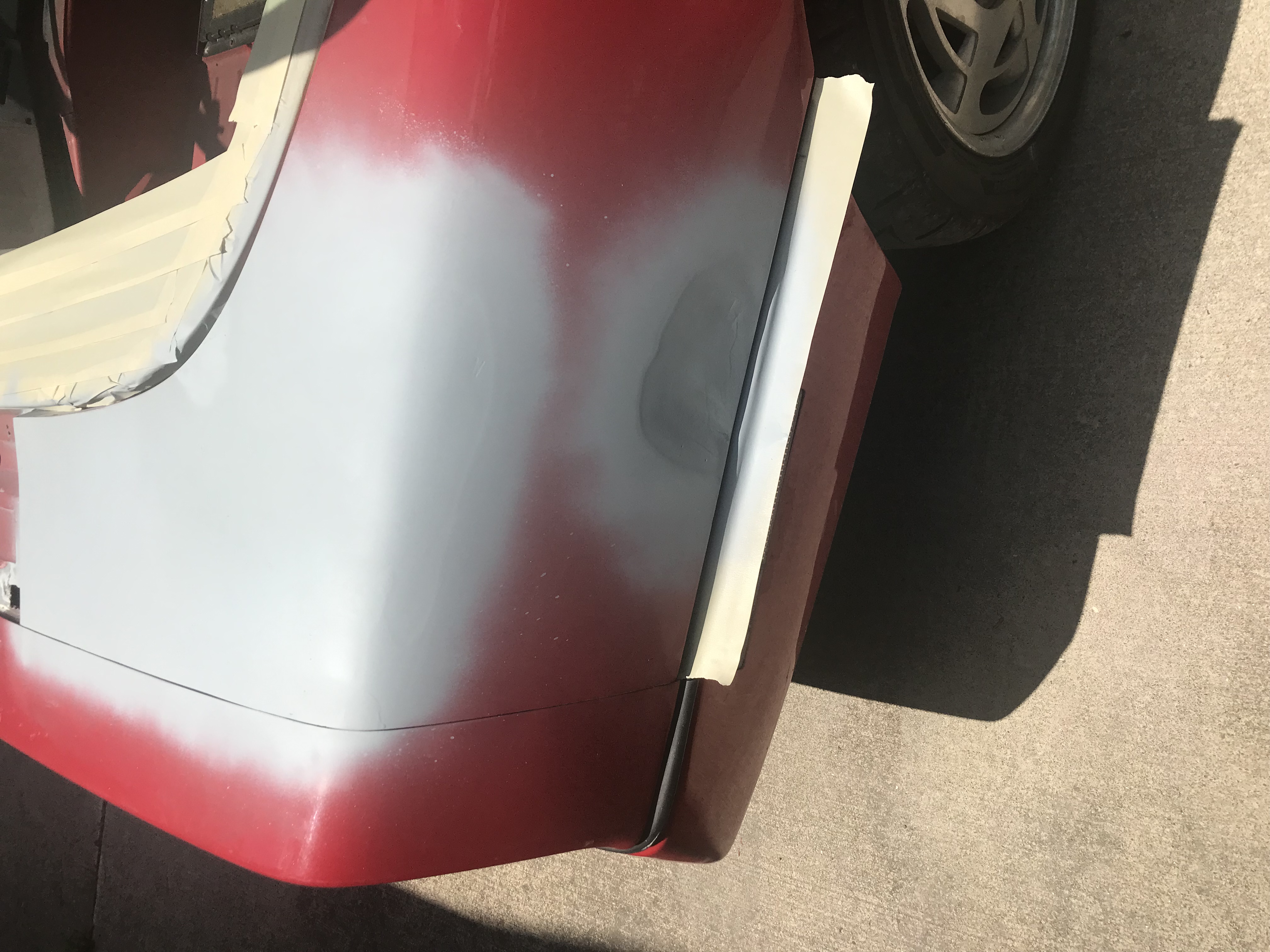

Some time in November we put some paint on the LR quarter panel.

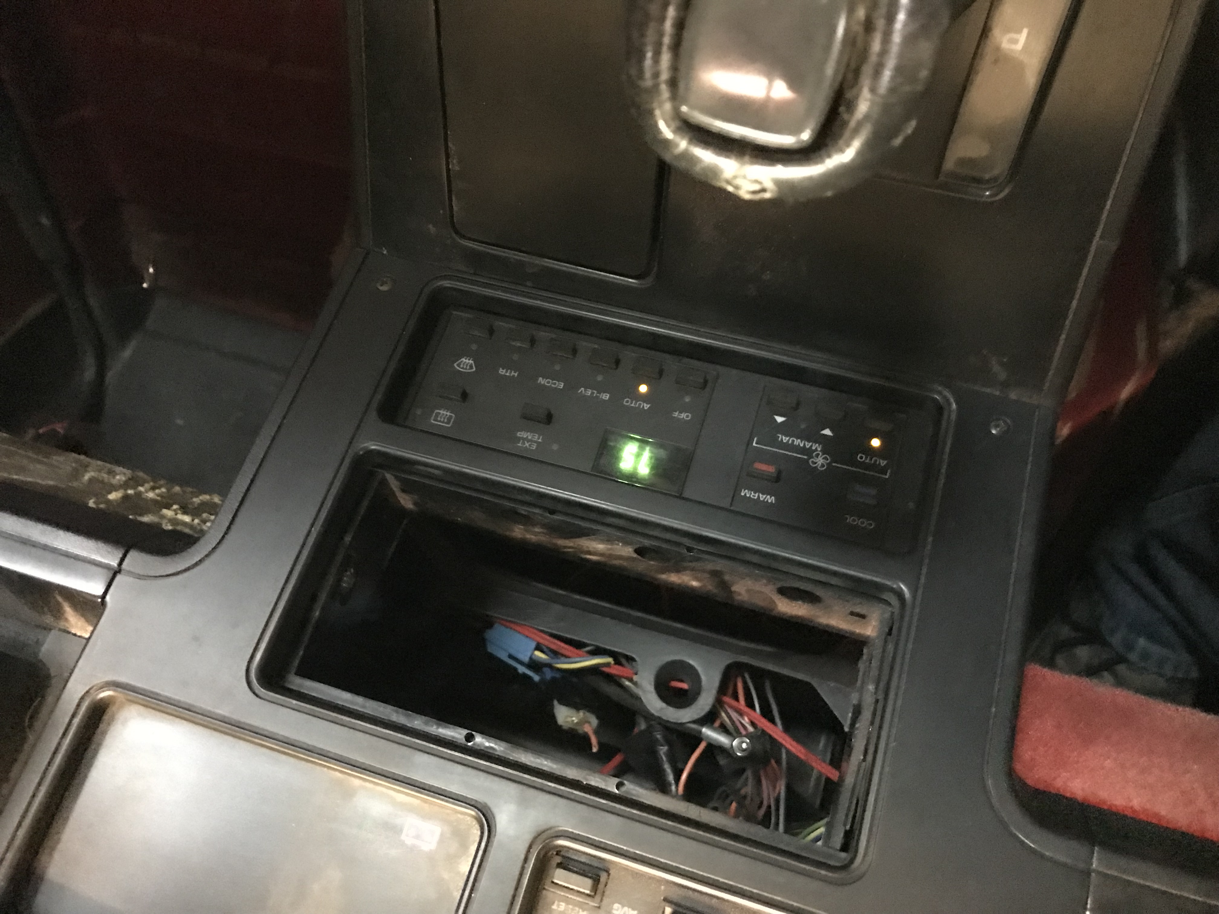

- The heater is now working. The vacuum lines were not connected, the electronic air conditioning controller and the blower motor controller were not working. Luckily I had those parts from the other Vette and they both worked. It took a while with the manual and a meter to figure out what needed fixed. With a charge of the A/C system it could have full heating and cooling function, though winter in NE Ohio makes the heater important.

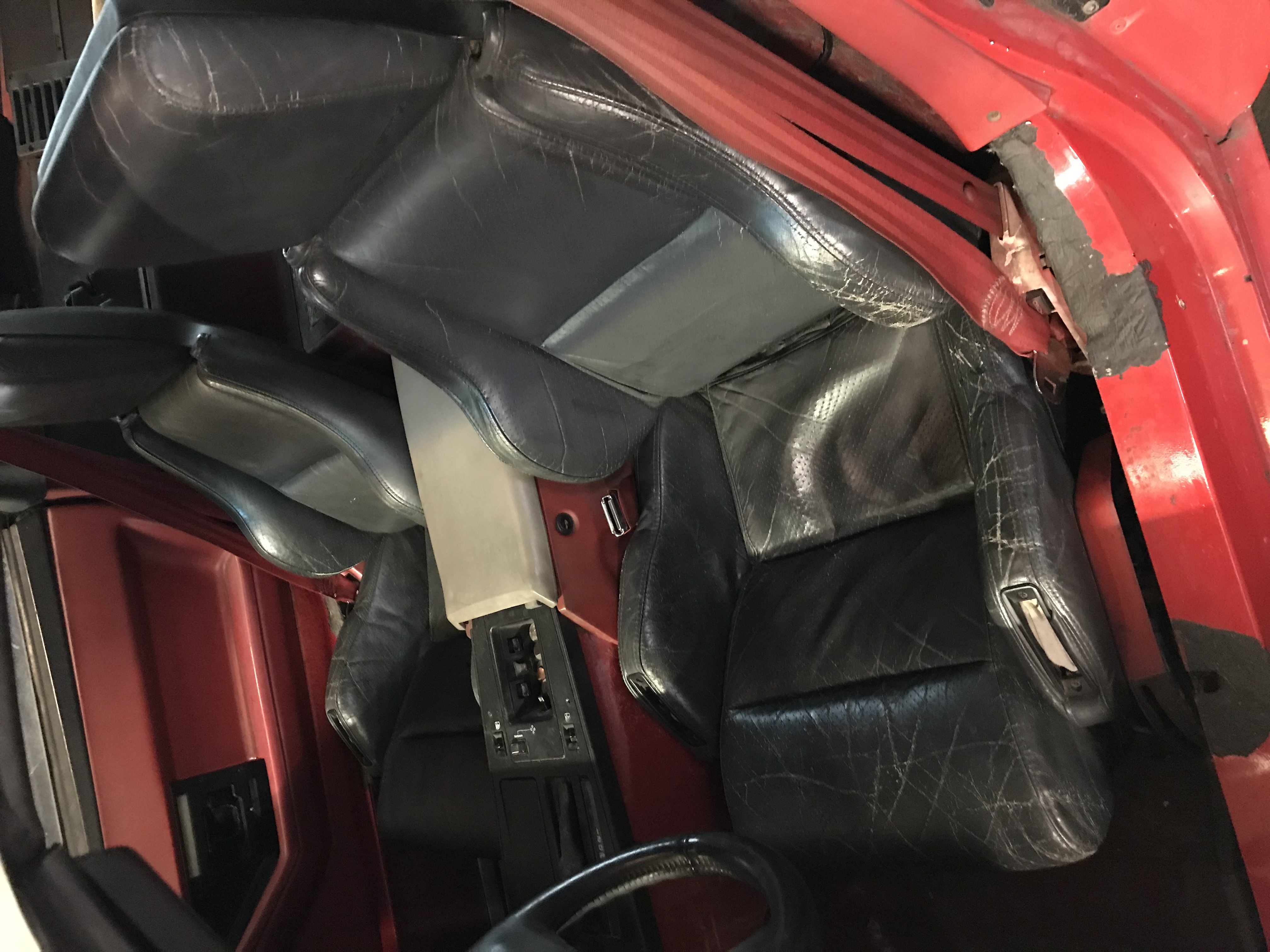

- The seats have been swapped out - replacing them with the extra seats that came with BP's Vette. These seats are quite deluxe and had some additional controls in them. Ended up using the base that came with the car, removing the more deluxe seat adjustments, and put it in the car.
- While the dash was apart I also swapped in the center dash bezel from my car as his was all broken up, and also the center console lid was all broken up so that got replaced as well.

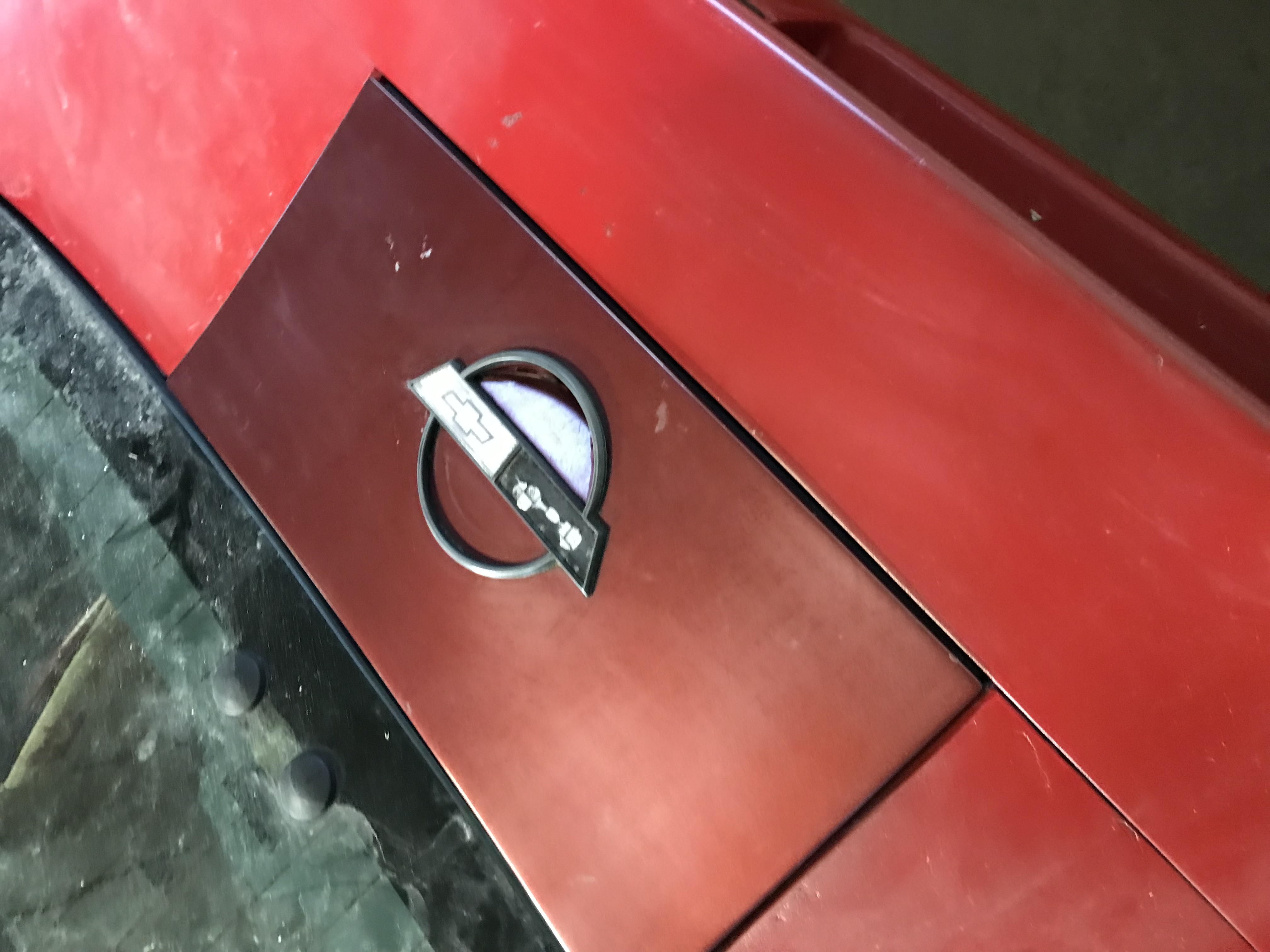

- Also it now has a functioning fuel tank door. I got this door in a parts buy a couple years back. It was quite dirty so I took some time to clean it up, and had to fabricate one of the moorings as it was fiberglass and had been damaged by the prior owner.
