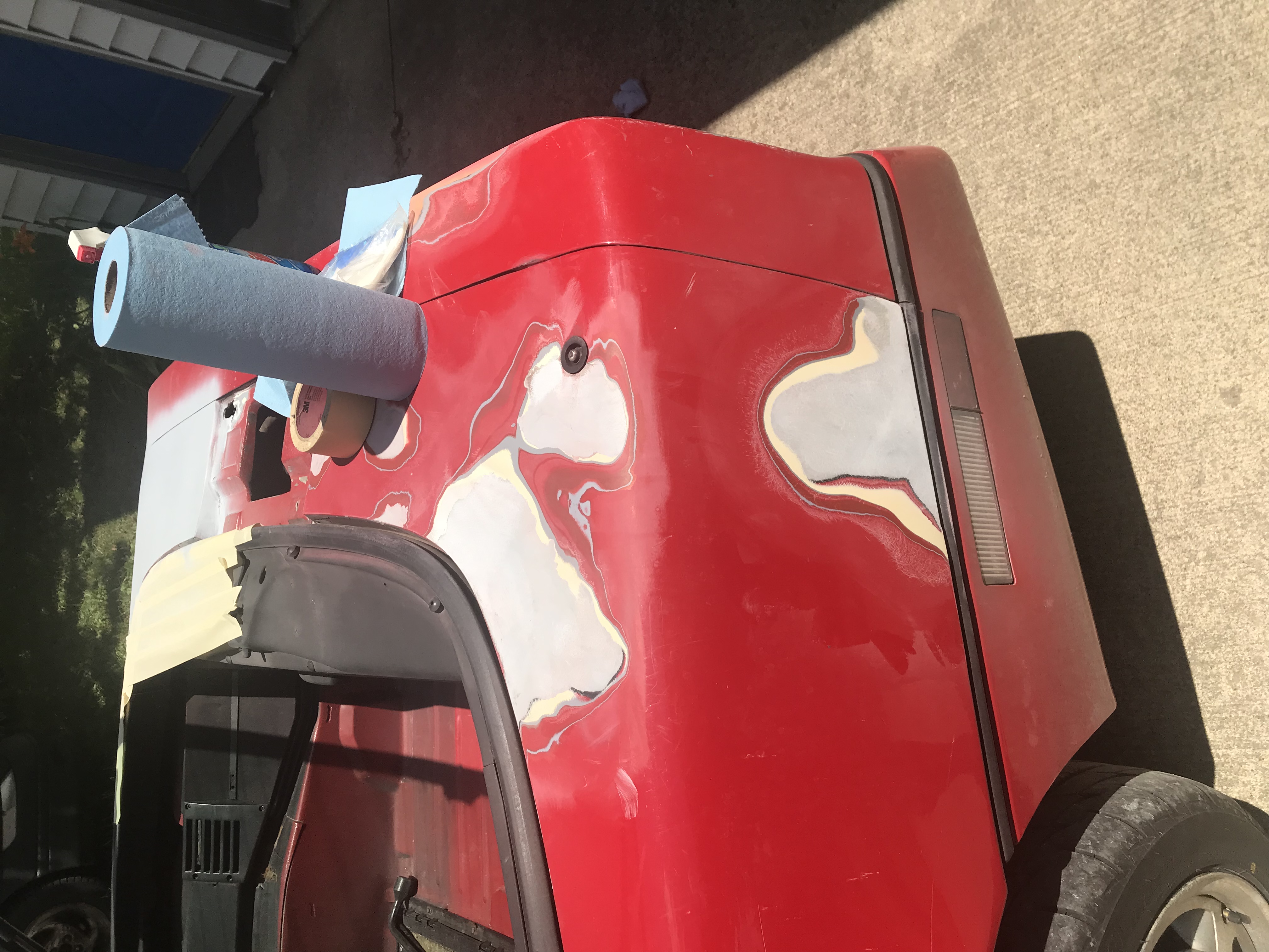

Kurt is going after the peeling paint in the back. You can see the car has been painted at least twice before it showed up here.
It’s not perfect but should look good in the on track action shots. If he cares it will get some clear on it at the end. The color match is good

- Also it now has a functioning fuel tank door. I got this door in a parts buy a couple years back. It was quite dirty so I took some time to clean it up, and had to fabricate one of the moorings as it was fiberglass and had been damaged by the prior owner.
