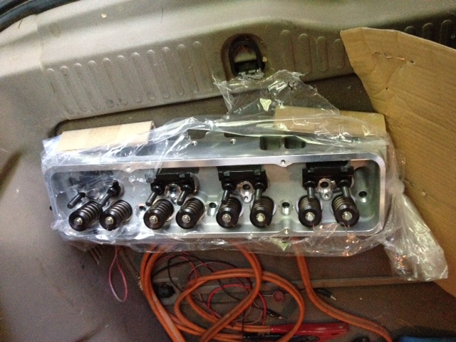

New heads arrived today. They are beeeuuuttiiifulll!

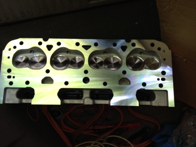

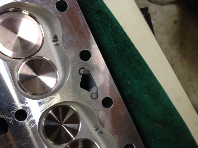

We did run into an issue with the Promaxx heads. The block has a pair of 1/4" water holes at the center bottom edges. The block holes match the gaskets perfectly but do NOT match the triangular holes in the heads.
We believe there's plenty of material so we could gasket-match the heads, opening up the triangular openings to uncover the water holes but don't wan't to void the heads warrantee. Alternatively, we could modify the gaskets and block holes to fit with the heads. However, the sizes of those water passages are no doubt engineered to get appropriate flow everywhere. If we expand those holes will we be disrupting flows in other areas?
I called Summit tech support and sent them pictures showing the issue. Summit referred me to Promaxx and gave me their number. Called them, emailed the pictures, and I'm waiting for a call back.

Promaxx called back but the rep, Chad, was better able to handle sales than head design questions. However, he was helpful and did go off to investigate and emailed
and called back. Turns out, there are specific head gaskets that Promaxx recommends for those heads: FelPro 1003 (4.166" bore) and FelPro 1004 (4.100" bore). Chad said a holes mismatch question came up before on some Ford heads and the answer was the holes were purposely designed for proper coolant flow for the aluminum heads.
The only thing that MIGHT make that seem reasonable is the SINGLE holes in that area between cyl 1 & 3 and 5 and 7. MAYBE two full holes aren't required required between 3 & 5???
The head gaskets that came with the Summit gasket set weren't labelled for manufacturer. We chose the Felpro 1004 but it looks like they are being discontinued. WXO found them on RockAuto, listed as "Discontinued" for about half what they were listed at on other sites.
Below is a picture of that gasket from Summit.
https://www.summitracing.com/parts/fel- ... -_-fel-pro
They have 3 bigger holes in the area in question. We'll see how they match the block and heads and decide they're OK or maybe do a little filing.

The instructions for the FelPro head gaskets cleared up the mystery of the coolant holes.
We need to drill holes in the block.

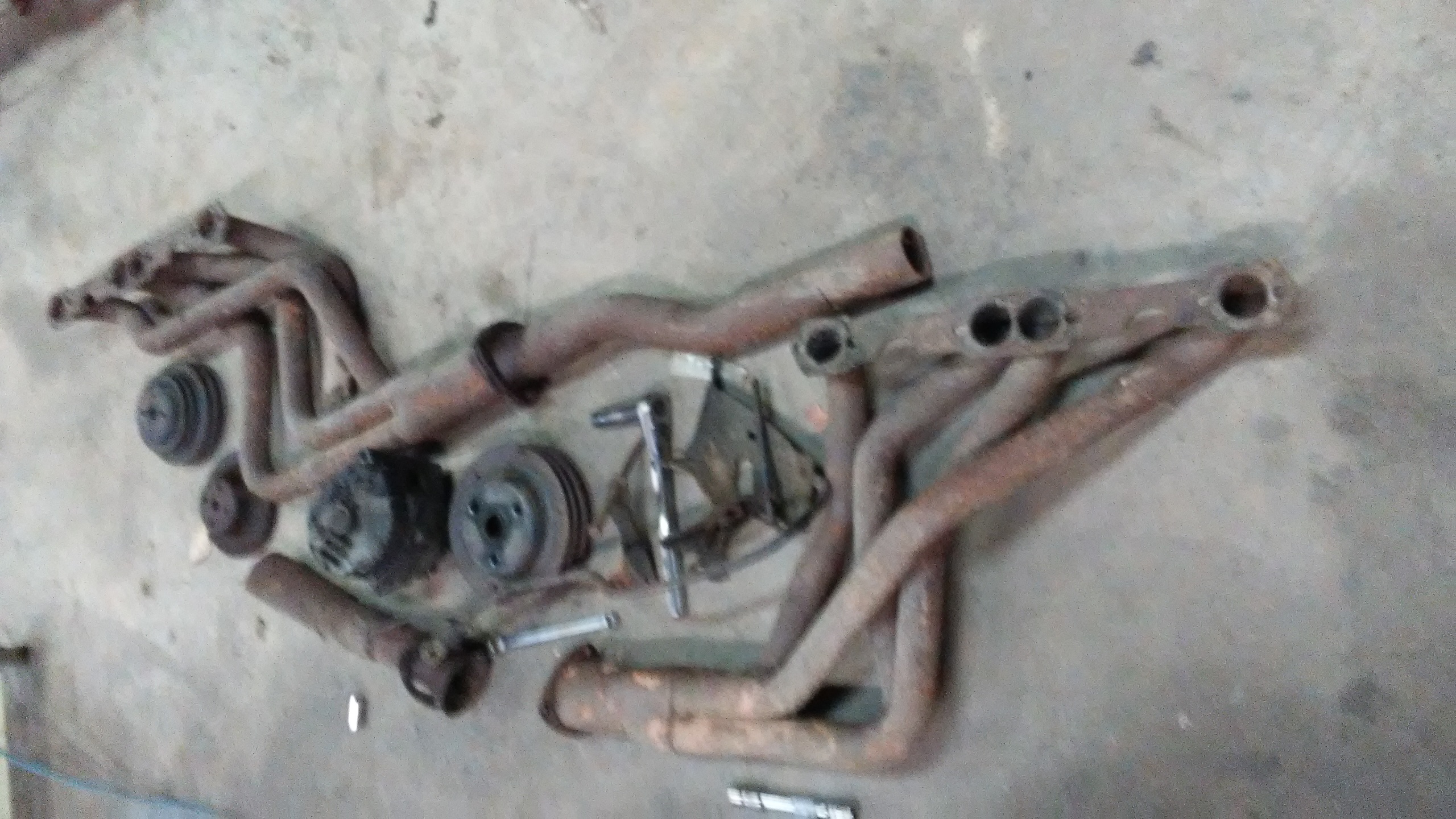

Les, a member of the Piedmont Classic Chevy Club (PCCC) responded to my parts wanted email with an offer to donate parts to our project. WXO made a trip to his place today (my wife is sick and I drove her to a doc appt this AM) and brought back perhaps everything we still needed. Alternator, alt brackets, crank pulley, 2 water pump pulleys, headers with stubs attached, and glass pack mufflers.

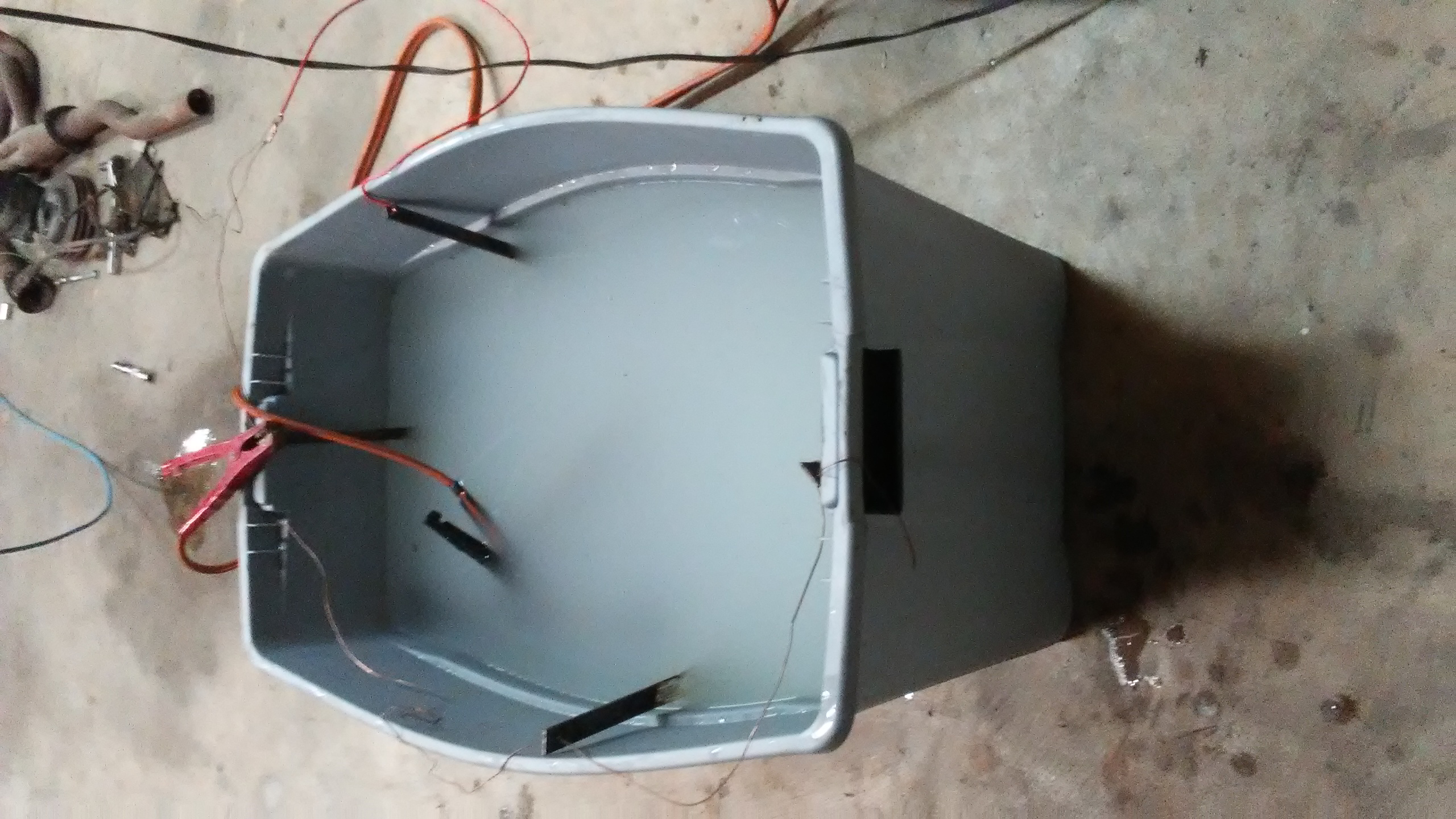

So, the electrolysis rust bucket came back out. Got one header cooking under there.
Brackets are soaking in the chemical rust bucket.
Hope to have it all derusted by our next work day, Wednesday.
One Header Ready for Paint

Got one header de-rusted and treated with OSPHO.
