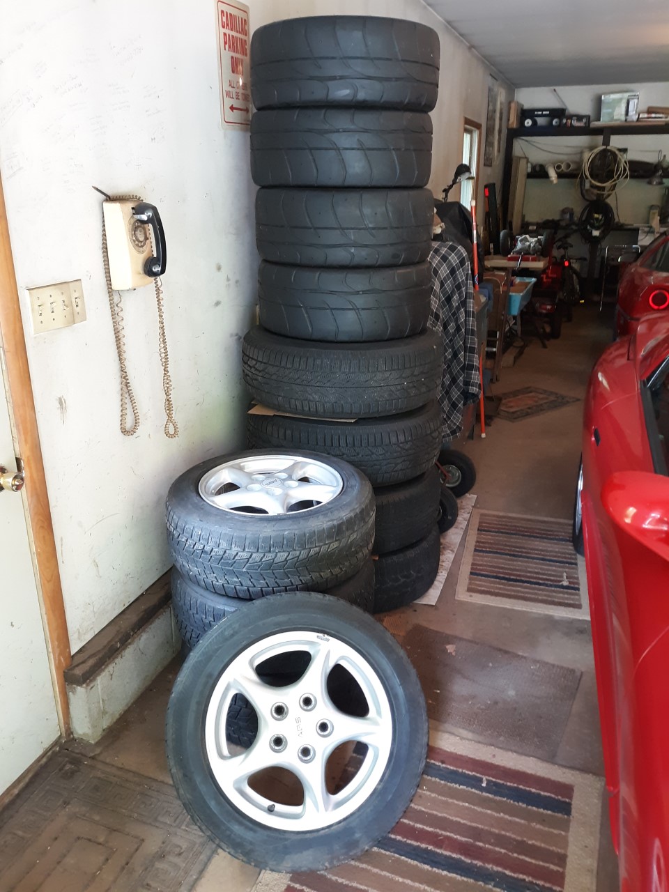

Yesterday we bought a used set of Nitto NT01 tires for the Firebird. They're 245-50-16 which is the stock size for a Trans Am of this vintage. There's actually no date on these tires, but the seller says 4-5 years old. They don't show any wear at all. We paid $320 for them and they are over $200 ea if we bought them new. This is a road race, 100 treadwear tire. I know it will be better on a road course, hopefully it will be better on an autocross too. We'll need to find a set of 16" Camaro or Firebird wheels cheap now. There's lots of sets out there for $200 or less, but they're all 2 hours away.

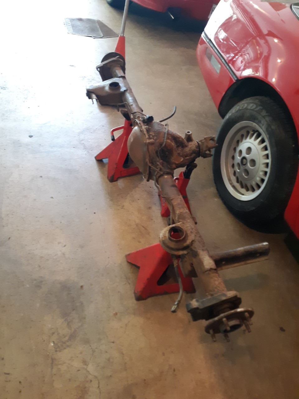

Dad was working at MostMint's place last Sunday and I found a 3.73 complete rear end for the Firebird. I found myself running out of gear on Nelson's back stretch and having to shift into 3rd gear at Dragway 42s autocross. The car currently has a 3.90 gear, so this should get me a few hundred extra RPM.
Yesterday we drove to the Rolling W dirt track near Butler PA to pick up a set of rims to go with our newish race tires. They are Firebird 16x8 rims that would be stock on this car. So now we need to get the rear end swapped out and the tires mounted in the next couple weeks and we should be ready for track day in June.
I'll let Fred post pictures of our acquisitions.
