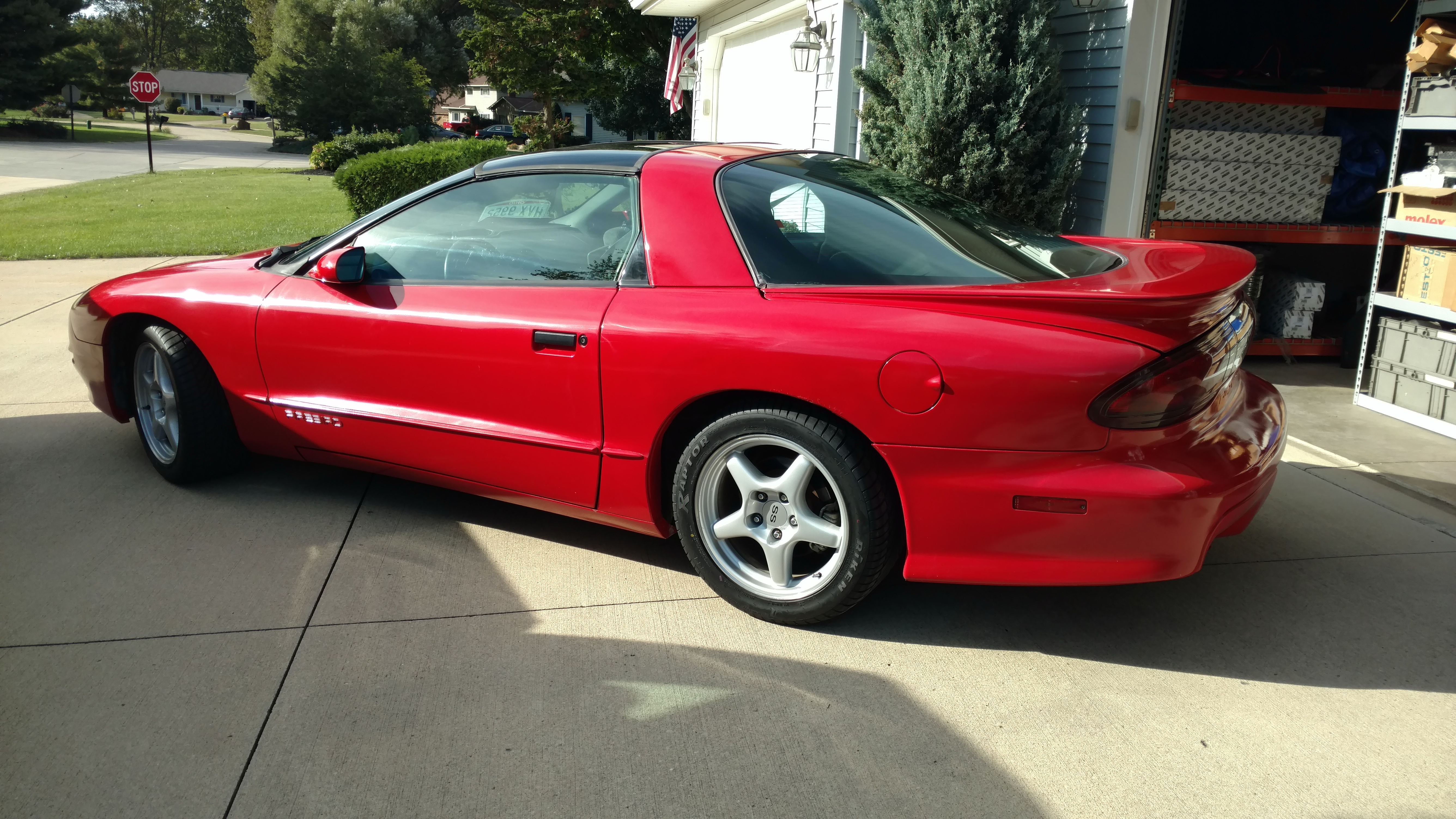

BP & I went to Fenton, Michigan on this Sunday 9/1/19 to get this 1997 Pontiac Firebird.
473 miles round trip. Left at 10:15am, returned home at 6:30pm.
Paul drove it home 237 miles in the rain, with no surprises. It currently resides in the 32V Garage.
What a great satisfying fun day!

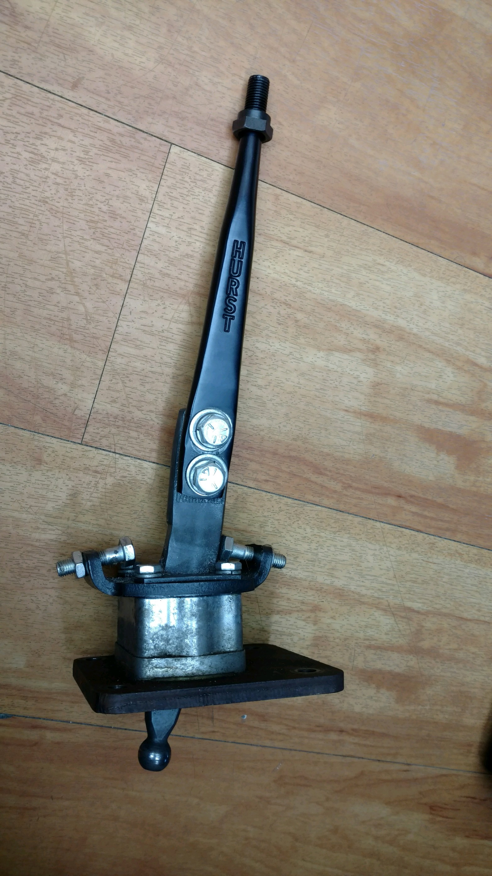

I also received the "new" shifter for the car today, fresh off ebay. That will make it's way onto the car by next weekend sometime. I will have to find a shifter ball between now and then too.

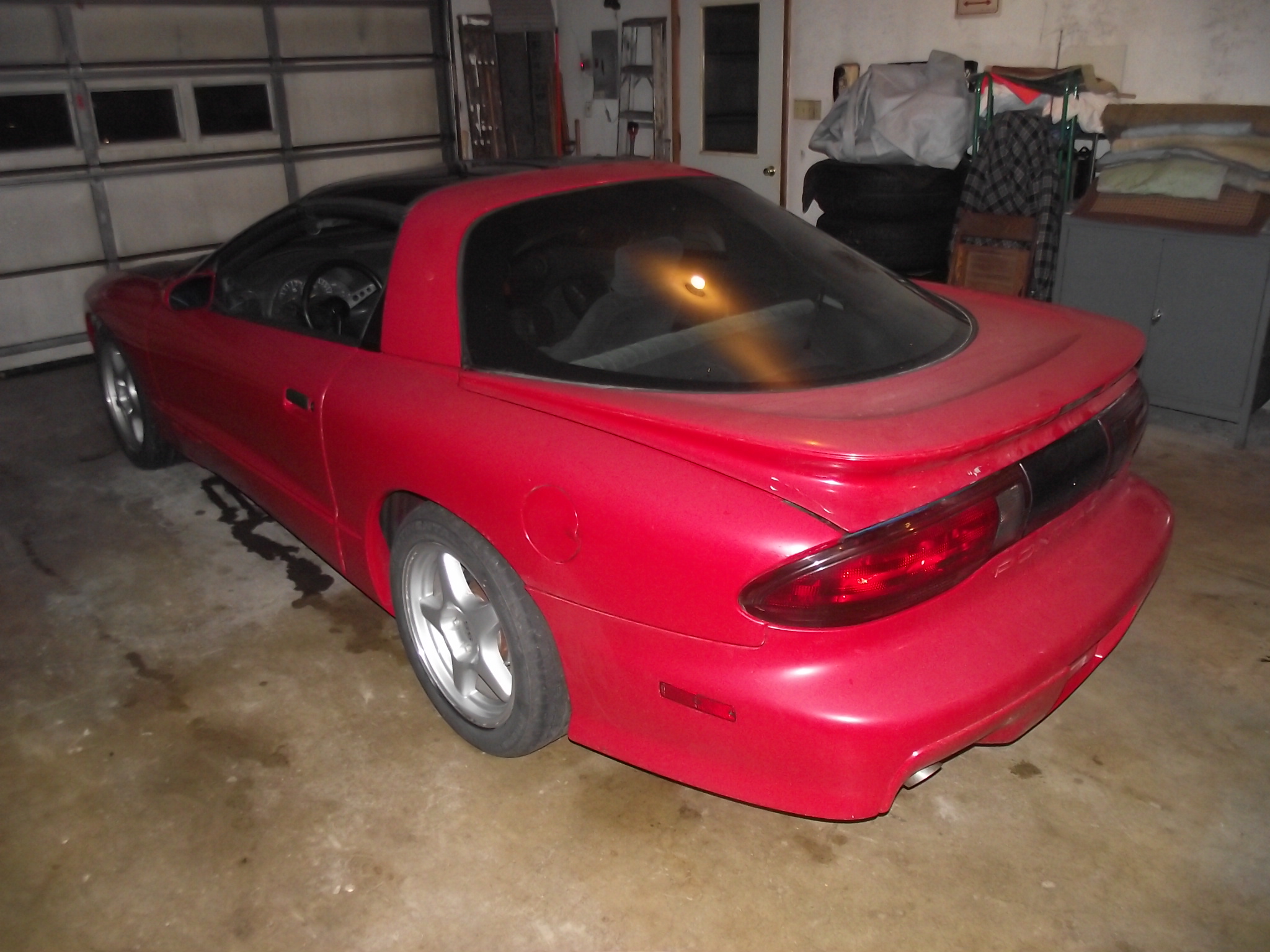

Re: 1997 Pontiac Firebird
One more check off the checklist.
Getting ready for a little fun.

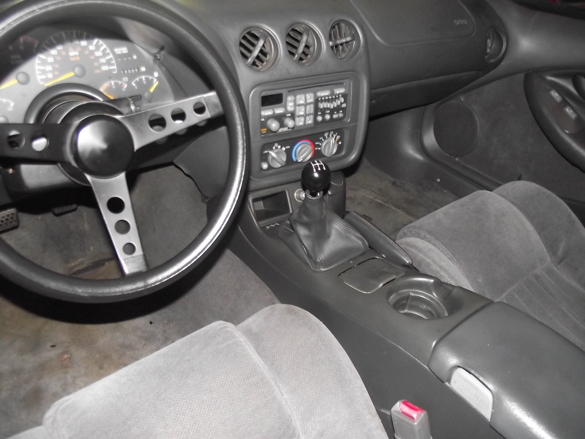

BP and I spent the morning in the 32V Garage.
Notice the shiny new Shift Ball, what is hidden by the boot is a Hurst Shifter. Removing the center console was pretty straight forward. No real surprises.
Keeps gettin' better.

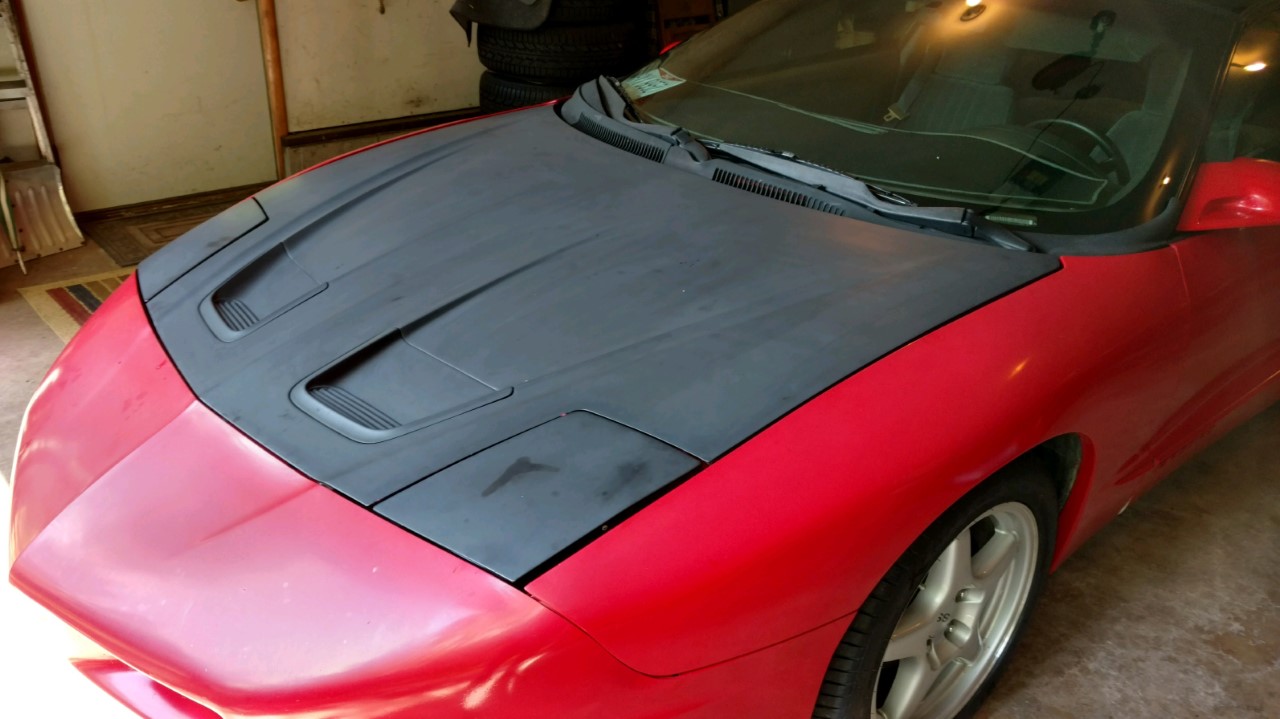

Since the new hood was too shiny for the rest of the car, I decided to do something about it. On Tuesday I brought the car home so I could pick at it after work and over the weekend.
I buffed the car out with pretty good success. I mean, it's shiny now and not the dull disaster it was. This car was repainted at some point, poorly. The poor par was the prep work. It looks like it was finished with 80 grit. Fortunately, from 20', it looks decent. The pictures show it buffed, but I did wax it and that helped too.
I also changed the oil and filter and switched to synthetic. I also changed the trans fluid with synthetic ATF. While under the car I chased an annoying exhaust rattle by repairing and rotating a clamp that was touching the bellhousing. I also found the y-pipe to header flange bolts a little loose. While there I rotated other clamps that were pointed down to create more ground clearance as I know one of them would hit the floor pulling out of 32Vs garage.
I also ordered two Moog front wheel bearing hubs from Summit (making them price match RockAuto) as these had a small amount of wobble from top to bottom. I'll keep them as spares. The Moogs have a 3yr warranty which was better than everyone else's at only one year. This is a weak point on these cars, but the upgrade is $1000 and I'm not doing that yet. I figure I'm good for three years, and these are relatively easy to replace.
