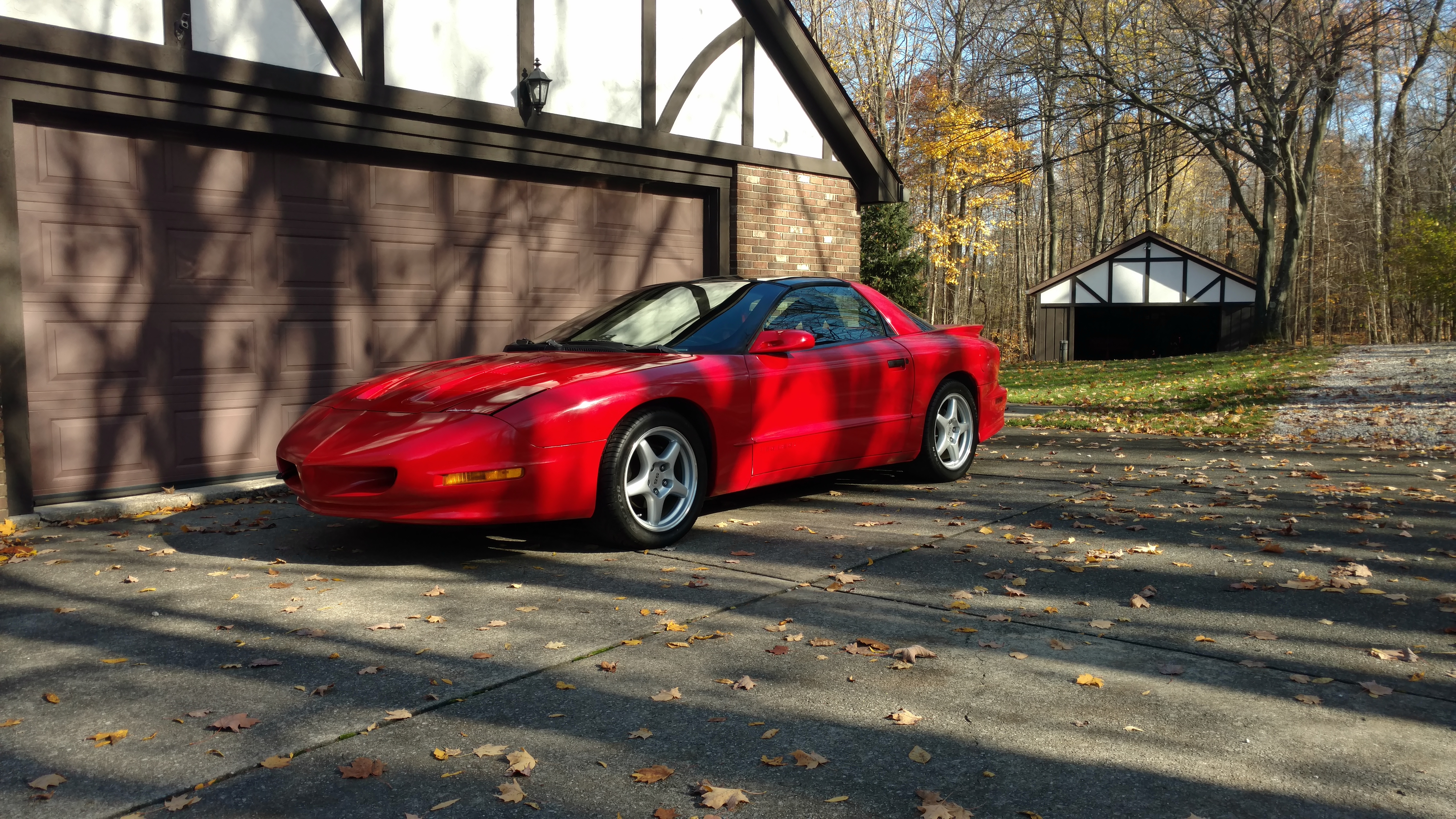

We pulled the Bird out to work on the F250 today. Looked like a good photo op.
