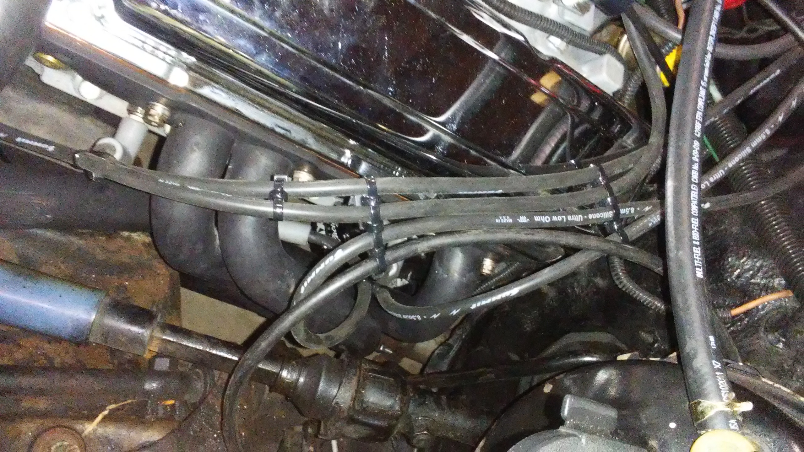

I appreciate your comments. I'm really on the edge about this. Guess I should do a spread sheet of the options and their costs/benefits.
I'm using BP's (Edit: OOPS, Dave's, not BP's) find on zip tie wire separators.
Notice 5 plug wires?? One is the speedo cable which is holding the plug wires up and away from the headers.

Those ziptie seperators came out pretty good!

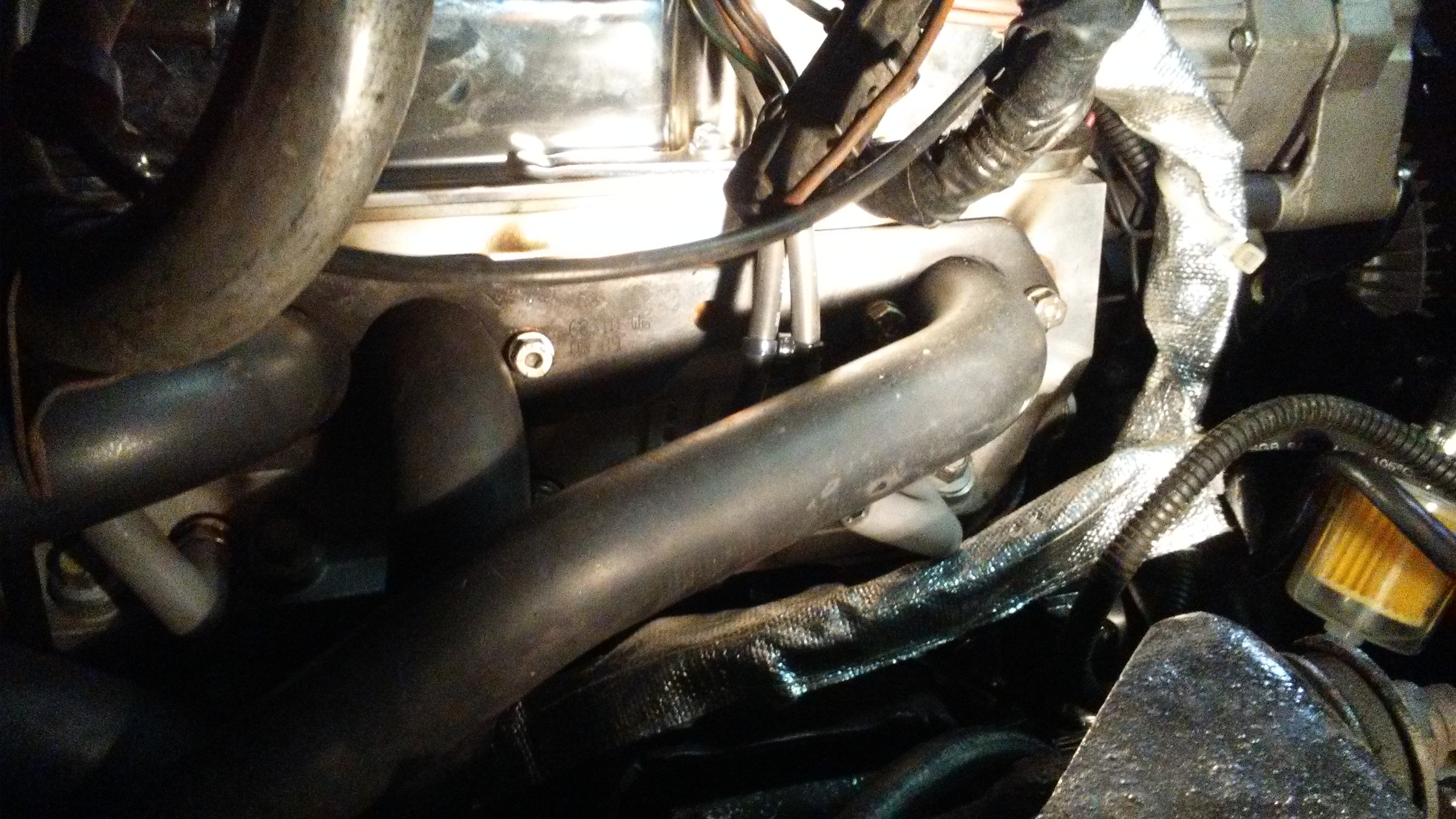

Removed the passenger side inner fender and found that header is leaking worse than I thought.
The flange is leaking by every one of the tubes as evidenced by the black on all four corners. Bolts are tight. Checked the driver's side and noticed just one leak there. I don't know why it would blow out on the corners like that. Those copper gaskets get many endorsements but that one didn't do it. May try some thicker gaskets or may use hi temp RTV.

Removed the headers and discovered the reason for the leaks. The 1.5" round header tubes didn't reach the corners of the square exhaust ports and gaskets.
The copper gaskets were replaced with some Mr Gasket #7402G "reusable" gaskets I had on hand. I'm hoping the 1 5/8 dia, 1/8" thick soft aluminum gaskets will seal on the square ports.
