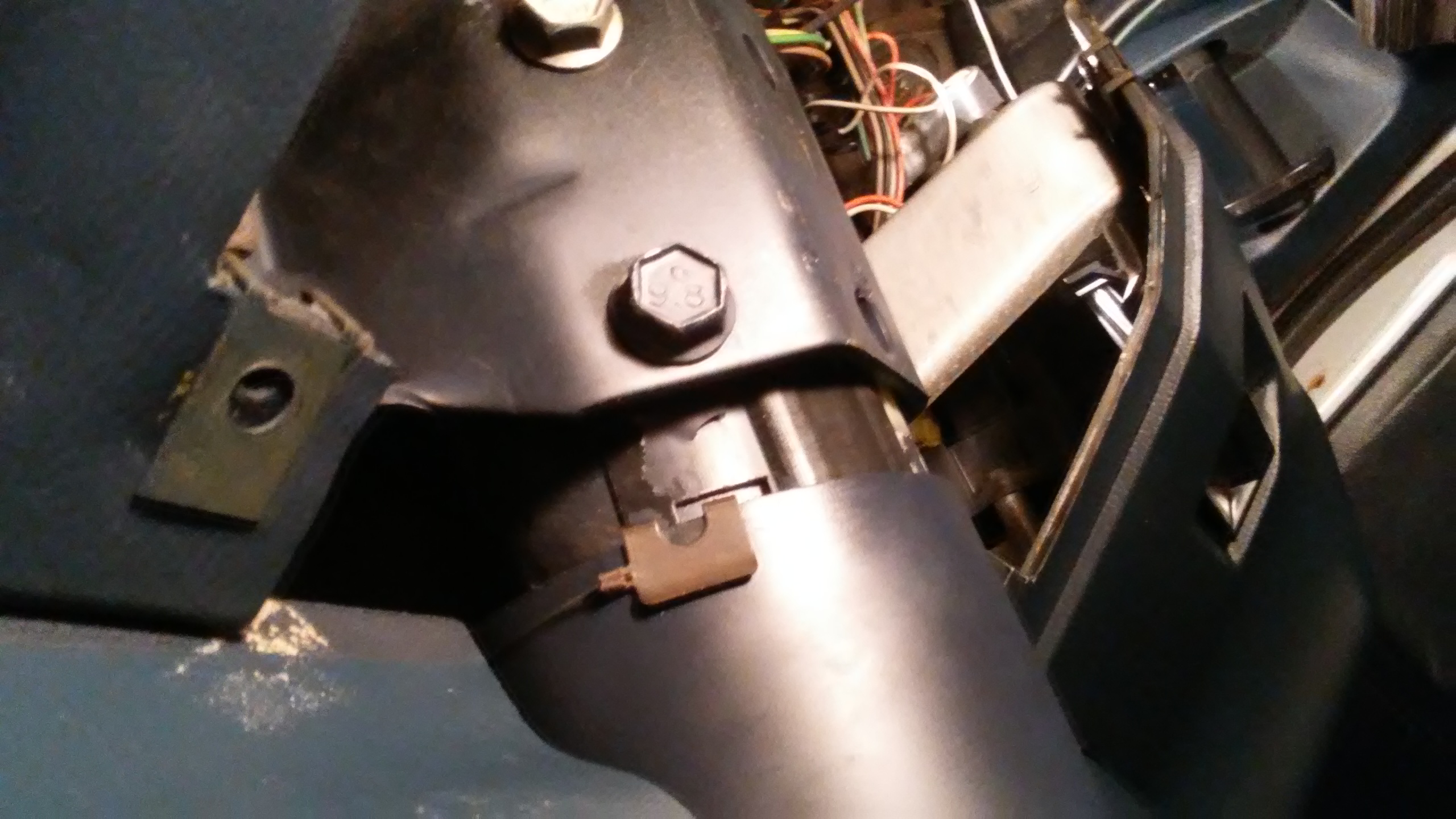

One thing that's really neat is the adjustment for the gear selection pointer. Its adjusted by moving a clip on the end of the cable that moves the pointer. Clip is on the steering column shift collar under the dash. Easy to do without disassembling anything.
Those pointers are so often off a little and not so easy to access the adjustment for lots of them. GM guys probably have seen this before but I thought it was very clever.

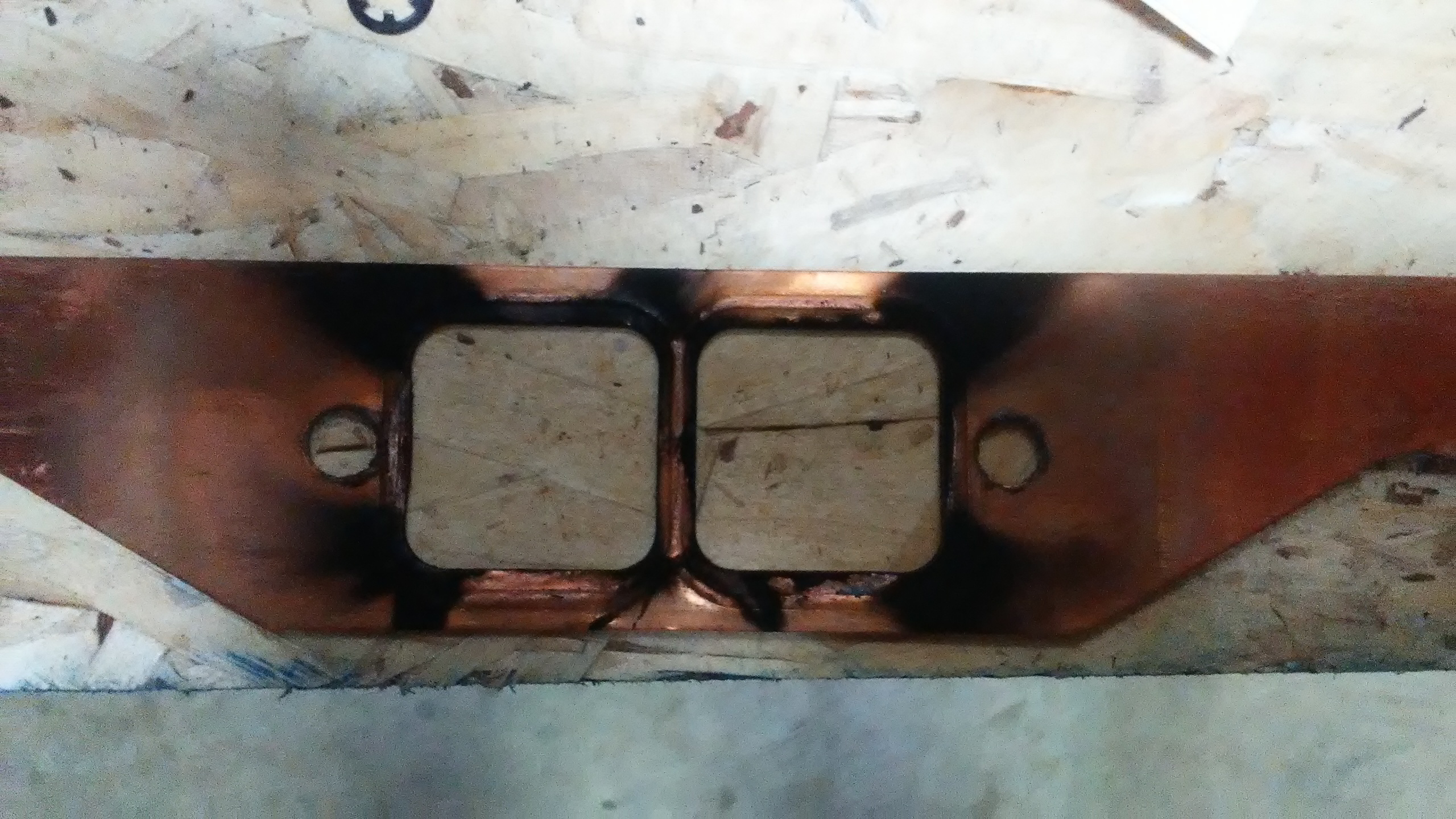

Removed the passenger side inner fender and found that header is leaking worse than I thought.
The flange is leaking by every one of the tubes as evidenced by the black on all four corners. Bolts are tight. Checked the driver's side and noticed just one leak there. I don't know why it would blow out on the corners like that. Those copper gaskets get many endorsements but that one didn't do it. May try some thicker gaskets or may use hi temp RTV.
WXO brought his AFR meter over today. Gotta get those headers sealed up before the AFR meter can be used.

Re: 1981 El Camino
A lot of guys don't agree with me on this, but I haven't used a header gasket in a VERY long time. Nothing but hi-temp RTV for me. Never had a leak with it.
Re: 1981 El Camino
BP,
Right. I've seen that from you and others. Couldn't do that on the Lincoln because there wasn't there just wasn't enough room to apply the RTV. Think I can use the RTV on the EC. Could be the right answer on these 1/4" flanges.

Removed the headers and discovered the reason for the leaks. The 1.5" round header tubes didn't reach the corners of the square exhaust ports and gaskets.
The copper gaskets were replaced with some Mr Gasket #7402G "reusable" gaskets I had on hand. I'm hoping the 1 5/8 dia, 1/8" thick soft aluminum gaskets will seal on the square ports.
I remember checking the copper gaskets against the ports (good fit). I did call Blueprint to get their recommendation on gaskets and was advised that the 1 1/2" tubes should be fine.
I was going to leave the passenger inner fender out till all this is sorted but the battery mounts on the inner fender. I will put jumpers to the battery, start the engine and check for header leaks before the inner fender goes in. Hope I don't have to replace the headers with some with square flanges.
