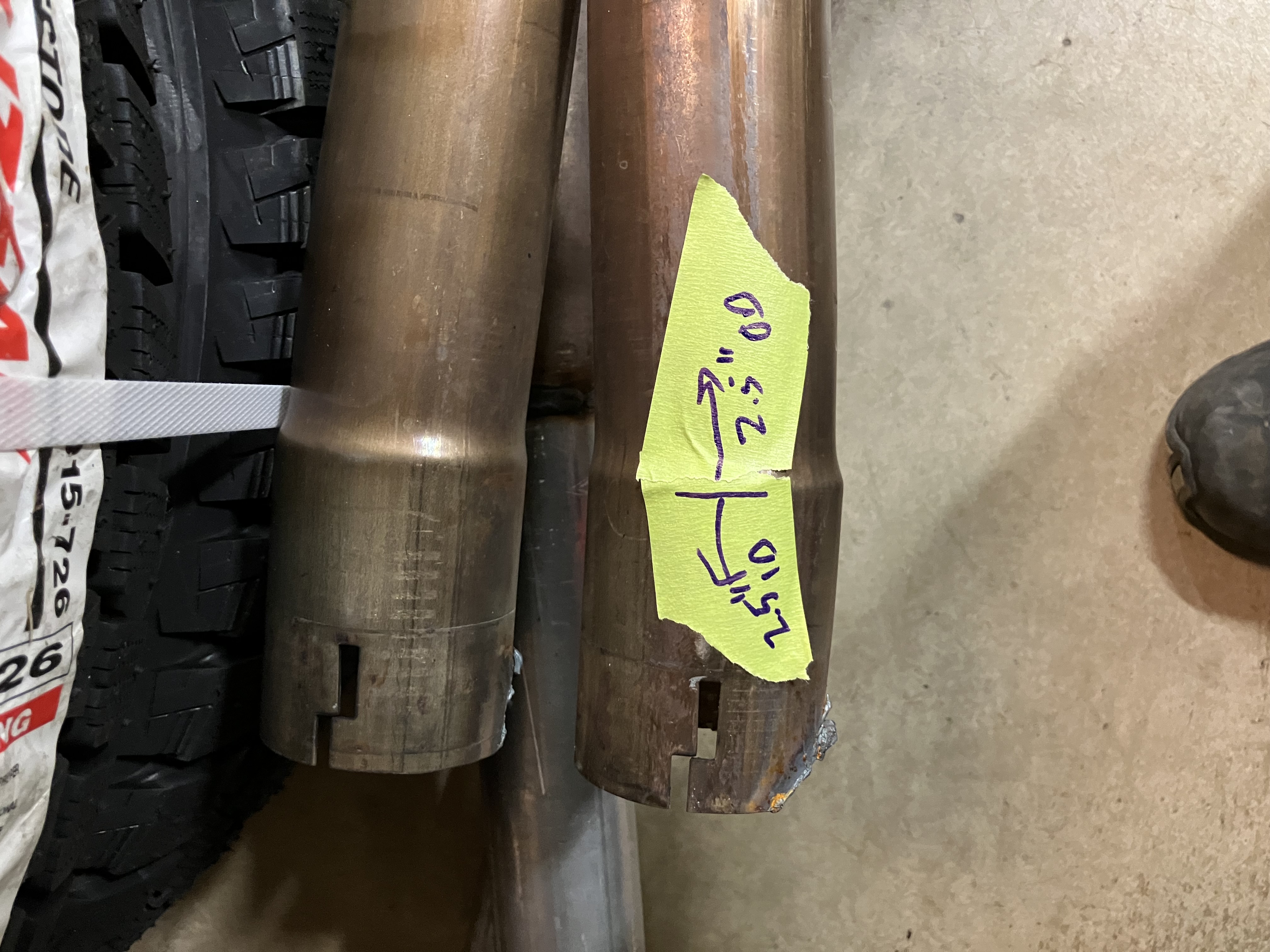

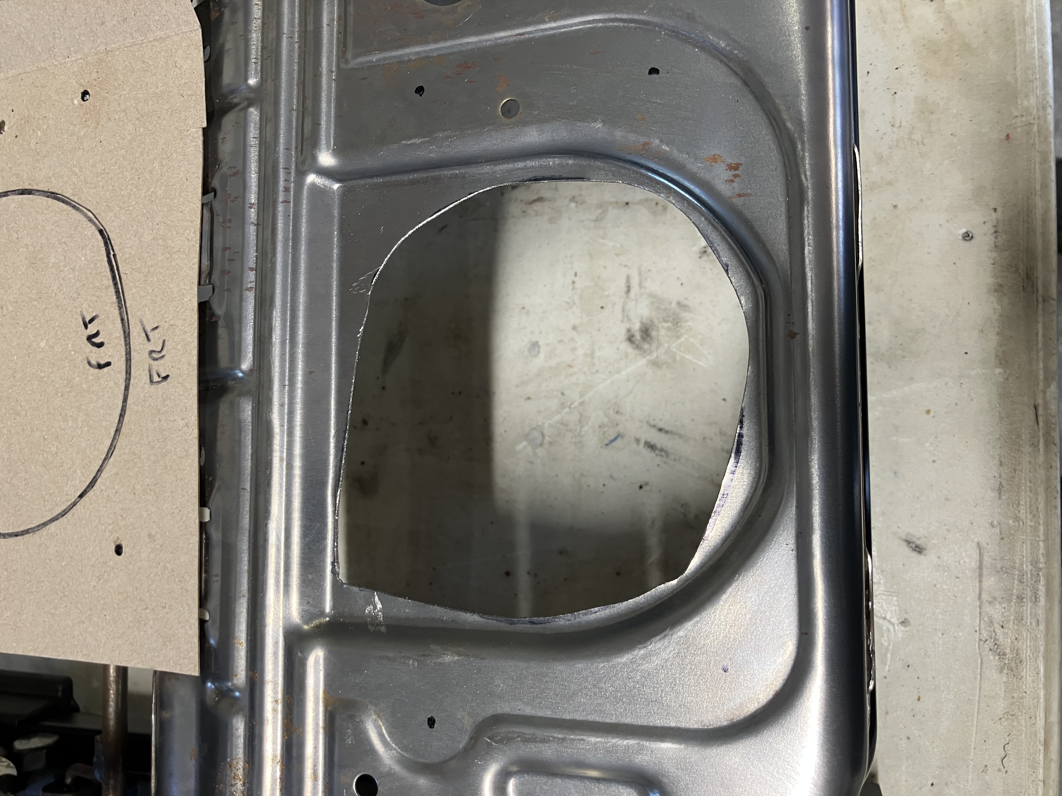

In order to fit this kit to the car, there are two issues - adapting to stock downpipes and exhaust tips. The downpipes on the car are 2.25" OD and the inlet for the catback system is 2.5" ID. My plan is to shorten these a bit and install an adapter. I was able to locate stainless steel adapters to fit both ends. I'll address the tips once the rest of the system is installed so I can see how tailpipes align with the openings in the bumper cover. The other issue is reassembling the tailpipes since they had been cut just past the muffler. Unfortunately in addition to the band clamps the installer had put several welds in to hold the pipe in place in the muffler. At first I was fairly critical of the installer, but reading the install instructed from Flowmaster I learned they actually recommend this to keep the system from moving. I took the time to grind those off, and re-align the separated pieces. These are currently with Kurt to get welded back together. The mufflers in the American Thunder Series are Super 40. I expect them to still be loud but hopefully interior sound at cruising speeds will be a lot better. This is the exact same system on Rachel's Charger so it'll be interesting to compare the sound between the V6 and V8 through the same system. There are mufflers that can be a little quieter in same dimensions as a fallback option.
