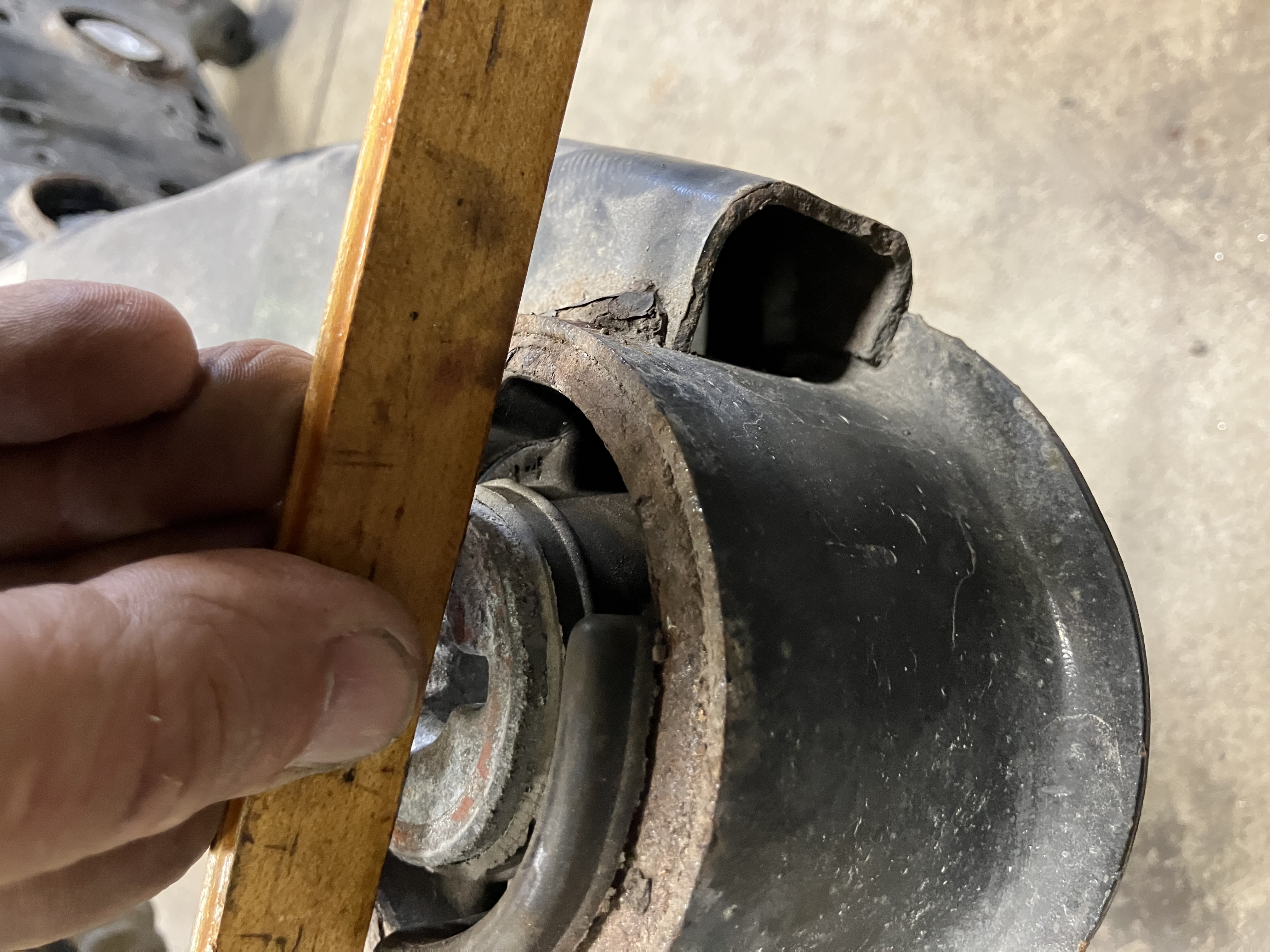

Within the past week I spent some time on the rear drivetrain/suspension.
One of the rear hubs had free play in it (was on the LR in the crash). I also discovered a small piece of the plastic inner fender that was apparently rubbing on the RR tire. Removal of the rear shocks did not uncover any obvious problems so I won't know if that is fixed until I driver it next. It took probably 3-4 hours to replace the RR hub and both shocks. At least half of that was the hub. I left the halfshaft in and did not disassemble the suspension. This adds complexity as there is not much room to reach the bolts. The rear hub looks like it has a rectangle shape pattern but really the top 2 bolts are a little closer together, which I learned while installing it.

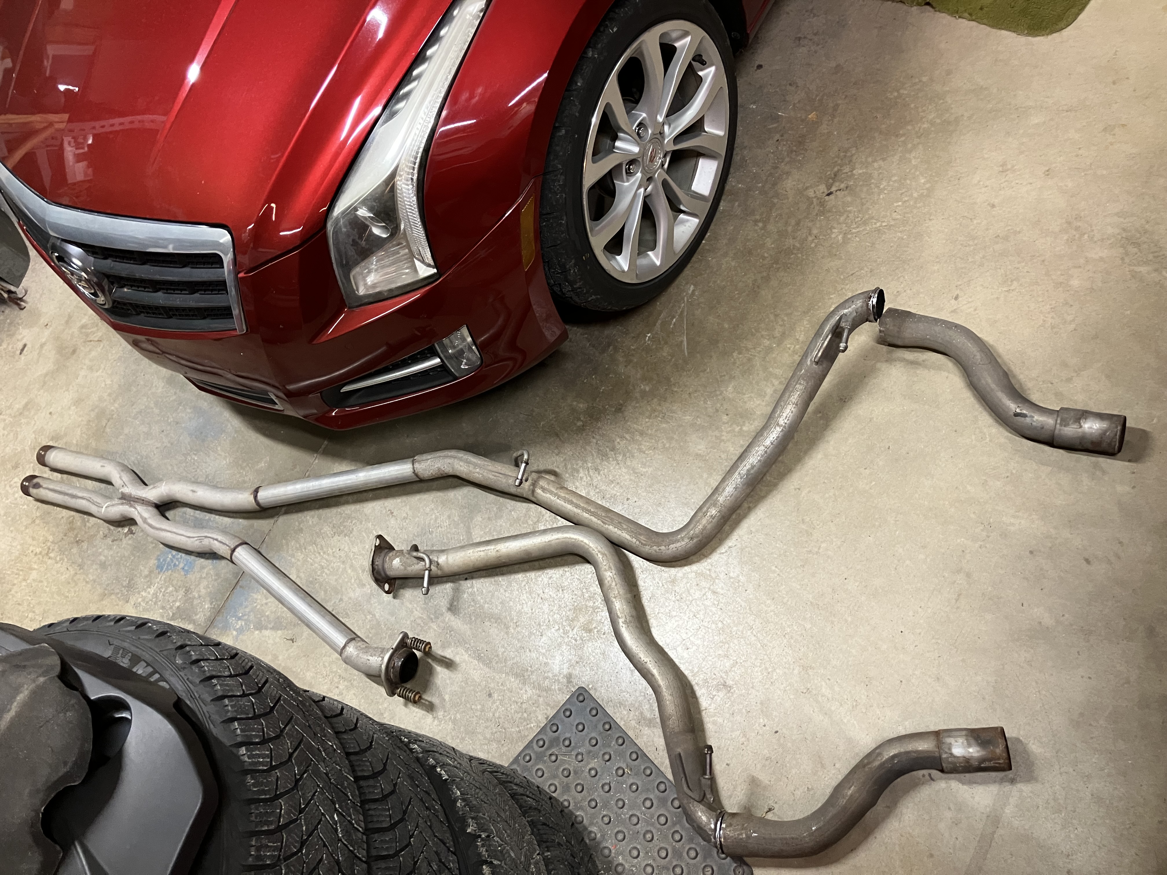

Went to work on exhaust. Decided to put the 2.25" Flowmaster knockoffs in back. Cut the welds to remove the muffler replacement pipes on the car (recall prior owner had converted it to all straight pipe) and started fitting in the mufflers. The knockoffs will fit back there but they had offset inlet and center outlet which put the outlet in a bad spot. I was ready to pull the trigger on a new pair with offset outlet, but before I did I though maybe I should check Facebook Marketplace.
As it turns out there was a used complete cat-back Flowmaster American Thunder series system available for $100. These kits are over $900 new. It was in Painesville so BP acquired it for me. The seller said the wrong kit was sent for her 2023 Challenger R/T, so the installers made it work, but in the end she didn't like the sound. She also threw in the stock system. Both systems had been cut when being removed. As it turns out the kit she had was from a 2014 Challenger not the 2023 Challenger. The part # she provided said it was 3" pipes which confused me for a bit, but with a little digging on the Holley site I was able to figure it out. This system has 2.5" pipes which I liked a lot better for the V6. Flowmaster offers a kit for the V6 which has 2.5" pipes which helps my confidence this is good size for this application. The difference of the older kit is how the exhaust tips work. This kit has ball type tips which would fit into the stock tips, whereas the newer kit would have dual outlet tips on both sides.
In order to fit this kit to the car, there are two issues - adapting to stock downpipes and exhaust tips. The downpipes on the car are 2.25" OD and the inlet for the catback system is 2.5" ID. My plan is to shorten these a bit and install an adapter. I was able to locate stainless steel adapters to fit both ends. I'll address the tips once the rest of the system is installed so I can see how tailpipes align with the openings in the bumper cover. The other issue is reassembling the tailpipes since they had been cut just past the muffler. Unfortunately in addition to the band clamps the installer had put several welds in to hold the pipe in place in the muffler. At first I was fairly critical of the installer, but reading the install instructed from Flowmaster I learned they actually recommend this to keep the system from moving. I took the time to grind those off, and re-align the separated pieces. These are currently with Kurt to get welded back together. The mufflers in the American Thunder Series are Super 40. I expect them to still be loud but hopefully interior sound at cruising speeds will be a lot better. This is the exact same system on Rachel's Charger so it'll be interesting to compare the sound between the V6 and V8 through the same system. There are mufflers that can be a little quieter in same dimensions as a fallback option.
Flowmaster exhaust has been installed.
At the front end of the cat-back system, I trimmed off some of the pipe so I could install some 2 1/4" OD to 2 1/2" ID stainless adapters, since the system is 2 1/2 and the factory pipe is 2 1/4". Factory pipe is 2 1/2" and it steps down to 2 1/4" for the join. The 2 1/4" end was a bit loose fitting so I slotted the adapter just like the stock exhaust so it can compress a bit and tighten up.
Kurt welded up the tailpipes - undoing the cut that was done on each side to remove from prior vehicle. Also had to weld up some cuts at the back end of the tail pipe. Looks like a ball socket back there so there was some grinding to smooth out the welds. I'm holding out hope I can install stock exhaust tips.
The install was fairly straightforward after all the up front prep work. I had to bend the rear brackets about 1/2" forward to get the bracket bolt to line up.
The fit is pretty good. The only issue left is the ball socket on the end of the tailpipe is about 1.5" too close to the bumper cover. I don't have the stock exhaust tips right now so I can address this later.
It sounds better though I won't really know until I drive it if these mufflers are doing what I want.

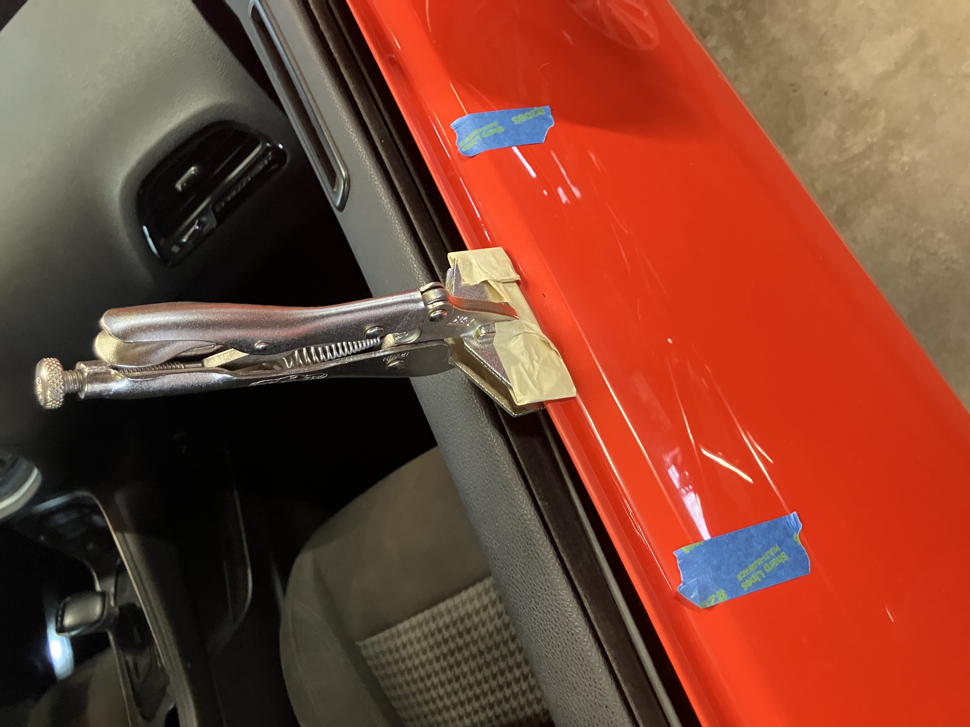

Today I had some time so I went to work adjusting the driver door window. It was a simple matter of removing the inside panel and raising up the window on the track just a bit.

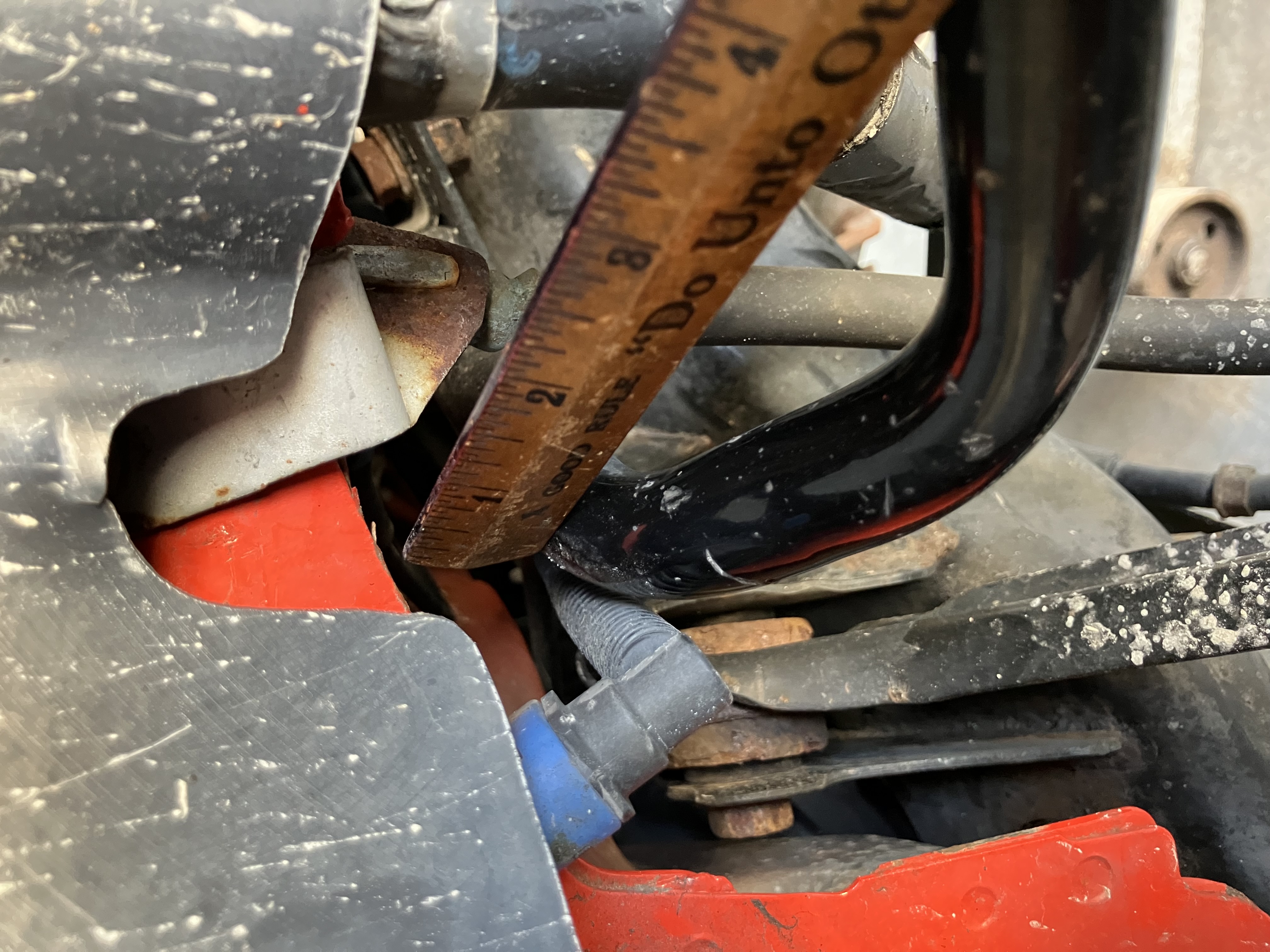

Had a little time last week so I started looking into the rear sway bar. I jacked up the car and disconnected the left side from the knuckle. With both rear wheels at maximum suspension travel the bolt had almost no tension on it and the bolt hole in the stabilizer link basically lined up with the attaching point on the knuckle.
Putting the car back on the ground uncovered put the now unattached sway bar at least two inches low on the driver side.
Further inspection finds a noticeable difference in the gap between the chassis at the bottom of the inner fender and the rear sway bar.
I decided to drive it without the stabilizer link on driver side. I kept the passenger side one on the just to keep the sway bar from slipping down while driving and rubbing on the suspension. Now it pretty much drives like there is no rear sway bar. I am not 100% sure this is the problem but it does not seem to throw the car as much on uneven surfaces.
The question is what to do next. In order to remove this bar the rear subframe has to come down. I have to decide if I want a stock swaybar, one from an R/T or other stock bar, or an aftermarket. I also have to weigh the additional effort of completely replacing the whole subframe (removal is probably 50% of the work) to eliminate that as a variable. Literally all the other rear suspension parts were wrecked and while the subframe looked OK its possible a small amount of damage is messing up the suspension in some other way. The front subframe was like $200 so its not a big expense. I'm still contemplating....

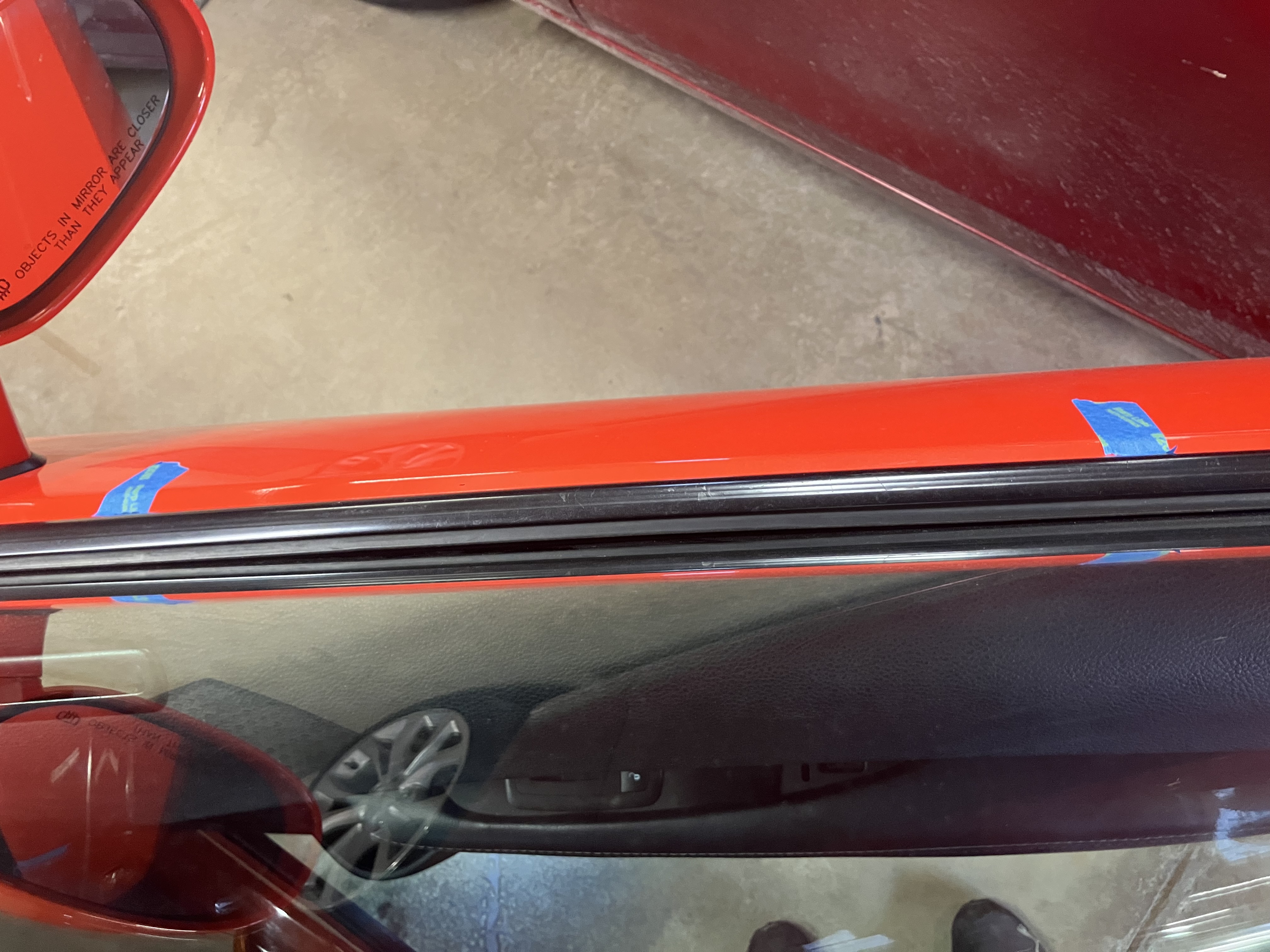

Made some repairs on the passenger door. There is a gap between the window and the seal which I addressed by removing the outer seal and adjusting the metal a bit. After that I removed the interior door panel to reinstall the the sound deadener/water barrier I forgot to put in when I was reassembling the car.

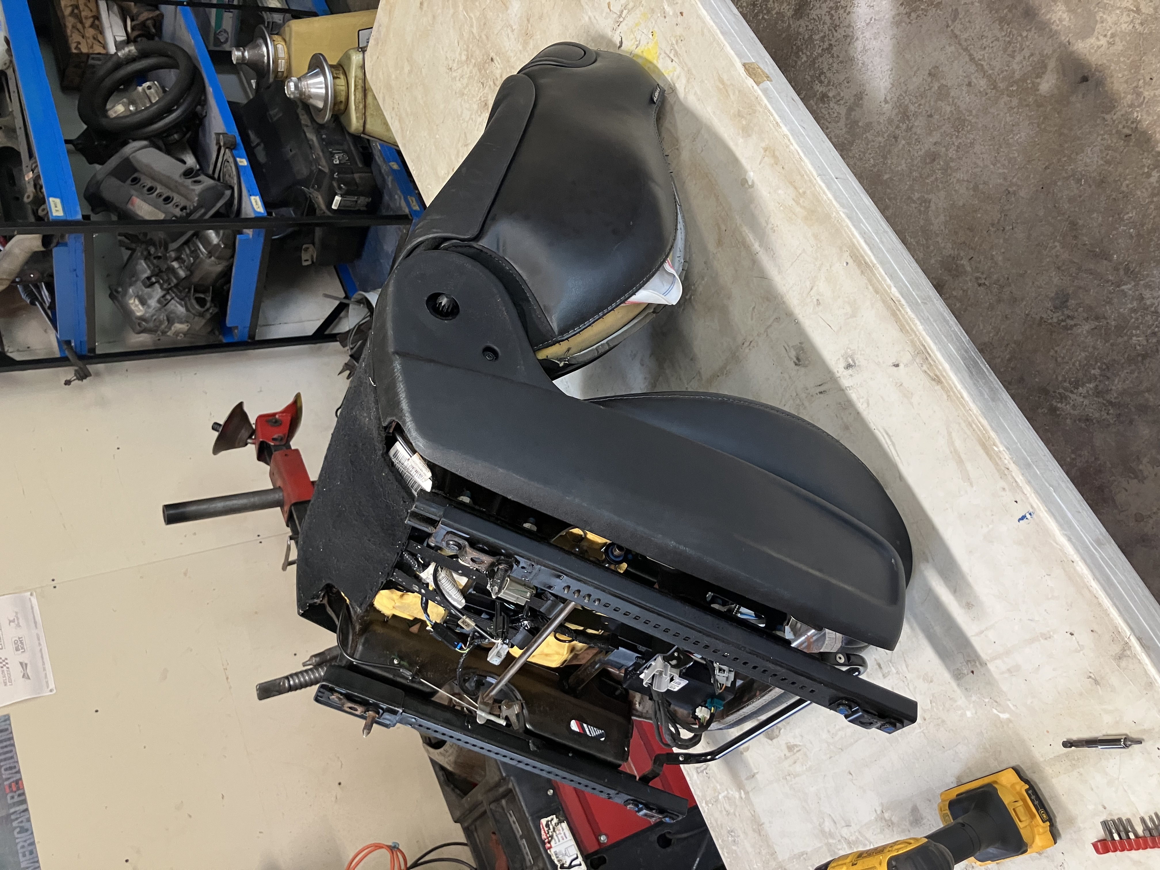

Side project: Seat cooling passenger side
The SXT Plus model has heating and cooling in the front seats. As I learned with the driver seat, the replacement seats I purchased were from a base model and didn't have these features. I have been thinking about doing this upgrade - but what prompted me to do it now is I wanted to get the old seats out of the garage. Started by disassembling the old seat. To get the seat covers off and on its best to separate the bottom from the back of the eat. The tricky part of disassembly is removing the cover from the seat foam. There are hard plastic tubes (drinking straw in thickness only longer) that snap into plastic clips that are embedded in the foam. If you're not careful, the clips pull up out of the foam. Also I found some of these clips to be broken on the old seats. I had to use the seat foams from the original seats as they are formed just a little different to accommodate the cooling parts. I was planning to use the original seat frame and move the covers and airbag over, but that plan got derailed. I first noticed the upper frame was bent which was not surprising based on what I had seen disassembling the original driver seat. Looking at the seat base I also noticed it was bent down - measuring showed it was 1/2" lower than the replacement seat. I don't pretend to know what happens in a crash but the front edge of bottom of the seat got enough force from the passenger the metal got bent down. Switching plans I then completely removed all the wiring from the original seat. I also had to cut a hole in the bottom of the seat frame to accommodate the set base cooling unit. Transferring the control module required moving a bracket, but the holes were already there in the frame so I just had to drill out the rivets on the old one and put some 3/16" rivets to work on the new one. Those rivets have been waiting here a long time to get to work. When I was early in the rebuild I bought a set of used stock seat covers. While it was apart I took time to compare the condition of these covers vs the one I had. Well those were cleaner so I chose to put them on.
The task is not technically complicated, but there are a lot of parts in a seat. At some point I figure I will move these cooling components into the driver seat too. Older driver seat already disassembled, so a little less urgent to do to get rid of the old parts.
