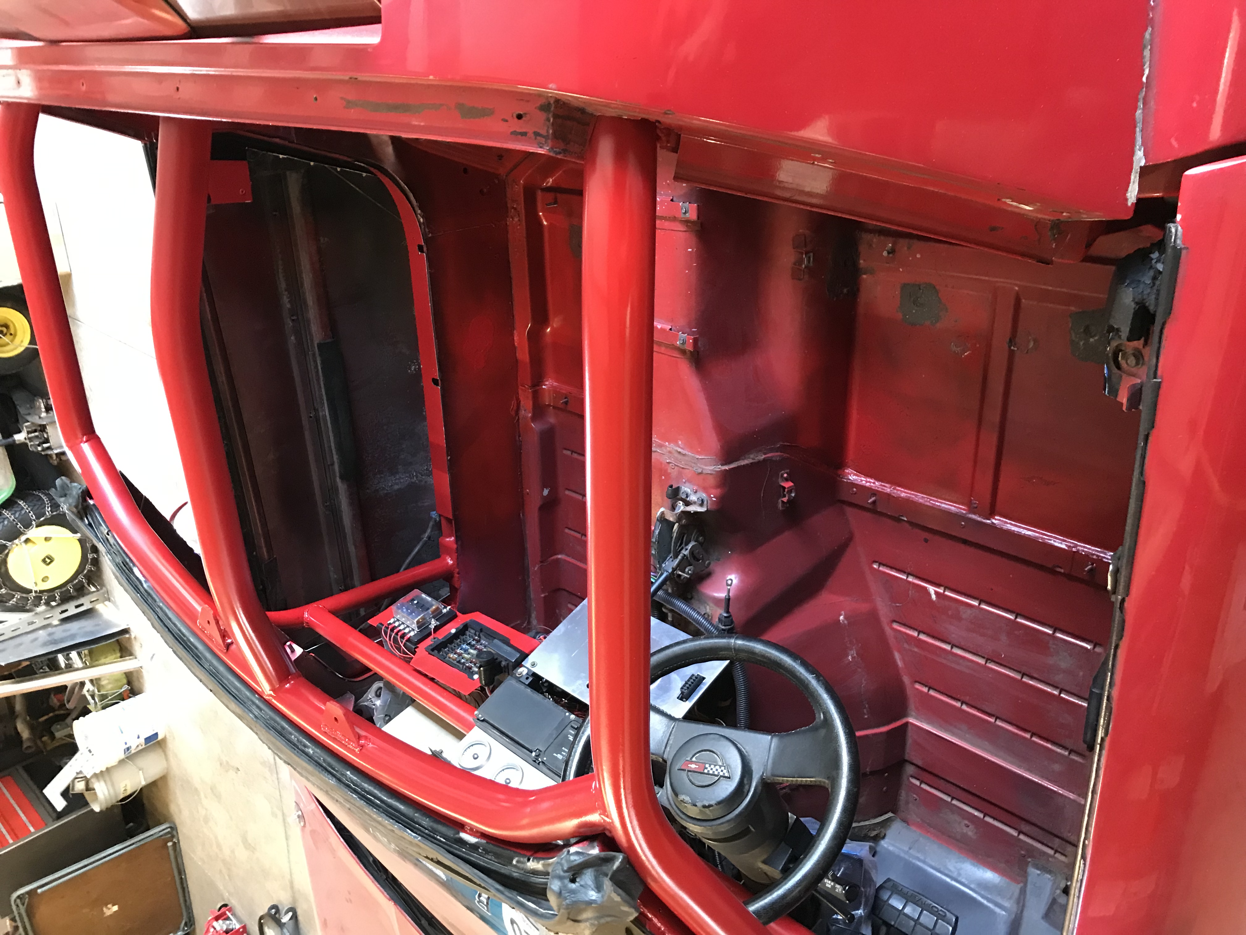

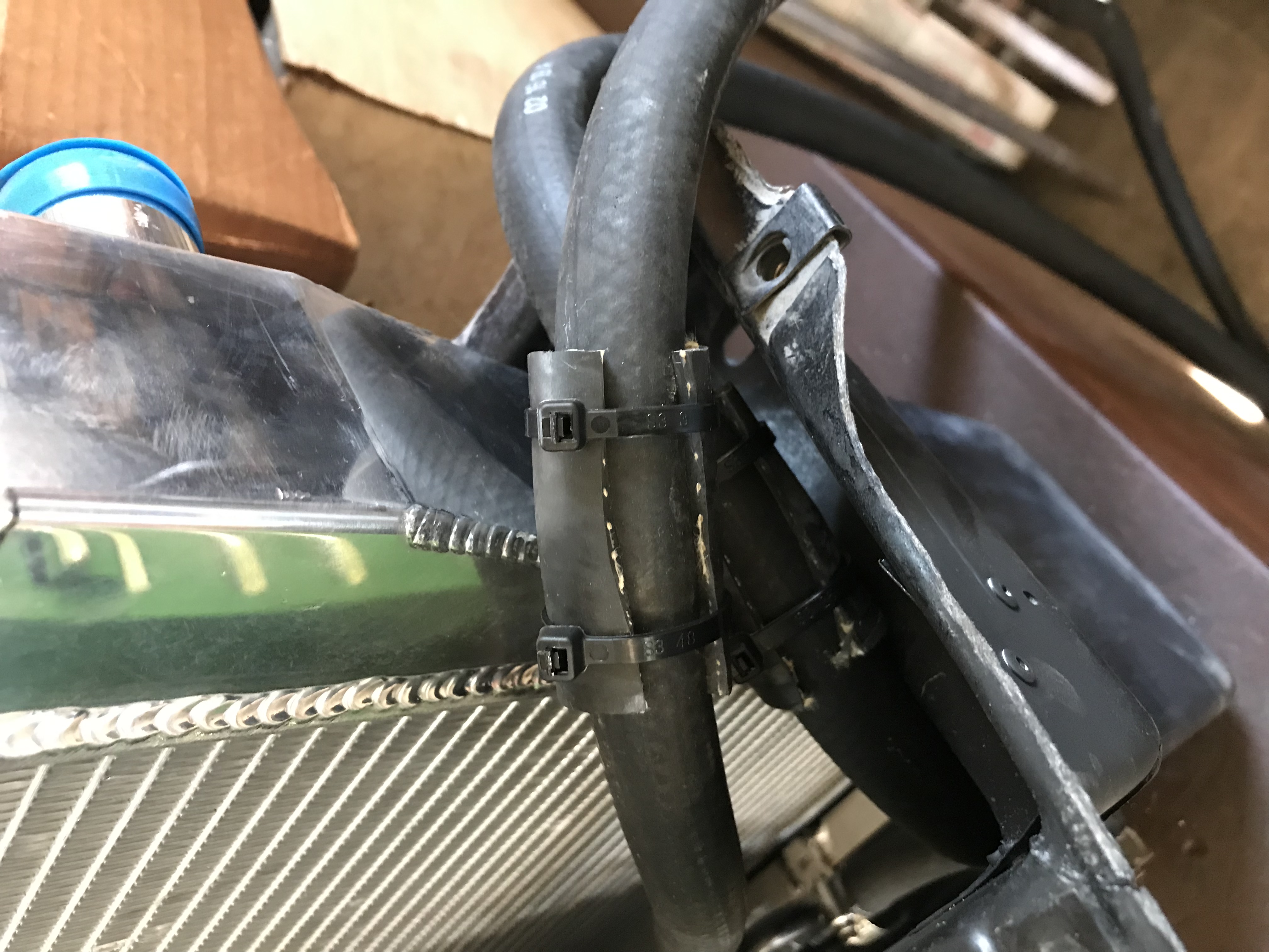

Finished up the interior wiring for now. Made a nice little bracket to hold the low coolant sensor and did some wire looming and organizing in the back. It looks pretty good. Also took a few minutes and reinstalled the fuel tank door.
For the interior, some upcoming to do items
- fabricate brackets/install the Longacre rear view mirror
- fabricate/install GoPro mounting bracket
- fabricate/install covers for ABS compartment and soon to be battery compartment
- paint a lot of the roll bars (still have a few more places to weld that won't want paint yet)
- passenger seat bracket fab and install

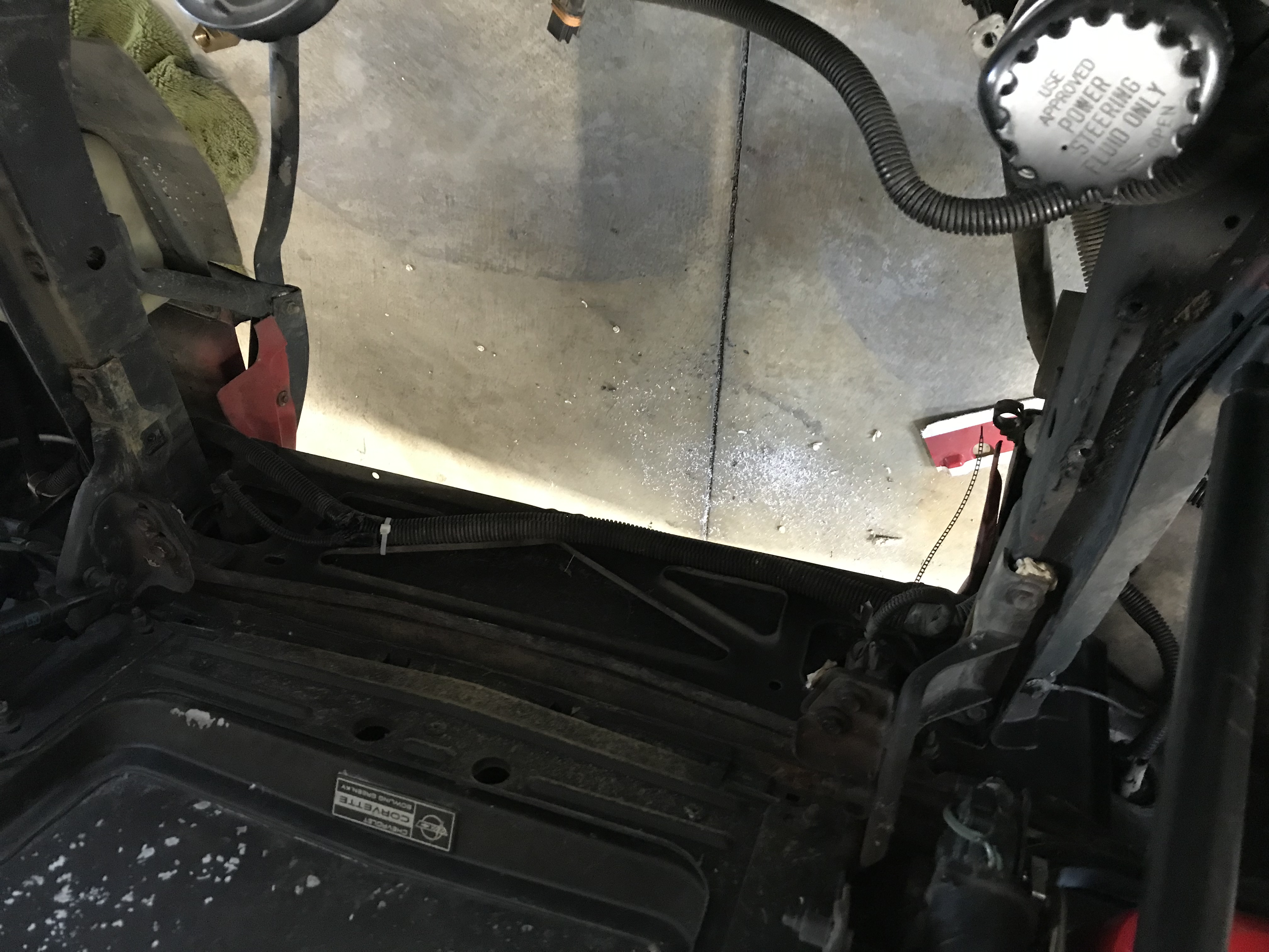

Found the brackets I started for the passenger seat. Started mocking it up and noticed some problems with seat positioning - cannot get it as far back as I want using the stock studs without cutting the seat for access to install the nut. Must contemplate next steps here - might be to get another seat. I can't use the stock seat belts as the roll bar blocks the bolt hole for the should belt attaching point.
Calibrate the TPS following the instructions I shared on BP's Vette thread. Note: raising the connector end raises the resistance and vice versa.
I also connected a wire to the rear latch so I don't have to reach all the way back there to open the hatch.
Test drove the car. I think it might challenge a stock L98 for like the first 60 feet but the truck heads and cam just don't wind up at all. Also this might be the first time I drove this car in warm weather. The heat off the transmission tunnel is noticeable - just a regular street drive and the highest temp I got off that tunnel was 125 degrees. Some kind of heat insulation is going to be very necessary for any type of extended summer driving with this car.
Edit: ordered the 7/16” Delrin rod as suggested in the video to fix the pop up headlights open/close system.

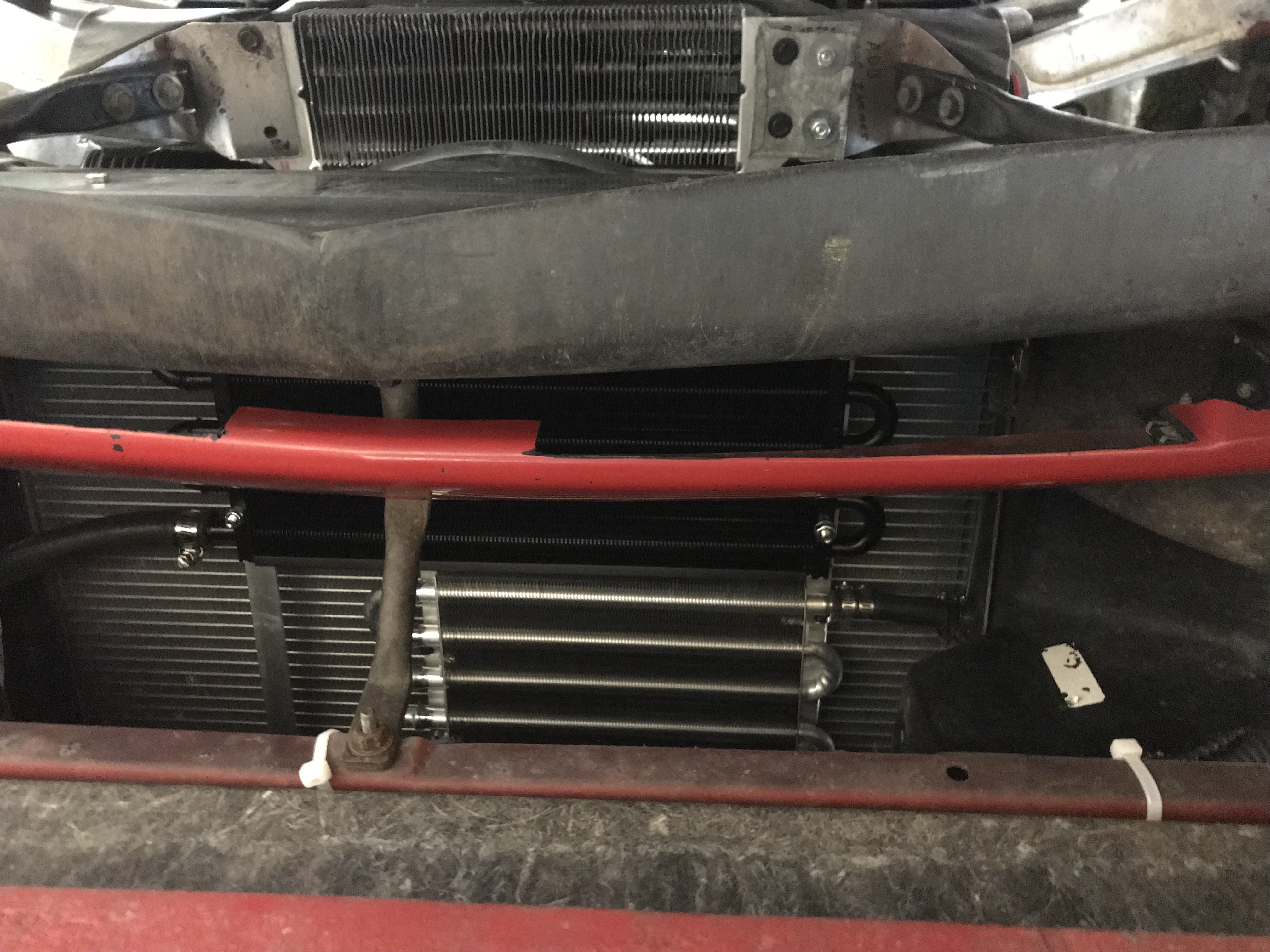

Earlier this year I fit the heavy duty radiator into a spare shroud I had acquired. It has been patiently waiting for me to finish the work and install the other coolers. With the car running I decided to tackle this project next. I fabricated a frame from 1/8" x 3/4 aluminum bars to attach in front of the radiator inside the shroud - and with a little help from Cut N Paste and his TIG welder it is assembled. After that I drilled all the holes to attach the frame to the shroud.
Also the coolers needed attached to the frame. For the trans cooler I riveted small 90 degree tabs to it with small holes in each to bolt it to the frame. For engine oil cooler I expanded existing holes in the end supports to fit a 1/4-20 (oops meant to do 10-24). For each I then placed them on the frame and drilled the holes to align.
I also determined the top tranny line into the radiator is the supply from the transmission. Since I plan to chain the stock cooler and the aftermarket cooler together I will put the aftermarket one second in the chain. With this info I started fabricating the line from the trans cooler out to the aftermarket cooler in. I had also made a drawing and figured out all the fittings I need and picked up the few that I did not already have in inventory.
I'm contemplating using some type of metal piping for the oil supply and return lines as well to limit the risk of damage to the lines under the hood. It's kind of busy on the driver side and I will have to navigate around the power steering, alternator, the main shaft of the steering column, and the exhaust. I still have some figuring to do on this part.
The overall plan would be to get these coolers in so I can try them out at a track day yet here in 2022.

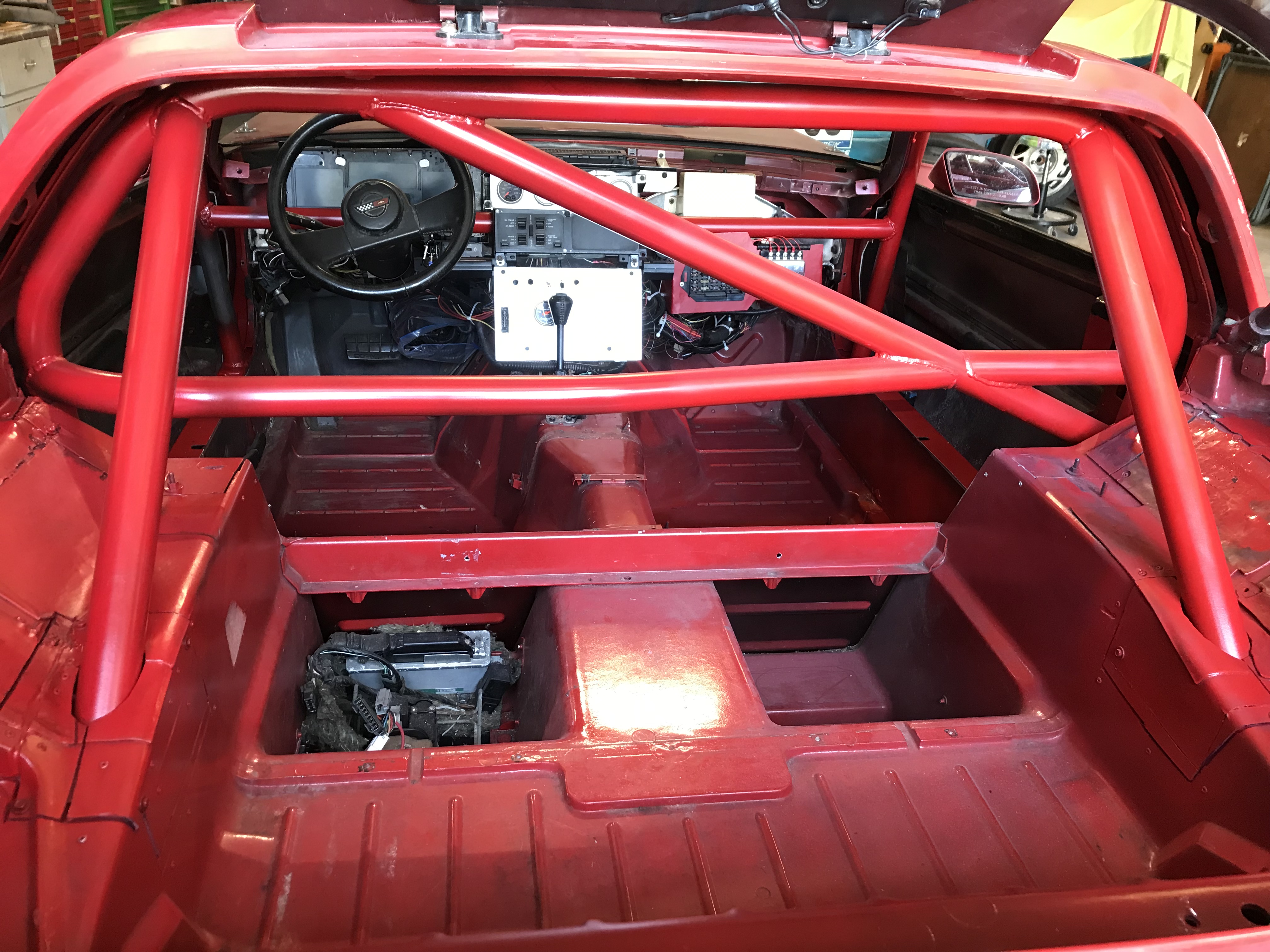

After some thinking I decided the inexpensive viper red was not a good match. The price was right but I found a video of a guy who used it and compared the color to the Vette and it was not very close. Would have needed a 100% repaint, so my choice is to crack open the old red acrylic lacquer I had from my 87 Camaro. I wanted to apply more selectively than my Devilbiss gun could offer so I spent $15 on an inexpensive spray gun from Harbor Freight.
Other paint preparations included draining the air compressor tank, and fixing the air hose on the reel in the garage. The day before the hose started leaking. It's like 5 years old but only been used for 3 months.
Fred32v was over on Friday to get the interior paint done, bringing some necessary supplies.
On the car we
- cleaned up surface pitting on the floor
- masked off everything that could catch overspray
- disconnected all the interior wiring to the ABS, fuel tank, tail lights and packed them up under the dash
- seat and seat belts out
- vacuum up the interior surfaces and clean up the floor
- prepped and primed the last bits of roll bars and the floor
We also had to play with getting decent air pressure to the gun and have an evaporator setup. Once that was done it was just a matter of mixing up the paint and putting down the paint. It's been a long time since I put down lacquer, and this little gun put out a lot less paint which was helpful but took some adjusting. I really liked the small gun and it had a lot less overspray than the large gun or spray cans.
The paint laid down decent. I still have to put it all back together.
There is going to be one more paint session after the door bars are installed, where I will cover the remainder of the floor behind the seat, and anything else that was missed.

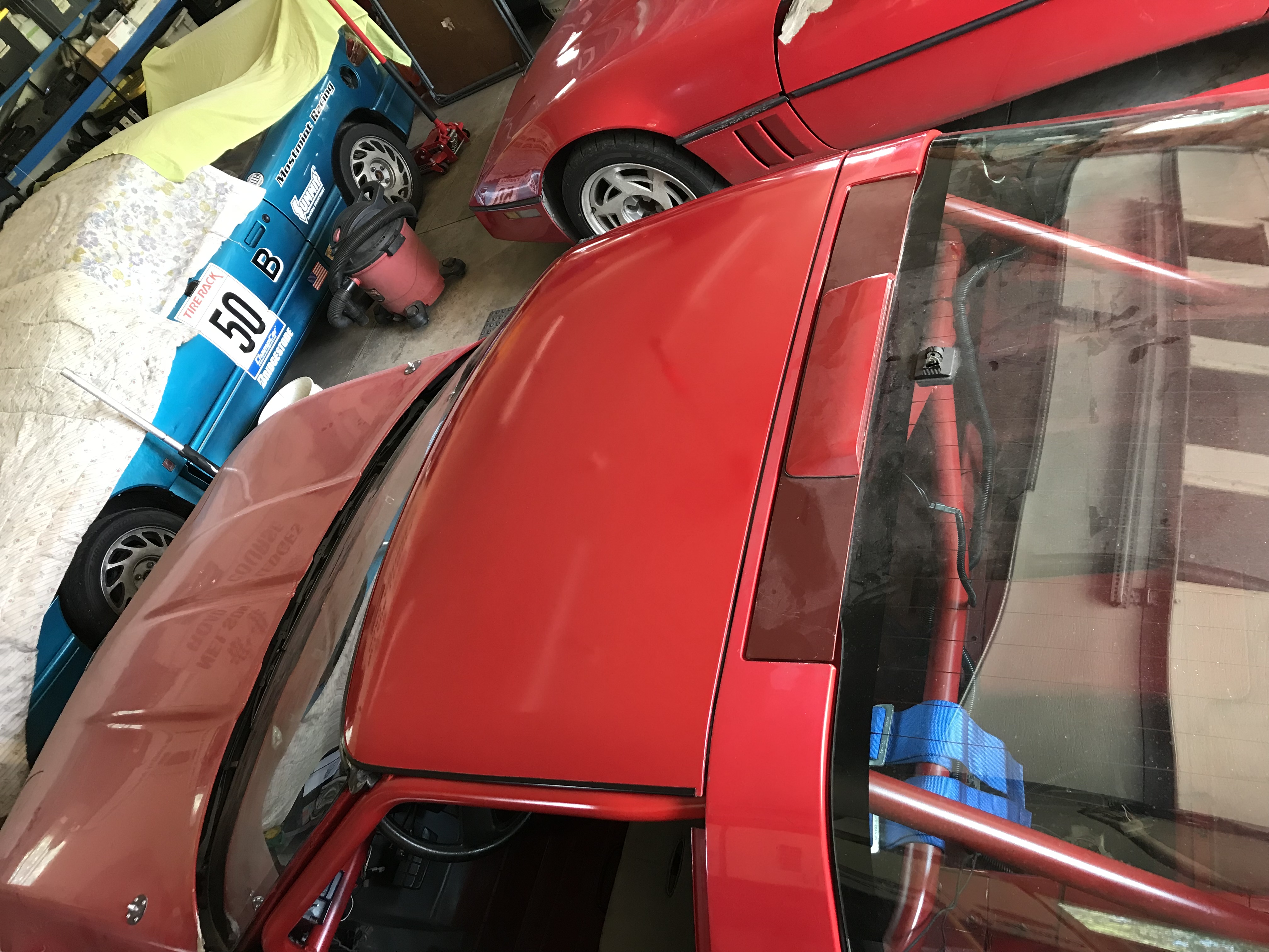

The top was some beige metallic. I dipped into my remaining stock of red and painted the roof to match the car. I chose to clean with wax and grease remover and sanded it with 320.
I lowered air pressure and put my Devilbiss to work. It laid down the paint so nice at something like 20 psi.

I put some more time in on the cooling systems. Both engine and transmission oil coolers are attached to their new bracket in the radiator shroud, and I roughed in a path for the engine oil lines through the shroud and more transmission line fabricating.
I followed that up by removing the radiator and shroud from the car. Hopefully assembly will be straightforward.

During rough assembly, we put the top grommets in the shroud and quickly learned the Frost Bite radiator that is a “direct bolt in” is actually about ¾” shorter than the stock radiator. When Fred32v was over he fabricated extensions for the top rubber grommets. We also did quite a bit of trimming to simplify the install of the top part of the shroud with the radiator and transmission lines in place. While I was attempting to connect the fan to the lower half of the shroud, I learned this was almost impossible inside the car as the power steering cooler is right there in the way. Removing the shroud for this helped facilitate the fitting of the new grommets.
The transmission lines needed additional fabrication – trimmed the factory return line and flared it. Completed bending the line from the cooler to the factory return line.
While the shroud was out I got the idea I should fix the front part of the inlet ducting. The bottom edge was quite bent and it took some straightening to get it right. There is a plastic air dam underneath and it was bent back so not helping push air up toward the radiator, so I took some time to bend that back to correct positioning. I also washed all these parts so I wouldn’t have to handle these dirty parts the whole time.
There is a red deflector in the middle of the inlet which I left, though I trimmed off the bottom part with the intention of letting more air through. The NCRS judges will approve of the factory date markings
With the inlet ducting and main shroud out I got the idea that now is the time to open up the front bumper and let some air in that way as well. With these parts out I literally pulled my garage stool into the opening and could sit there in front of the engine. I started by cutting a hole in the license plate area, then cutting a hole in the fiberglass – yes the bumper is mostly fiberglass.
After that I trimmed back a couple of the aluminum brackets to create a bigger opening. As it turns out this will mostly allow more air to the radiator though about ¼ look like its headed to the air filter.
After those diversions I set to putting it back together. First the inlet ducting, then the main part of the shroud, radiator, then the transmission lines, cutting the short bit of hose I need and making the final connections to the transmission cooler. Next step was to install the top of the main fan shroud, the air cleaner, low coolant sensor and double check everything for tight. Last step was to put coolant in it. It took over ½ gallon more than what came out of the car due to extra radiator capacity.

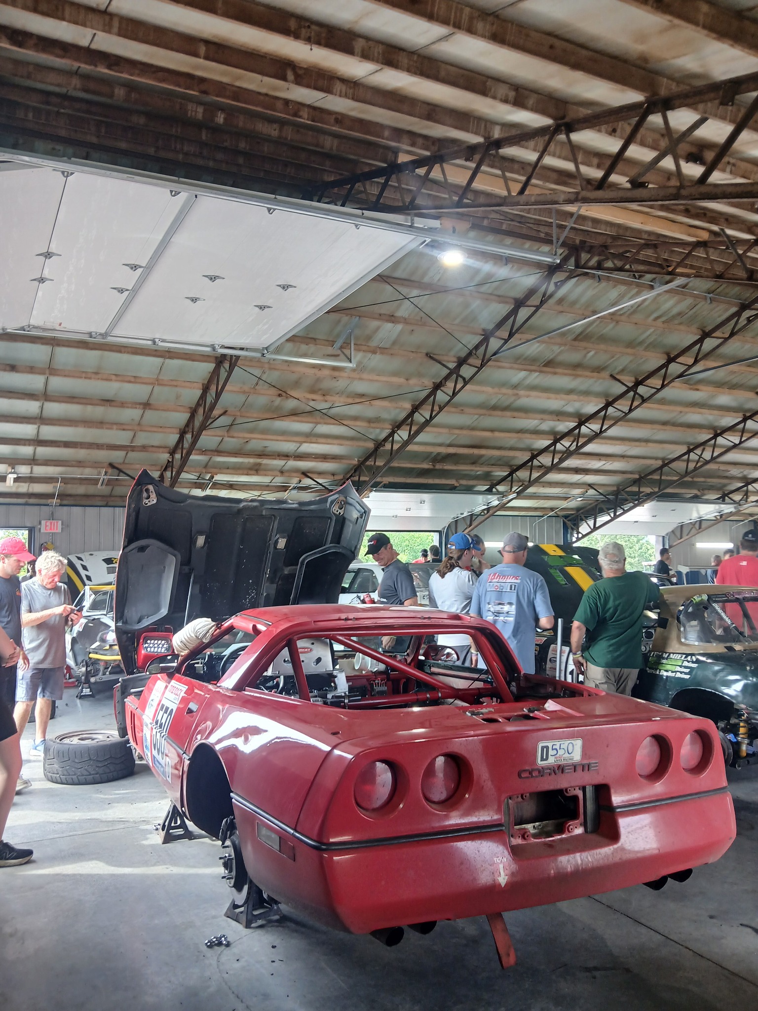

There was considerable grinding from the car on the way back from the dragstrip. Since the wheel bearings were in stock here and Fred32V was coming over, the Vette got some attention last Friday and all four bearings were replaced. The rears look like they were leaking grease - maybe a really long time ago. First test drive will confirm if the bearings were in fact the problem.
It also had a problem where it would not start after I was sitting in line to enter and a lot of on/off. Best guess is heat soak into the fuel lies up front - will insulate them before going to the drags again.

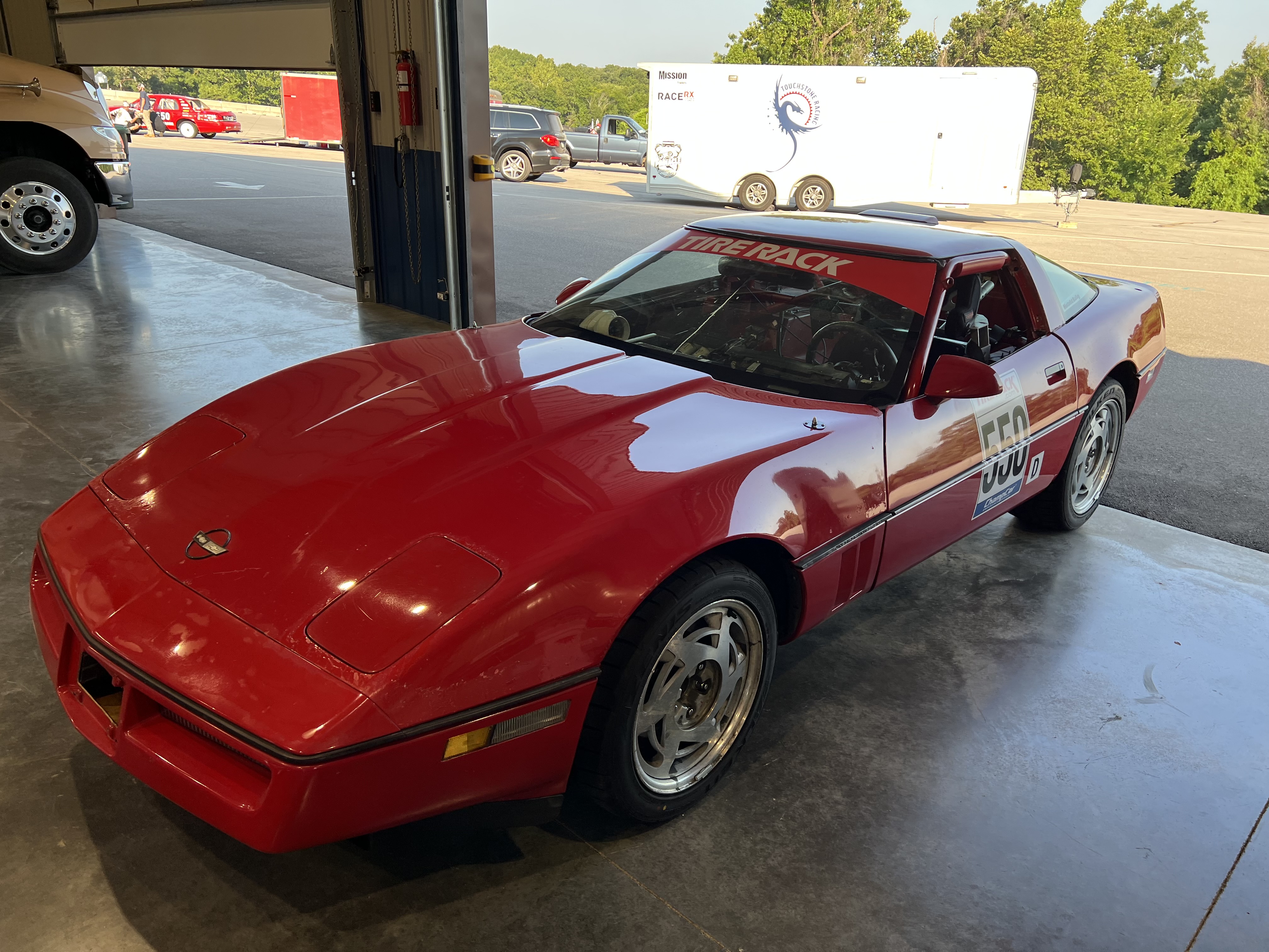

Yesterday I sold the Corvette. Actually I sold the entire Corvette race car development program as there were many yet uninstalled new parts and a boatload of spares.
I’ve been consistently passing up opportunities to drive other peoples cars which is a sign my desire to do endurance road racing has faded. It just didn’t make sense to finish a car I’m not going to drive. It took a solid 18 months to convince myself it was time for it to go.
My friend Troy traveled here from MN to pick it up with a stack of spares. I’m excited to see it finished and out on track.

Being the first race for a new build I'm not expecting great finishes but I am hoping to see some competitive lap times.
Re: 89 Corvette Mostmint #39
The Vette did well in its debut. It finished P6 on Saturday and P7 on Sunday and won D class both days. About 35 cars in the field
It’s still on the stock springs so there has to be room for improvement once he gets the Z51 suspension installed
It appeared to me it was making 2 hrs on a tank as well.
Super happy with this outcome
