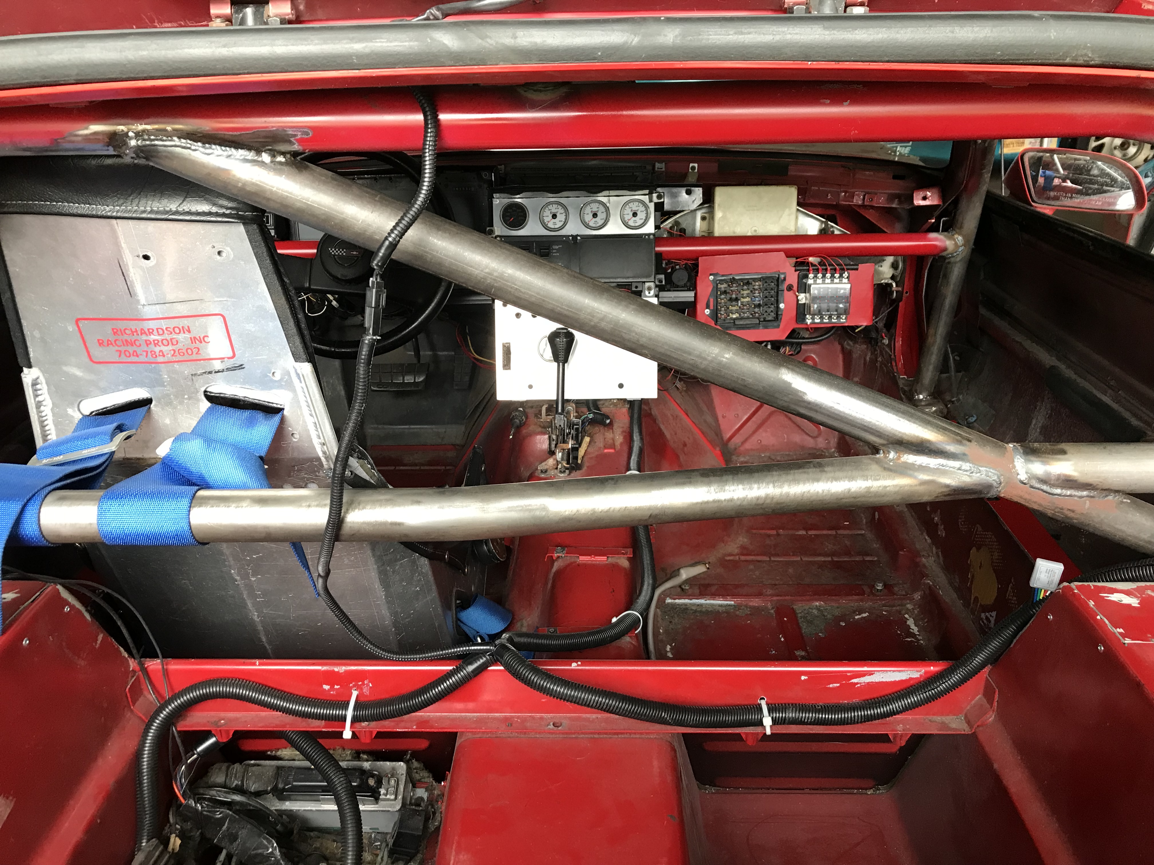

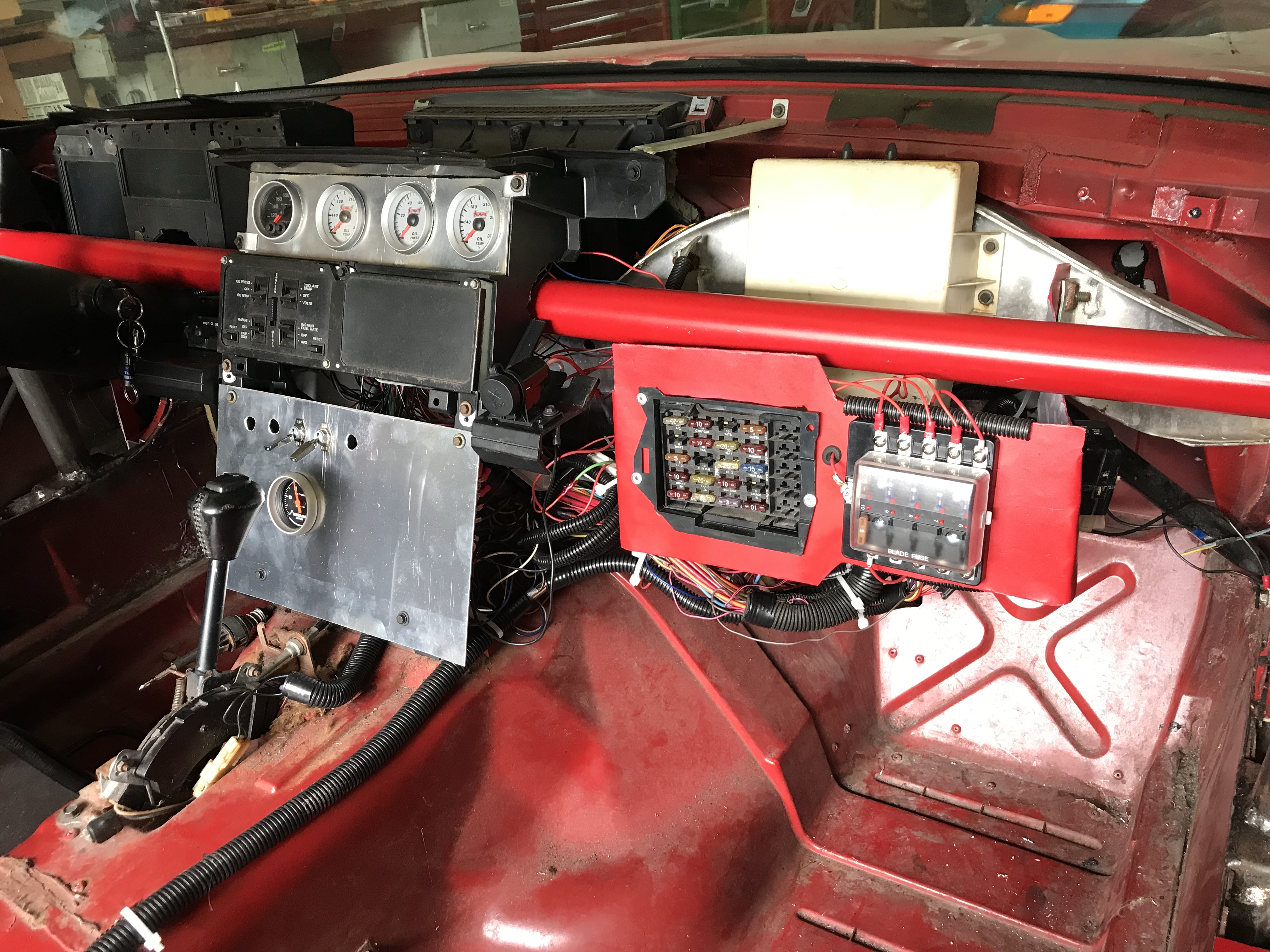

Finished up the interior wiring for now. Made a nice little bracket to hold the low coolant sensor and did some wire looming and organizing in the back. It looks pretty good. Also took a few minutes and reinstalled the fuel tank door.

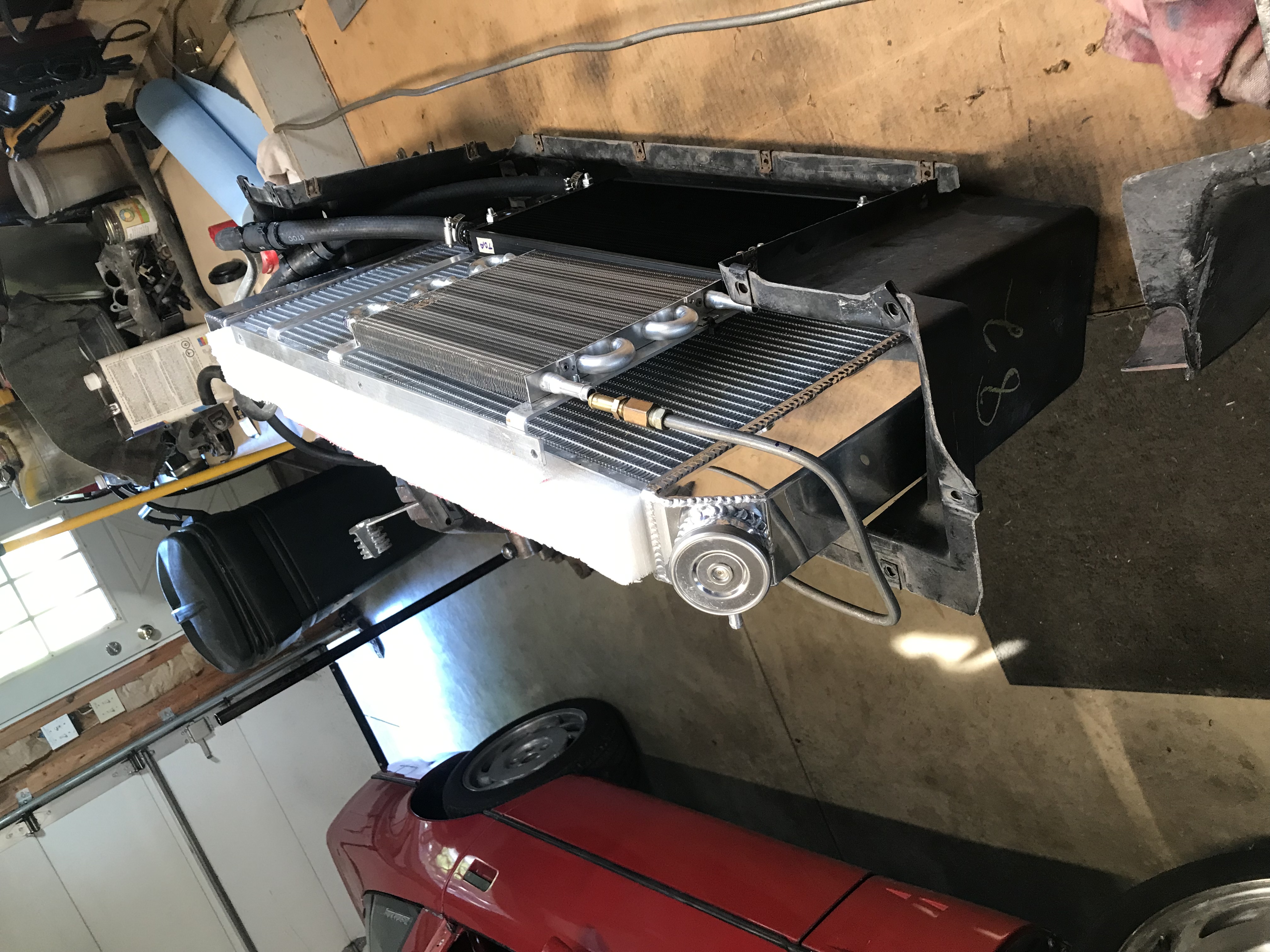

Earlier this year I fit the heavy duty radiator into a spare shroud I had acquired. It has been patiently waiting for me to finish the work and install the other coolers. With the car running I decided to tackle this project next. I fabricated a frame from 1/8" x 3/4 aluminum bars to attach in front of the radiator inside the shroud - and with a little help from Cut N Paste and his TIG welder it is assembled. After that I drilled all the holes to attach the frame to the shroud.

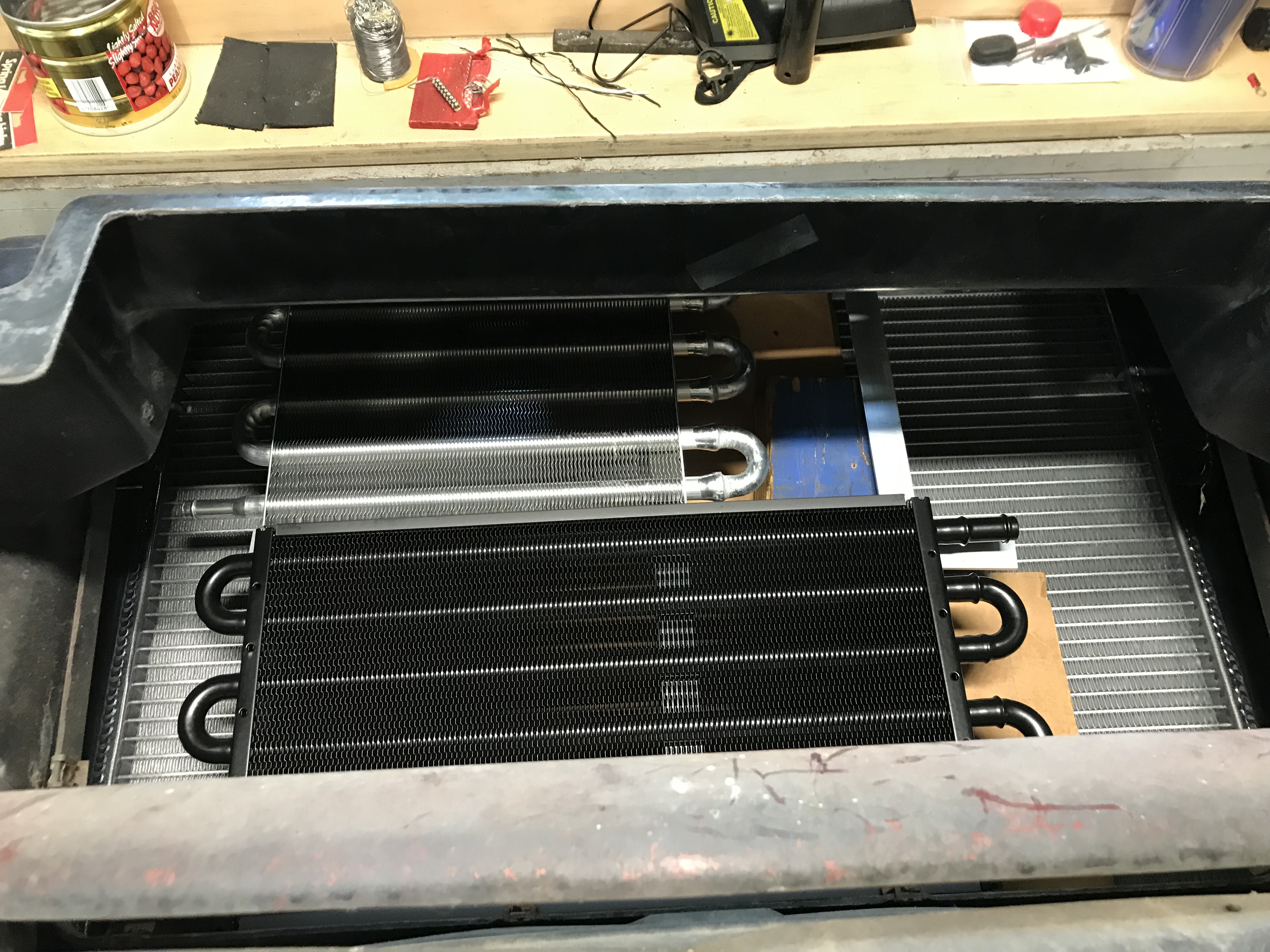

Also the coolers needed attached to the frame. For the trans cooler I riveted small 90 degree tabs to it with small holes in each to bolt it to the frame. For engine oil cooler I expanded existing holes in the end supports to fit a 1/4-20 (oops meant to do 10-24). For each I then placed them on the frame and drilled the holes to align.
I also determined the top tranny line into the radiator is the supply from the transmission. Since I plan to chain the stock cooler and the aftermarket cooler together I will put the aftermarket one second in the chain. With this info I started fabricating the line from the trans cooler out to the aftermarket cooler in. I had also made a drawing and figured out all the fittings I need and picked up the few that I did not already have in inventory.
I'm contemplating using some type of metal piping for the oil supply and return lines as well to limit the risk of damage to the lines under the hood. It's kind of busy on the driver side and I will have to navigate around the power steering, alternator, the main shaft of the steering column, and the exhaust. I still have some figuring to do on this part.

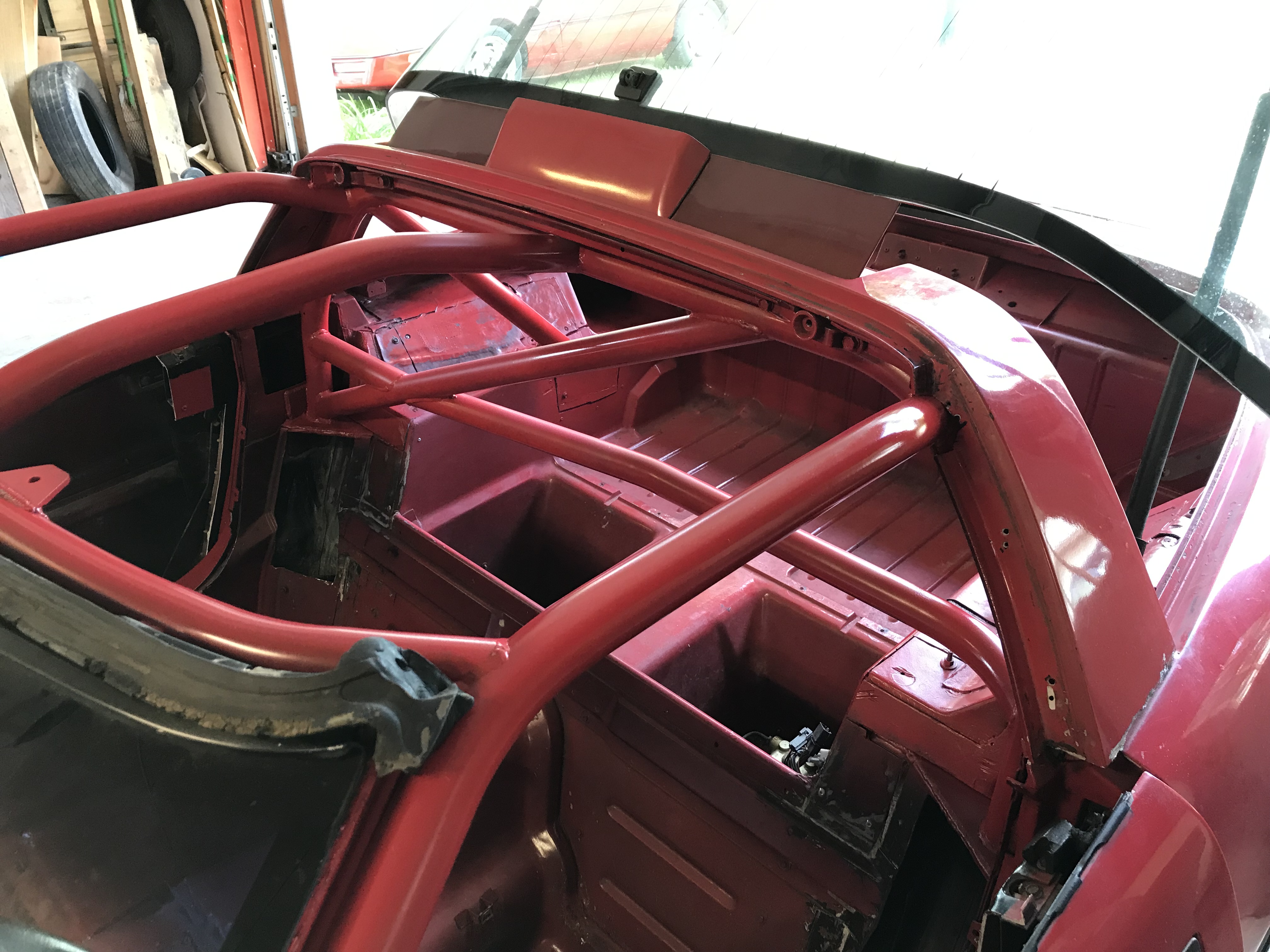

Also, Fred32v was over and got to work on painting the roll cage. A lot of the bars had surface rust so that needed cleaned up, we had to remove a bunch of stuff from the interior, and lots of taping. We got the bars primed but only one side painted. I chose color matching red for the paint, which I was getting in 8 ounce aerosol cans. Well its now like $16 per can and they go fast, so we didn't have enough to finish. We have to make some decisions about painting the interior - as the primer overspray got on a bunch of the floor, and there are a couple rust spots on the floor. I am not able to find any reasonably affordable color matching paint - I'm seeing acrylic lacquer for close to $400 per gallon. I have some lacquer that is the correct color so that may be the option, or I can explore other colors that are much cheaper such as this acrylic urethane from Summit https://www.summitracing.com/parts/sum-up303g I'm hoping I can at least see a sample of this in real life to tell if its close enough.

Fred32v was over on Friday to get the interior paint done, bringing some necessary supplies.
On the car we
- cleaned up surface pitting on the floor
- masked off everything that could catch overspray
- disconnected all the interior wiring to the ABS, fuel tank, tail lights and packed them up under the dash
- seat and seat belts out
- vacuum up the interior surfaces and clean up the floor
- prepped and primed the last bits of roll bars and the floor
We also had to play with getting decent air pressure to the gun and have an evaporator setup. Once that was done it was just a matter of mixing up the paint and putting down the paint. It's been a long time since I put down lacquer, and this little gun put out a lot less paint which was helpful but took some adjusting. I really liked the small gun and it had a lot less overspray than the large gun or spray cans.
The paint laid down decent. I still have to put it all back together.
There is going to be one more paint session after the door bars are installed, where I will cover the remainder of the floor behind the seat, and anything else that was missed.

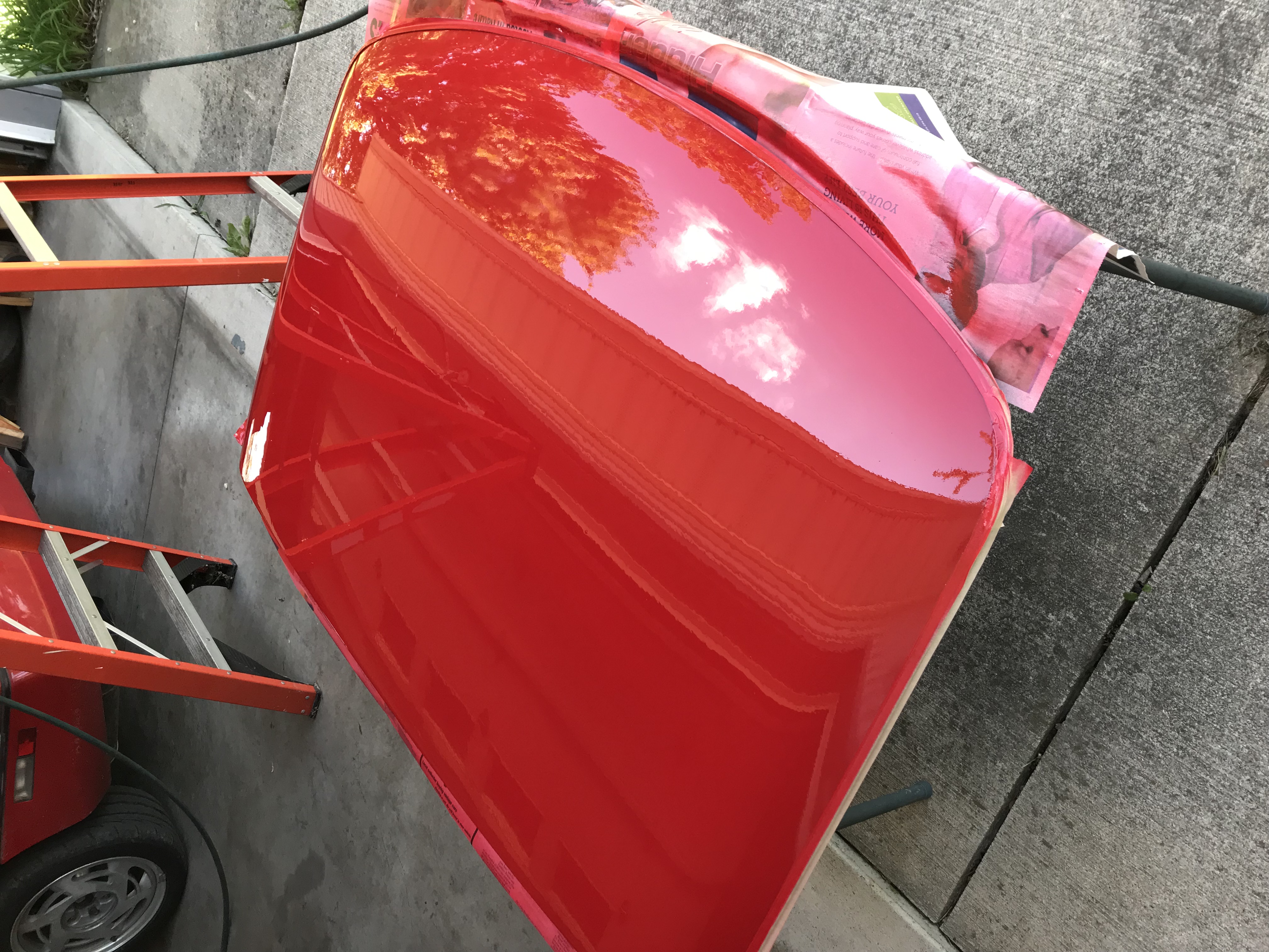

The top was some beige metallic. I dipped into my remaining stock of red and painted the roof to match the car. I chose to clean with wax and grease remover and sanded it with 320.
I lowered air pressure and put my Devilbiss to work. It laid down the paint so nice at something like 20 psi.

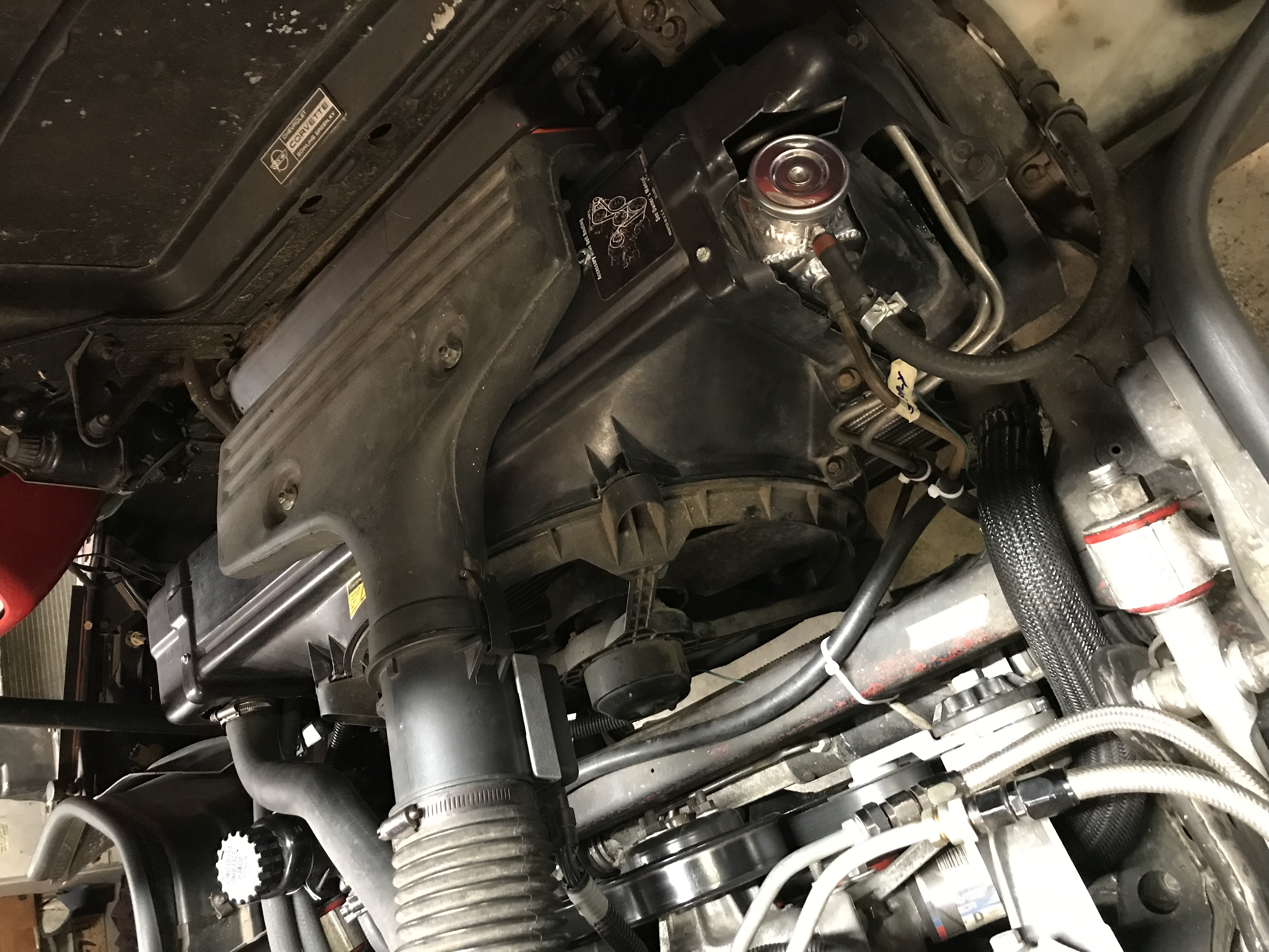

During rough assembly, we put the top grommets in the shroud and quickly learned the Frost Bite radiator that is a “direct bolt in” is actually about ¾” shorter than the stock radiator. When Fred32v was over he fabricated extensions for the top rubber grommets. We also did quite a bit of trimming to simplify the install of the top part of the shroud with the radiator and transmission lines in place. While I was attempting to connect the fan to the lower half of the shroud, I learned this was almost impossible inside the car as the power steering cooler is right there in the way. Removing the shroud for this helped facilitate the fitting of the new grommets.
The transmission lines needed additional fabrication – trimmed the factory return line and flared it. Completed bending the line from the cooler to the factory return line.

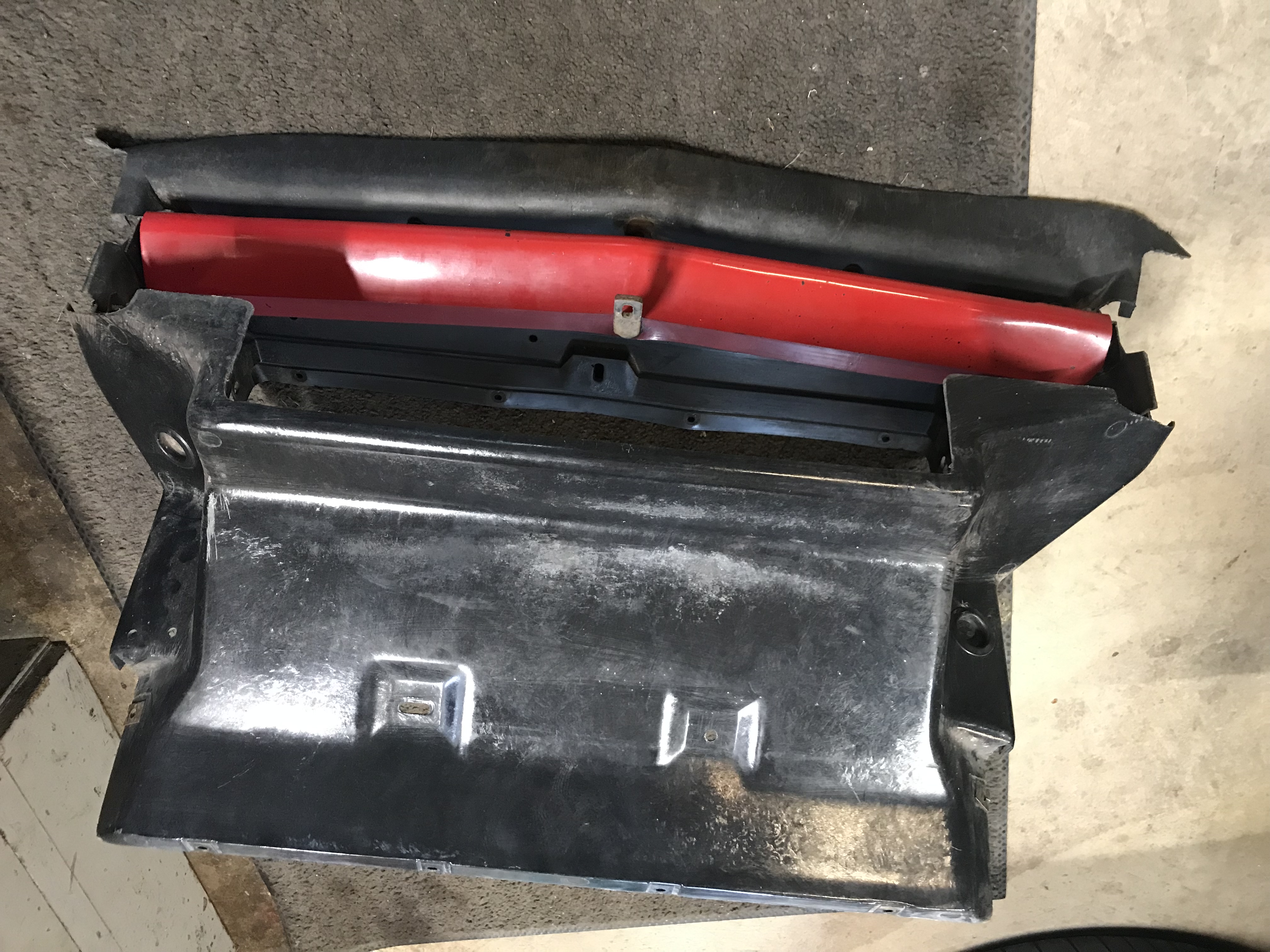

While the shroud was out I got the idea I should fix the front part of the inlet ducting. The bottom edge was quite bent and it took some straightening to get it right. There is a plastic air dam underneath and it was bent back so not helping push air up toward the radiator, so I took some time to bend that back to correct positioning. I also washed all these parts so I wouldn’t have to handle these dirty parts the whole time.
There is a red deflector in the middle of the inlet which I left, though I trimmed off the bottom part with the intention of letting more air through.

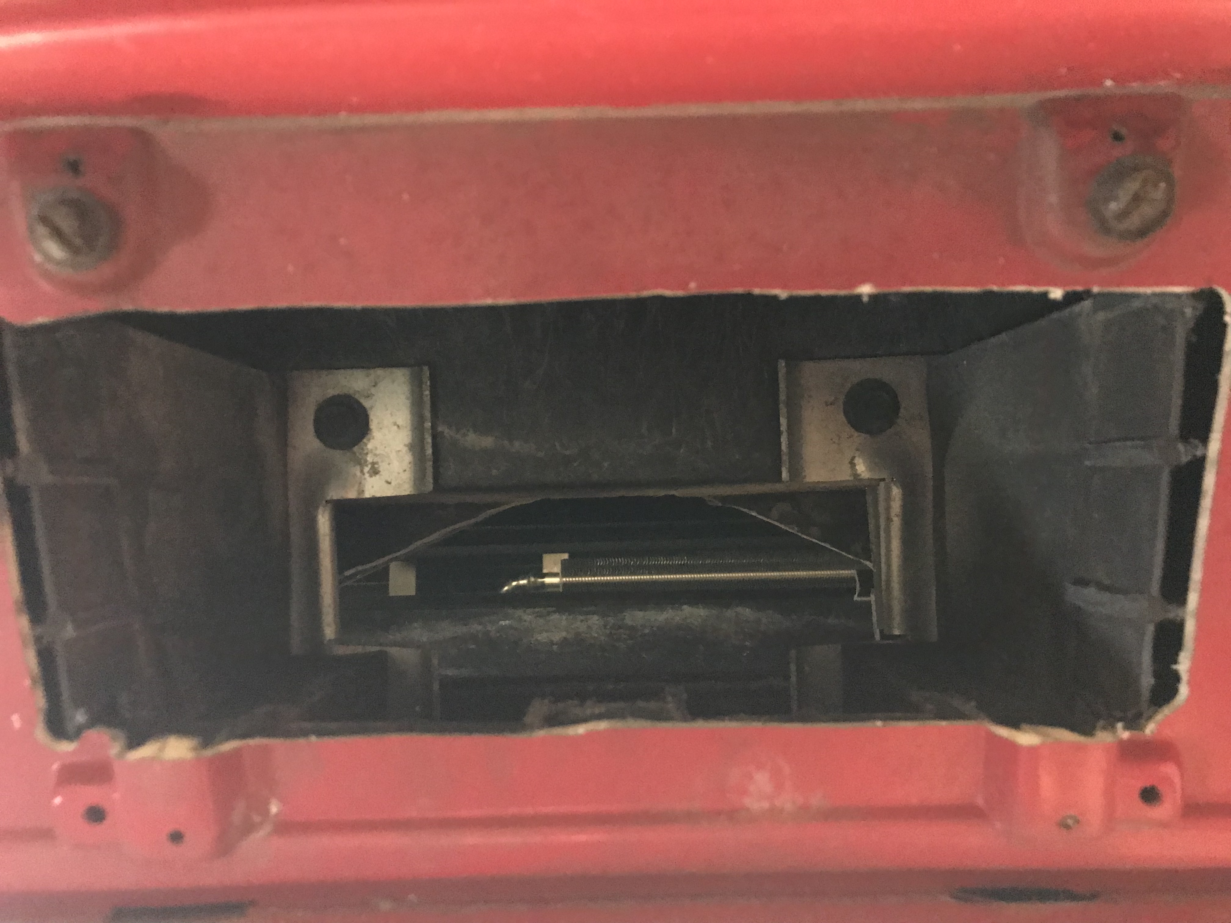

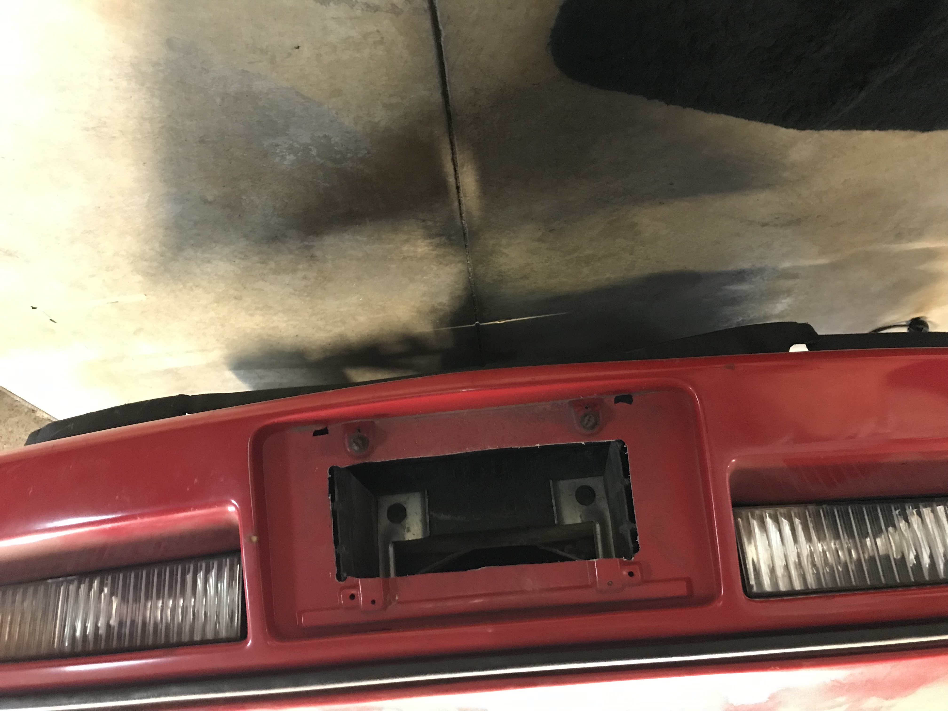

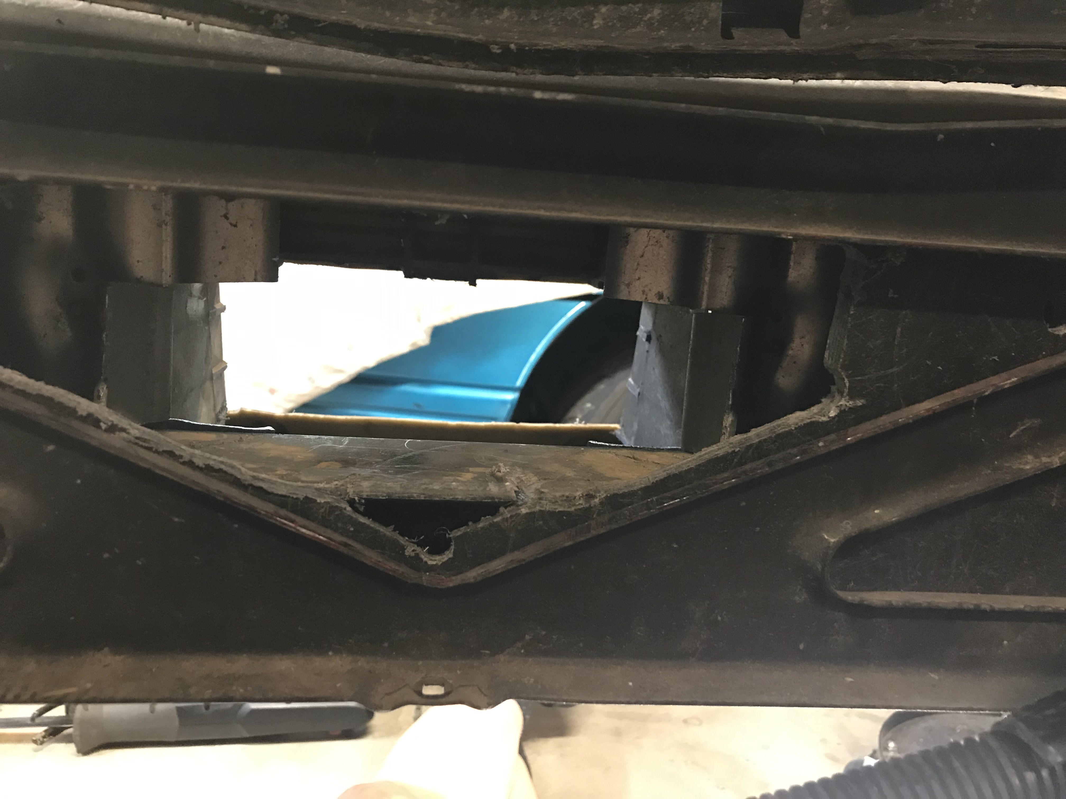

With the inlet ducting and main shroud out I got the idea that now is the time to open up the front bumper and let some air in that way as well. With these parts out I literally pulled my garage stool into the opening and could sit there in front of the engine.
I started by cutting a hole in the license plate area, then cutting a hole in the fiberglass – yes the bumper is mostly fiberglass.
After that I trimmed back a couple of the aluminum brackets to create a bigger opening. As it turns out this will mostly allow more air to the radiator though about ¼ look like its headed to the air filter.
After those diversions I set to putting it back together. First the inlet ducting, then the main part of the shroud, radiator, then the transmission lines, cutting the short bit of hose I need and making the final connections to the transmission cooler. Next step was to install the top of the main fan shroud, the air cleaner, low coolant sensor and double check everything for tight. Last step was to put coolant in it. It took over ½ gallon more than what came out of the car due to extra radiator capacity.
