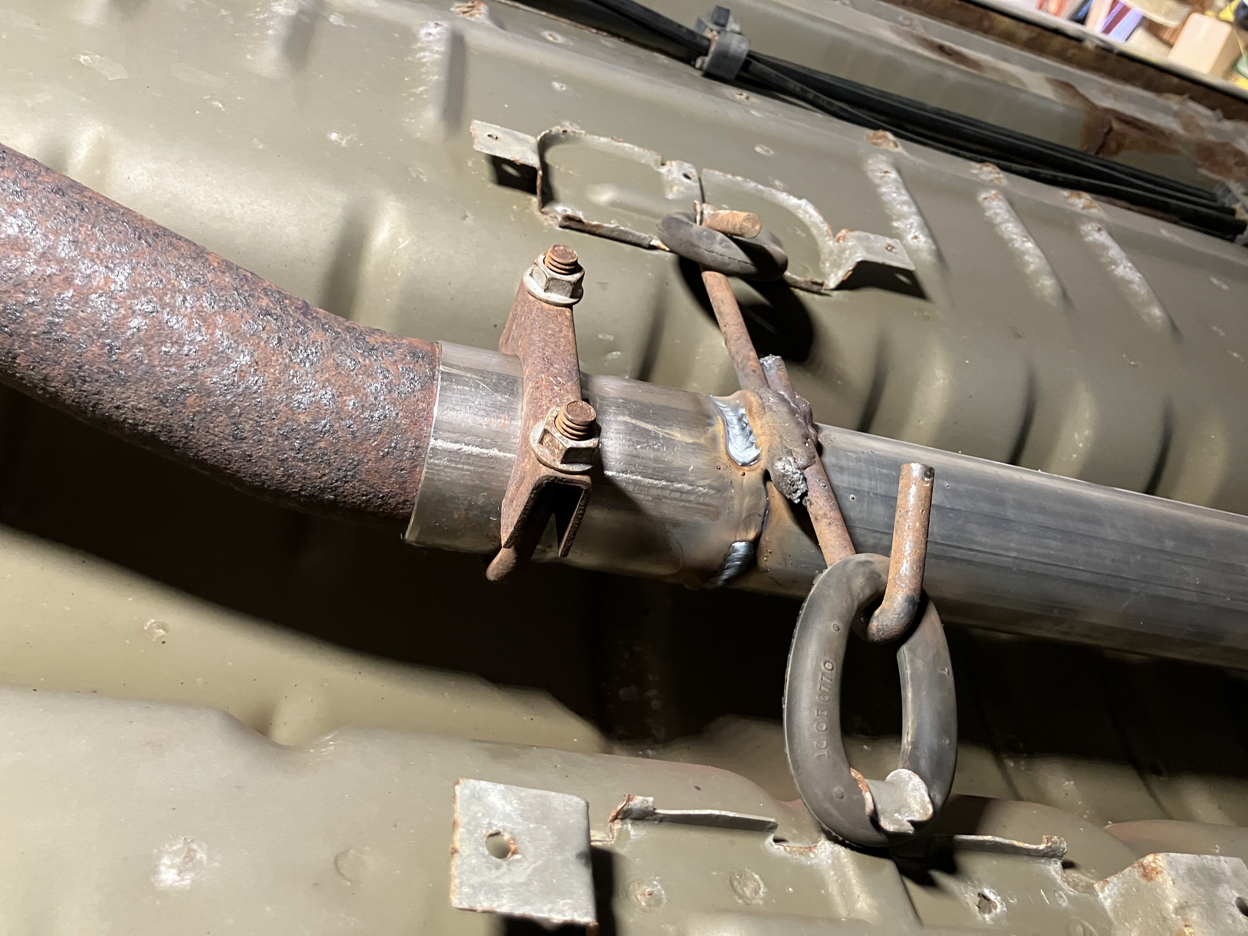

Issue #4 - exhaust leak
The resonator has a thin outside layer made from a metal sheet, and it is separated at the join. There is a flange just ahead of it that was rested quite badly. I ground down the bolt heads to make that separation. I'm contemplating between a straight pipe to replace it or maybe get a cat back exhaust from a less rusted car at pull a part.

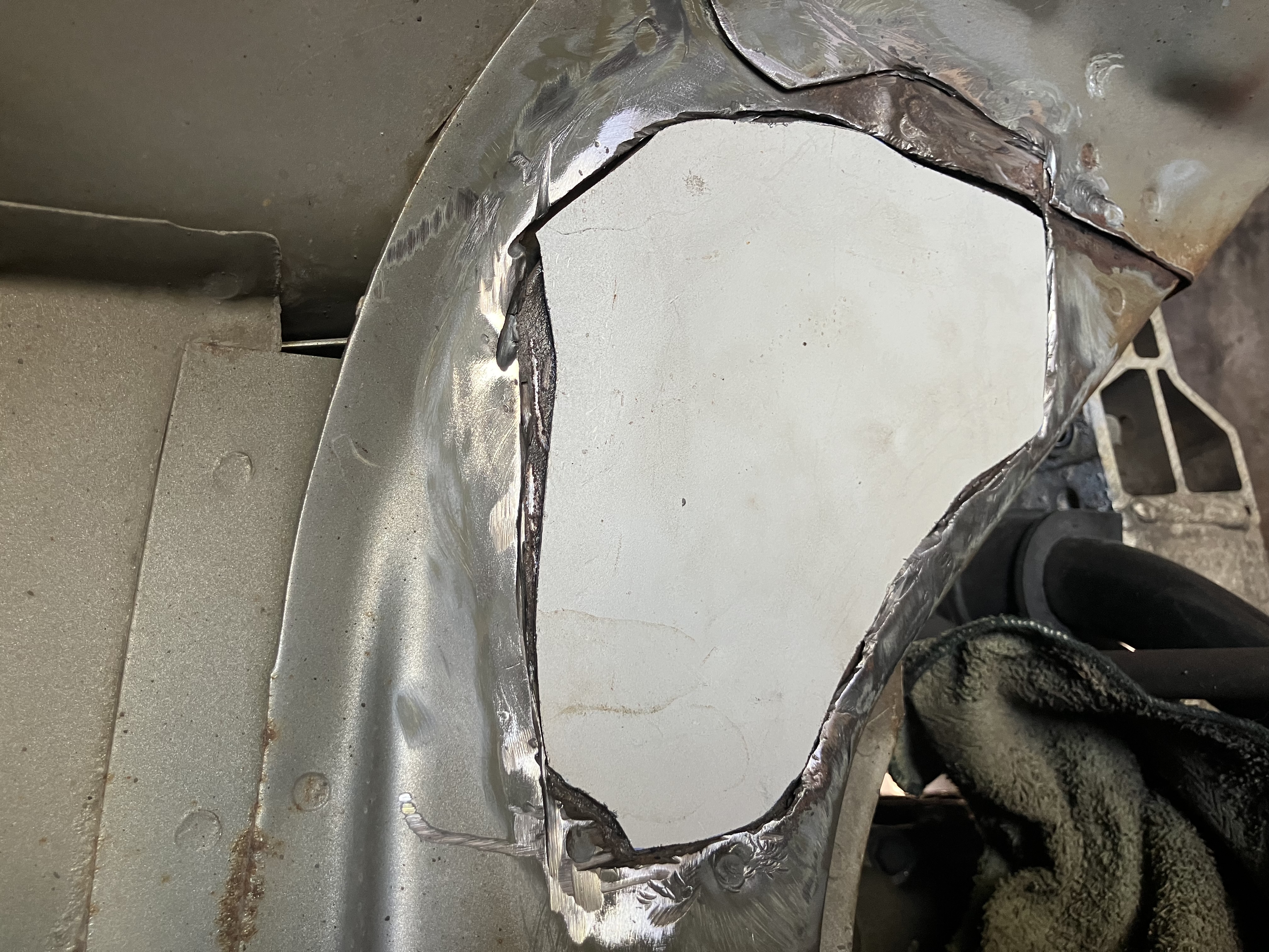

Issue #5 - chassis rust in LF
I did some inspecting of the chassis to make sure it was still sound. With the Acadia rust cancer surprises I didn't want to really do anything on the car until I knew it was sound. There is a fair amount of rust underneath but nothing I would call terminal. I can see a hole in the rocker panel under the driver, but the main rust issue was in the LF wheel well. The chassis there had a huge rust blister that I think needs attention. The plan here will be to make a metal patch panel and have Kurt weld it in. Its only the outside layer that looks compromised by rust.

Resonator had a hole in it. flange connecting downpipe to rest of exhaust was almost gone. Last Friday I was at pull-a-part and found a like new exhaust under an Impala. I had to get a 2.25" ID sleeve to connect it to the downpipe. Kurt welded that and one bracket on and it fit perfectly. I just want to start it before I put on the clamp and make it permanent. front sway bar

I cut out the rusted material, cleaned up the area and made a cardboard template. The metal is .070". Kurt has some scrap metal from industrial equipment I'm expecting a piece to arrive today. Once the metal is cut to match the template I'll have Kurt weld it in.
exhaust leakResonator had a hole in it. flange connecting downpipe to rest of exhaust was almost gone. Last Friday I was at pull-a-part and found a like new exhaust under an Impala. I had to get a 2.25" ID sleeve to connect it to the downpipe. Kurt welded that and one bracket on and it fit perfectly. I just want to start it before I put on the clamp and make it permanent. front sway bar

Exhaust is clamped up and complete. It is precariously close to the new sway bar with suspension at full travel, but it clears Front sway bar is installed.

Chassis patch
I made a patch and cleaned up the metal for welding. On the inside I treated the metal with rust inhibitor. Welding is scheduled for Friday Issue #7: Brake noise

Chassis patch

Completed the list of repairs!
Had the car over to Kurt to get the patch welded in, and then I prepped and painted it.
