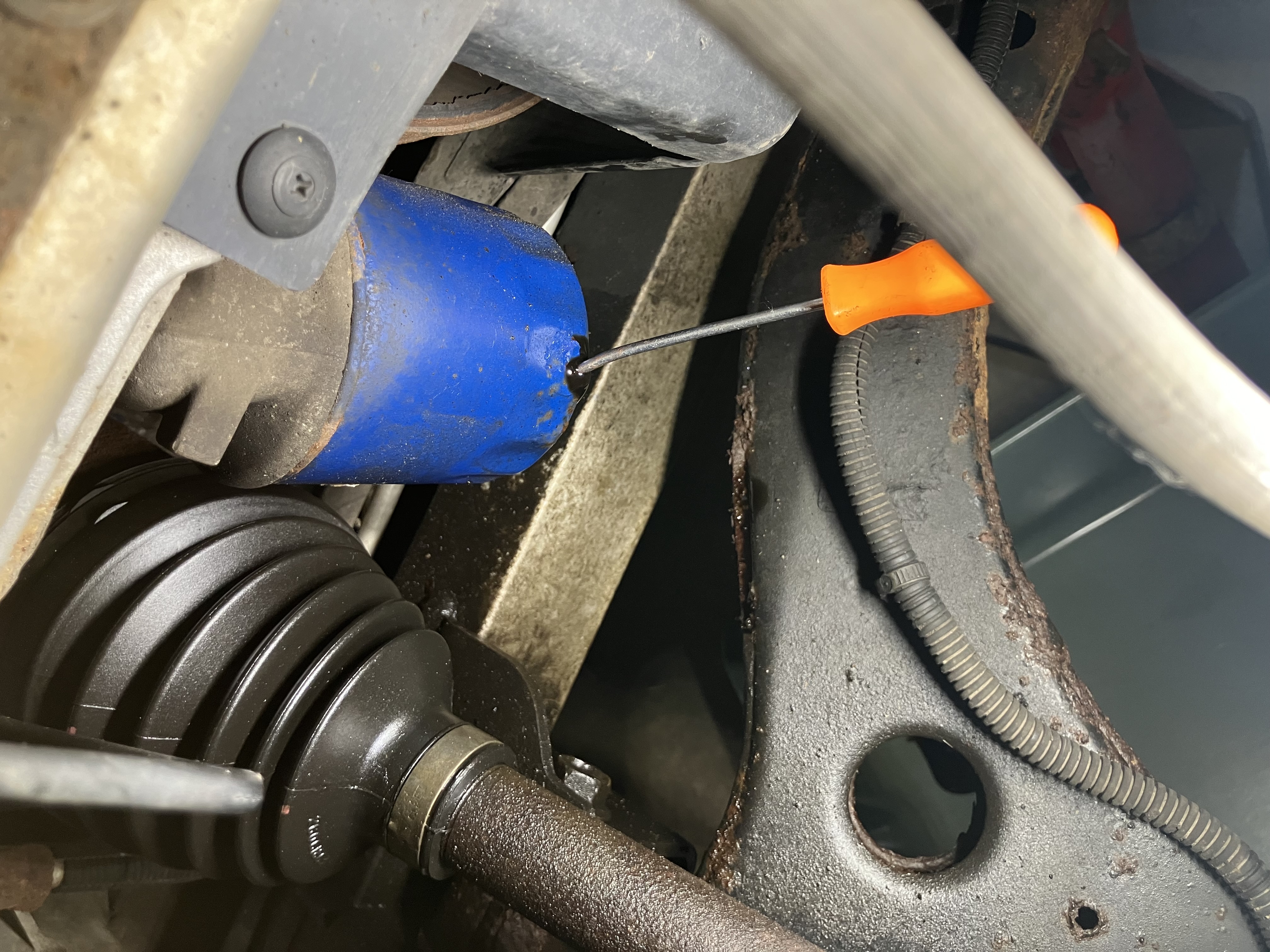

Issue #1 - the oil leak
There was concern this was a power steering leak, but close inspection uncovered a small leak in the oil filter due to rust. I pushed a screwdriver into it with ease. That was a much easier fix though. My Mom drove it every week but not that many miles so best guess is that filter was 3-4 years old and with the salt in the snowbelt that was enough to rust out the filter.

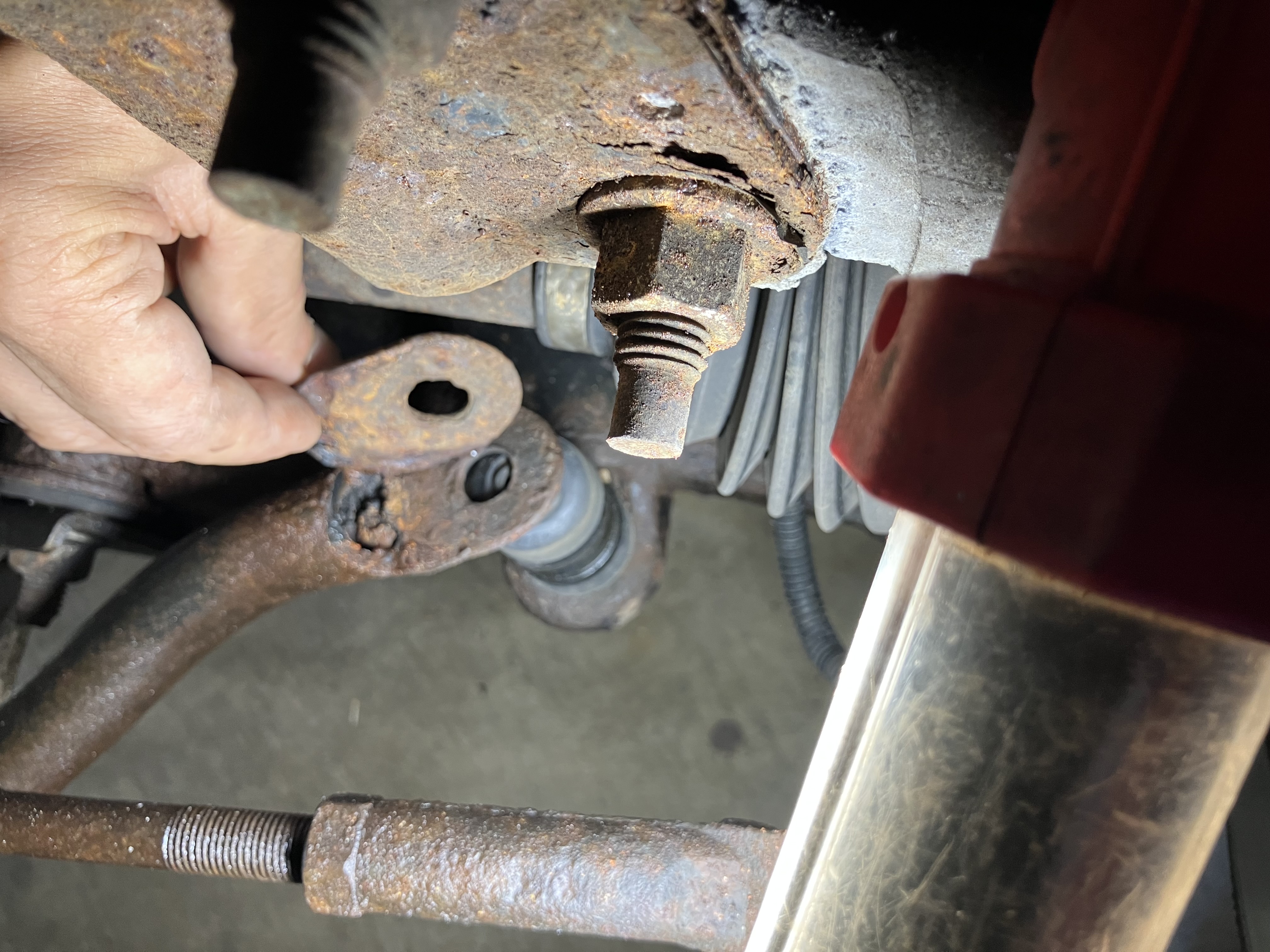

Issue #3 - Front sway bar
To my surprise one stabilizer link was broken, and one of the sway bar ends was split. I found a video that showed how to remove this without having to lower the subframe. I was going to have Kurt weld the bar, but then I saw a new one with the stabilizer links for about $80 shipped.

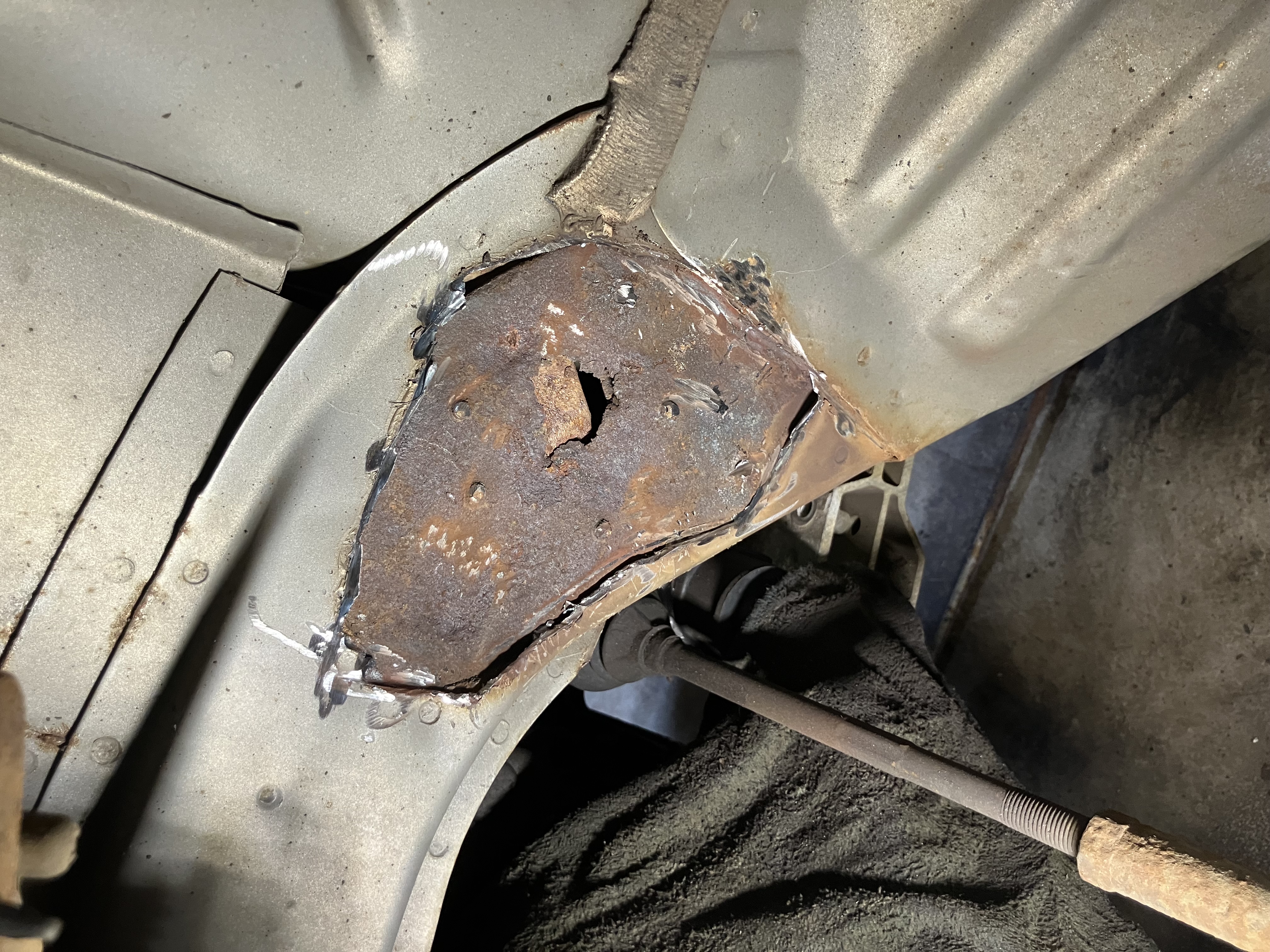

Issue #5 - chassis rust in LF
I did some inspecting of the chassis to make sure it was still sound. With the Acadia rust cancer surprises I didn't want to really do anything on the car until I knew it was sound. There is a fair amount of rust underneath but nothing I would call terminal. I can see a hole in the rocker panel under the driver, but the main rust issue was in the LF wheel well. The chassis there had a huge rust blister that I think needs attention. The plan here will be to make a metal patch panel and have Kurt weld it in. Its only the outside layer that looks compromised by rust.

front sway bar
The new bar is in place. I'll bolt it in once I know I'm done with the gas lines. Being able to move it leaves some clearance to work on the lines

chassis rust in LF
I cut out the rusted material, cleaned up the area and made a cardboard template. The metal is .070". Kurt has some scrap metal from industrial equipment I'm expecting a piece to arrive today. Once the metal is cut to match the template I'll have Kurt weld it in.

Chassis patch
I made a patch and cleaned up the metal for welding. On the inside I treated the metal with rust inhibitor. Welding is scheduled for Friday

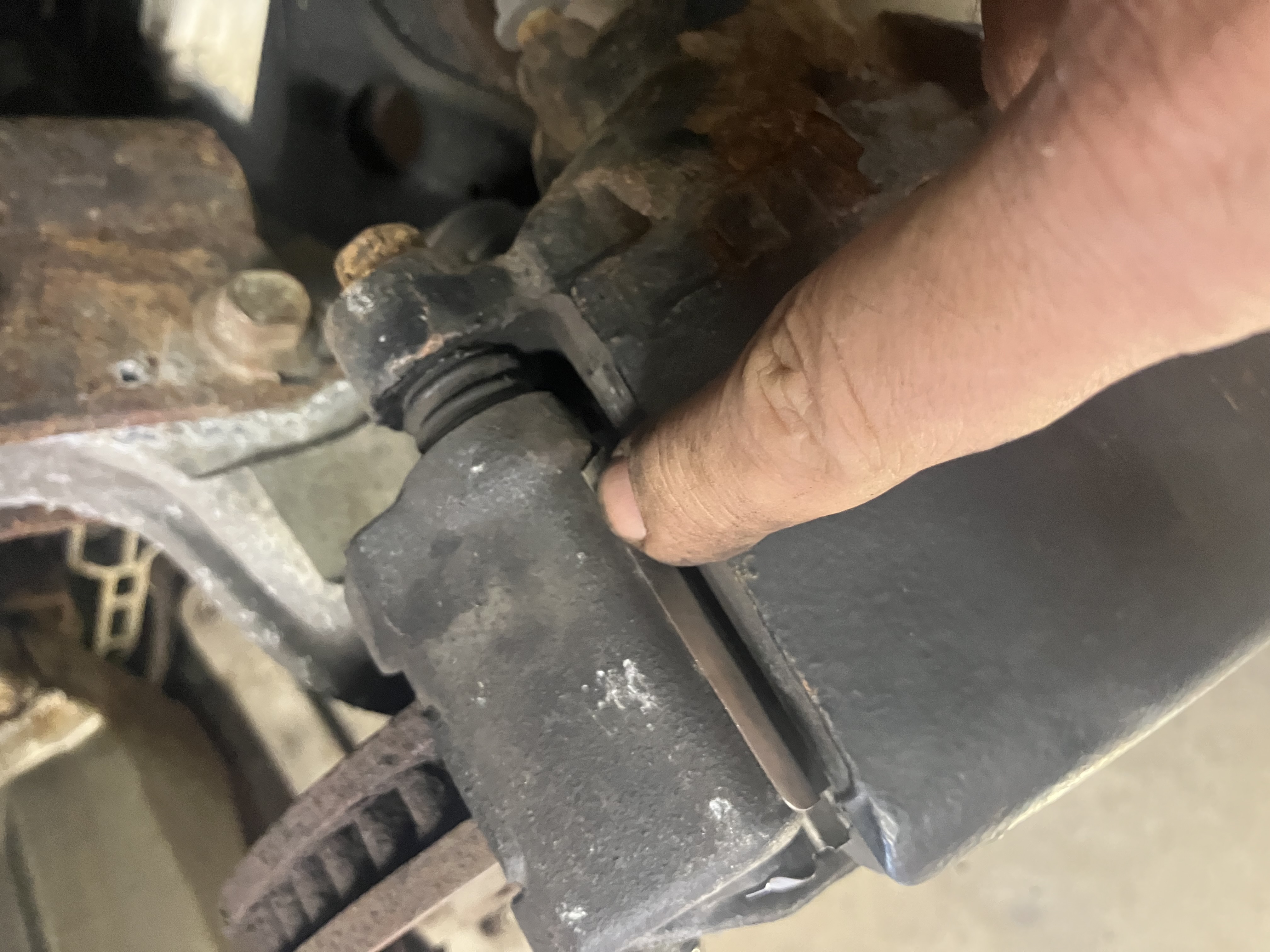

Issue #7: Brake noise
Did some experimenting and was able to replicate the problem with the engine off rolling and turning left which eliminated power steering. Then had Rhonda operate in the driveway and I walked alongside to confirm the sound was in the RF. It'll make the noise at like 2-3 mph.
Attempted to adjust the clips that help align the pads but that did not change anything. Ordered a rotor and a set of front pads.

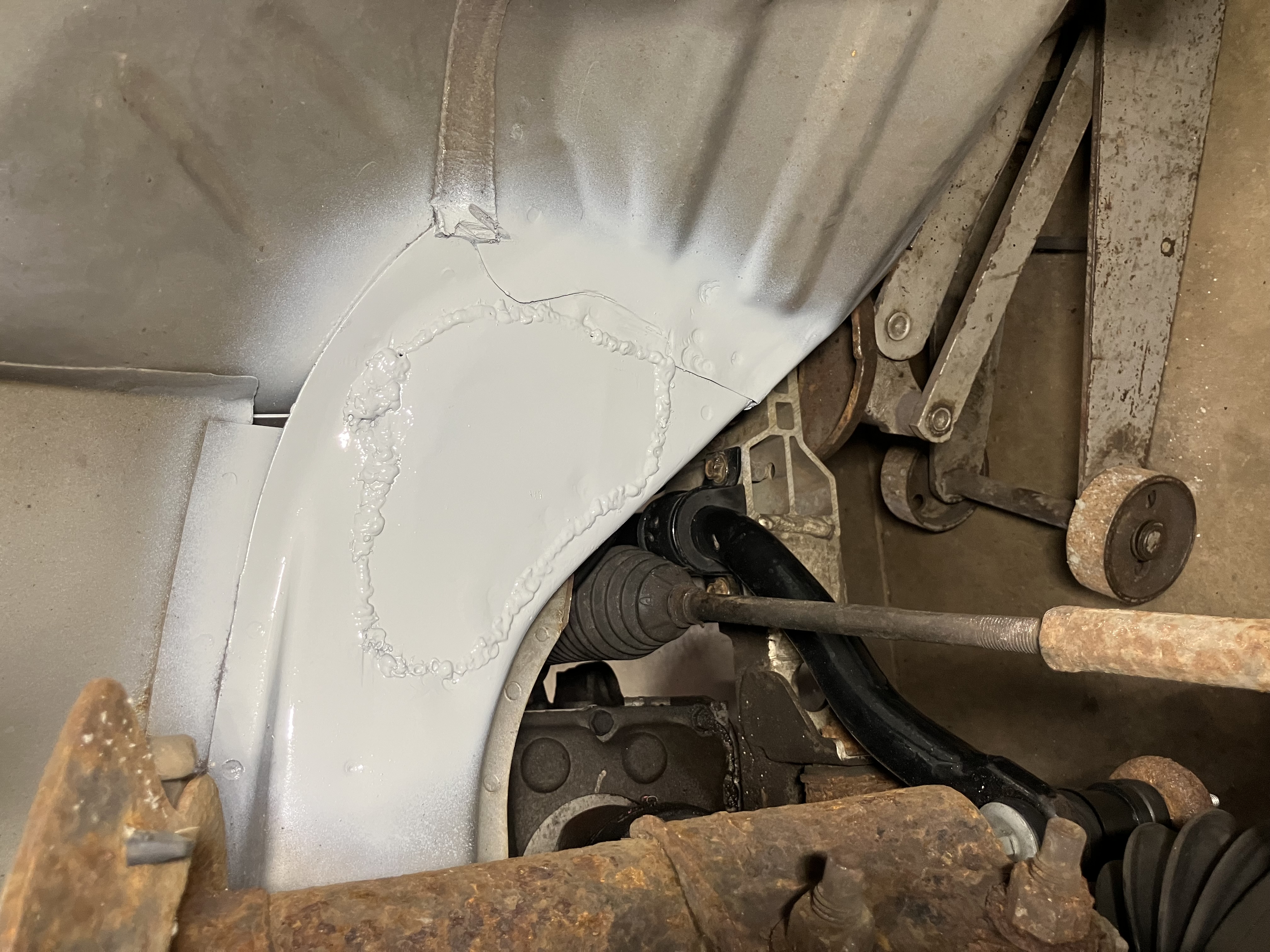

Completed the list of repairs!
Had the car over to Kurt to get the patch welded in, and then I prepped and painted it.

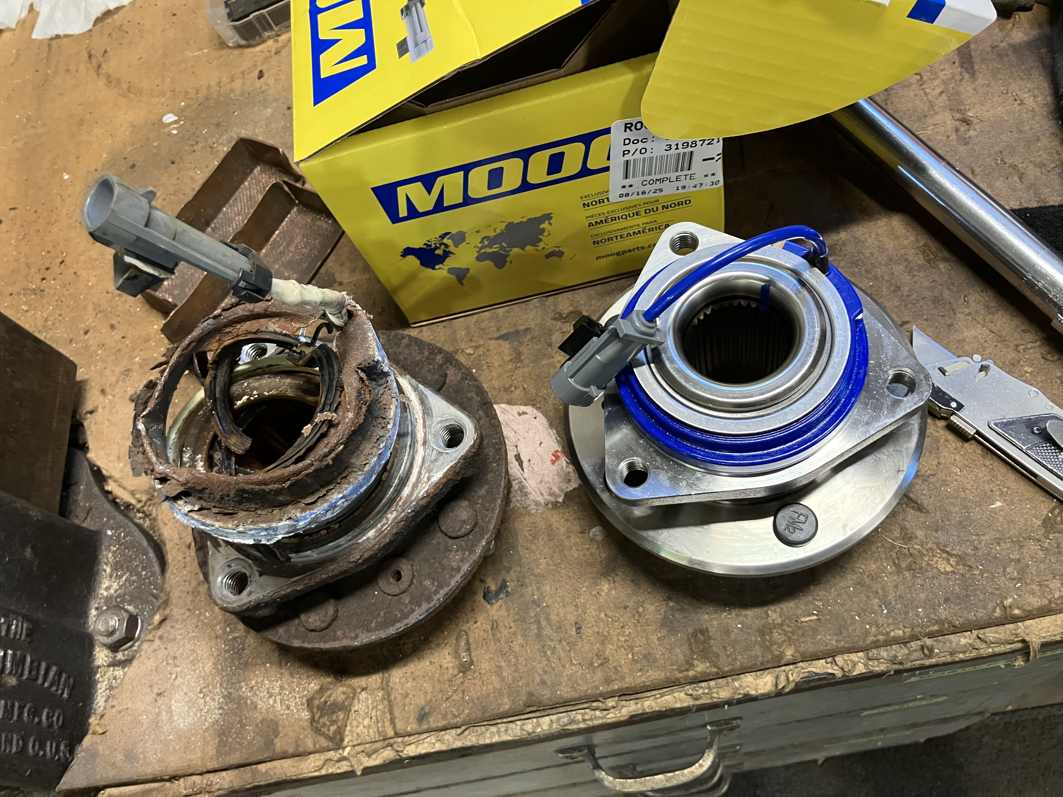

Also tracked down the noise in the RF. I tried swapping the brakes between RF and LF and sound stayed on RF. Then fortunately the car was making the noise just rocking it in the garage. With that I removed the caliper and pads and it still made the noise. That told me it's the bearing - so I replaced it. On disassembly the speed sensor came off the hub and it was quite rusty in that part of the hub assembly.
