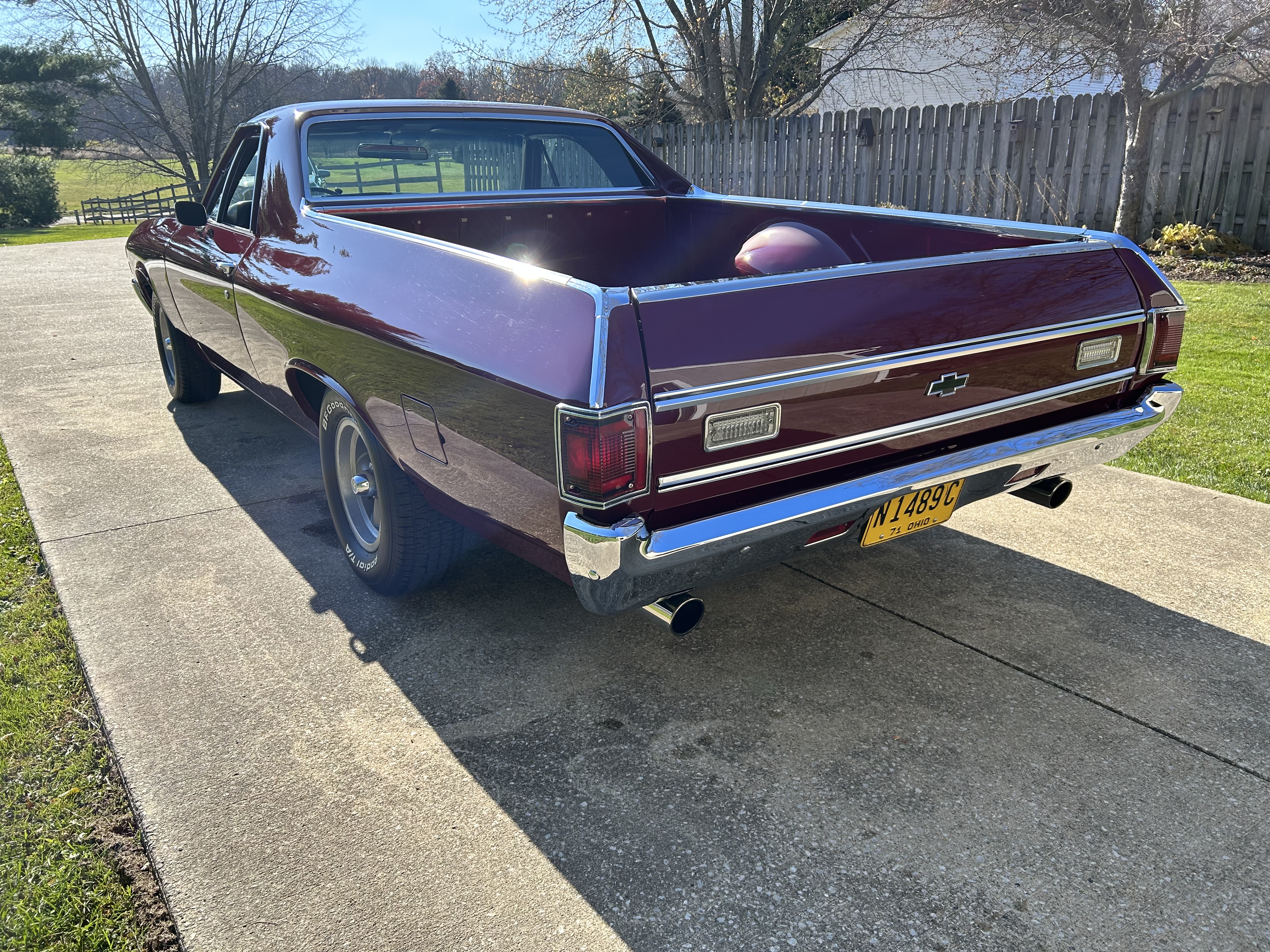

it took me a couple of days to get this posted up. The transaction and flurry of activity went down on Thursday the ninth.
After I had a verbal agreement on the 442 sale, I grounded the car and started my search for another project car. I was thinking convertible, Oldsmobile, C6 Corvette, or maybe an El Camino. I think that I’ve looked at 4000 cars online trying to understand what I’m looking at. As I studied the vehicles, pretty quickly I was turned off on mid-60’s Oldsmobile’s because I’ve had a bunch of them. A C6 Corvette is still something I’d love to have, but GMAmy reminded me that a car that’s not a project bores me and there would be not enough there to keep my interest over time. I’d been studying the El Camino’s and happened upon a couple of them locally, so, with a fistful of dollars burning a hole in my pocket, we set out to find a car. BP and I checked out a cool ‘65 that I decided needed too much work to get it back to what I wanted. So, I happened upon a redone ‘71 at a local car lot in Amherst. I found the ad on FB Marketplace. With some serious help & Chevelle wisdom from Tony, and a half of a day behind the wheel (Tony really took a bullet on this - all for a hot dog meal!) we had an El Camino at home in the barn. I’m just now starting to figure out what I got myself into, but the one thing I can say is this car is CLEAN! Paint and undercarriage are the cleanest I’ve worked on. I’ll post up more pics and such as I move through the project, but I feel as though I’ve found a really nice start to a project. More to come….

You could already turn a profit. Looks great!
Re: 1971 El Camino
Looks like a really nice find! How about some important details like engine, trans, mileage, etc.

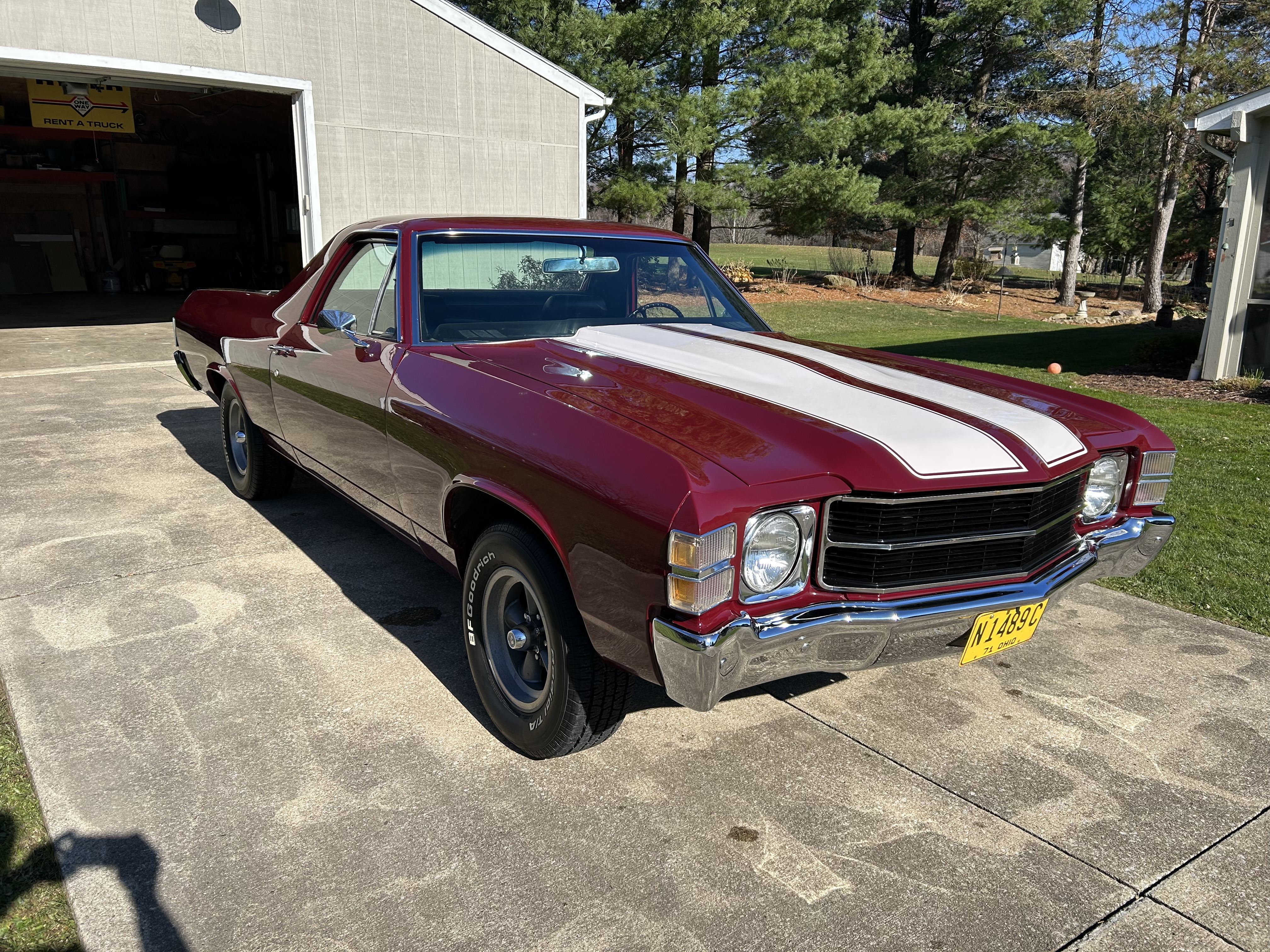

That Camino sure looks good sitting in the sun after a fresh wash!!
When you guys see the car in person, you'll really like it. The paint and body panels are super solid/good.
It's kind of the perfect project car for John - a fair amount of little stuff that he likes to fix....and is really good at. Zero body work or paint issues.

That thing looks super nice, cant wait to see it in person! I loved the '72 I had in the pre-Tiresmoke era.

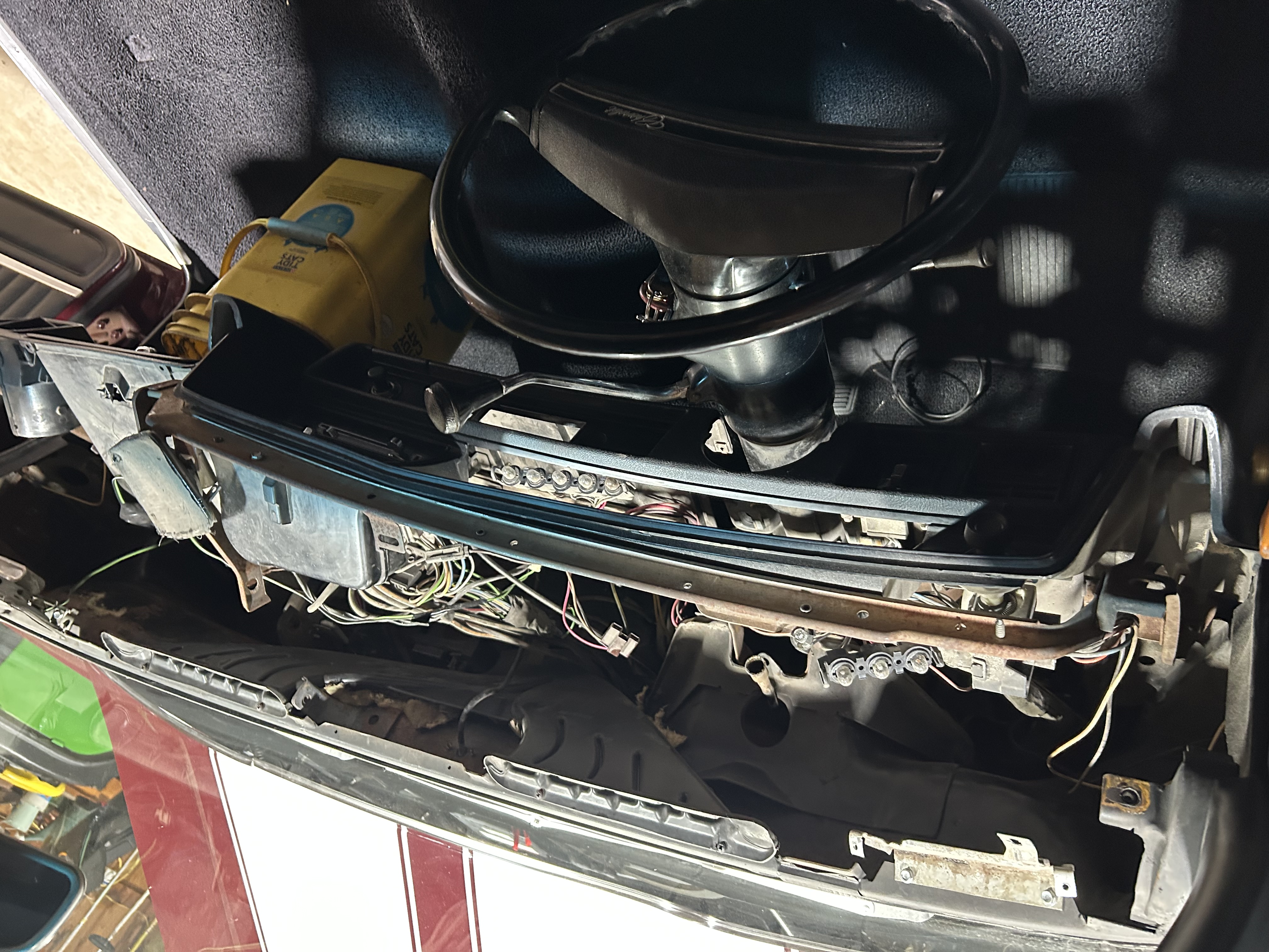

5) vacuum and blow sand blasting sand from behind dash area (it’ll need to be done again)
6) remove seat for dash work

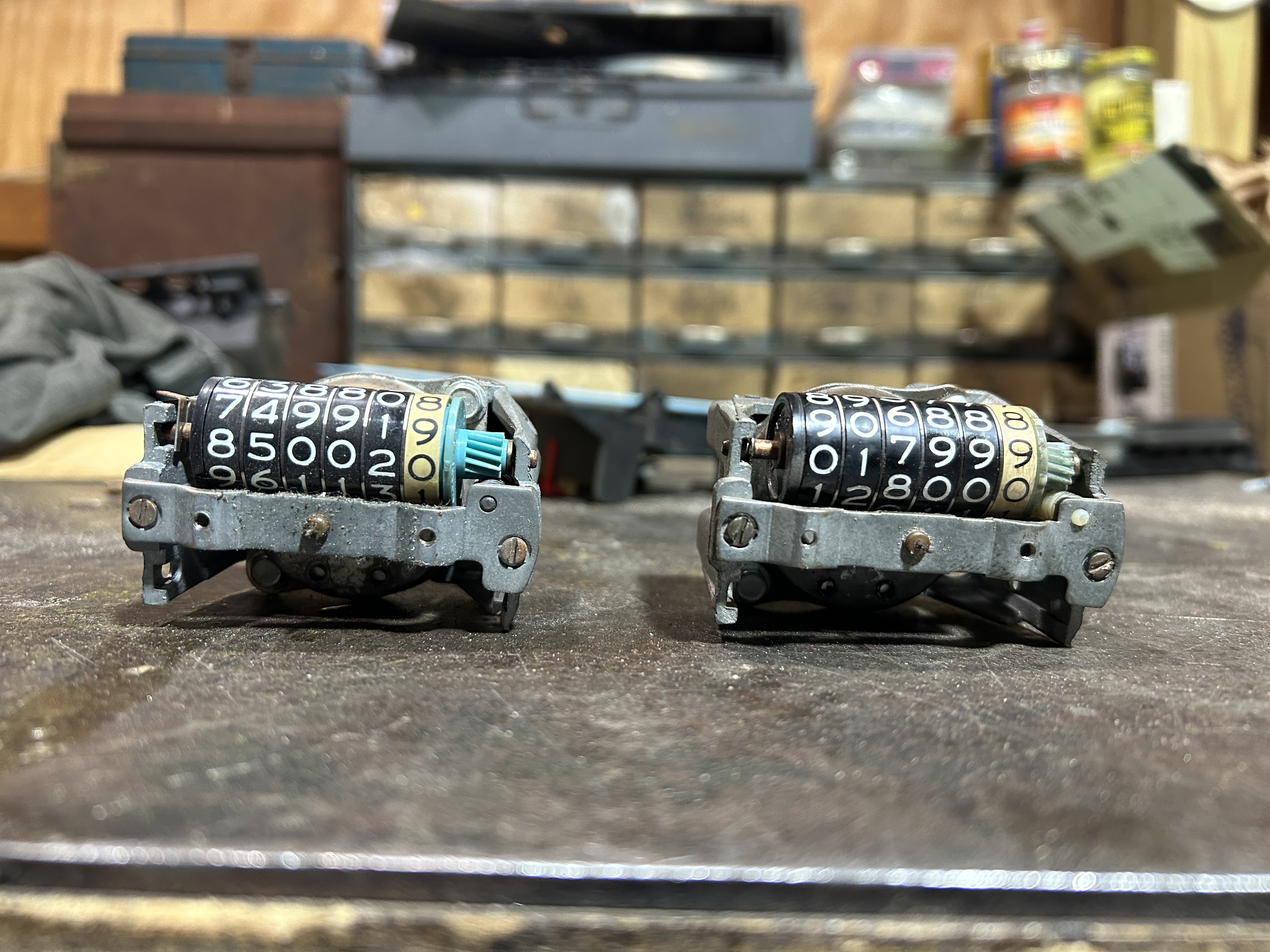

7) remove speedometer cluster and repair with used speedo cluster found on FB Marketplace. ( issue with speedo was loose change has found it’s way into the cluster — no idea how this could’ve happened - change jammed mechanism up and stripped the odometer gears )
reset odometer to current mileage ( less 35 miles )

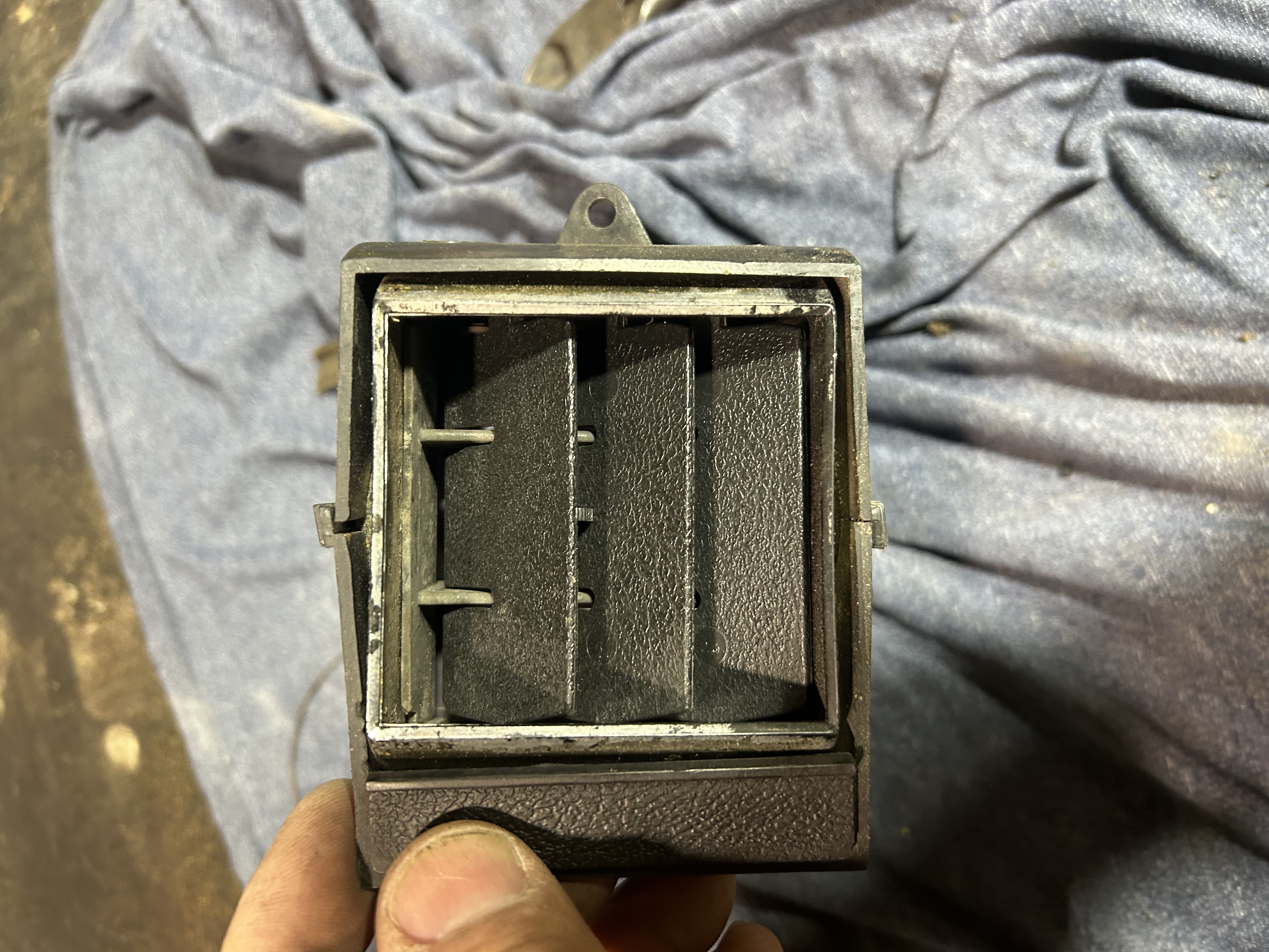

Re: 1971 El Camino
I felt pretty positive about yesterday’s work. I started the day by blowing out and vacuuming more sand from behind the dash. This finished it off and I’m pretty pleased with the outcome. There might be some sand left behind the dash, but very little. ( I’m thinking of naming this car “Sandy”) With the dust settling, I got to changing the vent louvres on the left and right of the dash. That job was pretty painless. The only hiccup came with the re-pop vents. There’s a small felt disc on the end of them that fits in the vent housing and keeps them centered. The new ones were too small and allowed the vents to wobble in the housing. The old vents had good felts on them, so I superglued them to the new assemblies and I was on my way. I then took to finding the annoying vacuum leak and no heat situation. To make an extremely long story short (about 2 hours of chasing vacuum hoses), the previous owner had plugged a vacuum supply line and left it on the motor. This line was to go to the vacuum canister on the firewall. The heater control valve hose was plugged into the vacuum canister and the heater control valve had a vacuum hose coming directly off of the carb. Basically, someone didn’t label the hoses and reassembled them incorrectly. Being in the garage with the door closed, I didn’t run the car to get it to feel heat, but I was able to watch the a/c vent door move as I moved the lever and the leak sound is gone. I moved forward after this. I got the speedo back in and, reassembled the duct work. All of the duct work was blown out with the air hose and wiped with rags as far in as my hand could go. All dash lights now work correctly and all go the switches were lightly lubed and blown out as well. ( 6 hours worked ) For reference, here is the schematic I found on the internet to help me diagnose my issues: http://thepartguy.com/diagrams_chevelle.htm
And the link to the 1971: http://thepartguy.com/diagrams/chevelle ... agrams.pdf
