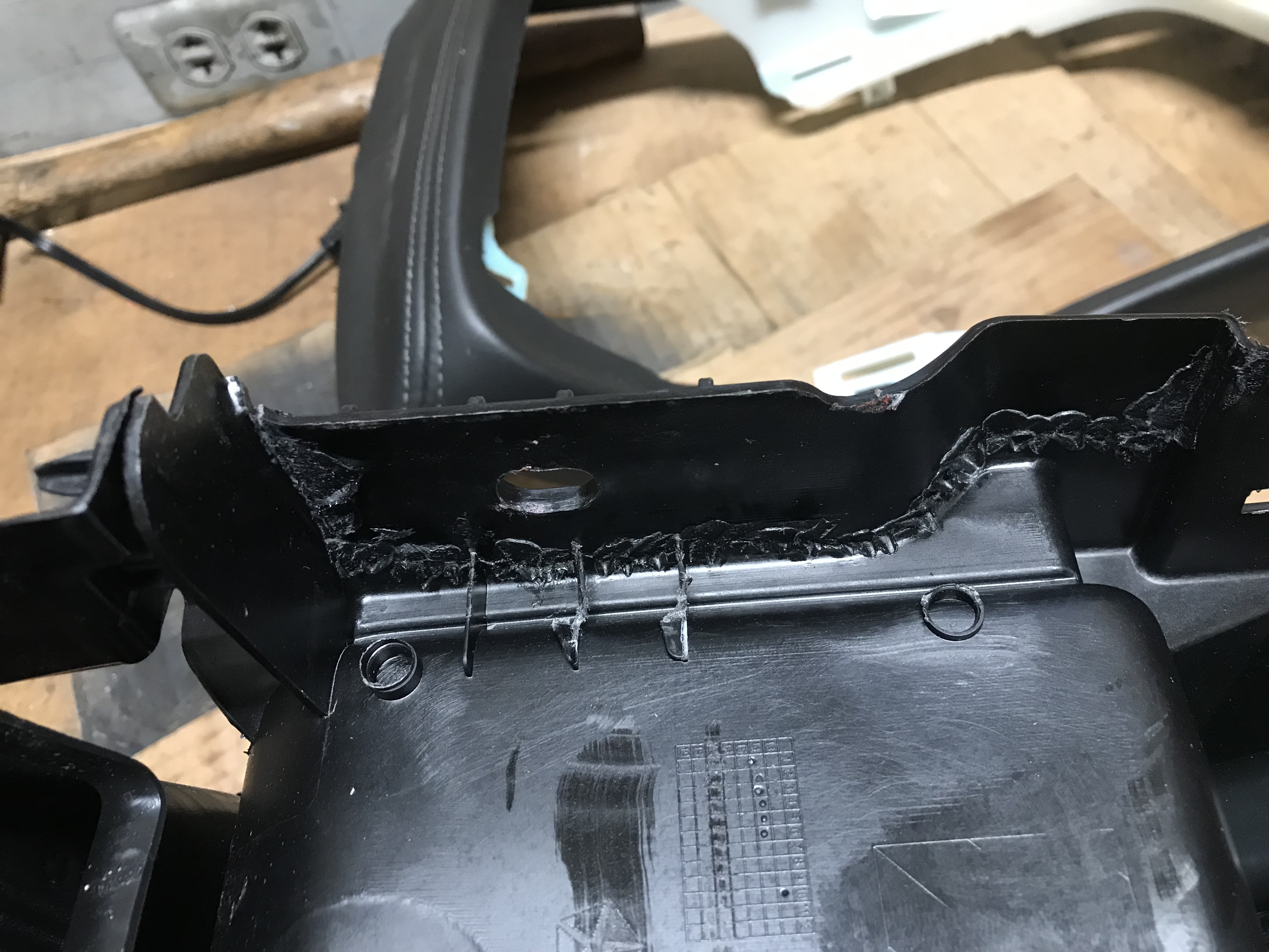

Center console:
Was damaged after the crash I believe – maybe police tearing it apart looking for drugs?
Disassemble, plastic weld many of the cracks, clean up the console including inevitable drink spills inside. Plastic welding went pretty well – its low risk if any of it fails since its just the center console Other:
Cleaned up the rear carpet – the facial cream that was on there had largely dried out so it came off fairly easily
Plastic welded the inside rear side trim. There were cracks in both sides. I just closed up the cracks by melting the plastic back together on the back side RF fender:
