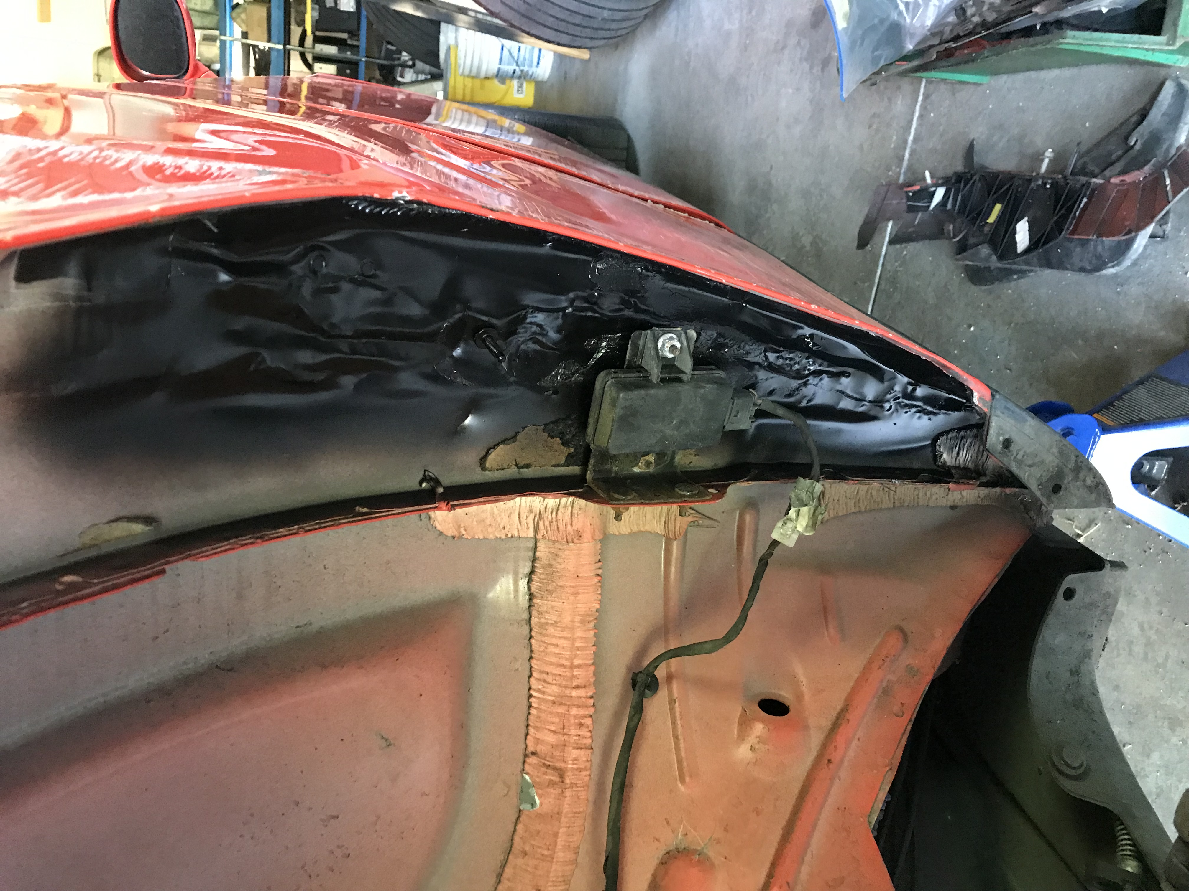

* heavy lifting fixing the RR fender: move the metal for the inner fenders and all along the bottom into position. this side was a little more crushed in so additional work was needed: had to cut a large window into the inside support so I could access more of the sheet metal. Also had to straighten the metal at the top of the fender above the taillight as it was buckled a little bit as well. The outside edge on the back of the fender moved out about 1 3/4" to get close to its original configuration.
* clean and paint the exposed metal resulting from the reshaping and the crash - went with black as it was in stock (thank you David Bales)

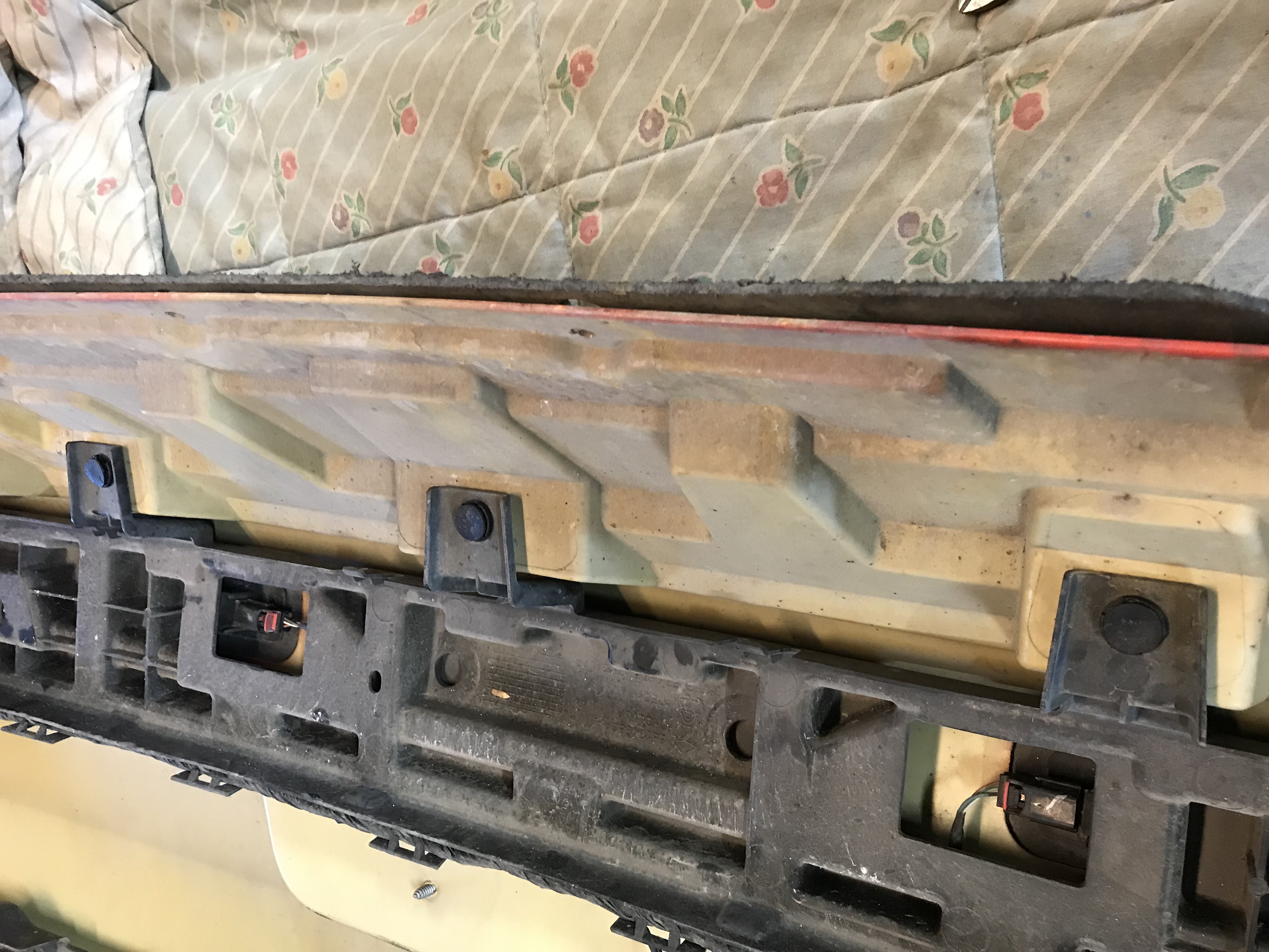

* ordered and installed the rear bumper cover retaining brackets. These are plastic and were missing/destroyed in the crash

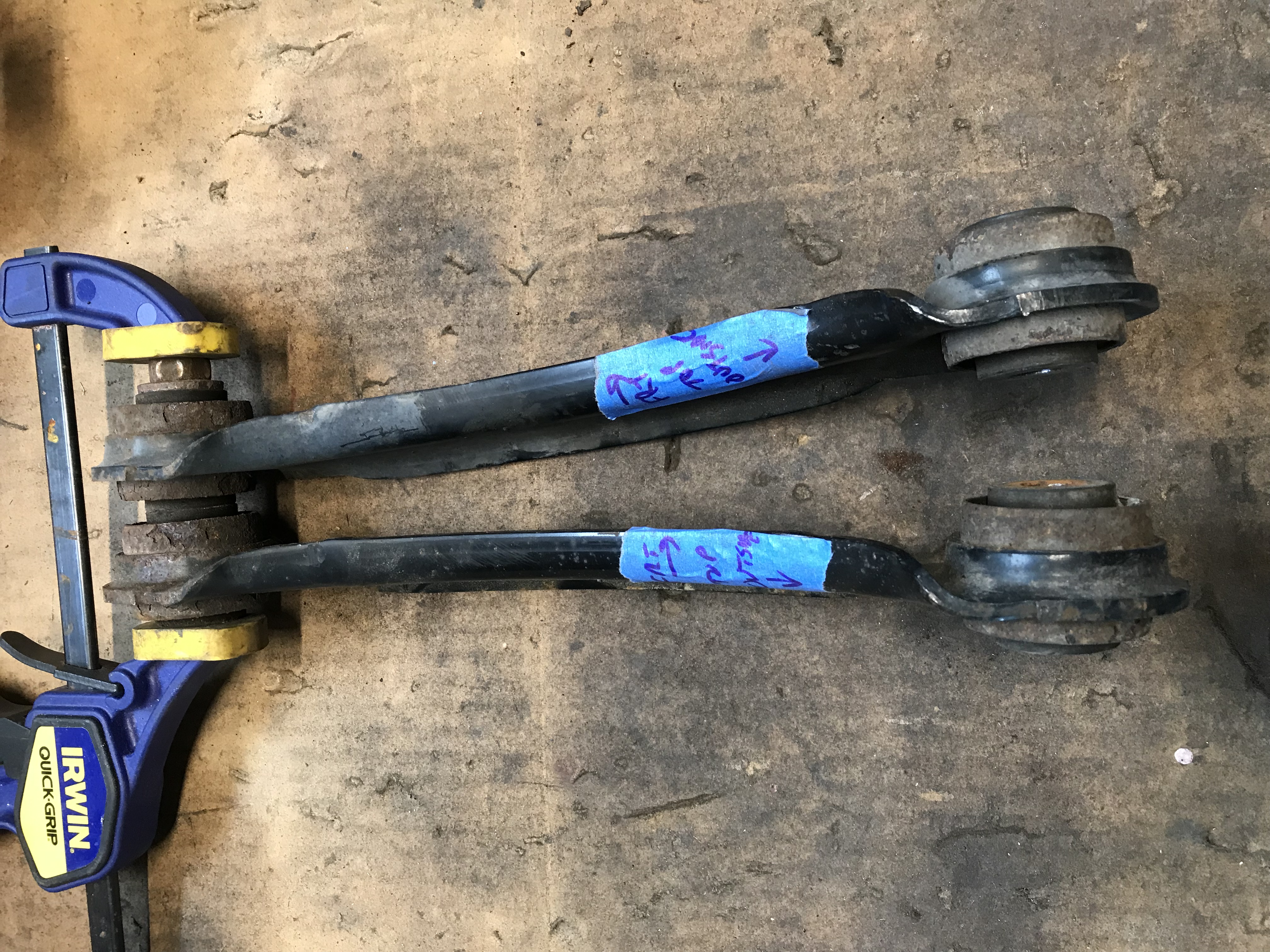

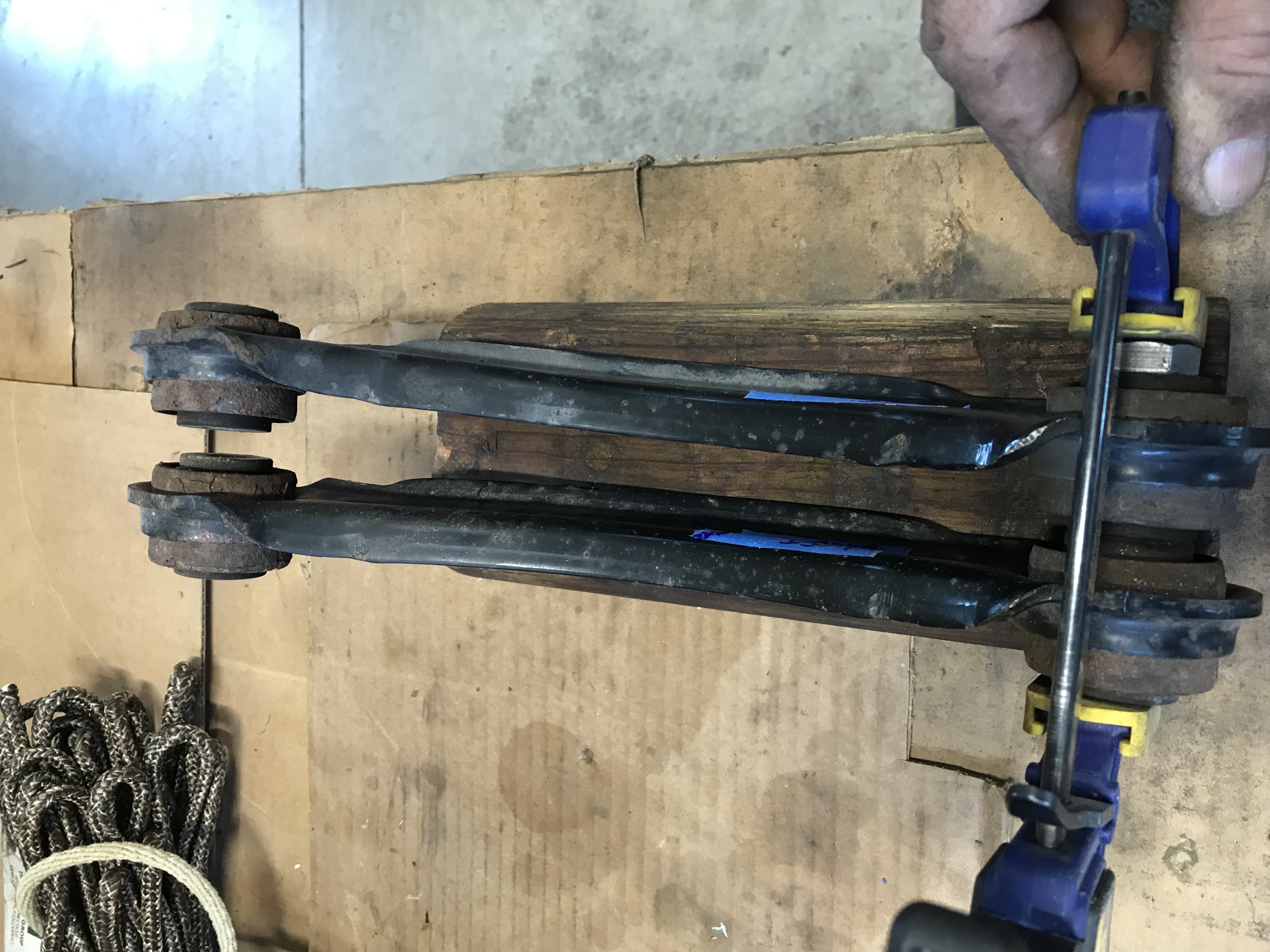

* Changed out both toe links and found them both to be longer than the unbent parts from the parts car. Unfortunately this netted significant toe in even at max toe out adjustment

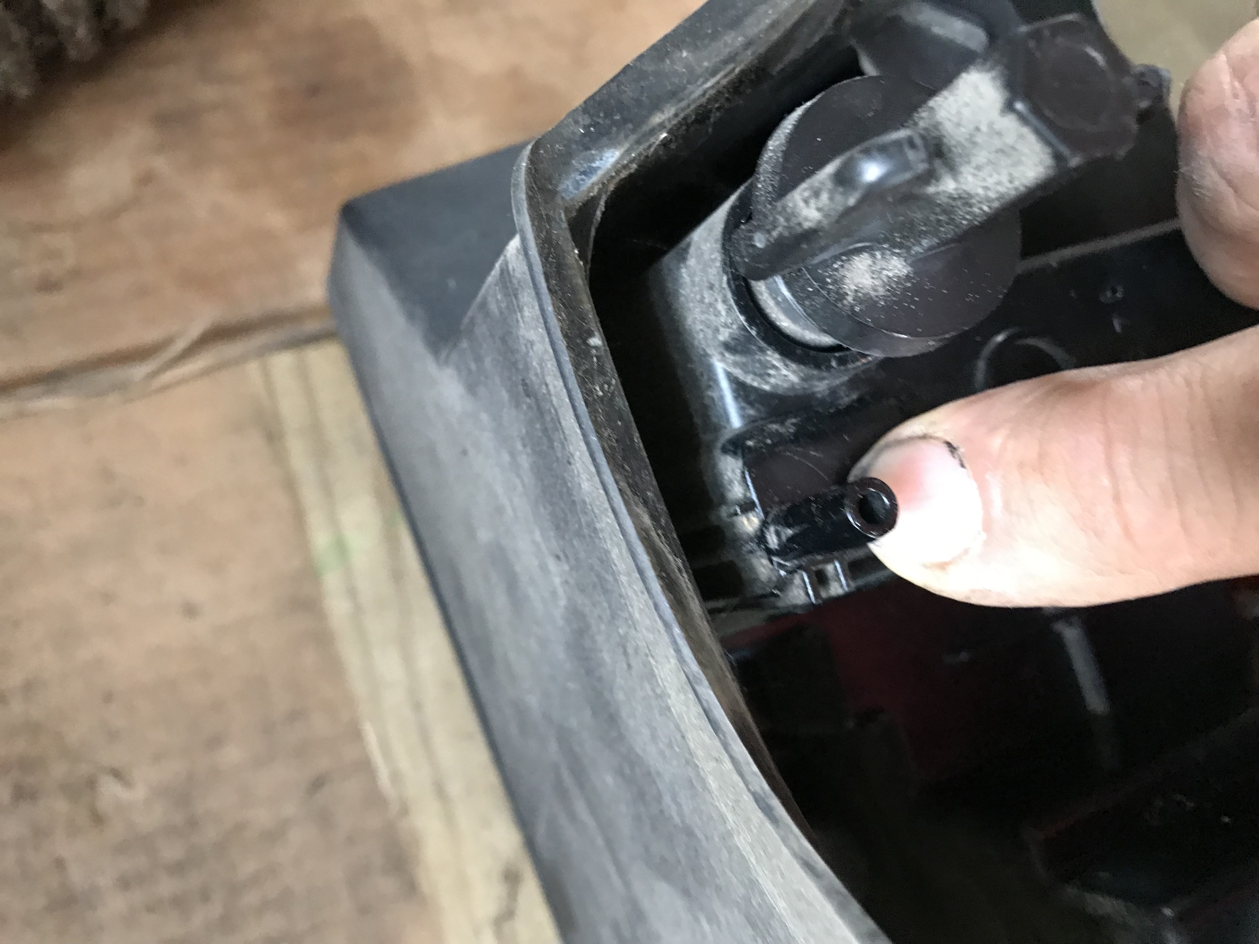

* the alignment pins on both taillights were broken off. Took a few minutes to super glue these back in place

* on the LR the front upper control arm was bent, so I changed this out. Had to lower the rear subframe on both cars to remove the retaining bolt. Sounds bad but really only took a couple hours to get both apart. This improved the camber from +2.1 to about +1.6 but made no change in the toe in, and the front edge of the tire now sits 2.5" from the front edge of the fender, which I consider to be acceptable
* learned from the service manual the rear subframe is adjustable - and measurements confirm it is too far left. The right rear wheel was the only one that didn't break so maybe it transferred more energy and moved the subframe over? I'll have to remove the coil springs to do it but I understand how I might do the alignment.
* experimenting with the LR camber, I learned that the camber readings with the wheel on were not the same as reading with the suspension loaded and wheel off. I should know better you need to roll a car after putting it on the ground to get accurate readings. Checking the RR the camber is now at -1.8 using this method. the LR is right close to 0.0.
* I put the LR together using a 1/4" bolt instead of the correct bolt, which nets about 1/4" movement in the right direction at the upper control arm (they call it camber link). This should get me over 1 degree in the right direction. Got distracted and didn't write down the final measurement. Up next will be re-check and determine how much more is needed to get to -1.8, then opening up the bolt holes on the frame mooring point for the camber link to allow it to move inward.

* made some finishing touches - moved the top edge of the RR wheel well outward about 1/2" to match the other side. Did some touch up on the paint on the fenders right where the bumper cover going to connect - wanted to get some paint on the damaged paint, and places where I had covered up damaged with black spray paint.
* caulked up the gaps between the fender and metal inner fender, anyplace that was disturbed from the crash
* assembled the bumper cover - put in the blind spot detector wiring harness, side marker lights, plastic support for the bumper. Pilfered some plastic push in rivets from the Charger to connect these pieces
* installed the inner fenders
* installed the rear bumper cover and the taillights

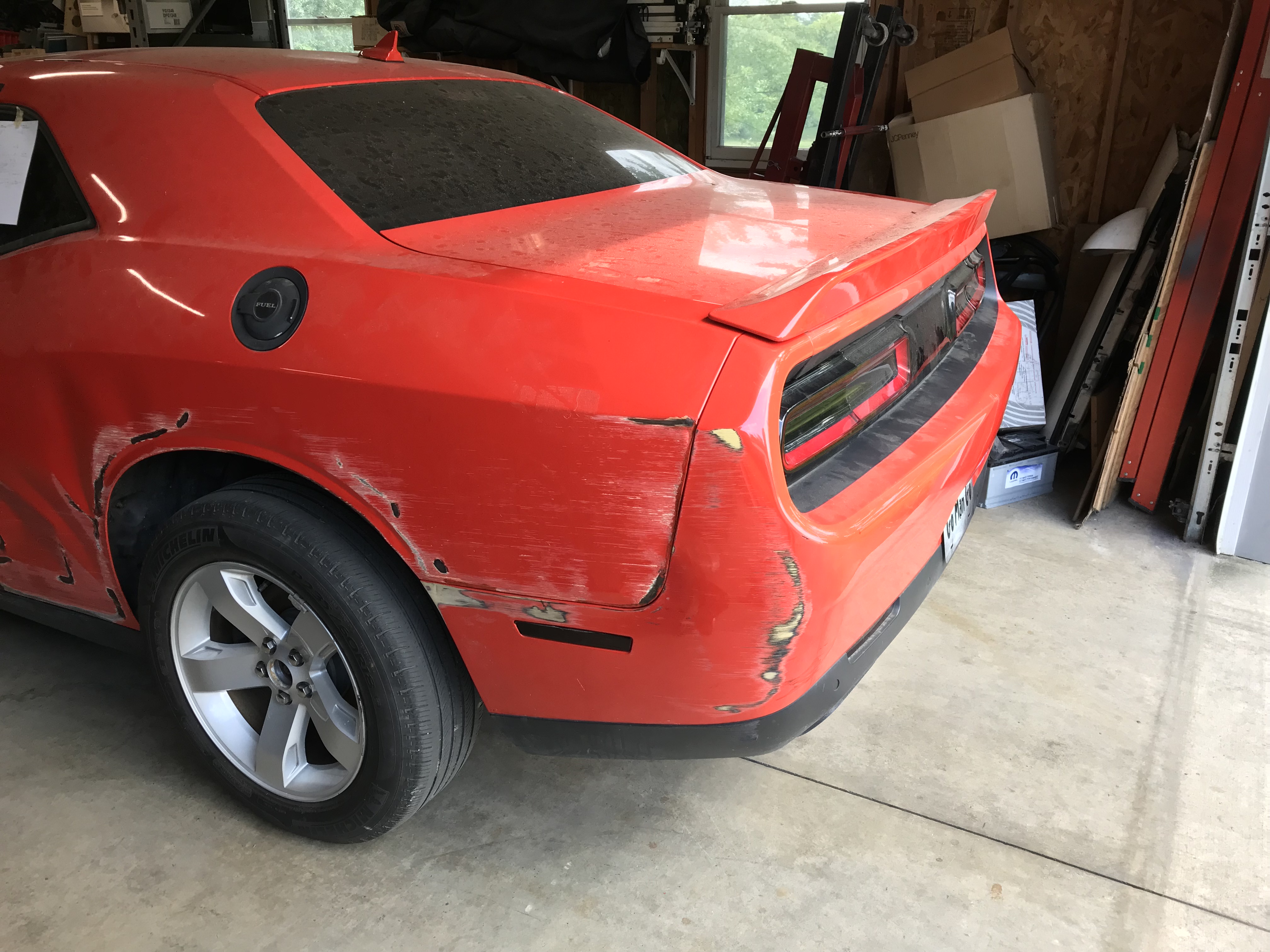

A few pics from this car's past. I did a VIN search and it brought up a used car dealer site.
I noticed the Dodge emblem on the back has been removed, and it has window tint and mudflaps that it didn't have at this point.

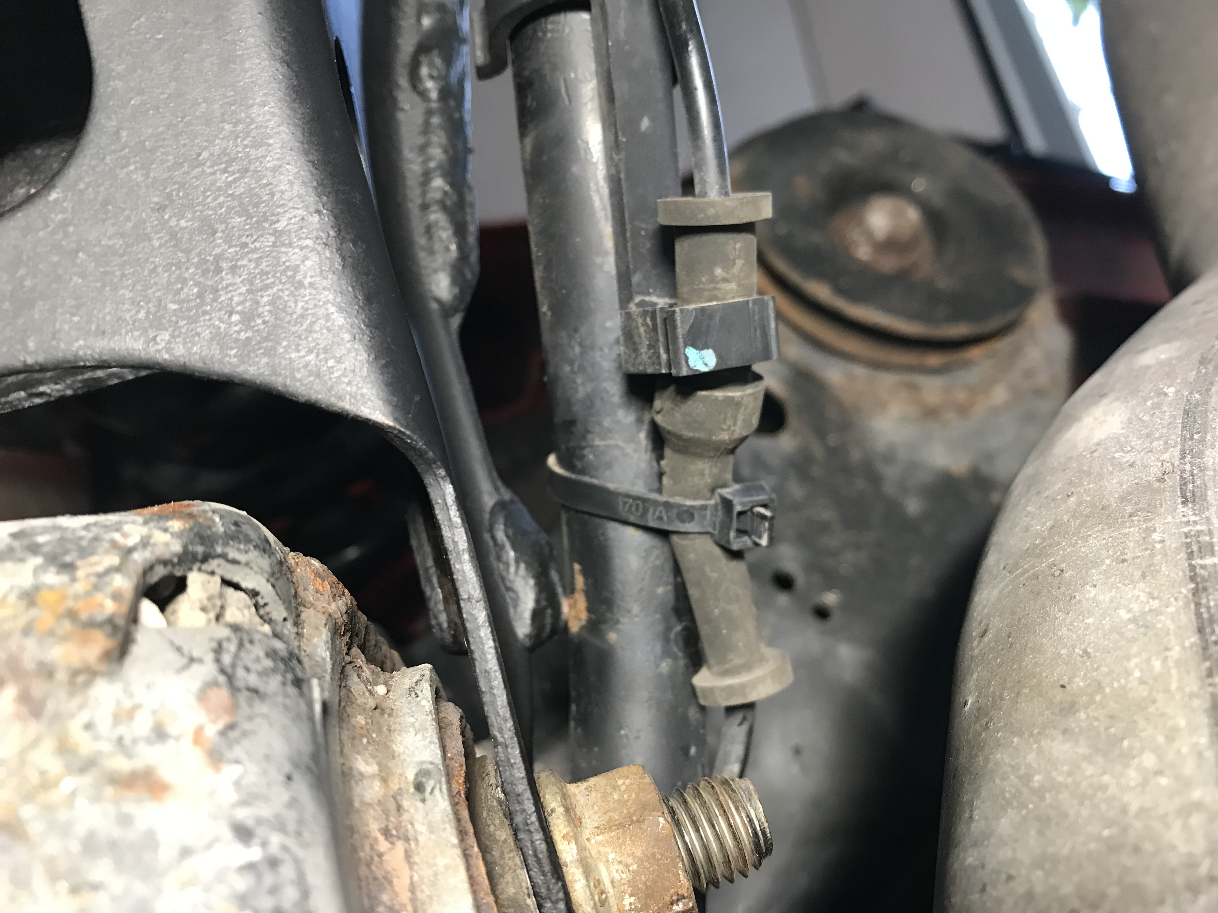

- found the brake lines going into the master cylinder to be bent from impact with the shock tower, also found the RF frame rail to be bent slightly

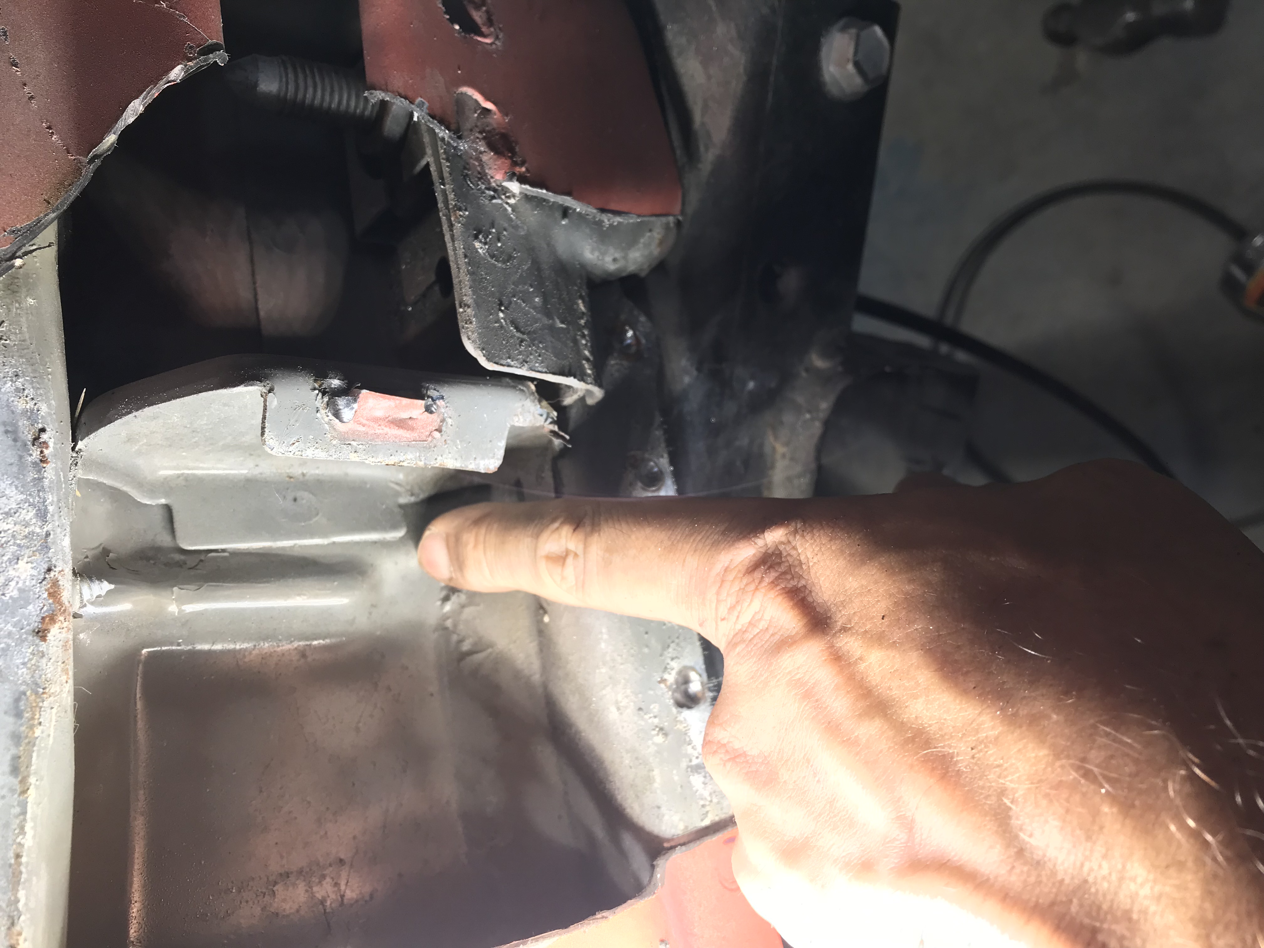

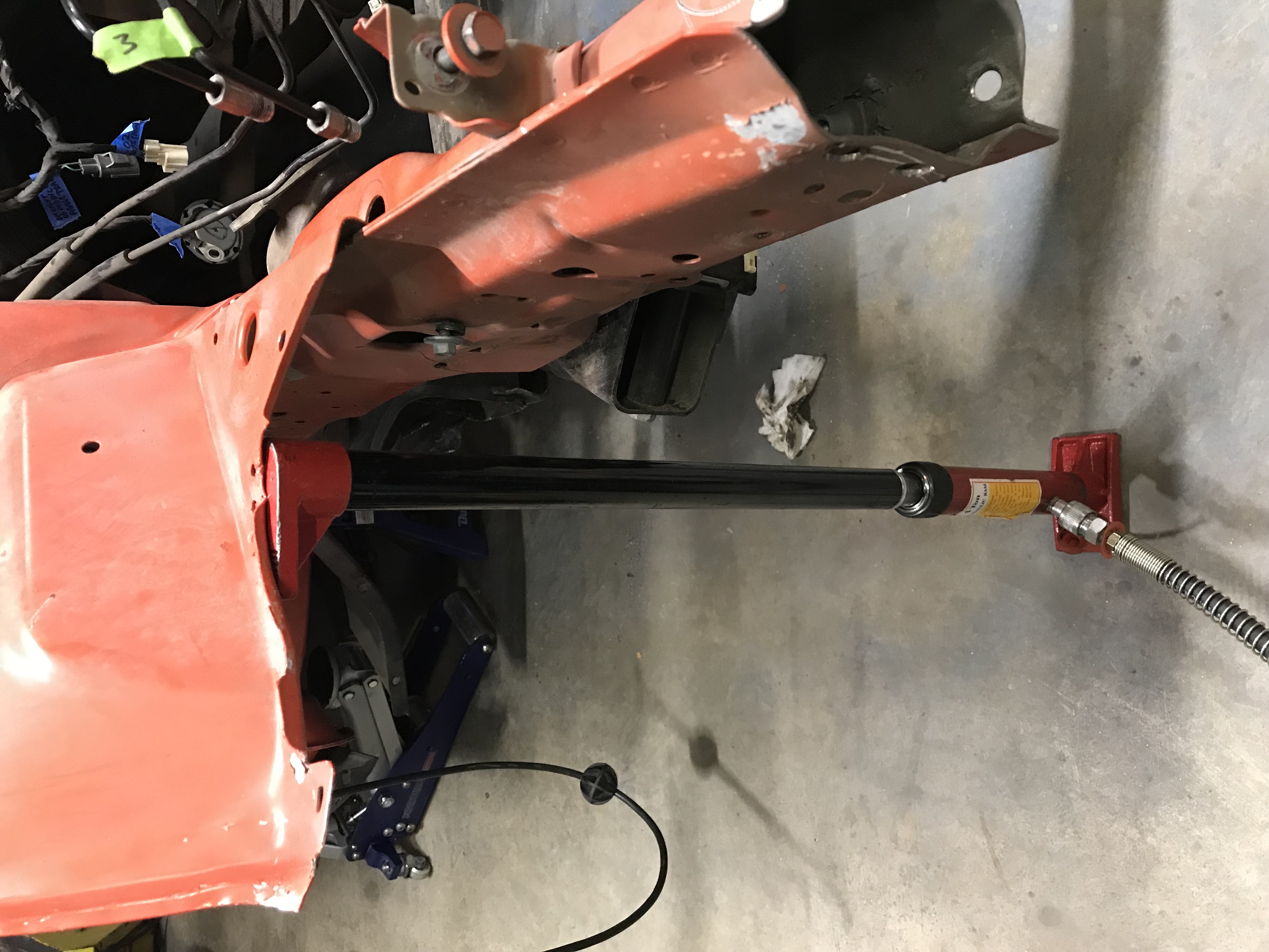

- remove portions of fender support - outer and center layer. pics of some of the damage:
- straighten those parts on the bench/in the vice
- straighten the fender skirt - pushing from the damaged rail to move it over, also put the porta power underneath to provide support
- cut a window in the frame, and pound out the indent behind it - needed a 5 lb hammer to get this to move
- straighten the window part on the bench/in the vice
- the first foot of the frame behind the bumper was not straight, so I cut a section off and straightened it in the vice/bench
- the other part that was still attached took some straightening as well

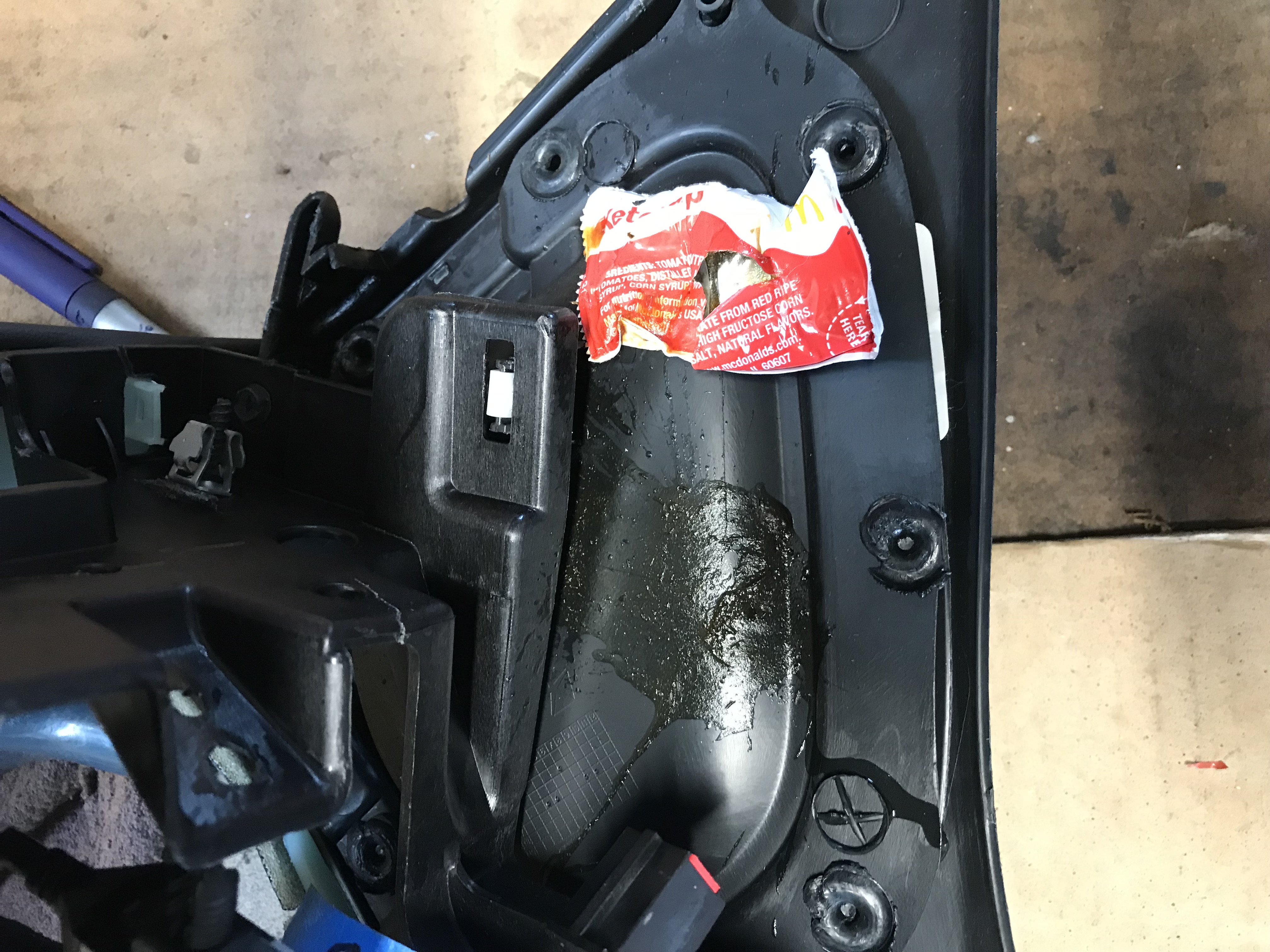

Started interior disassembly to get access to the floor. This uncovered a bunch of small messes - a ketchup packet that got to the inner cavity of the console and blew up, several dollars of change, residue from a giant spill of a red drink (?Code Red Mountain Dew, Hawaiian Punch?), more fries, chips and other misc. This car has been through several owners so can't tell who left what behind.
Carpets are out, driver and rear seat, trim panel under the steering wheel all removed. The car is really getting stripped down for this major repair operation that is imminent. Labeling most of the electrical connections along the way. Still have the dash to remove.

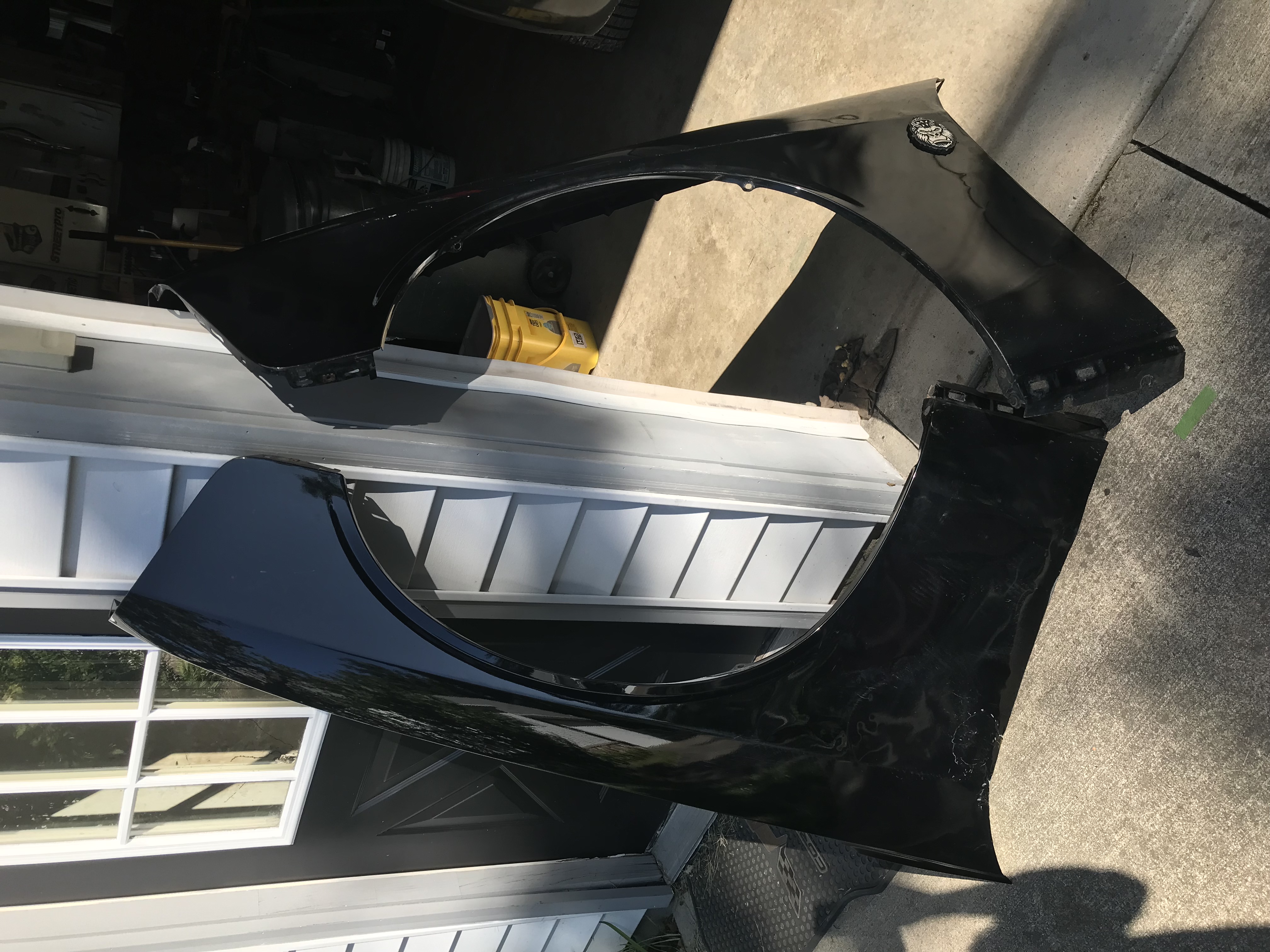

Picked up a pair of slightly damaged fenders for $50 - not perfect but they are close enough to straight that I can use them as templates as I attempt to straighten those that came with the car.

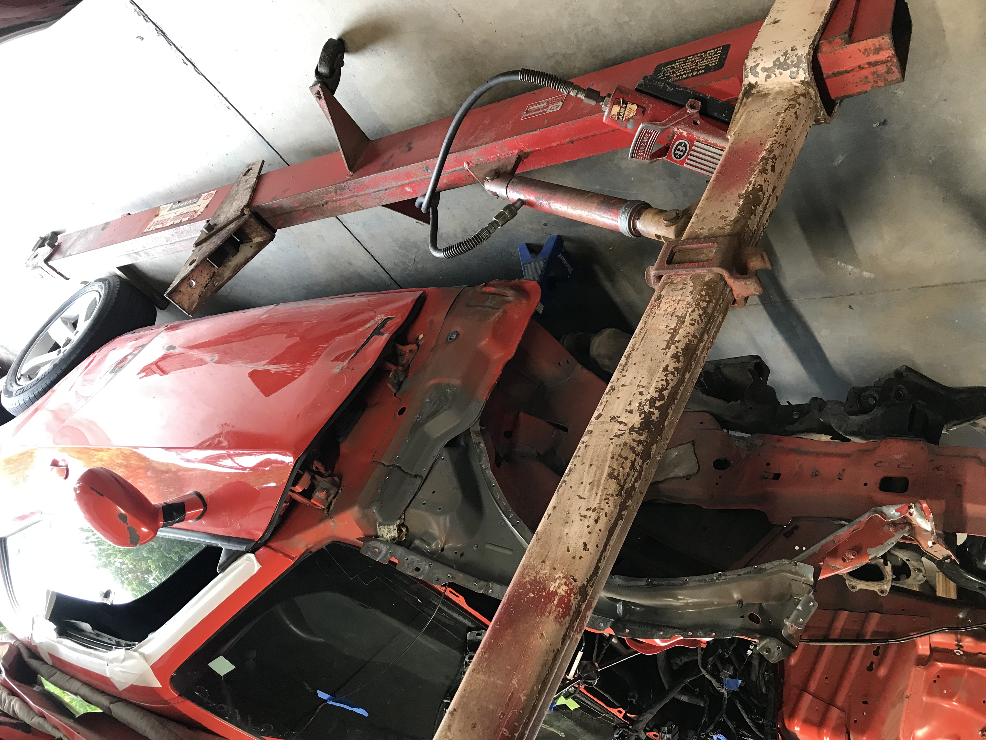

I also have a line on a Blackhawk Damage Dozer frame machine for $500. It is portable but kind of a behemoth compared to more contemporary portable machines. At 1/4 the price I'm thinking I'm going to try it. Spent a good bit of time learning about this machine and what it can do. Frame machines have a lot of accessories and it will be critical to get the pinch weld clamps which were not in the pictures in the ad. I inquired about several missing parts and the seller located a bunch more stuff that was associated with the machine including those clamps. All the videos I watched gave me some ideas as to how to use this equipment to straighten the car.
Posts: 3000
Not much activity the past couple weeks. The main progress is acquiring a frame machine.
Started doing research on this machine. It appears to be a very early version, and it is missing chain, and the cross brace tube.
I now understand the basics of what chain to get, I have a couple attachments and plan to order a couple more. Also need to figure out what grade of steel for the cross brace tube. It's 2.5" diameter round tube as opposed to pipe - just a matter of finding the right grade.

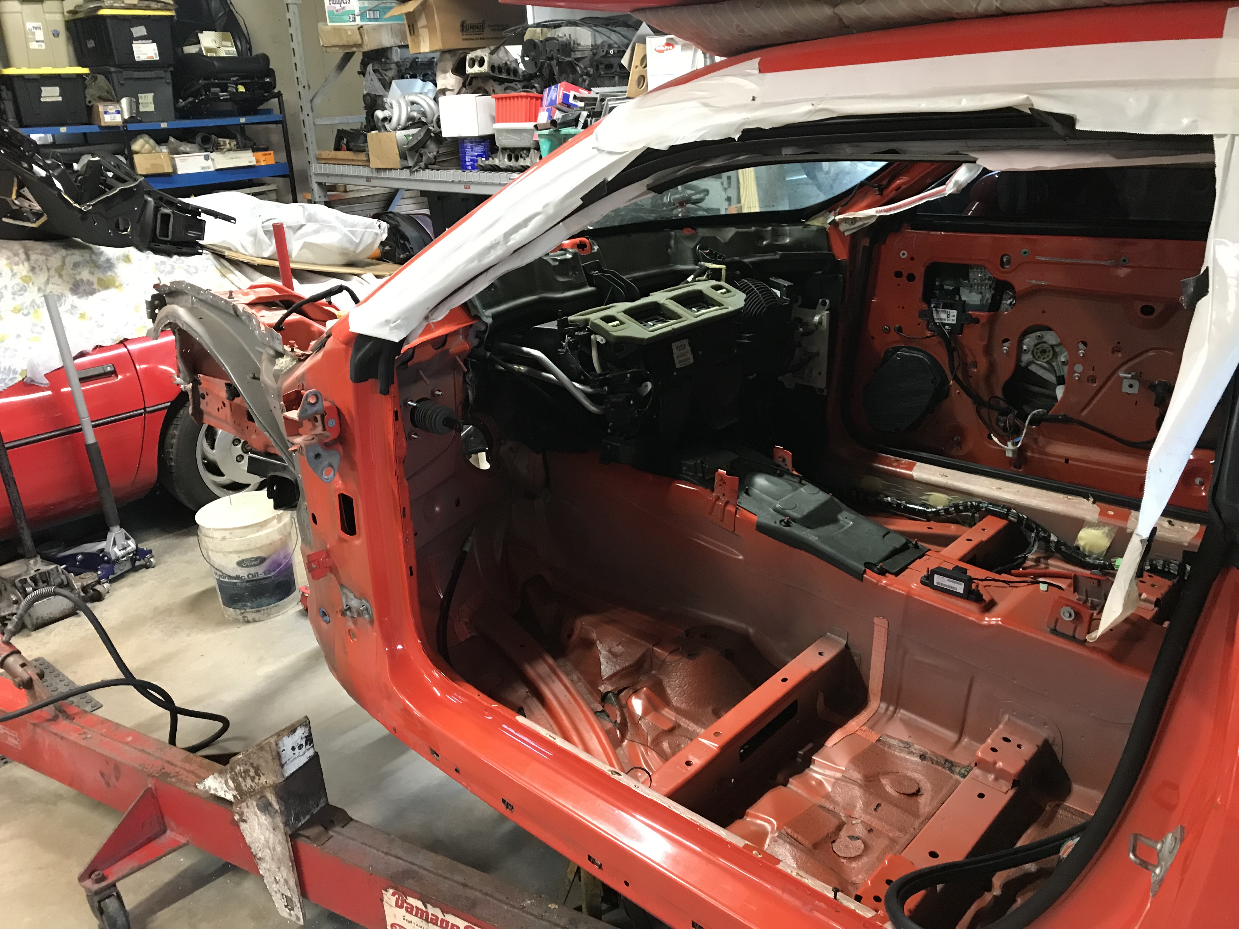

Finish cleaning up the interior floor – the car was gross with spilled soda, and food/trash everywhere.
Removed the dash, steering column, gas pedal, brake pedal, and ebrake assembly. Trimmed off part of the firewall insulation on the inside as I want to see what is bent. The hole in the firewall for the steering column is a bit out of whack from the crash, the plastic base for the gas pedal assembly was cracked, and the brake switch bracket was bent. The brake booster will not come out the LF strut tower is pushed back too far to allow the studs to slide out of the firewall.
Removed the driver side door.

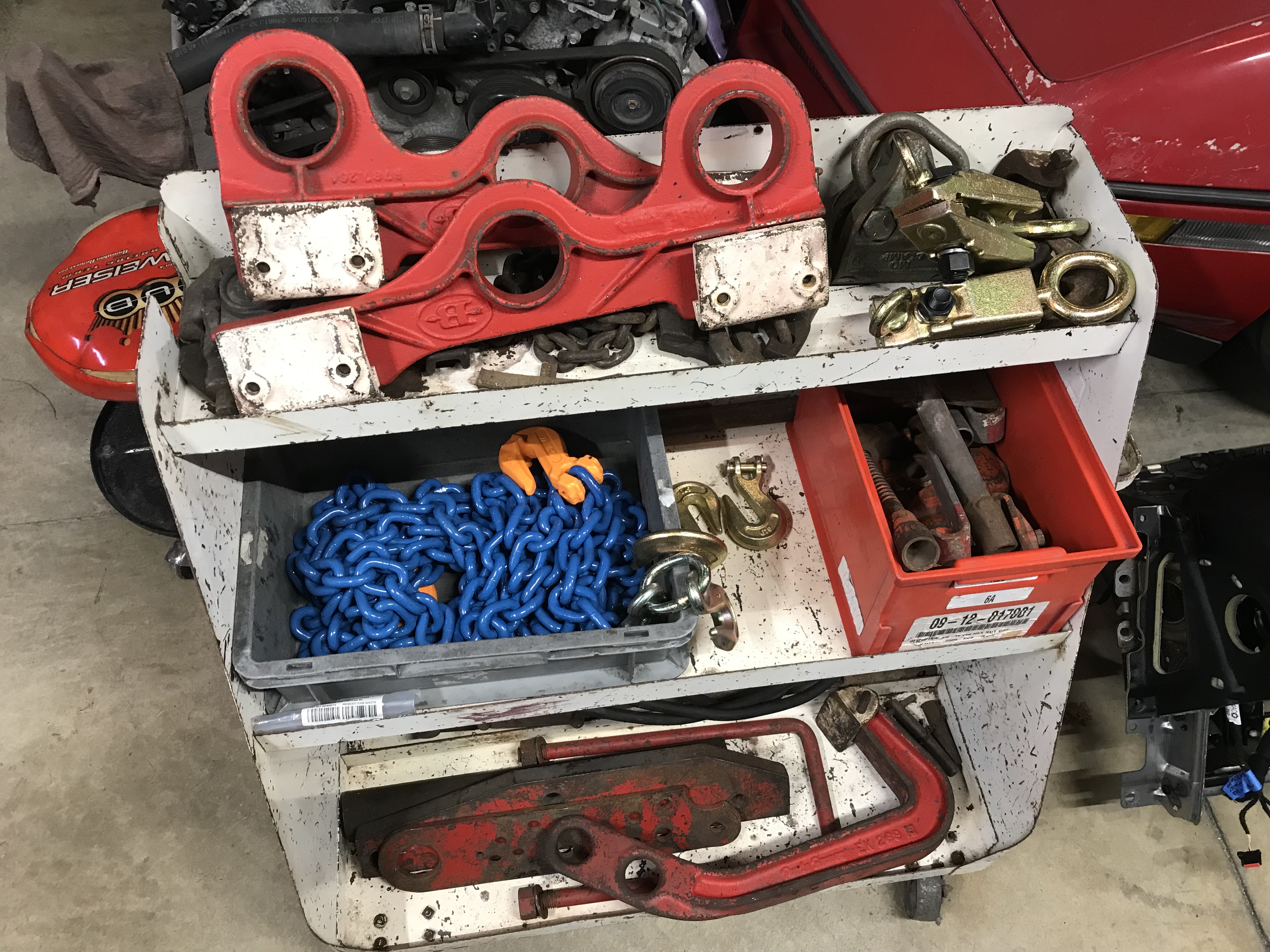

Ordered and obtained accessories for the frame machine. Two 10’ grade 100 steel chains, hooks, some pulling clamps, a few other hooks depending on the type of pull. For first attempts going to use one chain as a brace.
Also spent some time cleaning the frame machine, and all the stuff that came with it.
The car is about as far apart as it’s going to get, and I’ve put it up on stands to get the frame machine under it. I have to fabricate a rectangular pin for the frame machine then start lining up the first pulls.

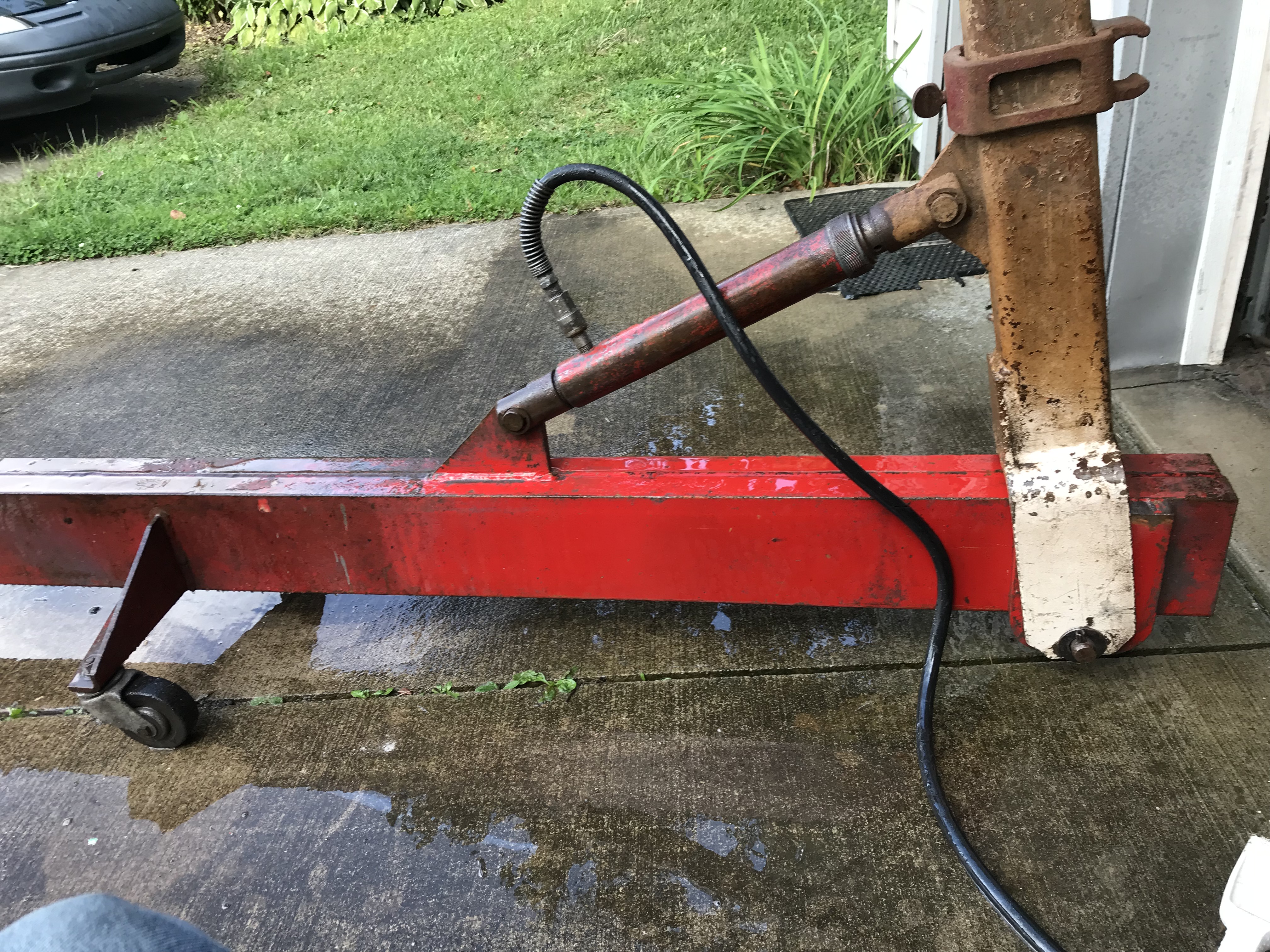

Made a first attempt at pulling out some of the damage, which uncovered a leak in the hydraulics on the frame machine. It’s located where the hose connects to the cylinder – I assume there is an o-ring in there that has dried out

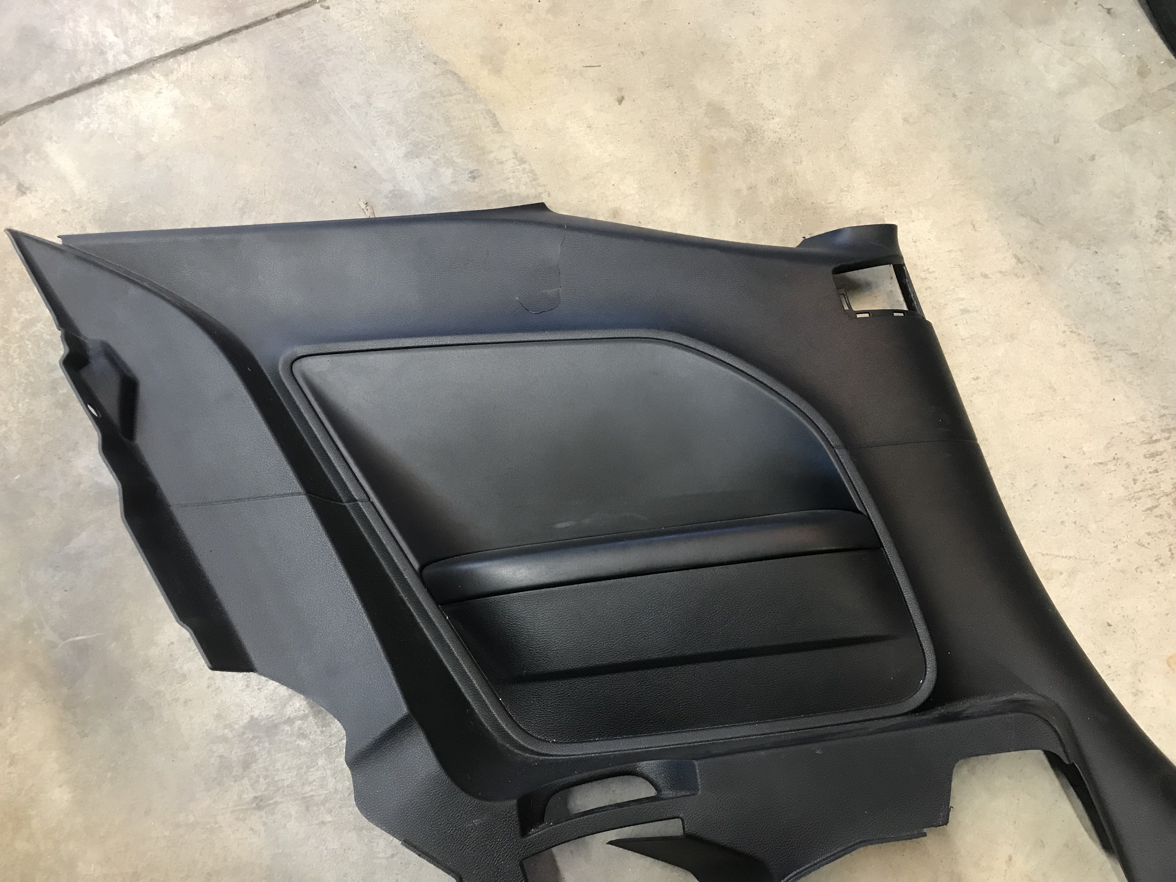

Plastic welded the inside rear side trim. There were cracks in both sides. I just closed up the cracks by melting the plastic back together on the back side

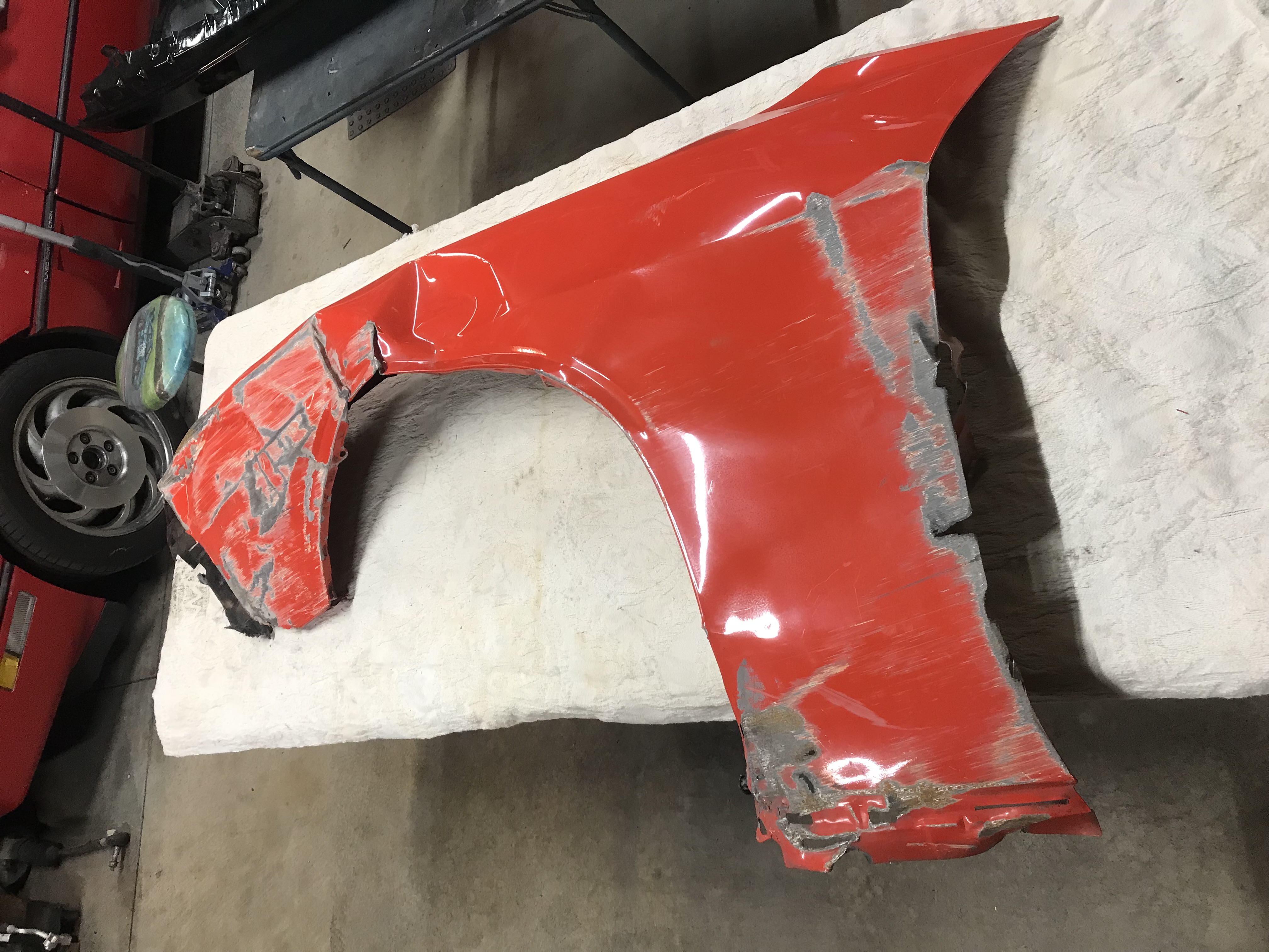

RF fender:

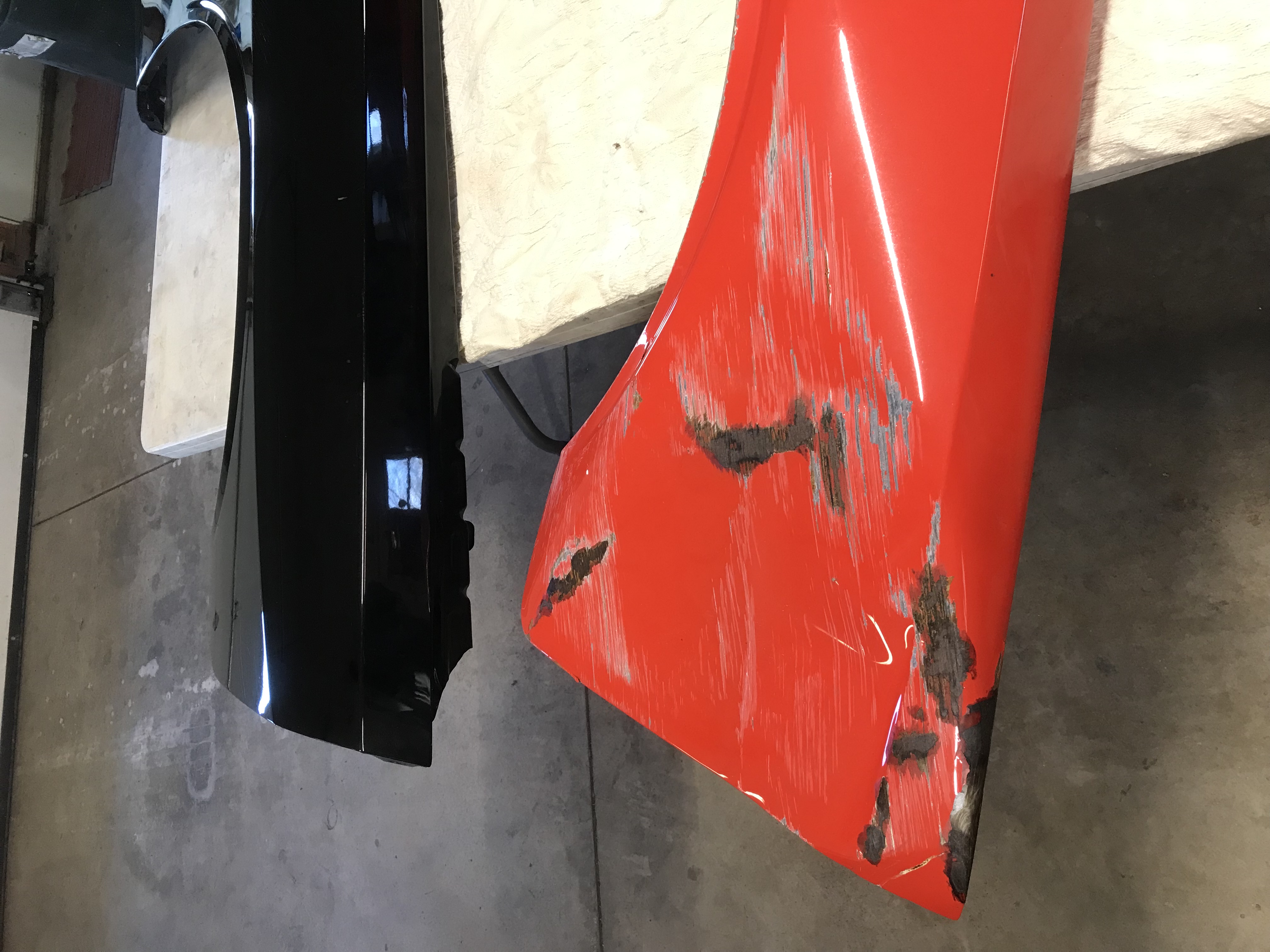

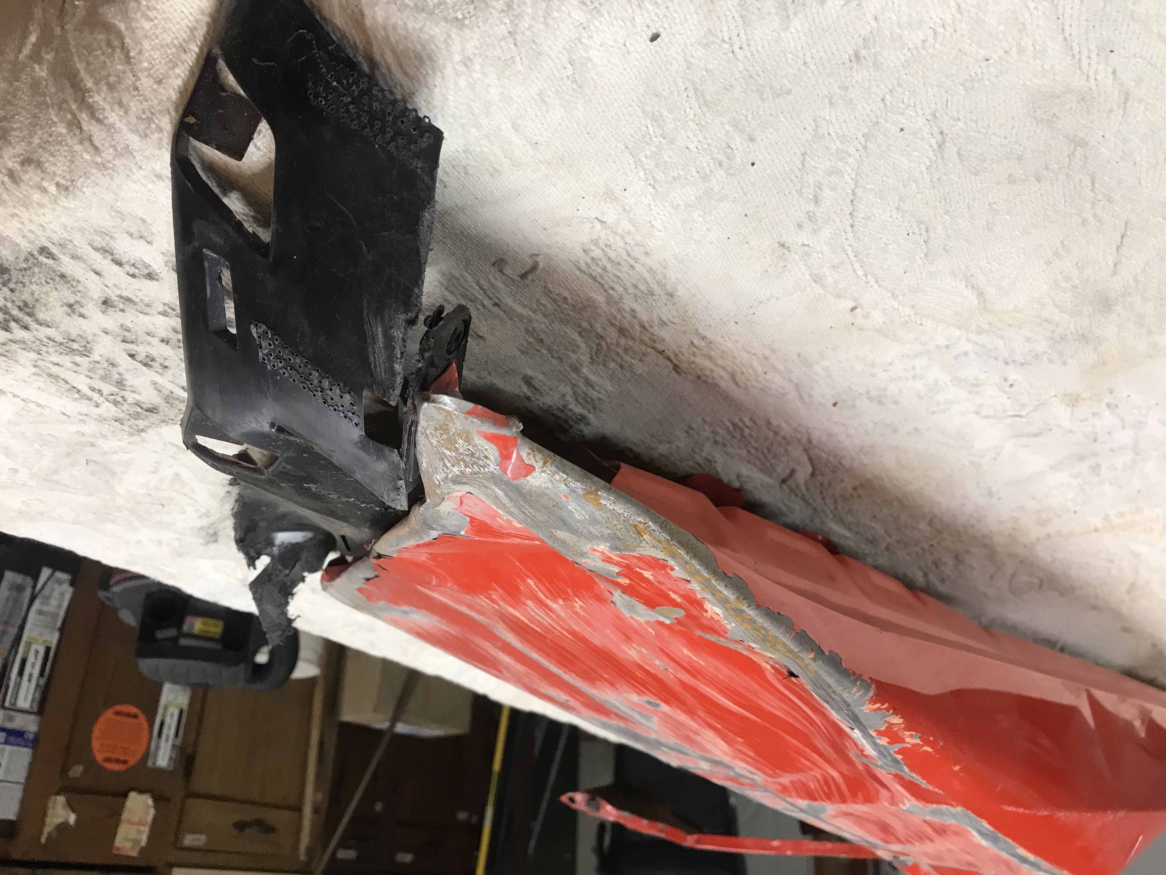

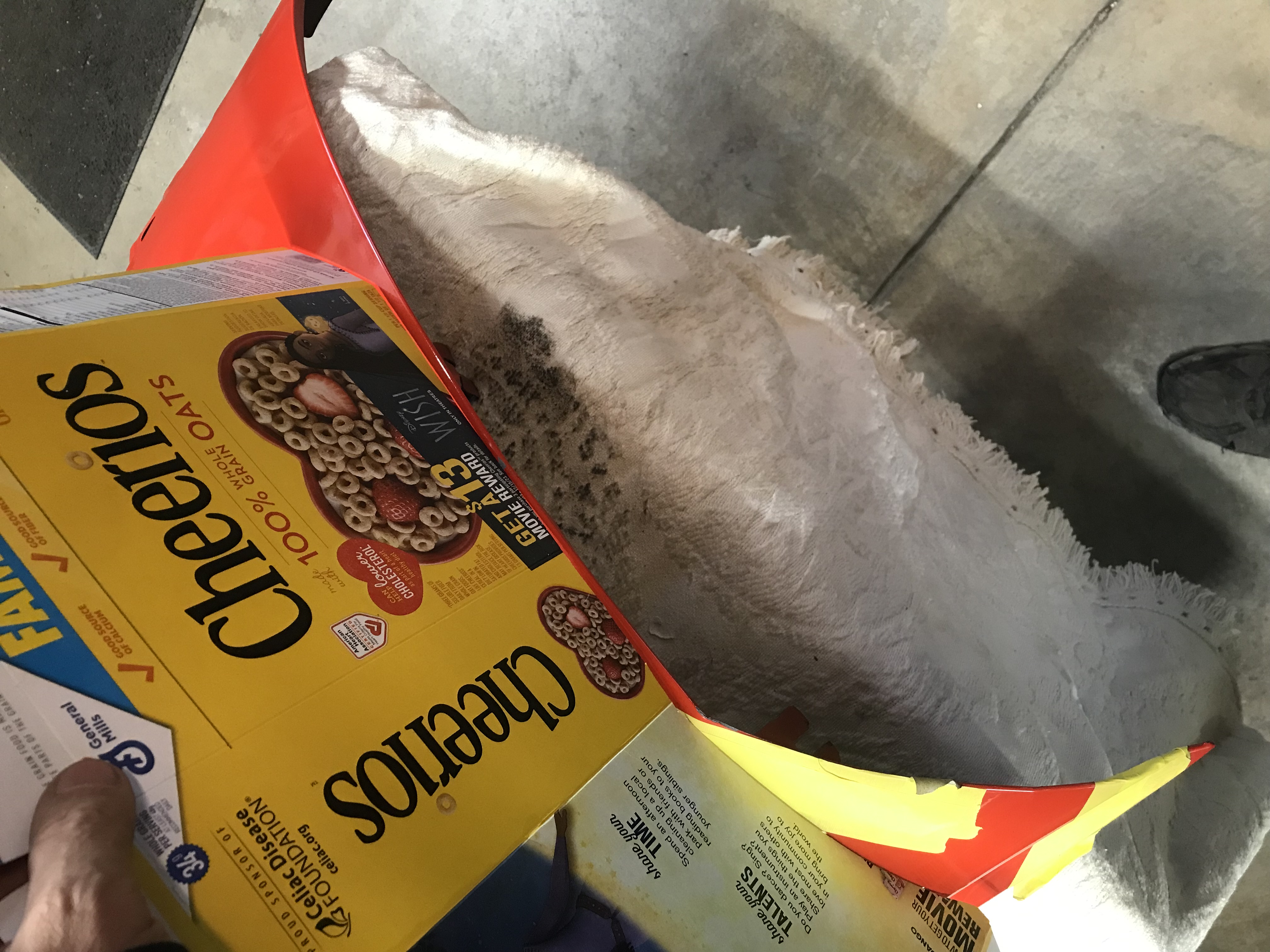

Did most of the heavy lifting on straightening this fender. On any normal shop repair this fender would be replaced, but I want that patina to stay with the car
The front was bent in quite a bit so there was a fair amount of bending required to get it back into form. The bottom of the front was also bent in so it got some attention. There were a few other spots to straighten but the hardest was the door edge. Ended up making a cardboard template matching the contour of the door, and did a lot of test fits.
Have some used/slighlty damaged fenders as templates. They are bent along the door edge. Since the door on the passenger side is straight at the front I made a template to help get the door edge of the fender in decent shape
LF fender:
Definitely the most bent up panel. In two spots the metal is folded over on itself. I believe this panel was torn off the car in the accident.
The front corner was pancaked badly. Had to get creative to re-establish the correct contours. Pics will tell the story. Also had a couple spots where the metal was folded over on itself. It took some prying to undo the folds before I could start making these flat. Other corners and edges got straightened, and I pounded out the worst of the dents. Had to get creative so as not to damage the paint that’s left – I avoided pounding on the outside where possible, and put a few layers of masking tape on that side where I had to hammer on that side. It’s not done yet but it looks a lot more like a fender.
