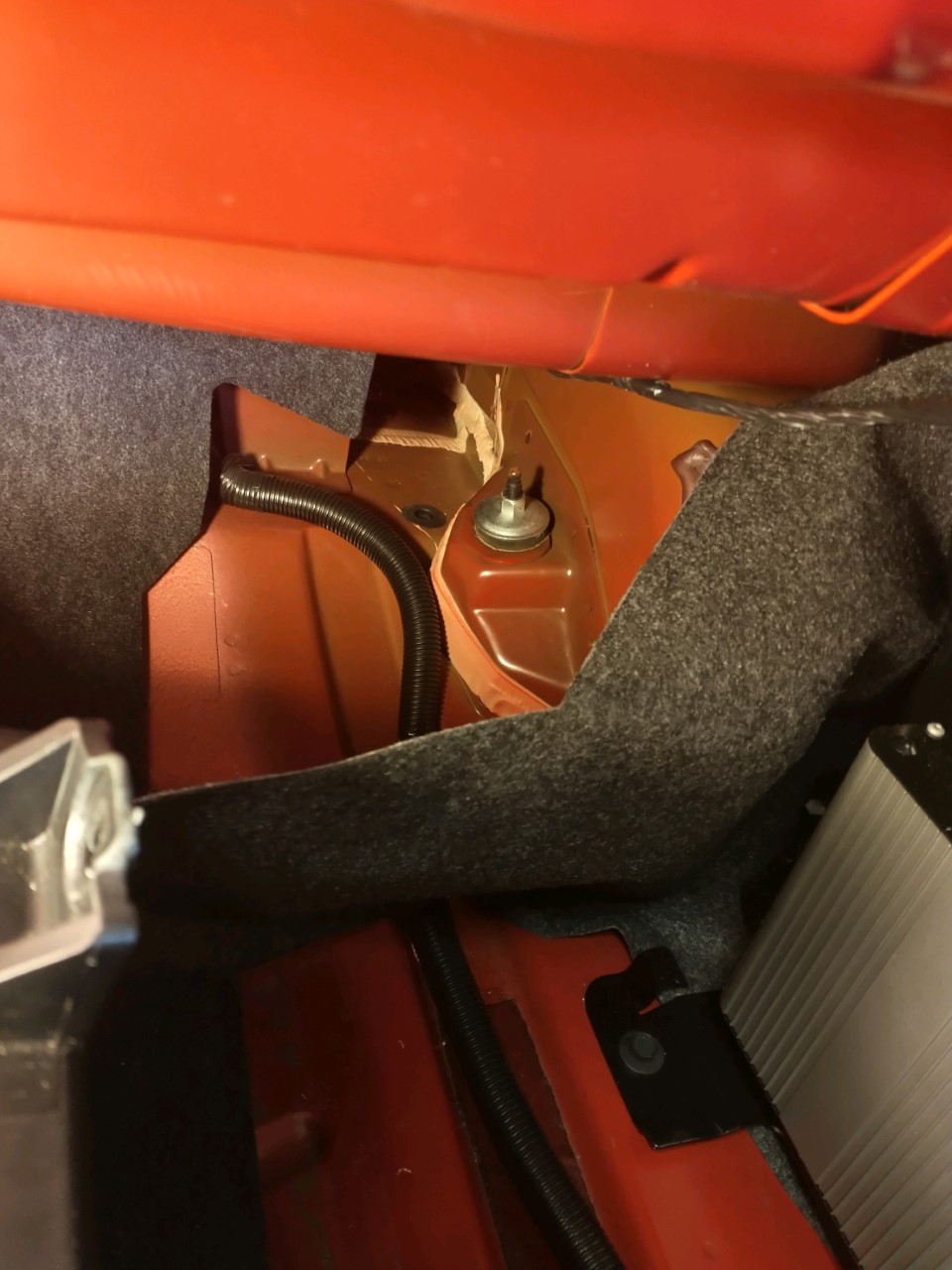

I also replace the rear shocks with new Motorcraft ones. The shocks were buried pretty well, especially on the passenger's side with the factory subwoofer in the way.

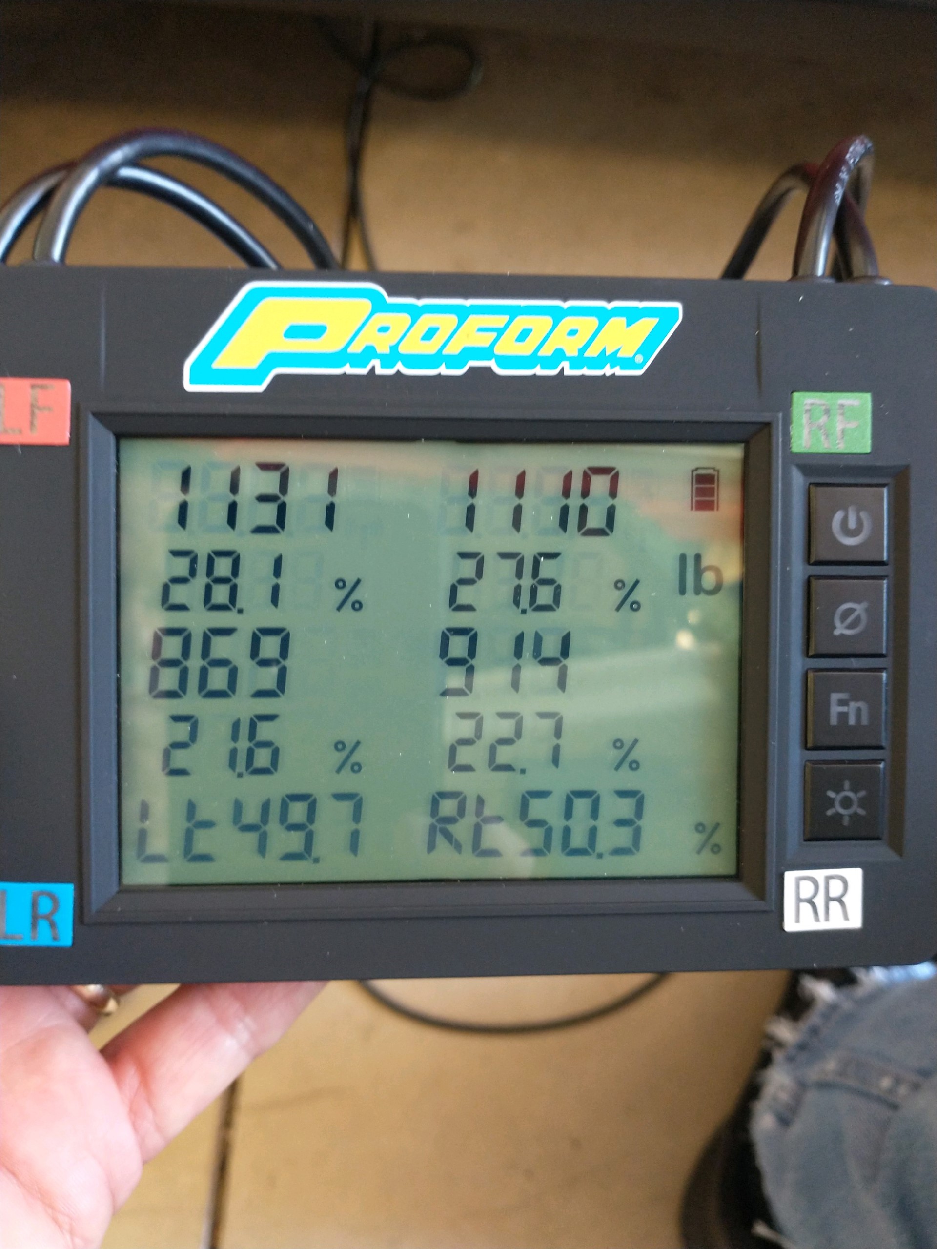

Been driving this thing with regularity and enjoying it quite a bit. It helps that my wife likes it. I put this one on the scales too, and it also had about 5/8 tank of fuel in it. It's pretty well balanced left to right, and I expect with me in it would be dead on balls 50/50. Front to back, notsomuch. With an iron block, it's pretty nose heavy (55.7/44.3). This is with the top down, so with it up would be even worse. And as expected, it's a porker, at 4024 lbs by itself. I think in 2011 the GT500s went to an aluminum block and did some other things to cut weight.
