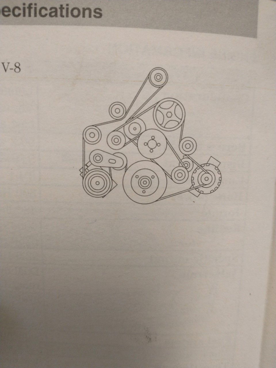

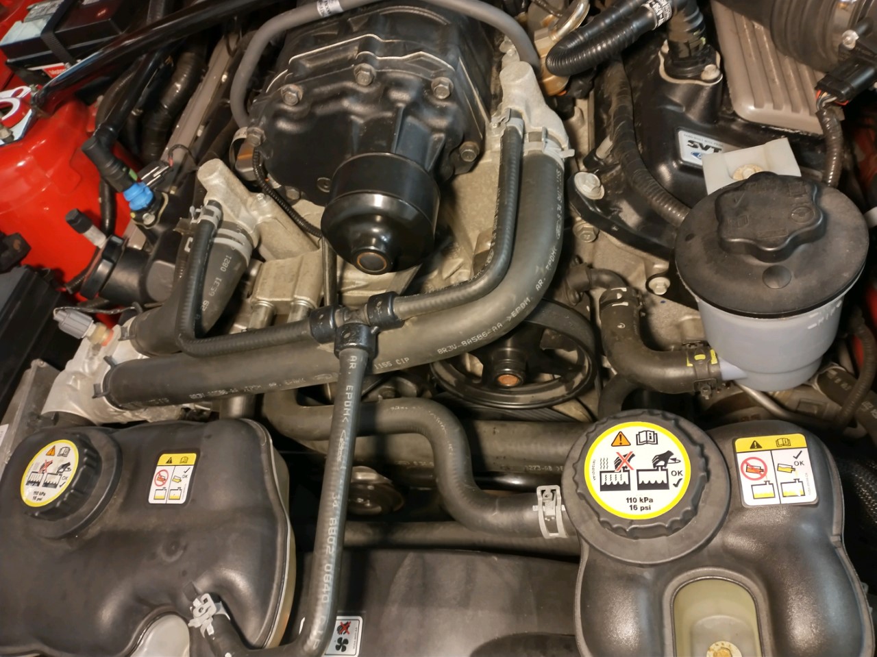

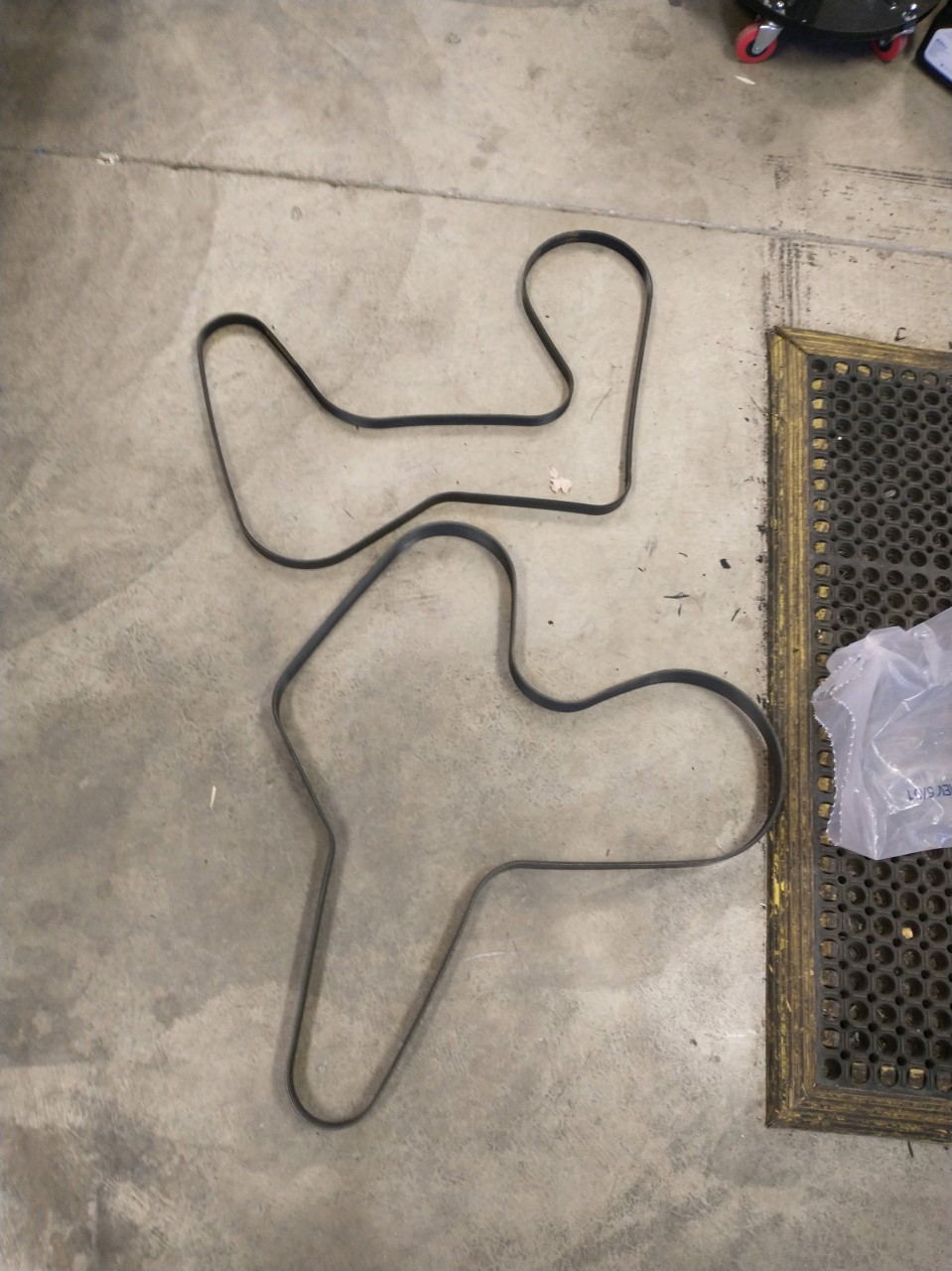

On Sunday morning I thought I'd tackle an easy-ish project by replacing the belts on the Shelby. There are two of them and they are basically stacked, so the accessory pulley (alternator, crank, water pump, P/S) is on the outside, and the blower belt on the inside (supercharger, A/C, crank) which is a very wide belt. This was about a two hour job when you do it the first time. It's another scenario where being skinny and not having meat hooks for hands helps. The job doesn't require any major disassembly, just some patience to get the outside belt off, and the removal of the tensioner to get the inside belt off. The problem is most of the job is done blindly, with a lot of getting up top and laying underneath to complete the task. There was a mirror and a bungee involved for reinstalling the tensioner too. But I persevered. I'm glad I did it too as the old belts seemed a lot older than their 14 years would suggest. A scenario where sitting too long took it's toll on them IMO.
It's funny, if you look at the old belts carefully, you can basically see where they formed to the pulleys when they were sitting for several years.

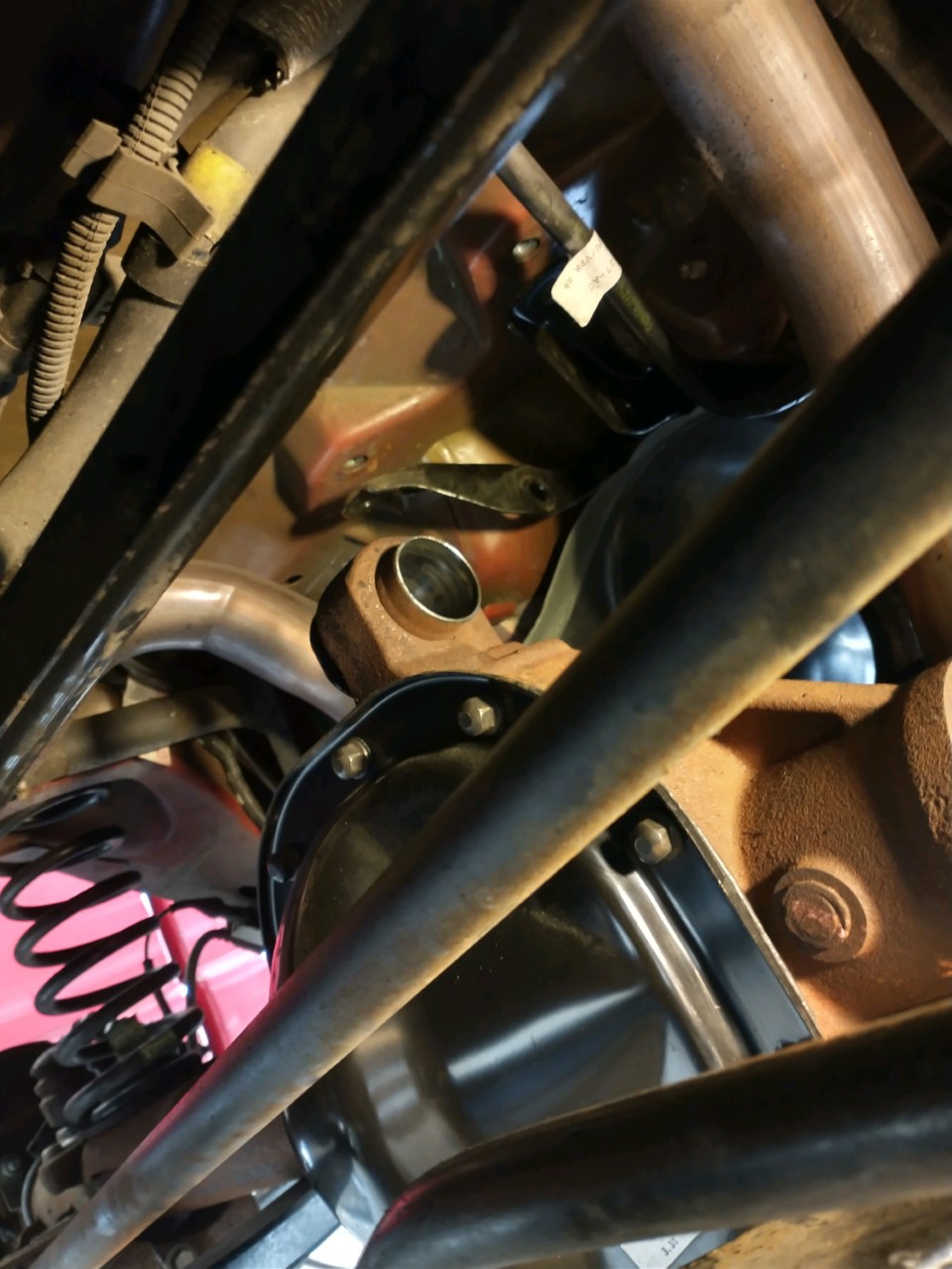

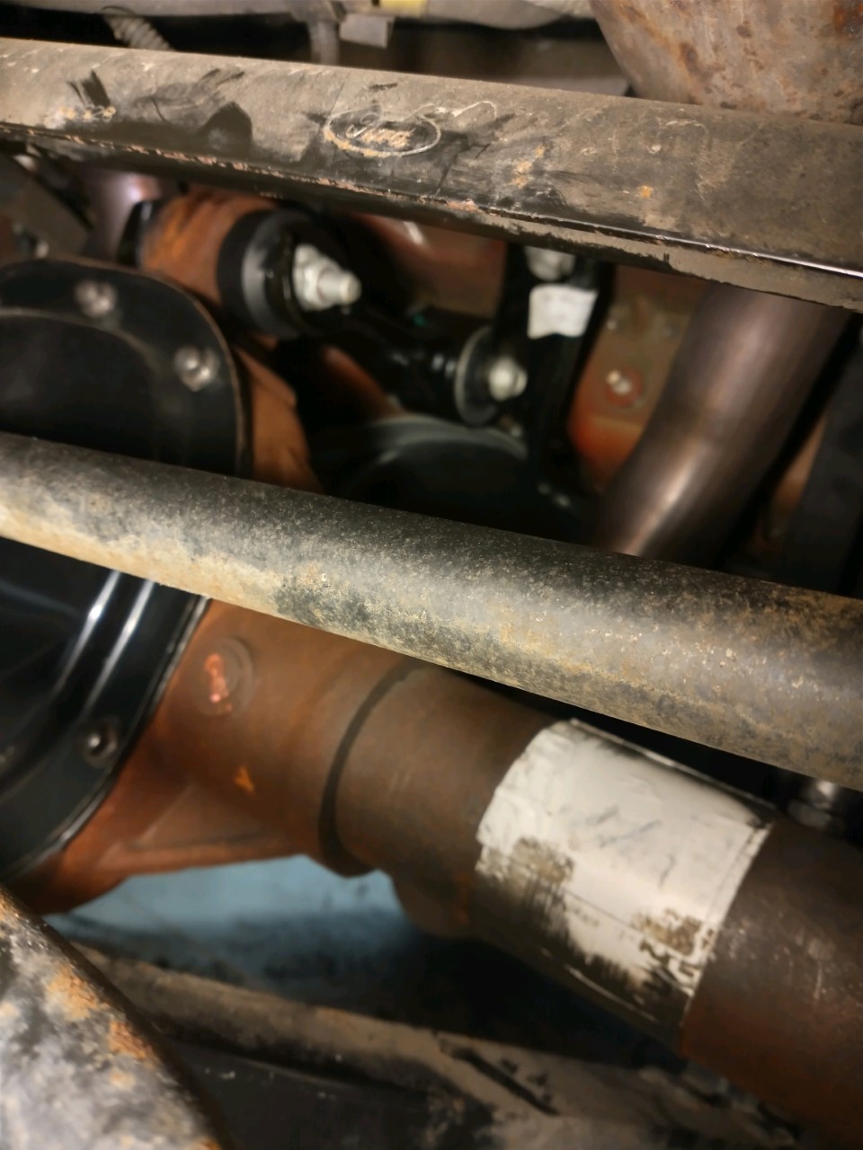

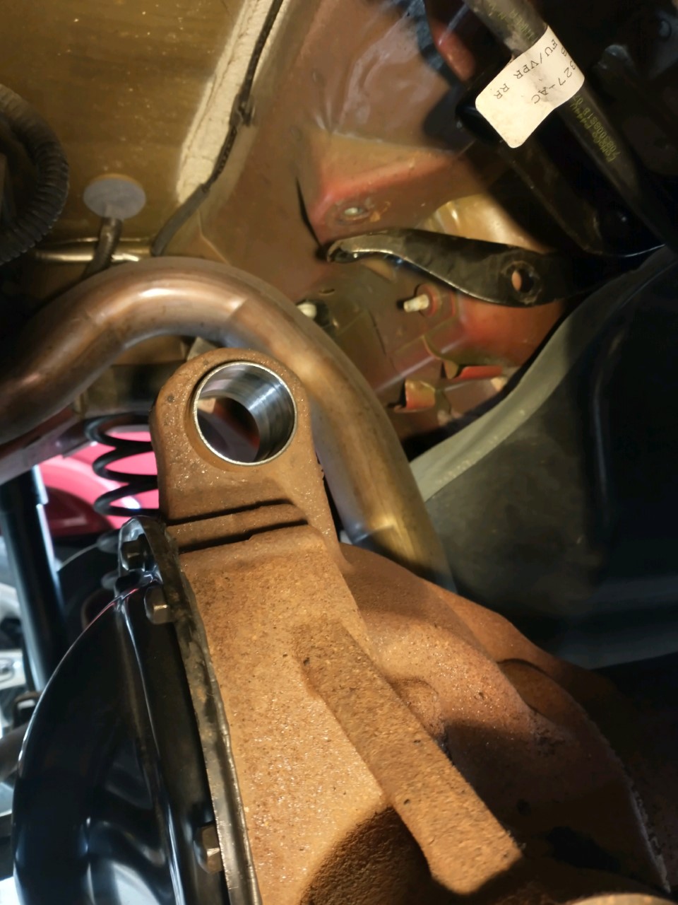

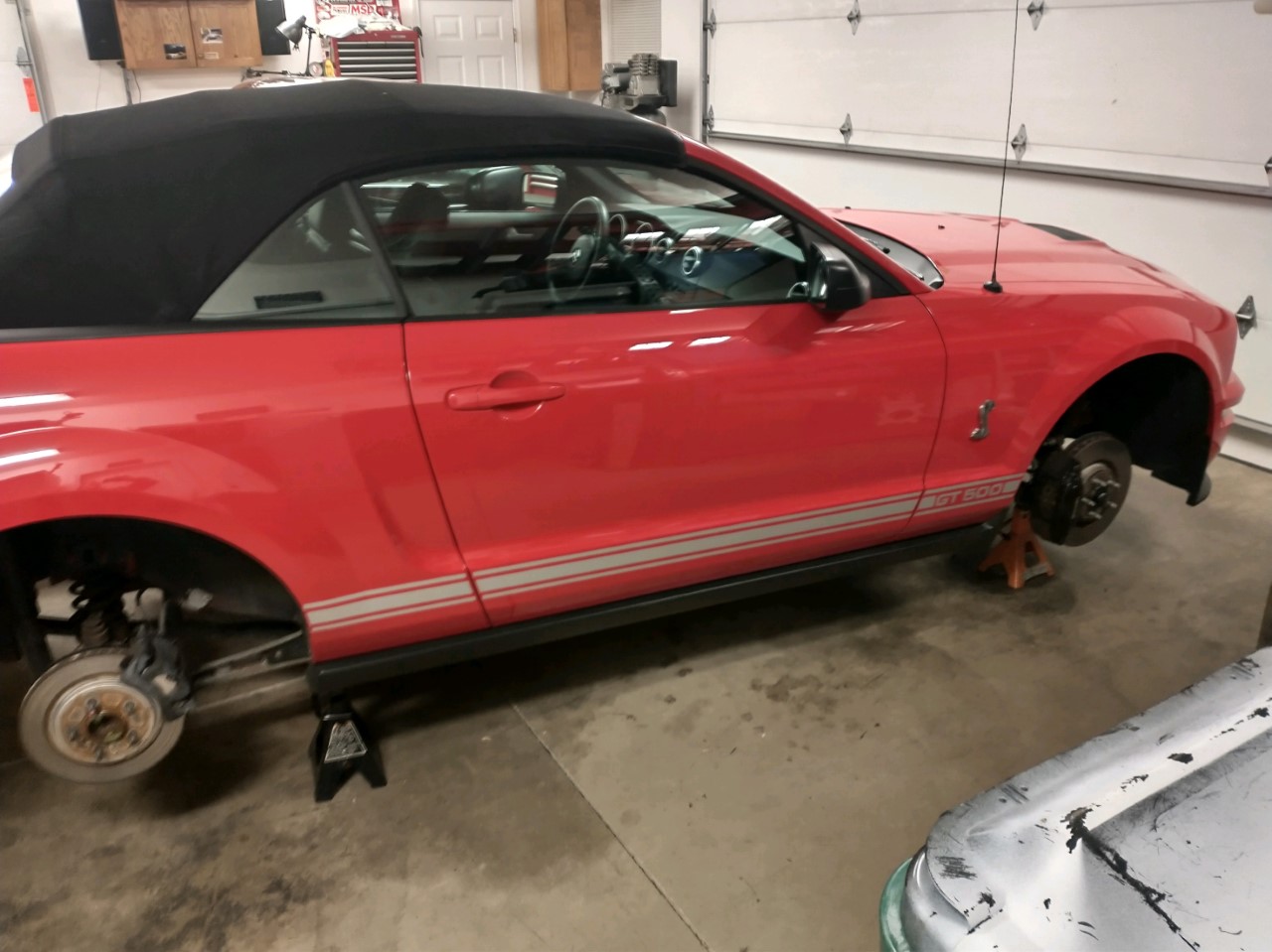

Over the weekend the Shelby got new Michelin Pilot Sport tires in the factory size. While I had them off I decided to tackle the rear wheel hop problem (hopefully). The upper control arm (there's only on) although low mileage, had two bushings that are dry and cracking. Being a convertible and a GT500, this is a tougher job than a stock Mustang, but I was able to get the control arm removed. I attempted to remove the bushing, but gave up after not too long and just decided to get a new control arm with a new bushing already installed.

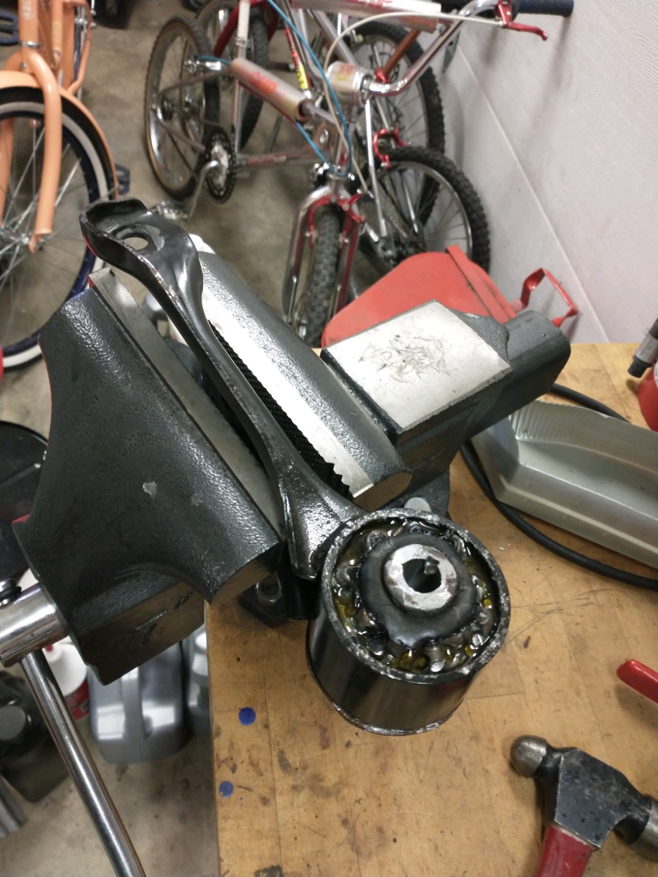

The bushing on the pumpkin is also press out, but LMR offers a urethane bushing to go in it's place reusing the steel sleeve that the existing bushing is in. You drill out the rubber all around the steel sleeve, then just attack what's left of the rubber with a wire wheel. I believe it's this urethane bushing that will do the most to help fix the wheel hop. I don't want urethane up on the body as I don't want to listen to the clunking. This isn't a race car, it's a cruiser, so quiet and smooth is more important.

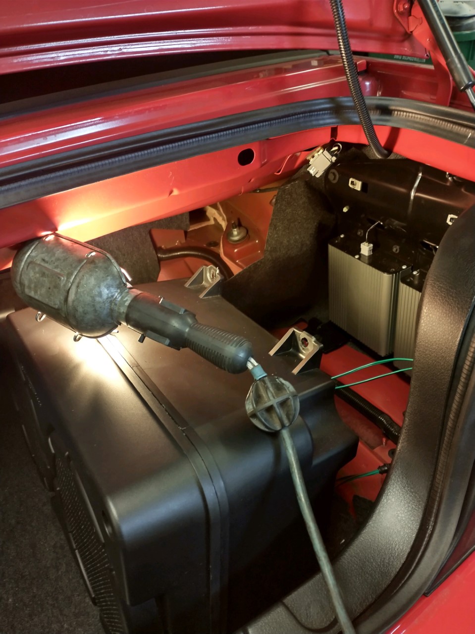

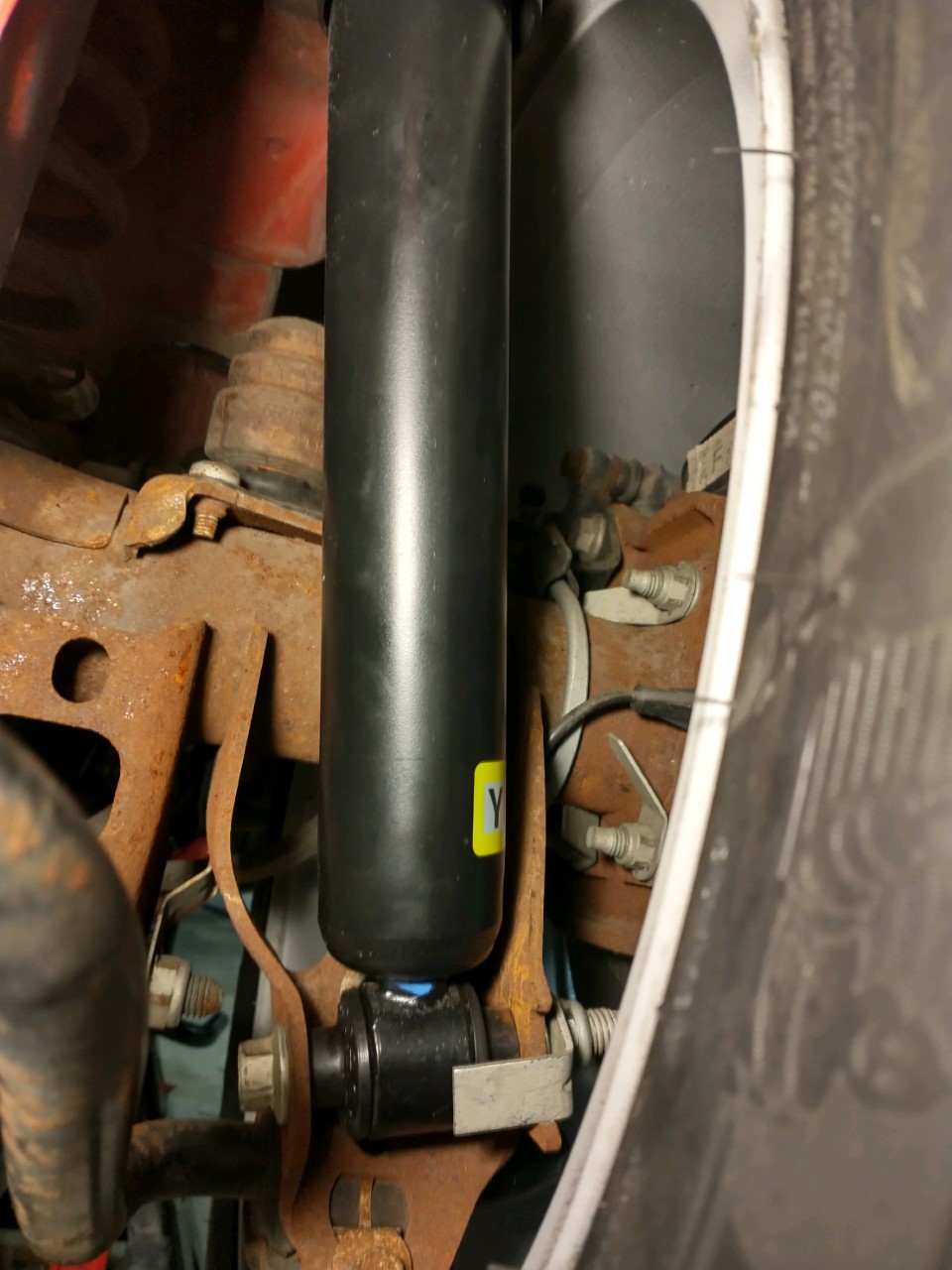

I also replace the rear shocks with new Motorcraft ones. The shocks were buried pretty well, especially on the passenger's side with the factory subwoofer in the way.
I'm hoping the new softer tires and all these upgrades will cure the hop, or at least make it a lot less violent where I could put some power down in first gear without rattling my teeth.
Posts: 3656
Re: 2009 Shelby GT500 Convertible
A couple evenings last week and late Saturday afternoon, I was able to finally get the new upper control arm and the bushing on the axle housing installed. The one on the axle was really a struggle to get the rubber out and pound the urethane one in. LMR's video just says to "tap" the bushing into the sleeve with a hammer. I pounded on it for almost an hour and a half with a four pound hammer (the biggest I could fit in that area). This doesn't include the time I spent drilling the rubber bushing out, and then burning it down with a tiny wire wheel. But at the end of the day, I win. Everything is back in place and I can happily say, at least on the street, that the wheel hopping is gone and I can actually use first gear under full throttle now. Between the bushings, rear shocks, and the new tires, the car rides SO much better, and is noticeably quieter inside too.
So now, I think really all I plan to do is a quick wax job, and I'm ready to cruise this summer. I will certainly take it to the drags, and might try a top down autocross too.

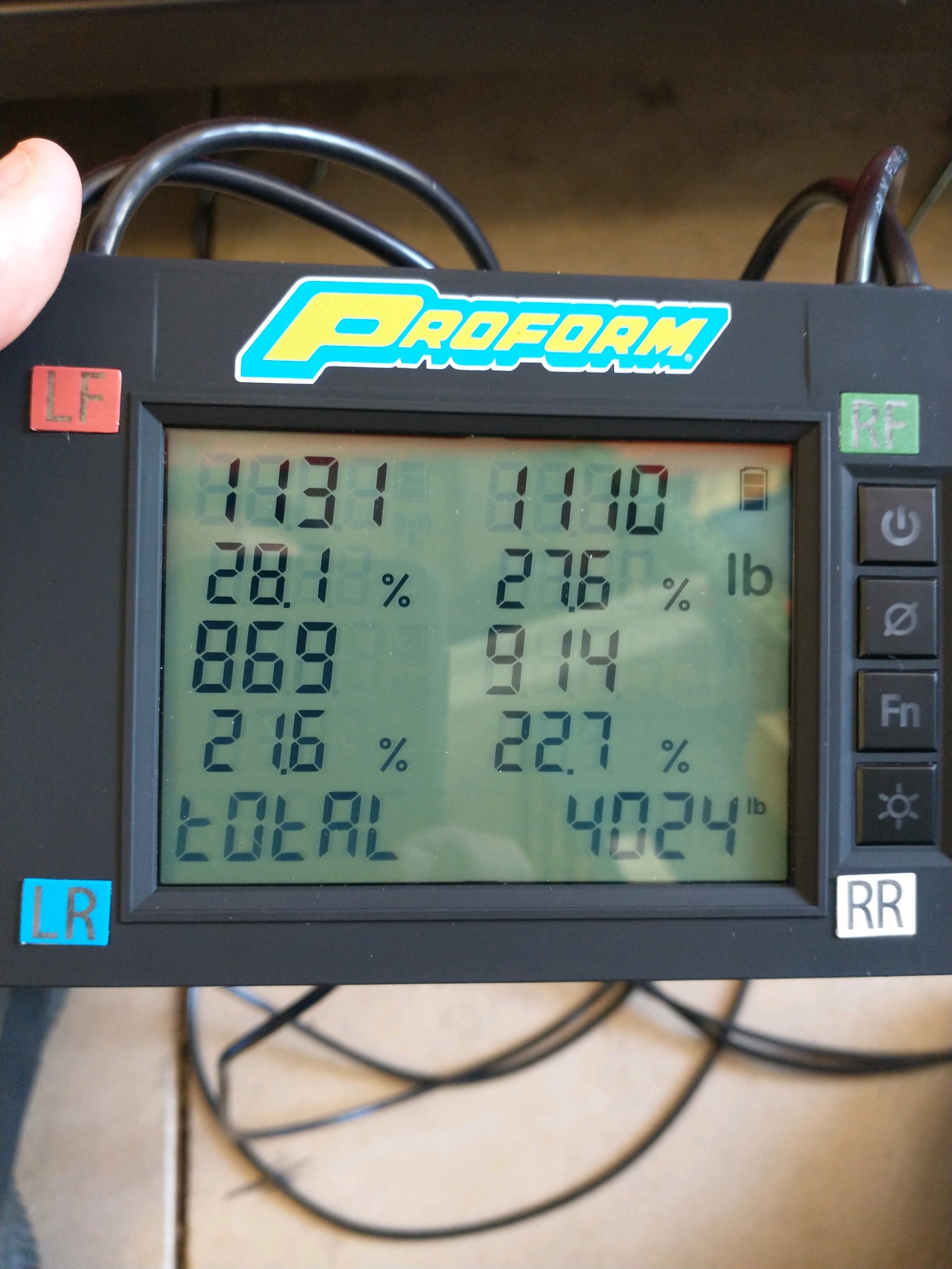

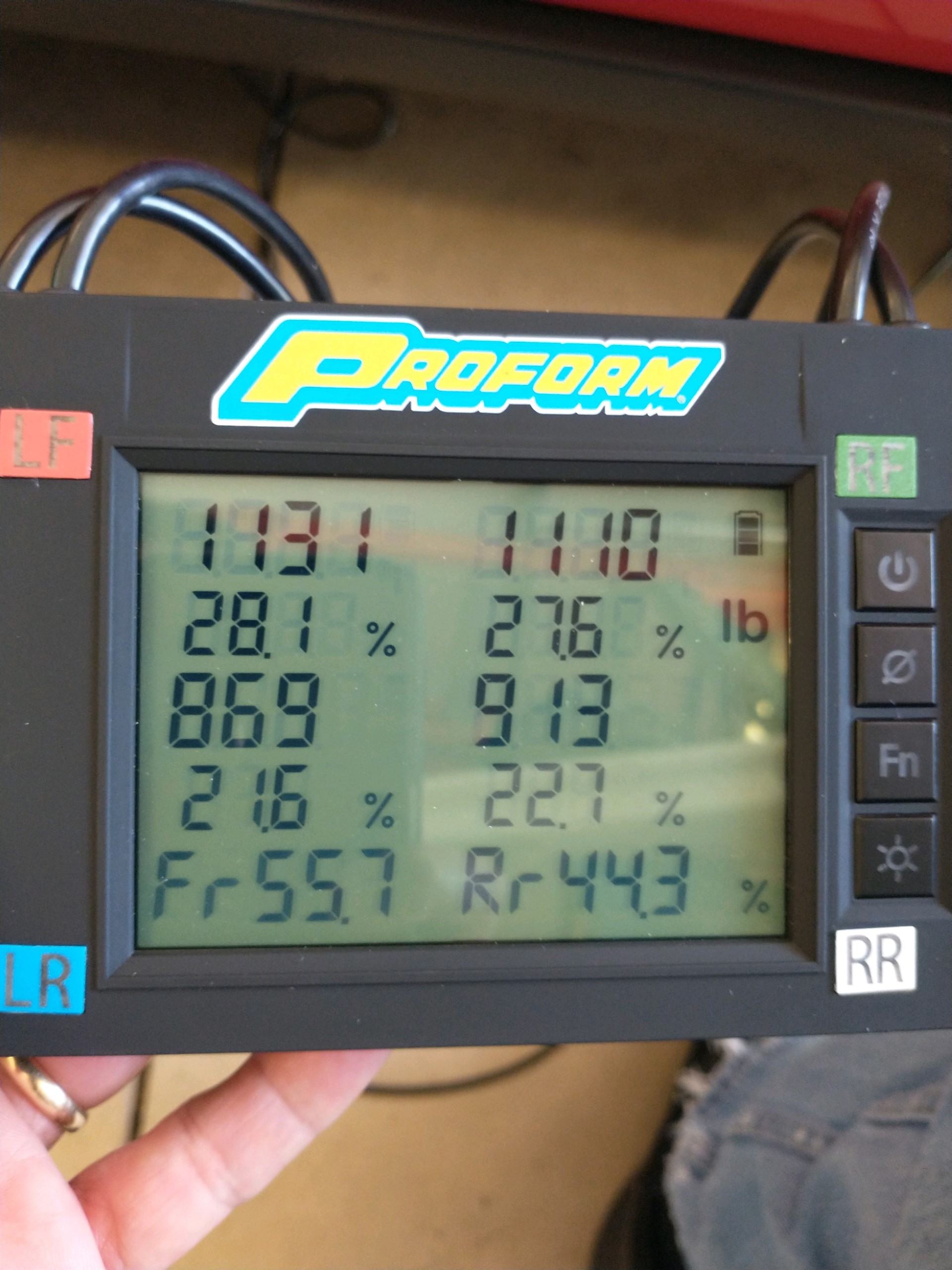

Been driving this thing with regularity and enjoying it quite a bit. It helps that my wife likes it. I put this one on the scales too, and it also had about 5/8 tank of fuel in it. It's pretty well balanced left to right, and I expect with me in it would be dead on balls 50/50. Front to back, notsomuch. With an iron block, it's pretty nose heavy (55.7/44.3). This is with the top down, so with it up would be even worse. And as expected, it's a porker, at 4024 lbs by itself. I think in 2011 the GT500s went to an aluminum block and did some other things to cut weight.

Posts: 3023
My Impala SS came in under 3900 and according to what I see online so does the V6 Challenger. Porker is right- but it has the horsepower to move it all so no worries!

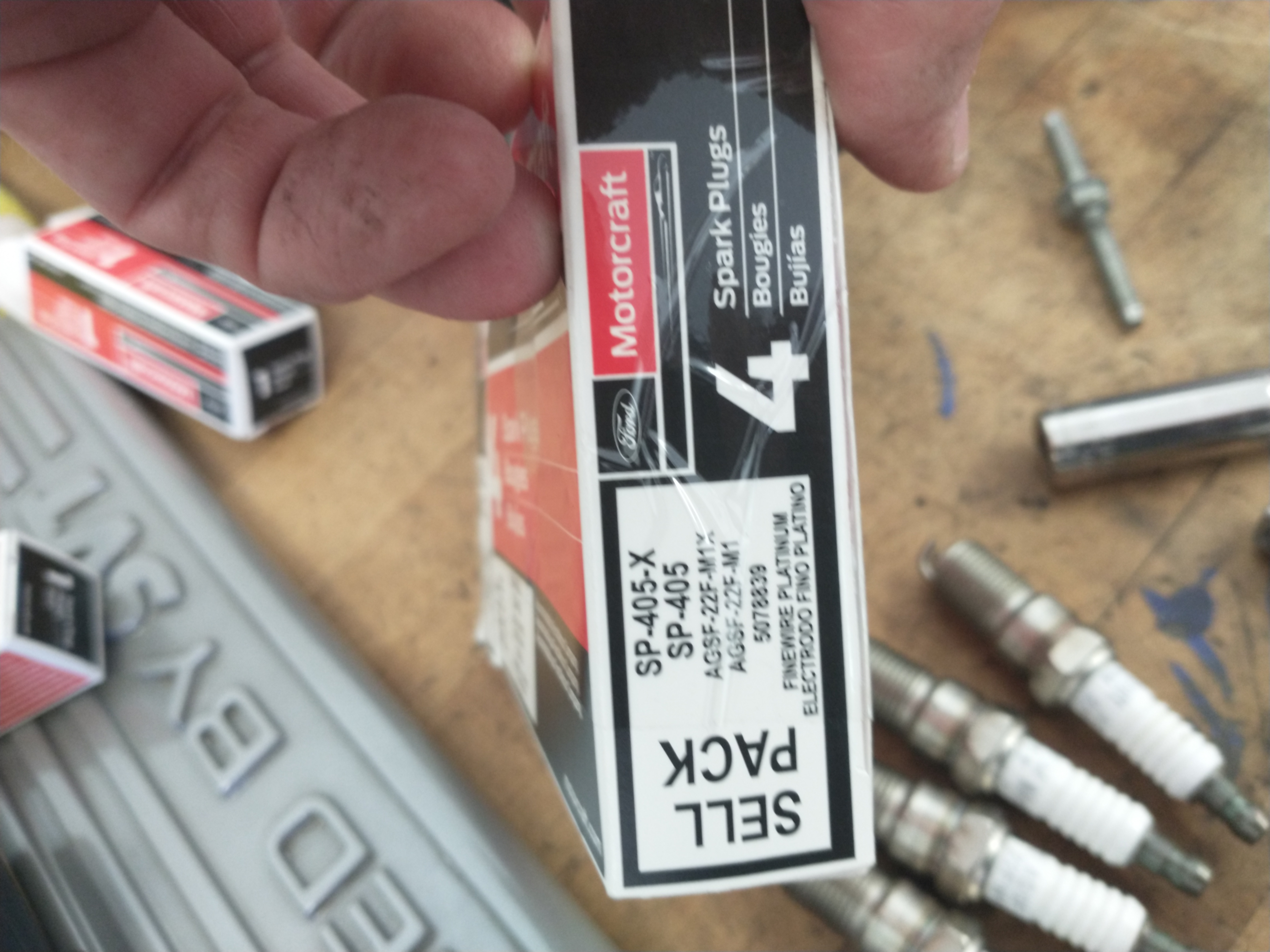

It's been a long time since I posted on this car, and that's been great. The top almost never goes up during the summer, although with the spring we had, it took a long time before the top came down. On Saturday on my way home from working on the Vette I stopped and got gas in Chardon at Sheetz and filled up the tank with 93. A few miles after that the car starting missing. Mostly under load at low RPM or under any kind of attempt at pulling hard. If it's at mid-RPM and just cruising, it seems to be functioning OK so I don't think it's a mechanical issue. I started blaming my full tank of gas on water in the fuel. I bought a can of HEET to dissipate some of the water and added a little octane booster I had because someone said that's a good idea. That didn't seem to help, so I bought another can assuming I had a LOT of water. This wasn't any notable improvement.
I sat down and watched some video of how water removers actually work. They don't magically dry up the water, more they suspend the water in the fuel so it can be used up and it eventually goes away. After seeing that I figured I'm going to have to use up some of this gas, so I drove around a bunch on Sunday morning (it was a nice morning) to use up about six gallons of gas. I topped of the gas and added one more bottle but really nothing has changed.

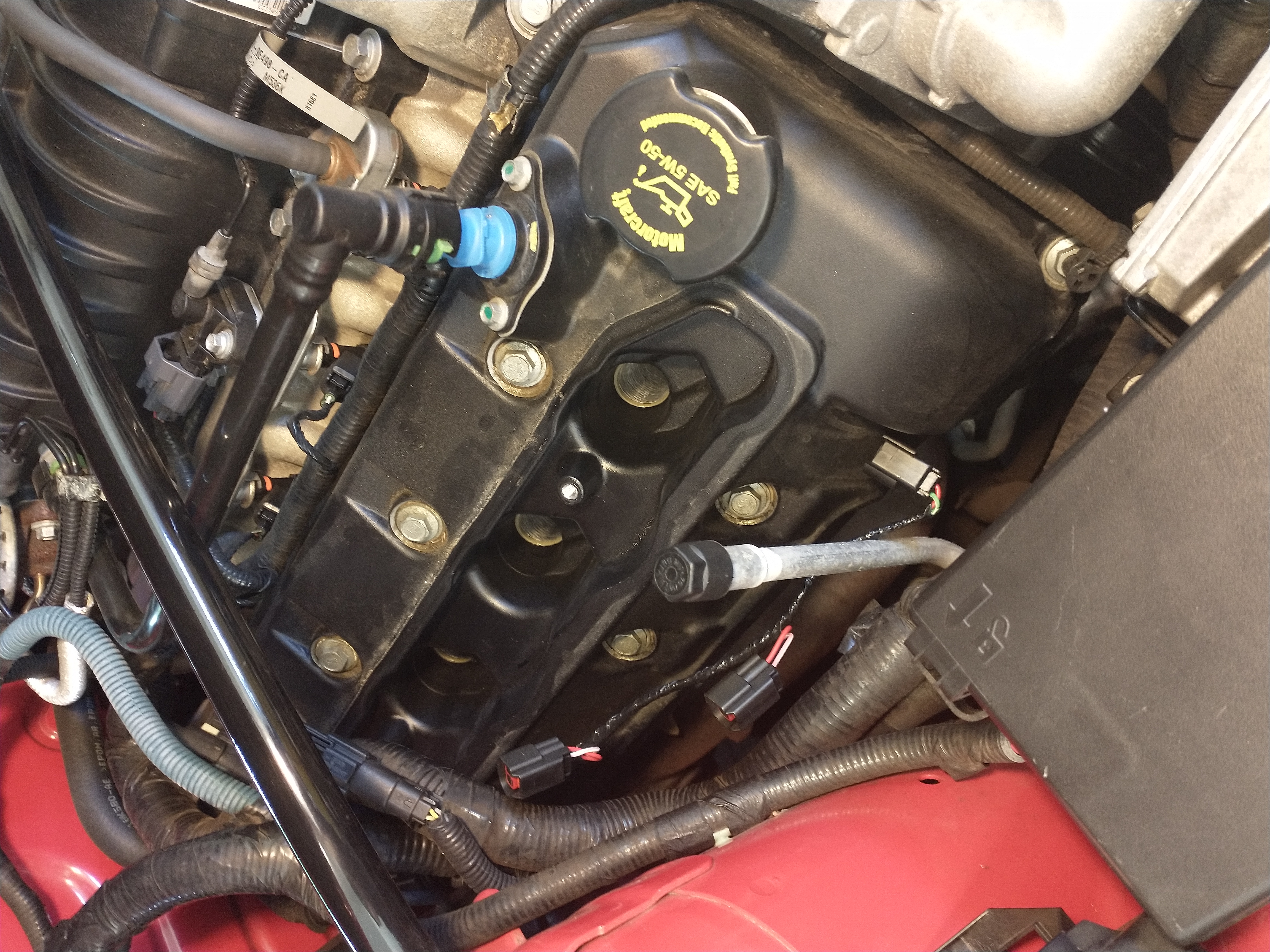

What I failed to mention is that it did finally throw a P308 code which is telling me #8 cylinder misfire. This could be caused by bad gas, but is likely an issue with ignition in that cylinder. Since the car is 16 years old, and Ford has issues with coil on plug coils and has for some time, I decided to just buy new coils and spark plugs. I figure they're old either way and it won't hurt to replace them. Those will arrive this week, but it looks like the job is not too bad on this car. Since I like the stockness of the car, I ordered Motorcraft parts. As far as I can tell, they have good reviews so far. I'll let you know...
**Ha! Two years to the date since the last post**
Posts: 3656
Less than two hours from start to finish, including the test drive and clean up and the new coils and plugs are in place. And the verdict is in: FIXED The car seems to run better than I ever remember, but some of that might just be between my ears. :lol: The new Motorcraft coils are allegedly a little better than stock, and I put the original Motorcraft plugs back in there. There was nothing glaringly obvious in relation to physical problems with any parts, so it must have just been dying a slow death in cylinder #8 and I suspect based on how good it feels, that there are others that are losing their mojo too.
