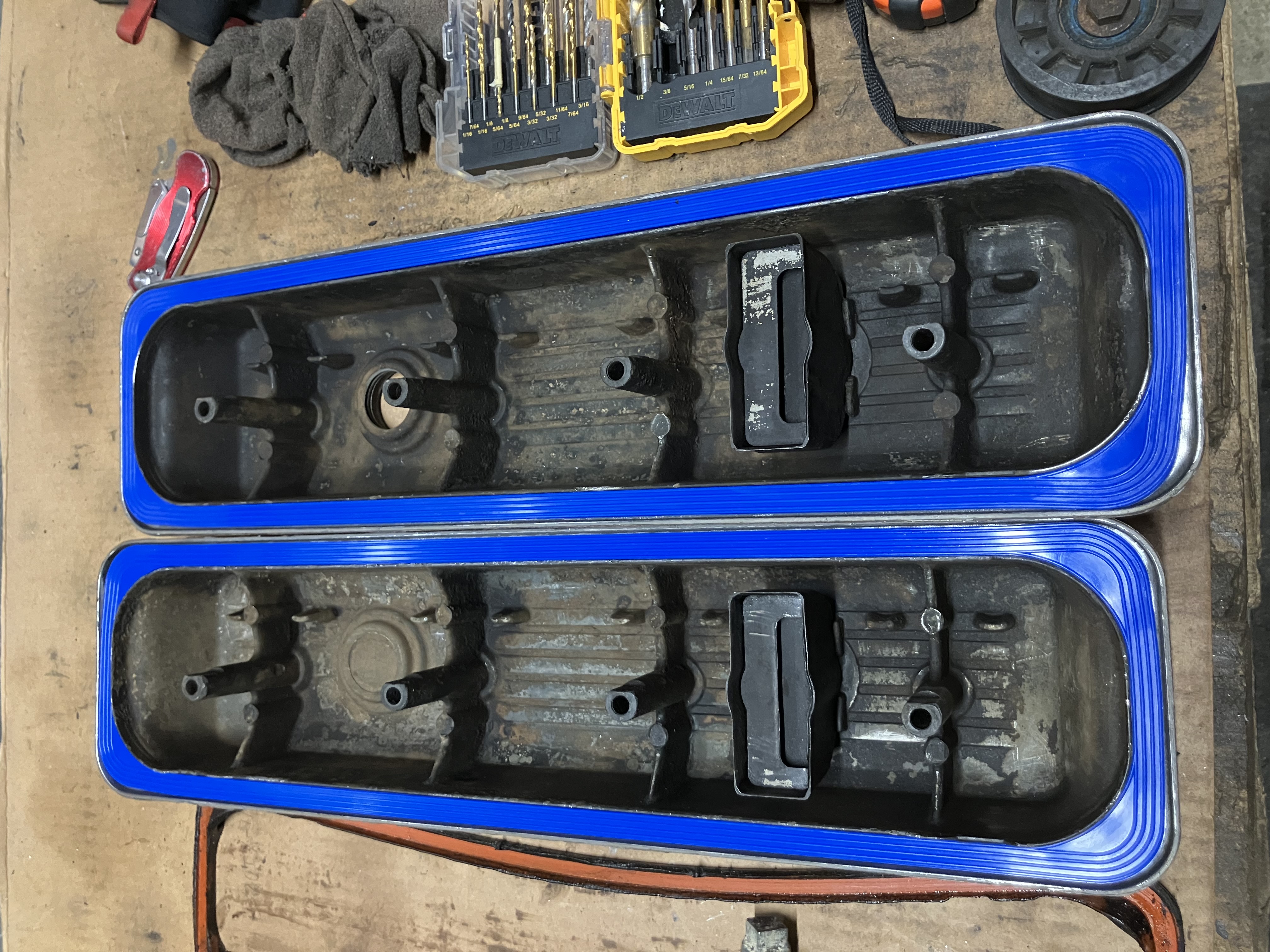

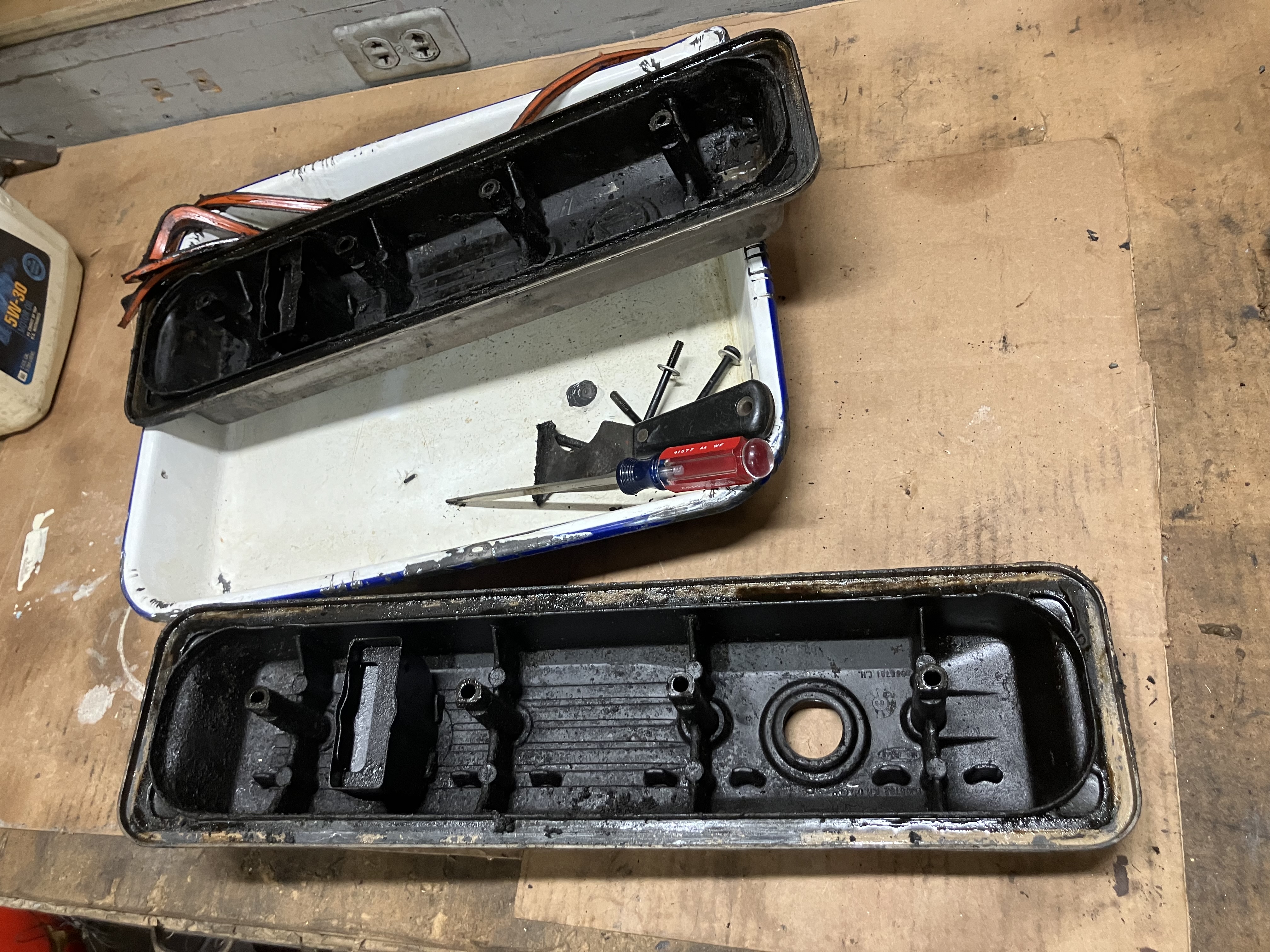

Also tackled replacing the valve cover gaskets. Getting them out was a bit of a challenge. The passenger side required removing the A/C compressor from the brackets. This uncovered the tensioner bracket was a bit loose. It also require removing a tube for EGR from exhaust to intake. After removal I spent a fair amount of time cleaning them. Also this gave us a chance to look inside the engine. It's not perfect but it is a lot cleaner inside than when we had it open to change out the intake gasket a few years back. The new gaskets looked to be about an inch too short but they stretched pretty easy and that also helped hold them to the cover during installation. I also decided that EGR tube needed to be eliminated so I fabricated some plates to cover the EGR openings in the intake and the exhaust manifold.

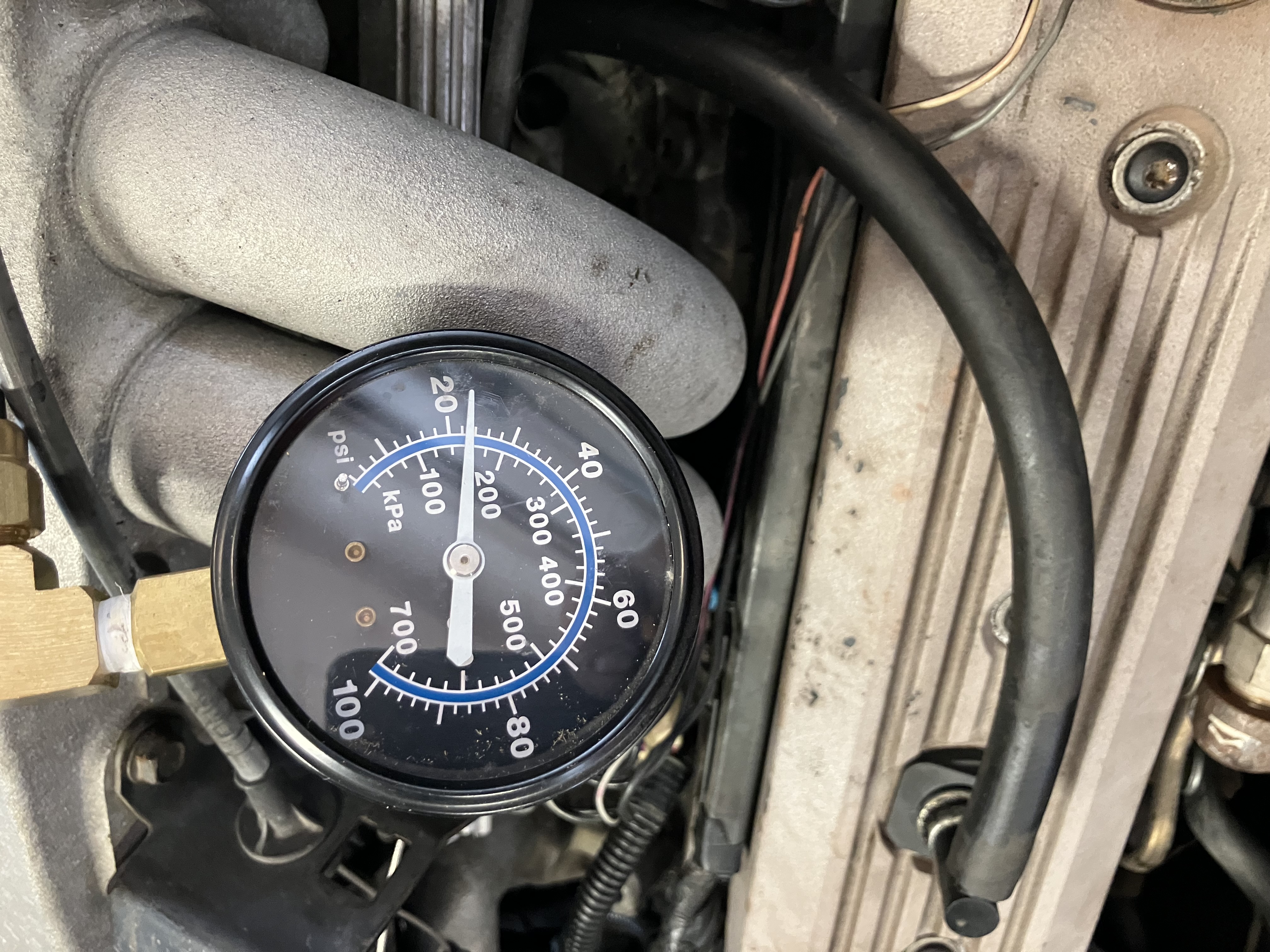

After the ignition repairs had no effect I put the fuel pressure gauge on it and found its only generating 22 PSI of pressure. With that info I ordered a fuel pressure regulator - but its not here yet. After that I tried putting some shims in there (layers of cardboard) to increase the pressure but it changed nothing. At this point I am questioning if the pump or filter is the problem. I have a couple options to try another pump - a good spare or borrow the unit from my 89. More to come...

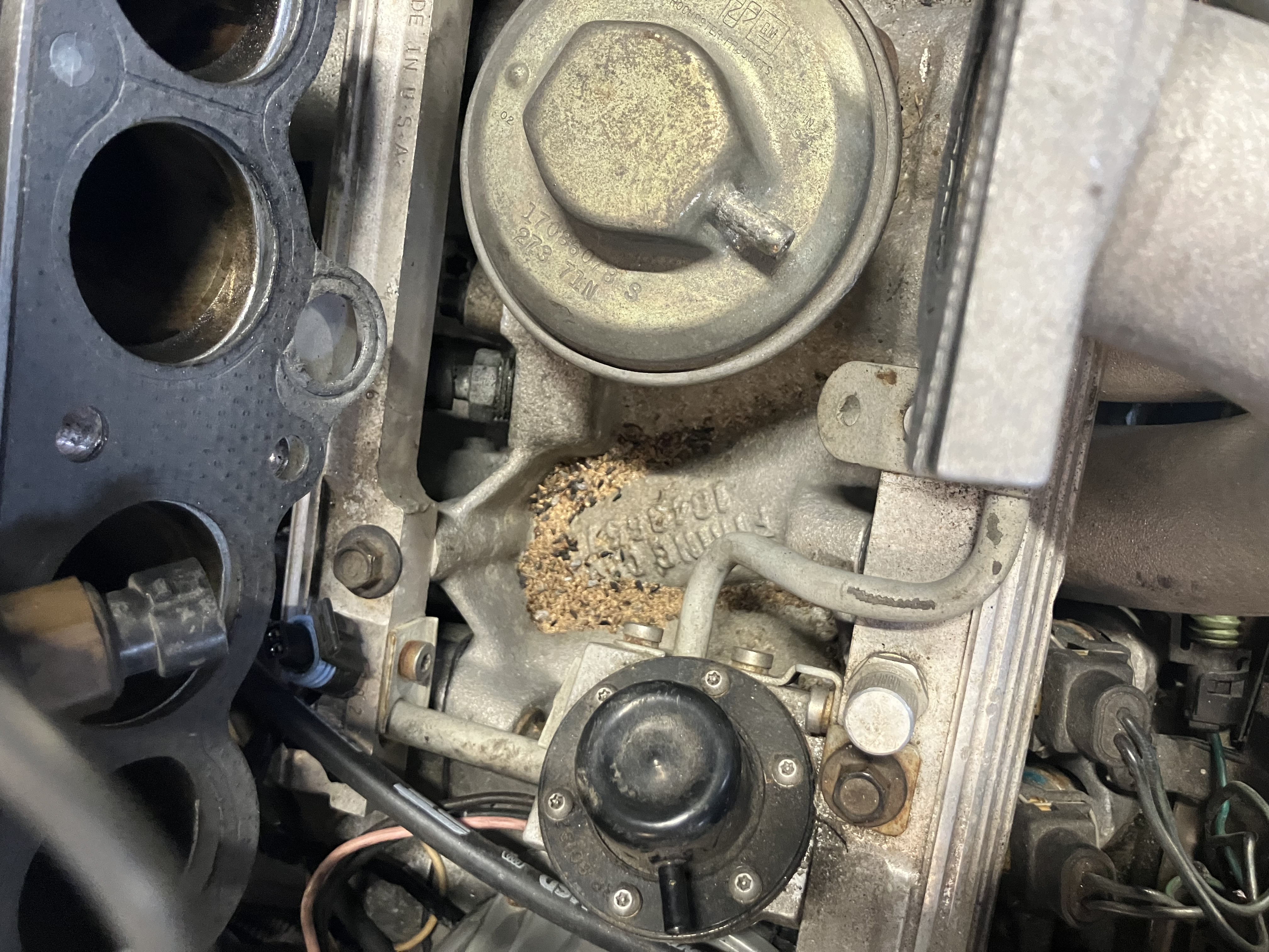

Hopefully those critters didn't get to something electrical... Might be part of the problem?
Re: 89 Corvette Mostmint #43
Possible but hickory nuts are what I found and there are none of those at Kurt's place.
I'll keep it on the list as a possible.

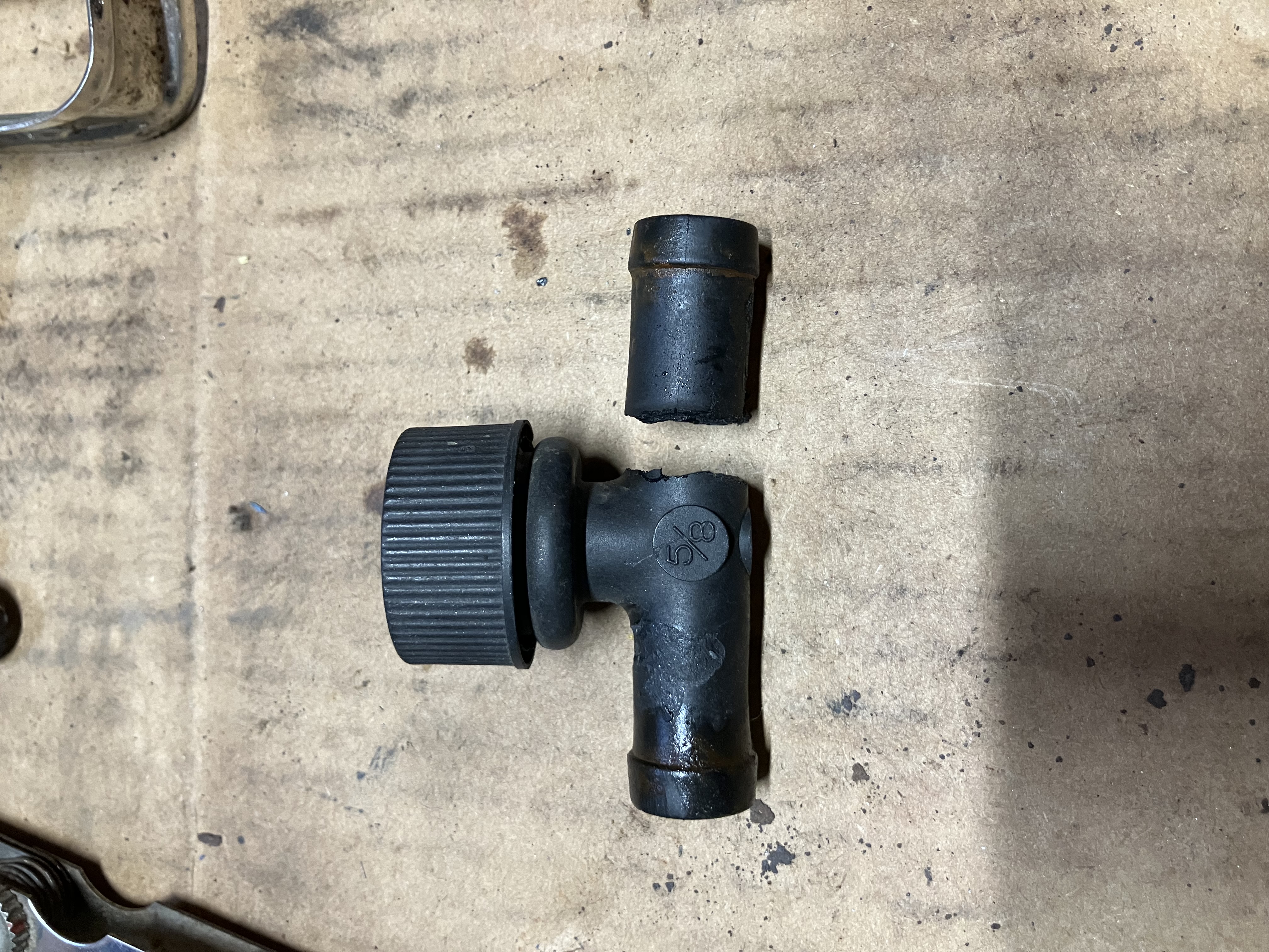

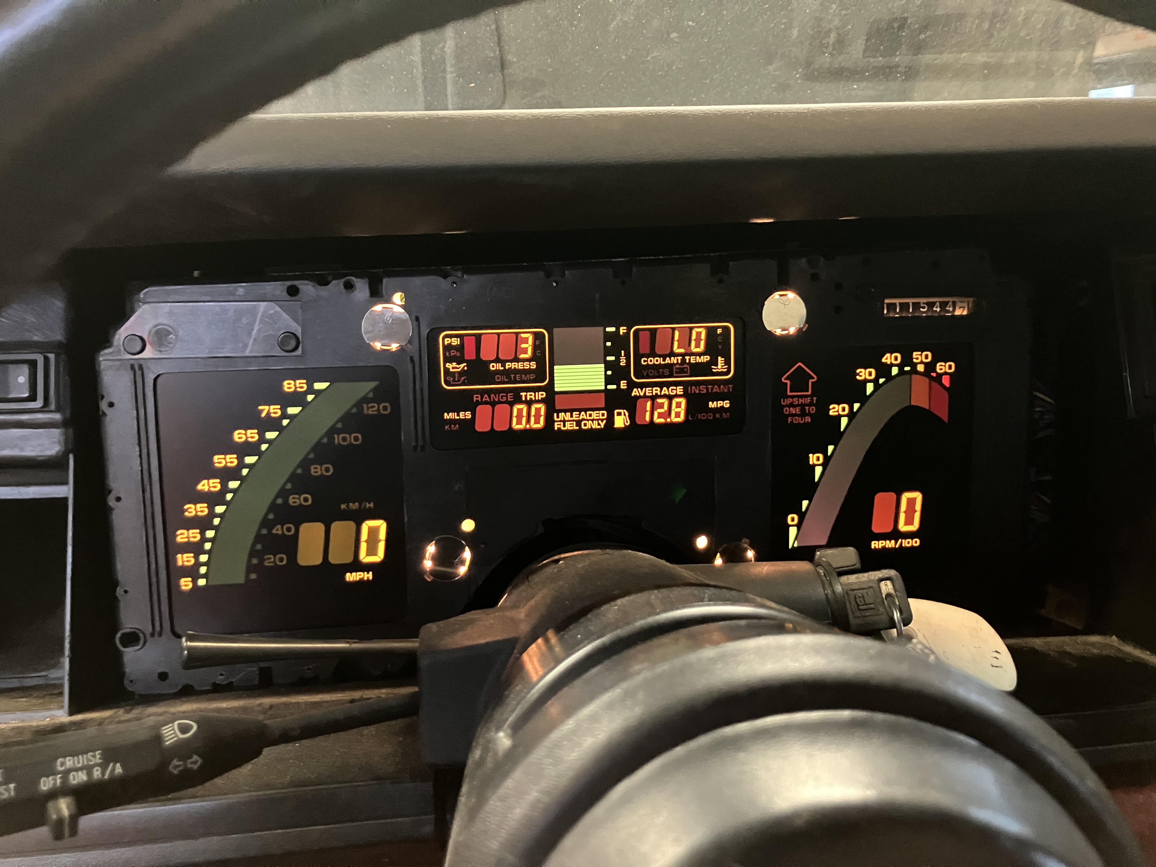

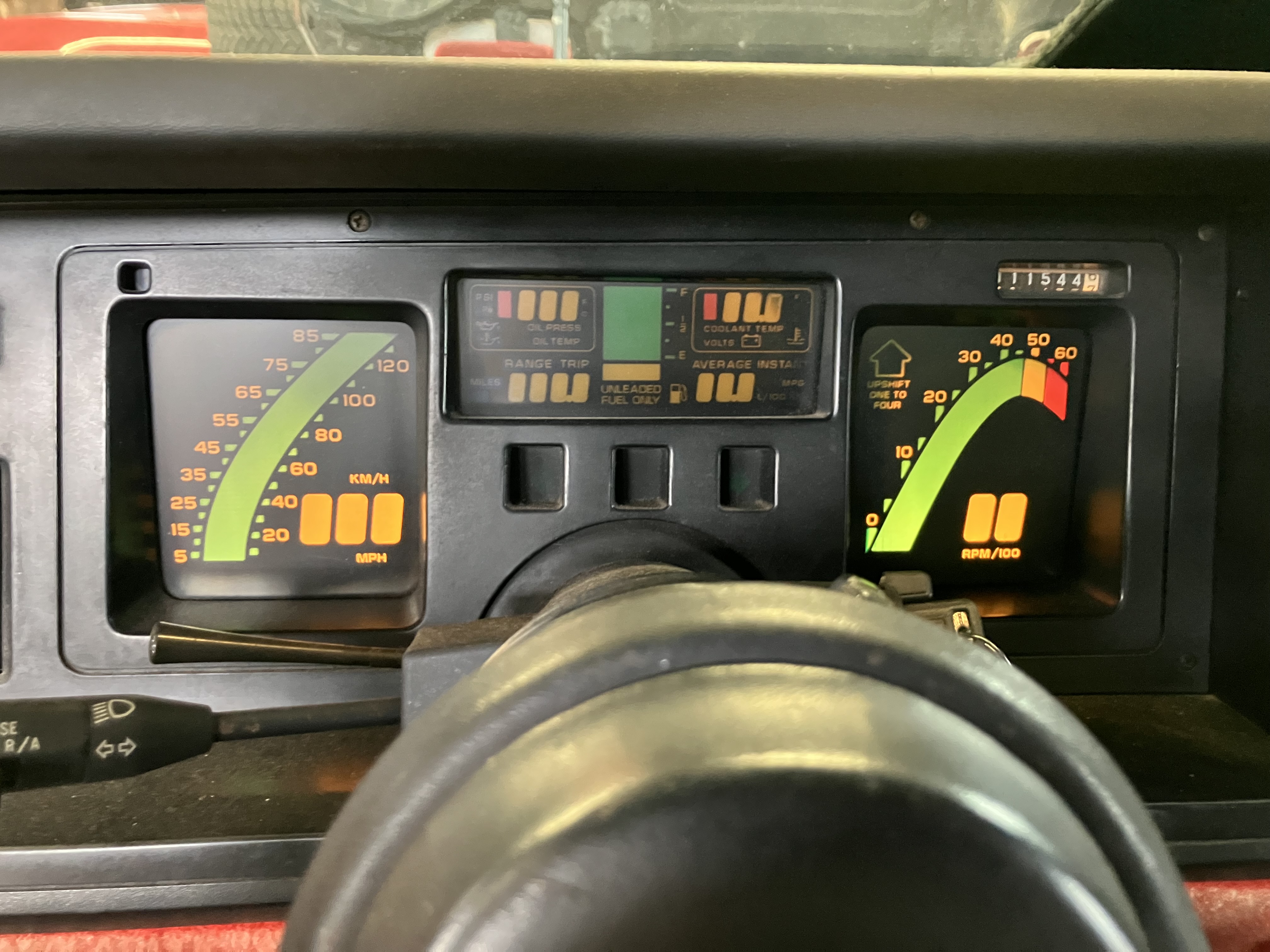

1) Fuel pressure issue is resolved. I removed the fuel pump/sending unit and found the plastic clamps on the hose connecting the pump to the sending unit to be broken. 2) Starting the car uncovered the gauge cluster not working properly. In this adventure I learned there are several issues the main being the polarized layer on the digital dash. The material just gives up which leaves every lighted part bright. I could buy all the parts but I decided to buy a rebuilt one. It's on the way. 3) This car starts but when its cold it won't idle on its own. In a minute or three depending on outside temps it will idle on its own. the main potential culprit here is the idle air controller solenoid (IAC). It could be faulty, or the wiring, or the air port it controls could be blocked.

1) The rebuilt gauge cluster finally came in and got installed. It looks good.

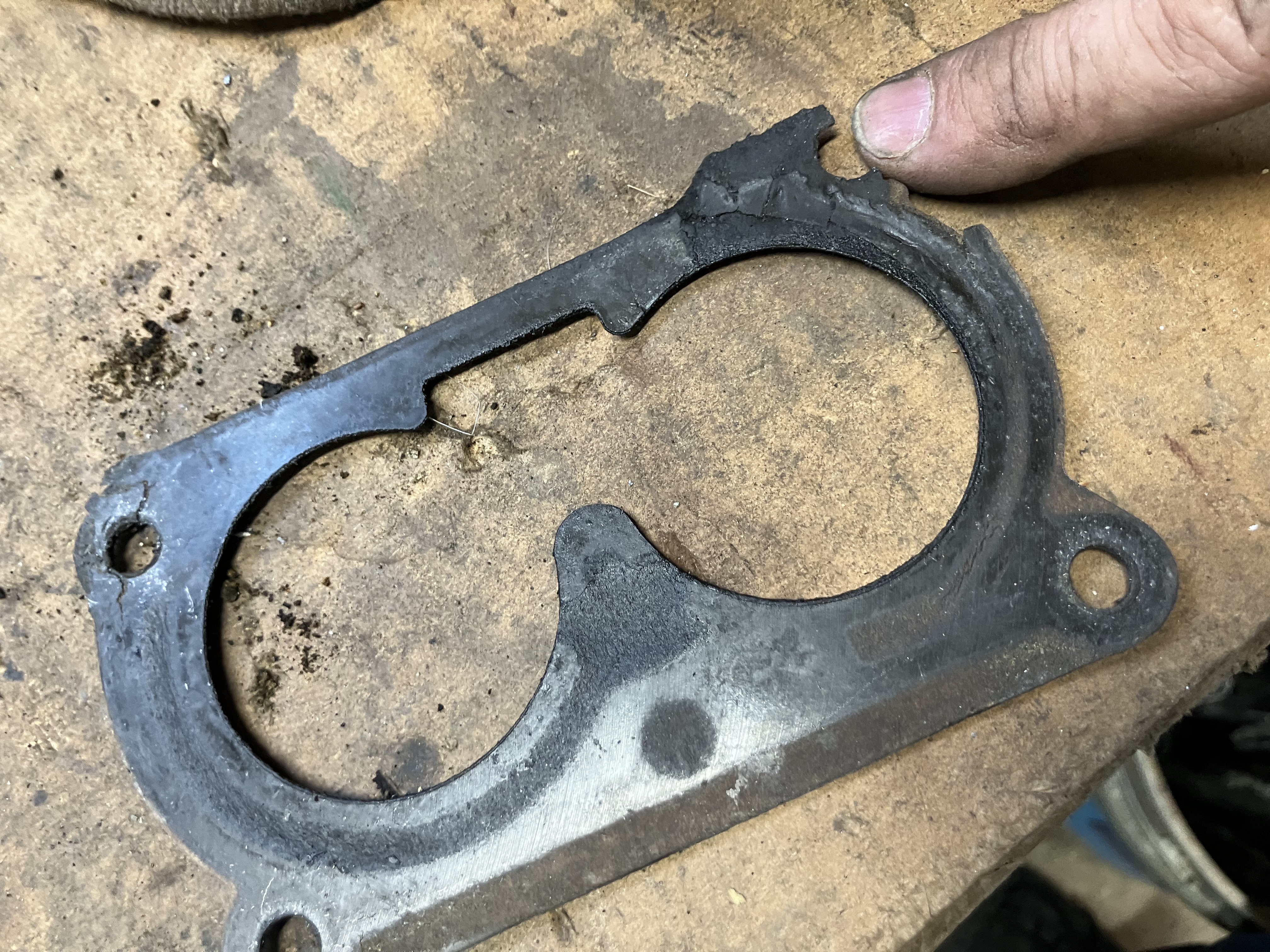

I took off the throttle body and found the gasket to be sketchy, and I cleaned it up a bit. There was some carbon build up near the blades. I also inspected the IAC including resistance tests and it was in spec. Test after reinstall found the idle to be too high. The factory manual actually says it should idle around 450 RPMs. I'm targeting 600 but it was more like 900 in gear. So I tried backing down the idle air adjustment, reducing the timing by a couple degrees to no avail. At this point I reasoned that there was some kind of vacuum leak so I pulled the throttle body again. Gasket looked good. I pulled the IAC out and found it had some type of sealer on the threads (maybe one thread width) that had long dried out and was cracking. I replaced that with Teflon. I also tightened up a vacuum line plug, the PCV line from the throttle body to valve cover, and the plate I used to cover the EGR port in the back was removed, trimmed down and new gasket installed. It looked like this plate may have been catching a little on the intake manifold or possibly the bolts were just a thread too long to hold it down all the way. Anyway all this worked. It started on its own, and when it got up to temp it was idling at 500. I used the throttle body stop to let in a little more air so it would idle at 600 in gear. Cold start now has it idling at about 1000 in park which is a little higher than I like but acceptable.

2) It seems I was way off on the idle issue.

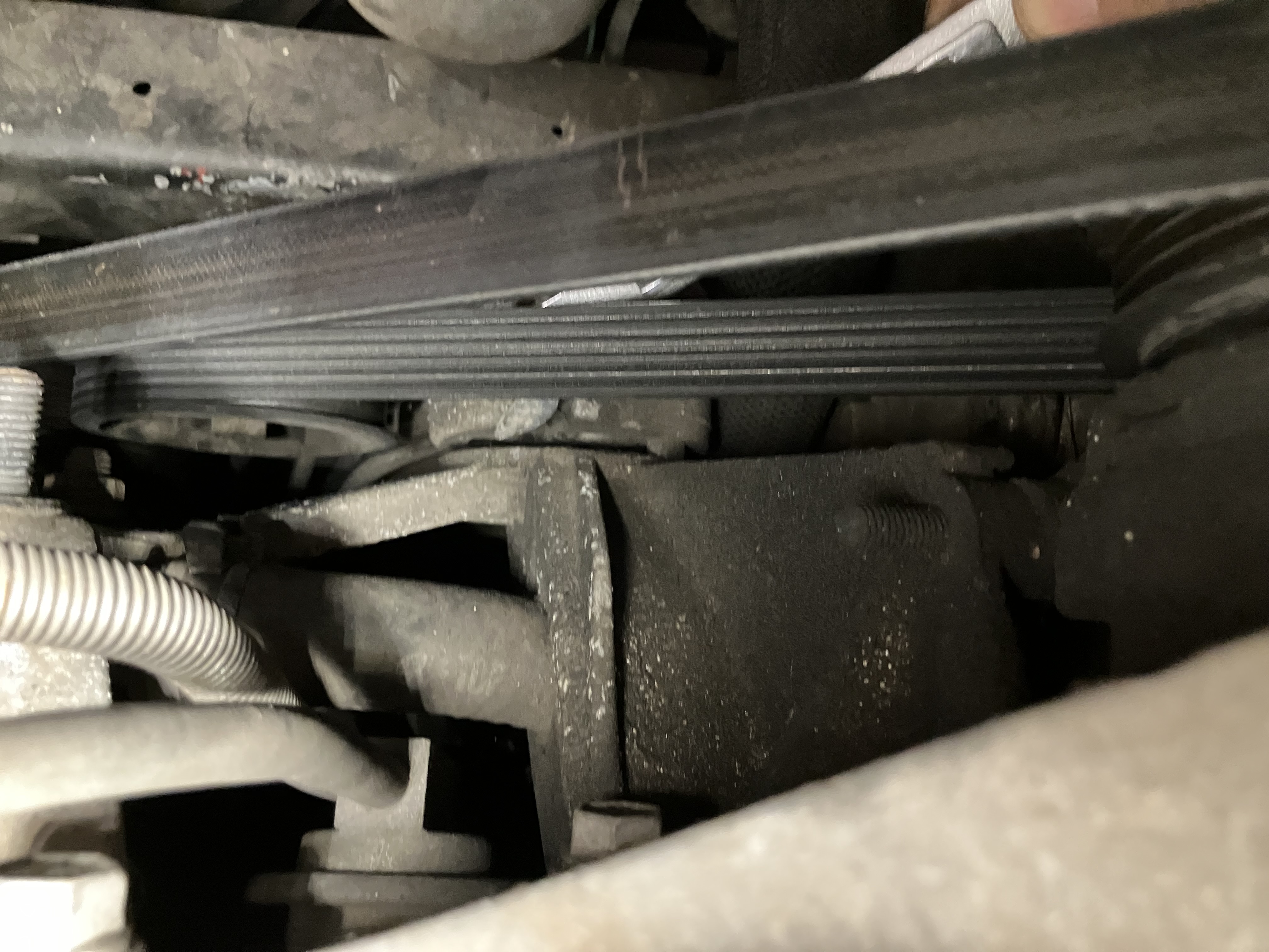

1) still has a sketchy idler for the serpentine belt. I have the air pump it might be best to turn it into an idler or possibly find a replacement pulley
