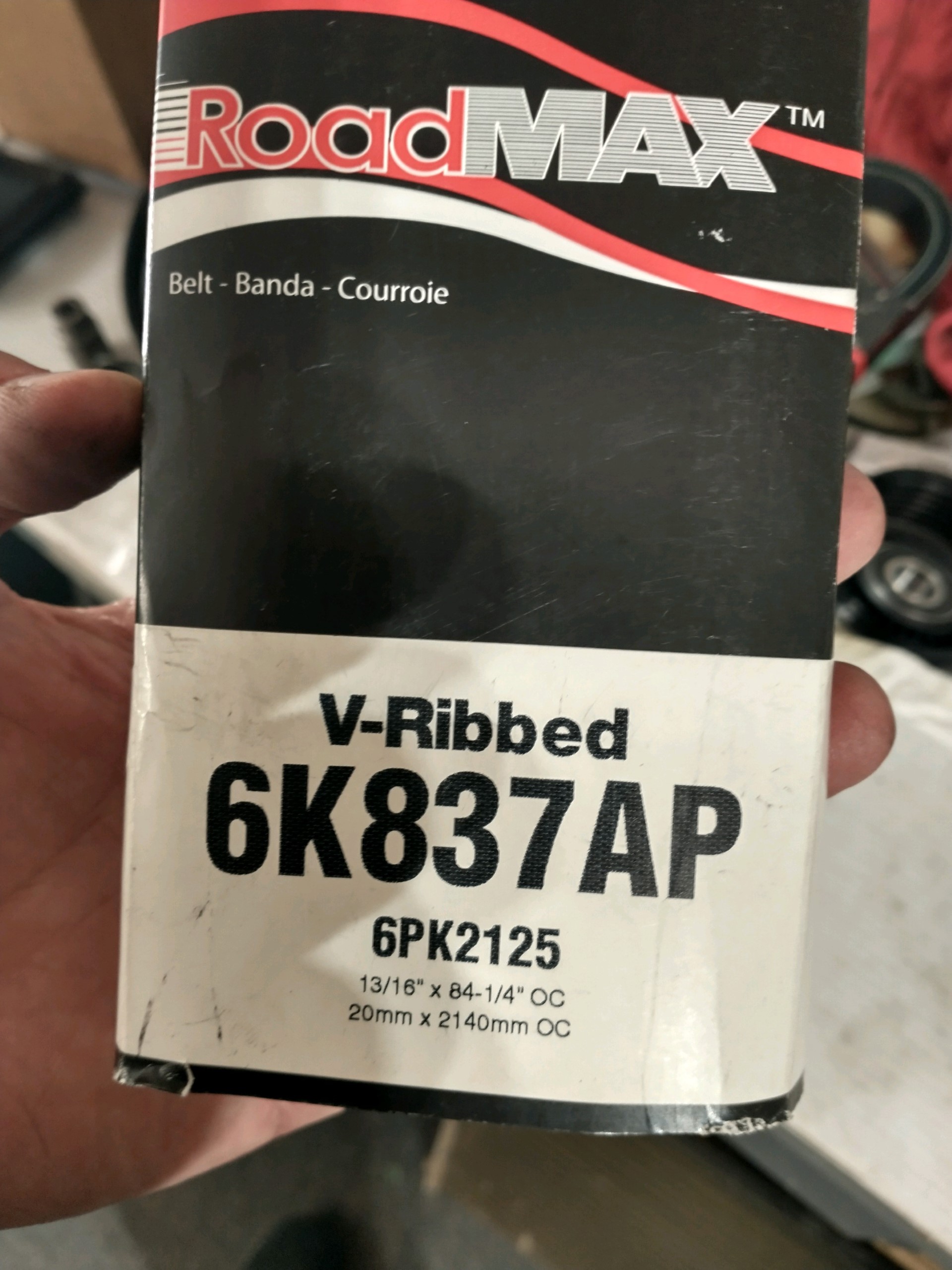

Luckily the A/C bypass conversion went swimmingly. I basically was able to bolt my steel pulley directly in place of the crappy plastic one and it lined up perfectly. We had to open up one of the two bolt holes just slightly but that was simple. Once installed, we went back to the parts store for a couple belts to try and got it on the first try. So this part of the project is complete. Unfortunately while we were warming up the car and checking things over, we sprung a leak. A big oil leak that seems to be coming from the oil pressure sending unit at the back of the manifold. There was a puddle of oil under the car after about five minutes of run time that was at least 15" in diameter, so something there is amiss. We'll have to pull the distributor to get to it, but since I forgot dad doesn't have a timing light, we still have to time it anyway, so hopefully that all goes smoothly. We'll pull that apart on Saturday to investigate.
