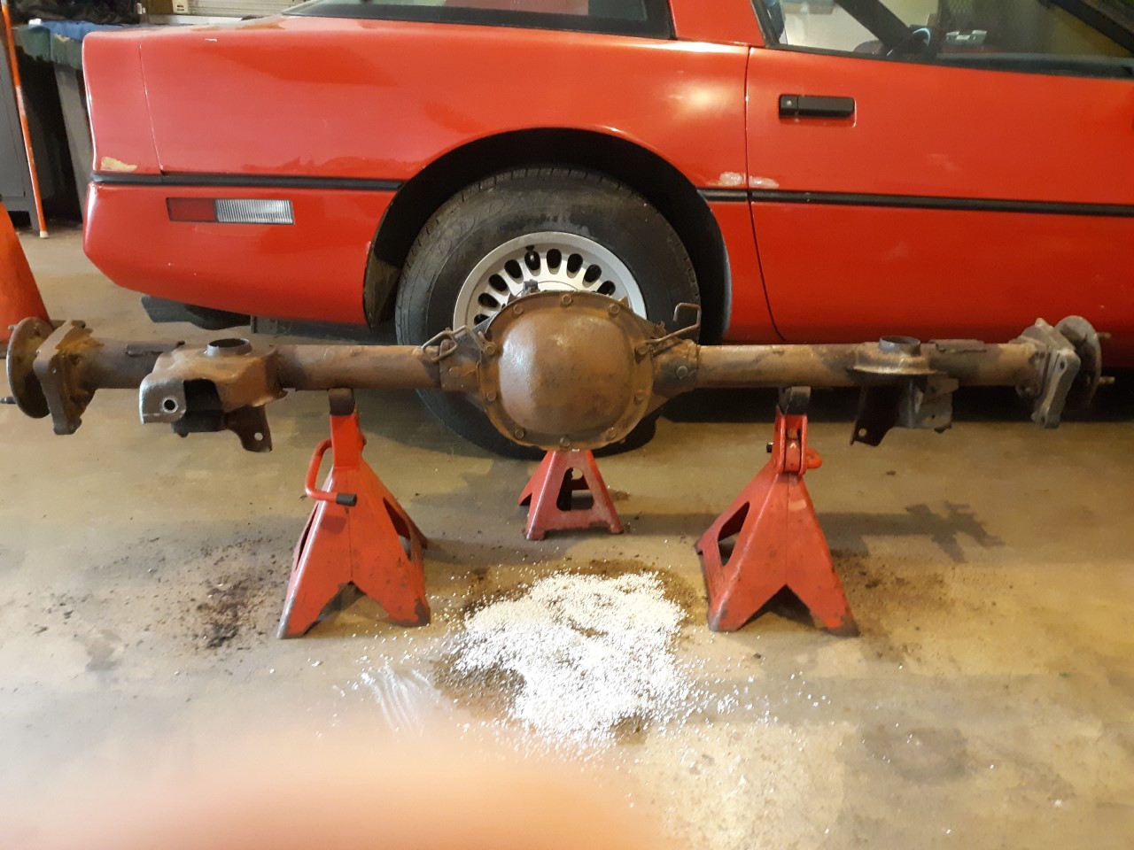

The 32v Garage was a very busy place Thursday afternoon.
BP arrived shortly after lunch, the plan was to swap out the 3.90
for the 3.73 rear-end that we acquired a short time ago.
I told him I'd help until 4pm, then I would leave on a dinner date
with his Mom. He was the under-the-car guy, at 4pm we had the
3.90 out and the 3.73 was barely hanging on it's shock.
When we arrived home after dinner at the Brown Barn,
I found BP putting the tires on, so I got to go along on the
successful test drive.
3.90 on the floor next to the Vette.

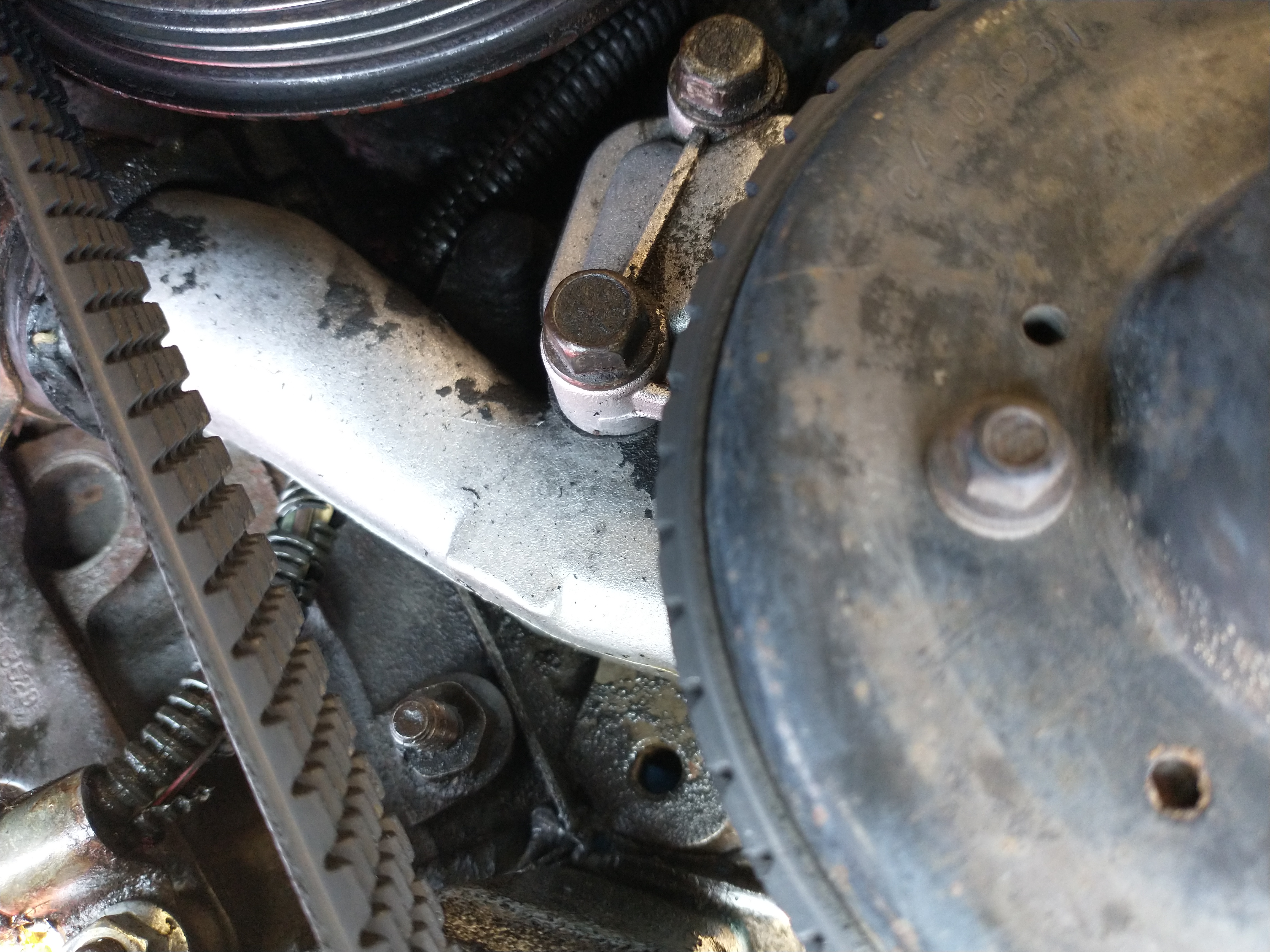

The welds survived track day, but I haven't checked them since the drags. That will happen in our next work session. But there was still the annoying oil leak that happens whenever the car is getting abused, but during normal driving stays dry. Turns out the culprit was a missing bolt in the block just above the water pump. I'm not sure what was supposed to be there originally though. A quick dig through an old coffee bin and the hole is plugged.

That is a weird thing. Obviously it was not in the regular oil drainback path and the only time it leaked is when vacuum and is low and PCV is not pulling. Hope that fixes it!

I think it's actually oil splash from something rotating at high speed, along with the low vacuum situation. But at least I won't smell the oil either.
