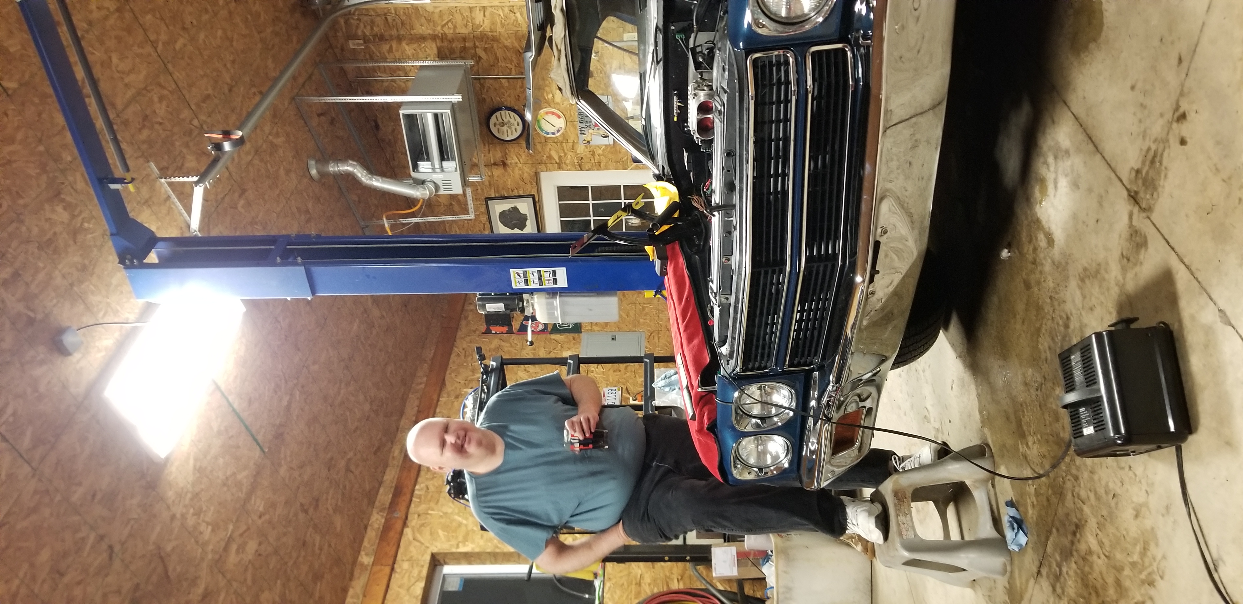

The good news is WE GOT IT FIRED IN THE CAR TODAY!!! And it sounds GOOD.
So Paul arrived around 930, and I had done a lot of prep on Friday night. Tony ran into an issue with work, so he was going to be much later than the usual. Paul and I hustled the 383 out pretty quick. I had bought a new Edge torque converter in the fall, but never got it put in. It was for the ZZ383, not this, but we'll see how it works. We got the 408 set in with the bellhousing and converter bolted up by lunch time. It took a little goofing around to get it in, but we handled it like pros.
Tony showed up just in time for the Guidos order to be placed, and now it was time to relax and little. Me and Paul ate, and then we'd just get things re-assembled. While we were eating, we had a surprise appearance by Dave Speece and him and Tony started picking away at reassembly while we ate and BS'd. By 230, Paul was ready to call it day. Dave, Tony, and I soldiered for 2nd shift, and despite a few initial difficulties, got it fired up and running! We got it fully hot, I was able to let the Auto-Tune do some work to make it run better. It's hard to get it started, but once running, it sounds pretty strong.
Dave and Tony stuck around long enough that we got the hood back on the car! The swap is DONE, and all that is left is a bunch of tuning.
Will it run the elusive 11.9x? Will it trap at 110+? Will it munch my 700r4?
