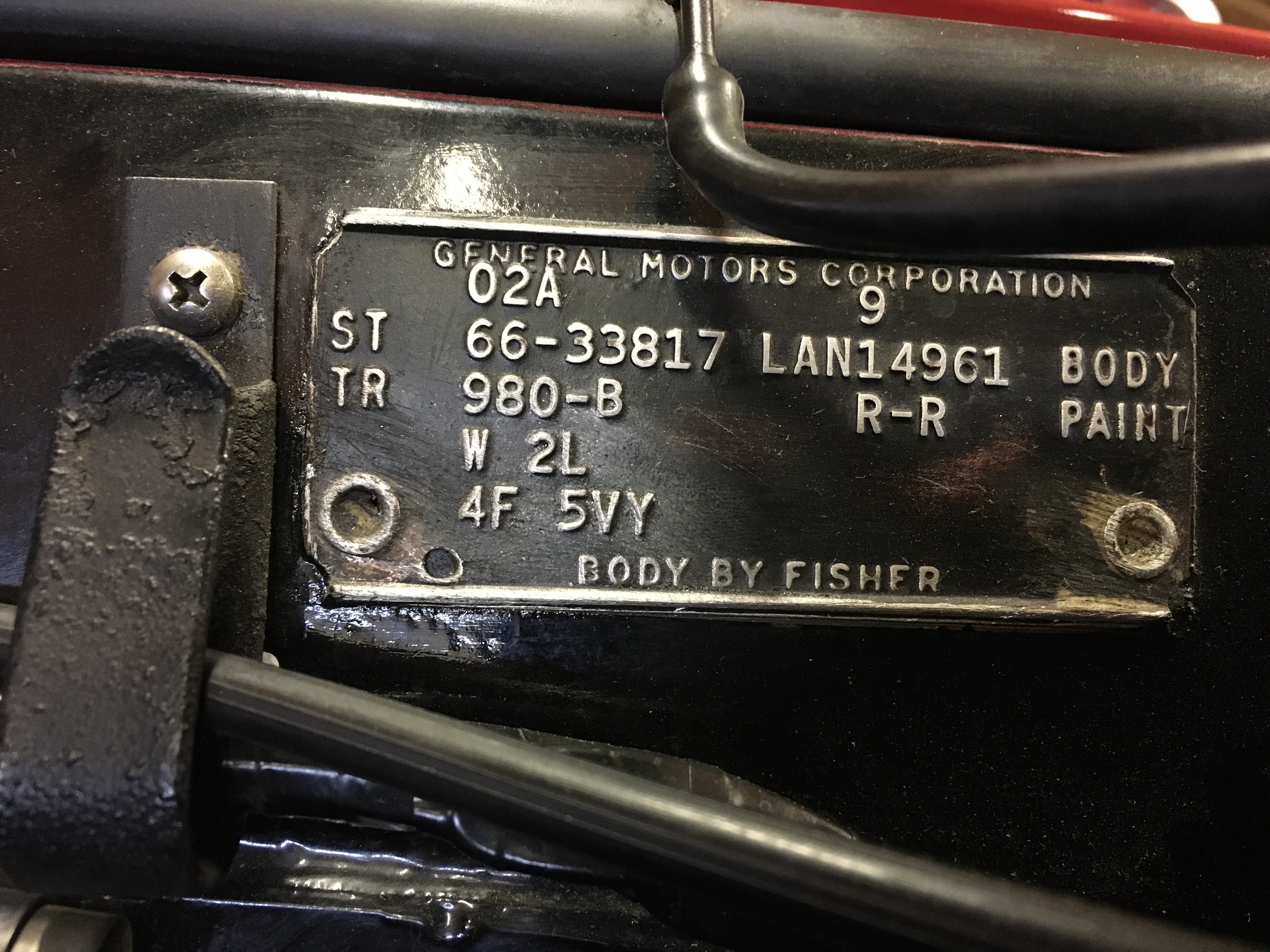

1966 OLDS 442 -- Decoding Body Tag
I decided that it might be important to see how true to build my 442 is. I've started researching
body codes & the vin # to see if it really is what I think it is. Using the below website I decoded my
body tag.
http://www.oldsmobility.com/oldsmo/view ... ?f=12&t=18
Time built: 02A -- 2nd Week of Feb
Year built: 66 Body style: 33817 -- Cutlass Holiday Coupe LAN - Lansing Built
Trim: 980-B Black Vinyl Bucket Seat Interior Paint: R-R -- Spanish Red ( top & bottom )
W = Soft ray tinted front windshield only 2L = Cut out 4 speed
4F = Outside remote control mirror 5 V=442 side trim Y=Deluxe seat belts
Some interesting stuff:
1) My car has bucket seats in it, not the bench. According to the chart in the link on this post, 980 is a bench
seat code, but I've seen multiple pics and sites that discredit this. 980 is bucket, 970 is bench.
2) There's a plastic plug in the driver's door where the remote mirror control used to go. (I'm going to start
looking for the remote mirror)
3) I've never found the build sheet, so I don't know what radio option it had -- I'm assuming because there's
an antenna on the fender that it came with a radio.
4) The rear axle ratio "TG" code is stamped into the axle. 3.90 no-posi ( parts on shelf - replaced w/ 3.36 posi )
I'm going to add motor numbers & trans numbers to my thread as I get the pics.
