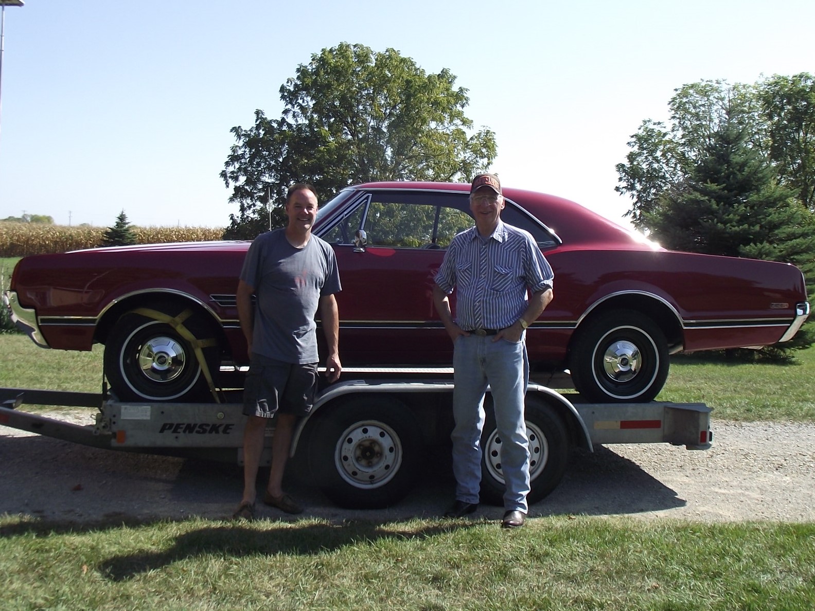

What a fun day today was. 600 miles later.
It's been a very long day, GMJohn drove the whole way.
His fun with this has just begun, stay tuned.

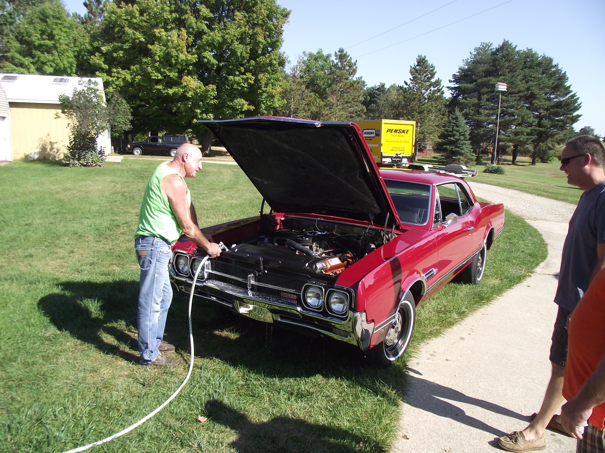

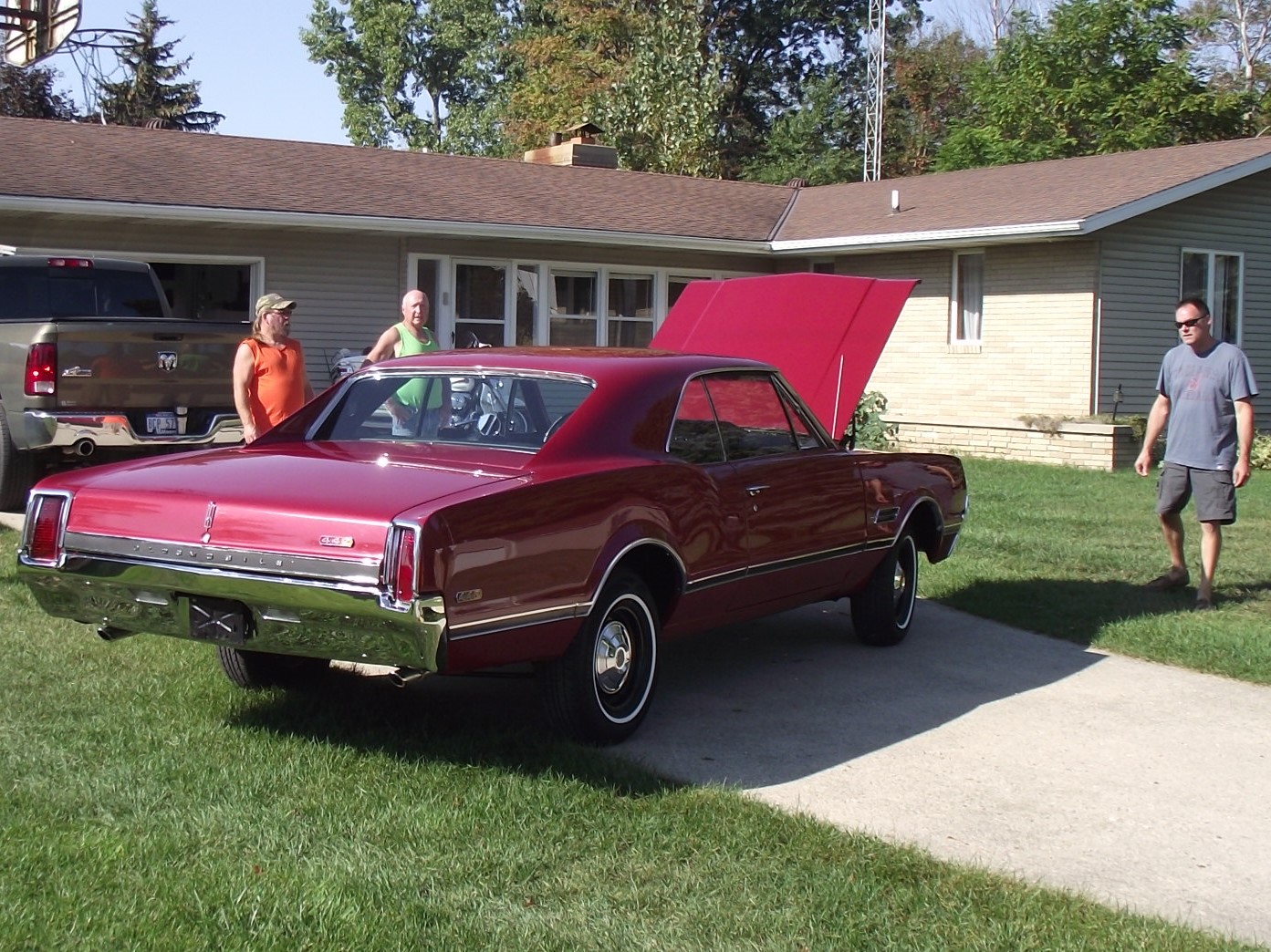

Ok... So here's how the deal went. We took off on Sunday for Vassar, Mi., a 300 mile drive. We left at
6:00 am and arrived at 10:30. We looked over the car and were very pleased with what we saw. Since I
had pre-determined the price with the owner, all that was left to do was to take it for a test run. The
owner Dan, was at the wheel showing me that it was driving as it should. Everything was going well until
the car suddenly overheated and started dumping radiator fluid all over the place and steaming. To make
a really long story short, the thermostat failed during the test drive. Unwilling to purchase a car that was
overheating, I decided to suggest removing the thermostat to prove that it wouldn't overheat with it out.
We re-assembled the water neck without the thermostat in place and test drove the car again. All went
as planned and the deal was done. Another 4.5 hours later we were home. It was a loooonnnggg day, but
well worth it! The car is not a $60,000 museum piece car. It's a REALLY REALLY REALLY clean 1966 Olds
442 with Tri-Power and a 4 speed. Manual steering and drum brakes round out the strippo package. Of course
I have plenty of things that I want to do to it to make it more of what I want, but it's a great start. First things
to do are to change radiator fluid and thermostat. Then oil change and filter to make sure that I have good
fresh fluids on day one. The engine was just rebuilt, so we will be taking it easy on it for a thousand miles or
so. More to come!!

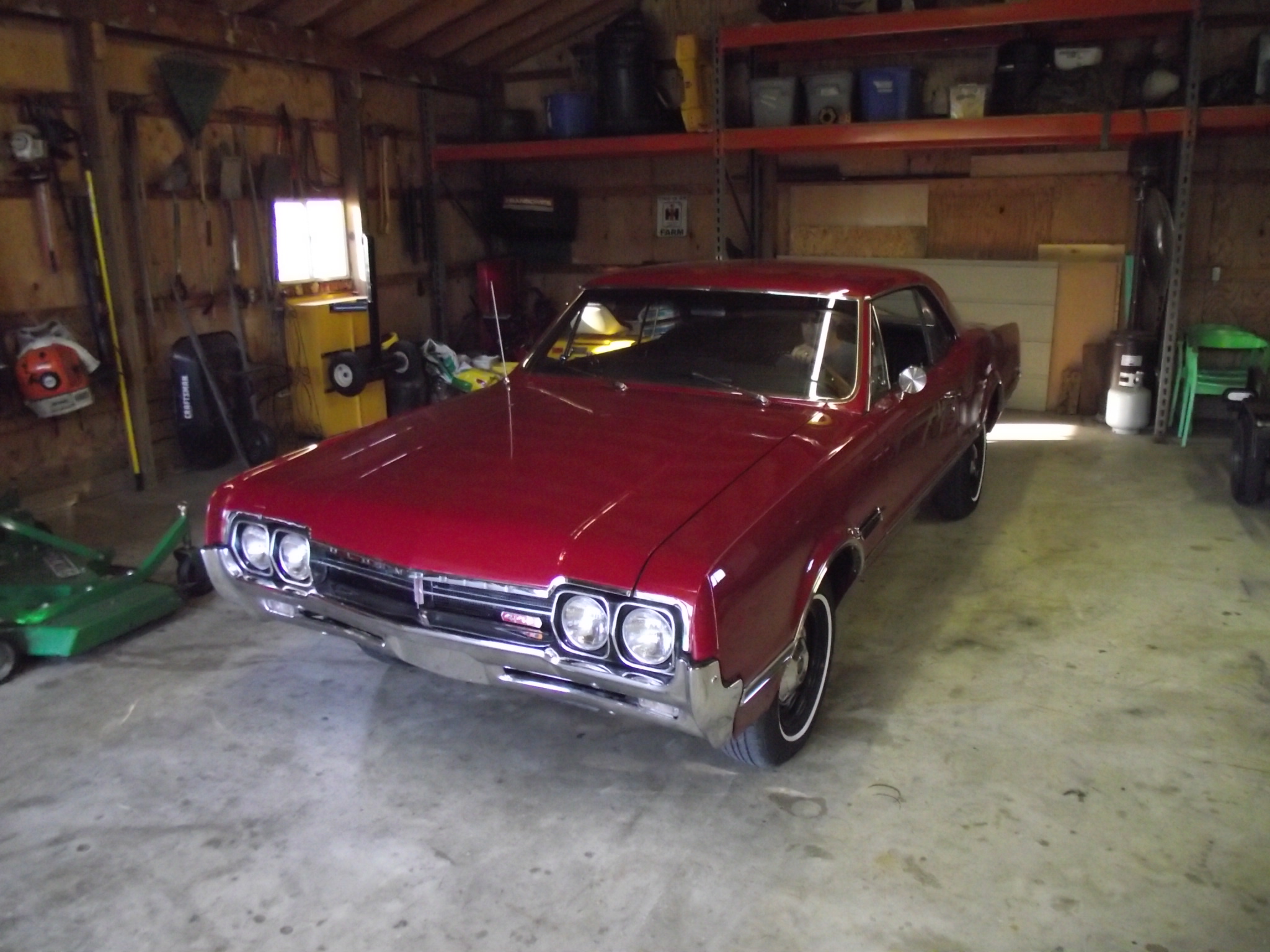

Tonight I changed the radiator coolant and put in a 180* thermostat. The coolant that came out was
like new, but I changed it anyway so the mixture would be 50/50 not whatever was there after we added
a gallon of water. While is was in there, I adjusted the choke rod so the car would start correctly. When
we first started it, I'm convinced that the choke was not working. It was tough to keep the car running
without holding down the throttle a bit. As it turns out, the choke linkage was not bent properly and was
not clearing the intake manifold, so it stuck open. After my slight modification, the car started right up
and the high idle at cold speed worked perfectly. Once the car got to 180*, the car went to idle. PERFECT!
Tomorrow I go do the title work, complete the license plate transfer and sign for the Hagerty insurance.
If I feel ambitious, I'll change the oil and lube the chassis so I know it's done right.
