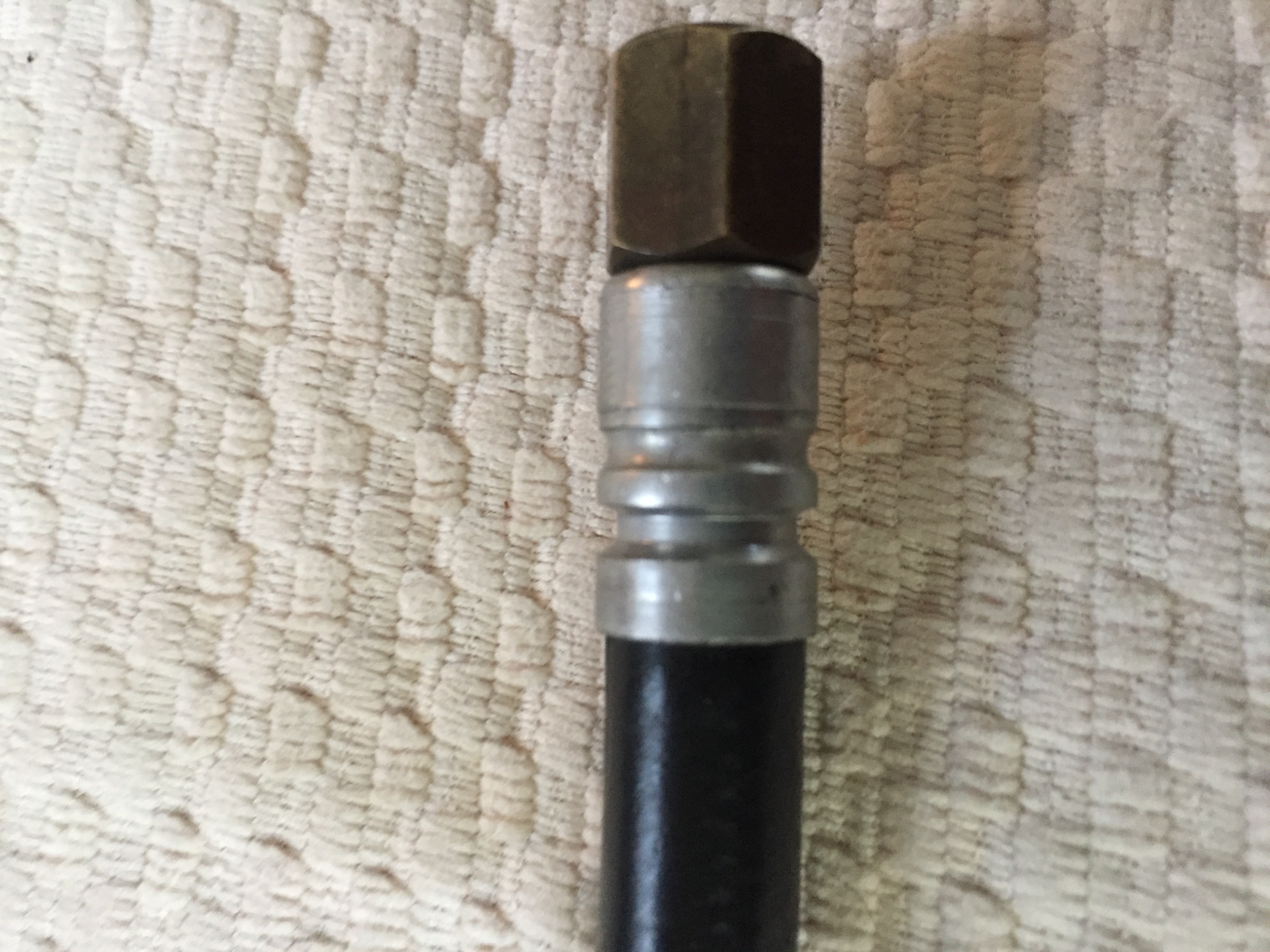

So continuing with project Under Pressure I Sussex out and ordered fuel injector lines from Hilborn because I was excited about firing this up! I previously told myself I was going to figure out how to do this so I don't have to overpay so much for the lines! Well in my ignorance I ordered the wrong lines (my injector has straight nozzles and normally they are 90 degrees which uses a much shorter hose...you see where this is going right? So I said F-it I AM gonna figure out how to go this...CHEAP!!!!!!!
Second pic shows a comparison of a 'factory' roll crimp and my reproduction..ahh I mean Hillbilly reproduction!!!! And finally of course my modified hillbilly tool used to duplicate it. And yes I went a little too deep I will add a jam nut to prevent that on the real lines/ this was just practice.
