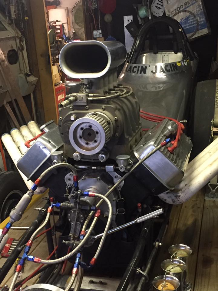

I was forced into it
Still lots more to do.

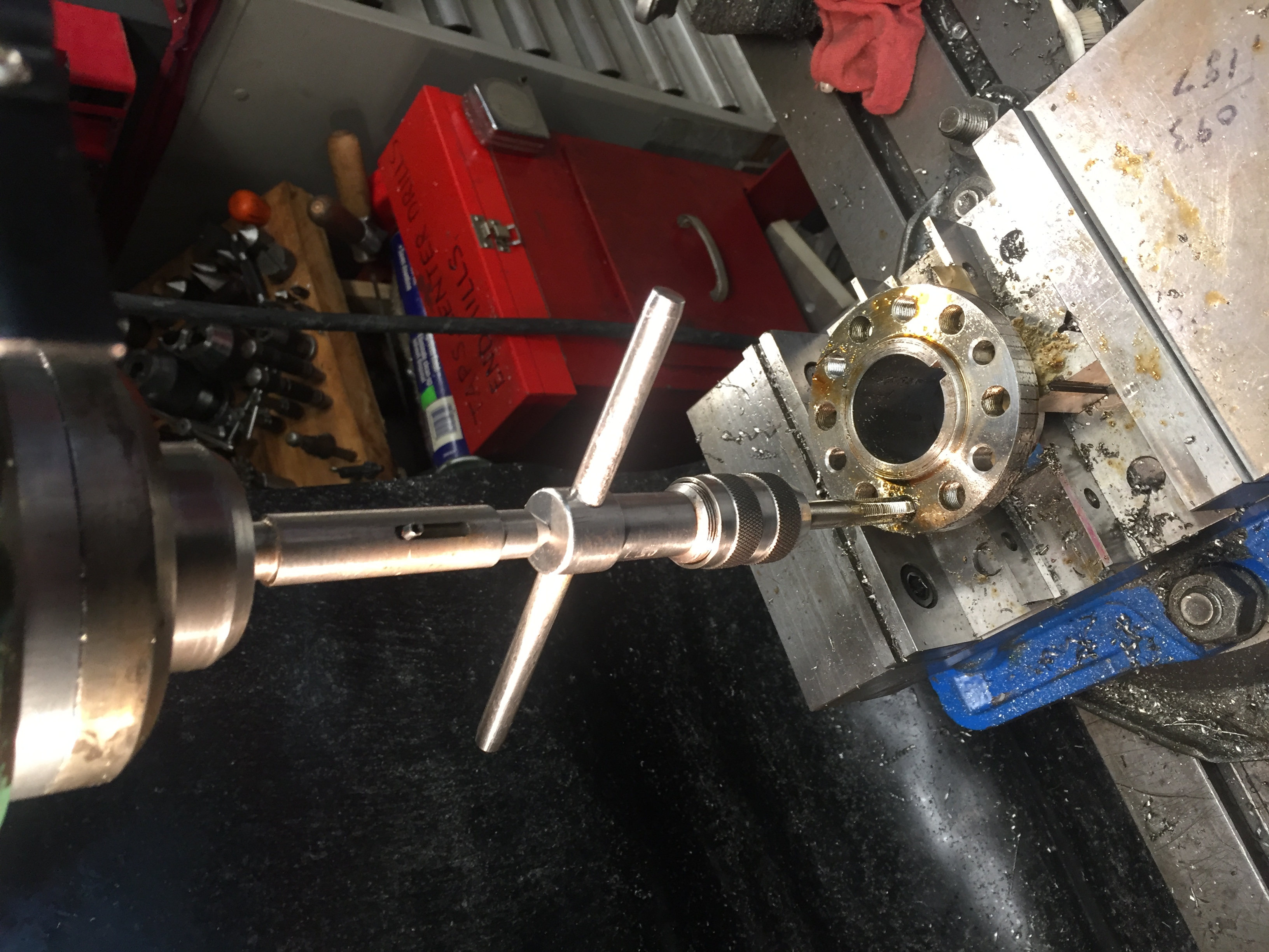

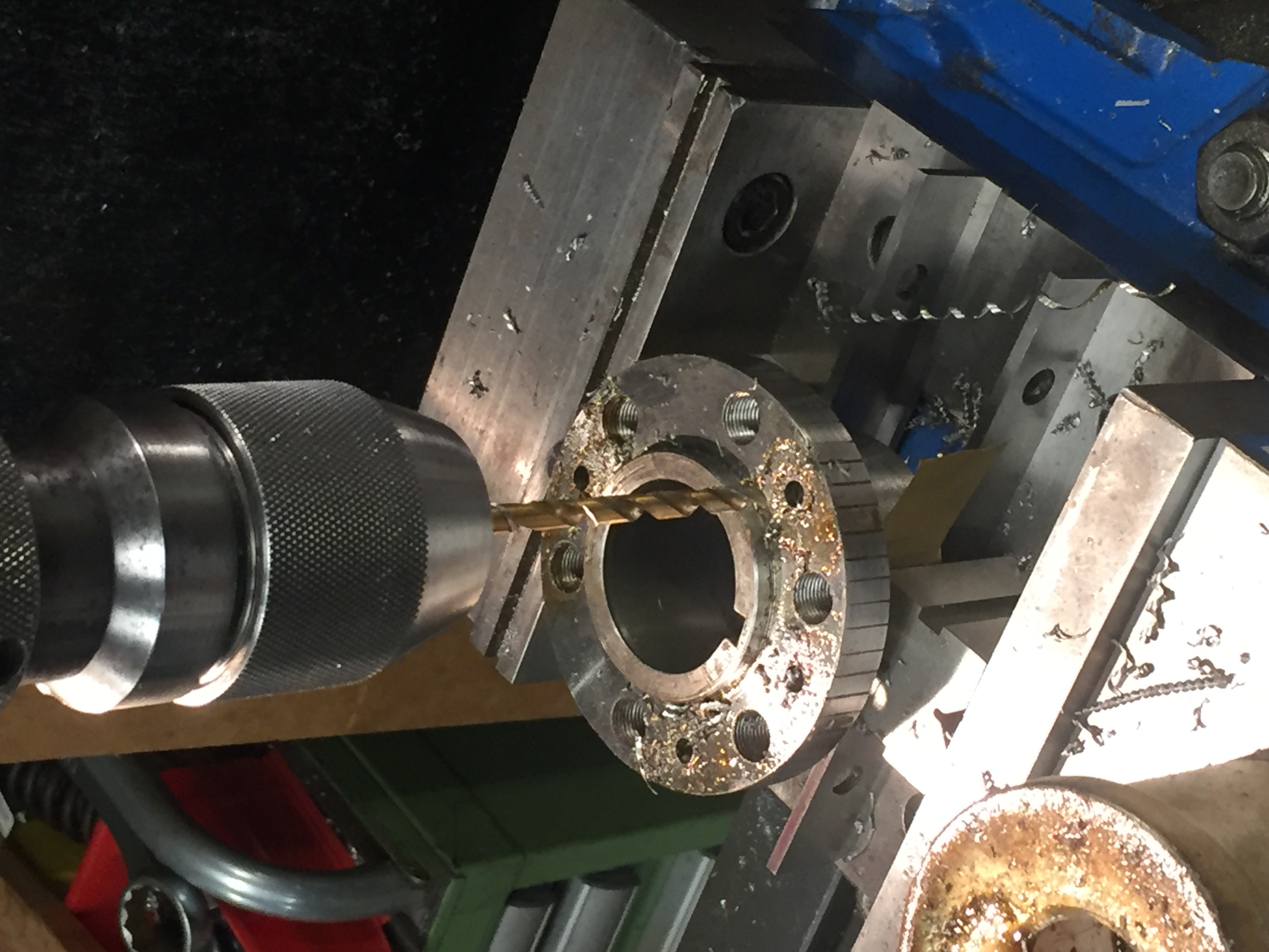

So in continuing with Project Under Pressure and embracing my Cheap Bastage roots I found myself needing to salvage this blower hub. Not sure exactly where I got it - it appeared gently used, but further inspection revealed several issues. First it had an oversized pilot which was easily remedied, Next I noticed that the face that mated against the crank gear was running out .015 or .020 thou - what the hell? So I trued that up. Next it had been drilled for helicoils - I know those are strong - I just didn't want those so I opted to redrill the hole pattern. It's start in' to look useable again!
