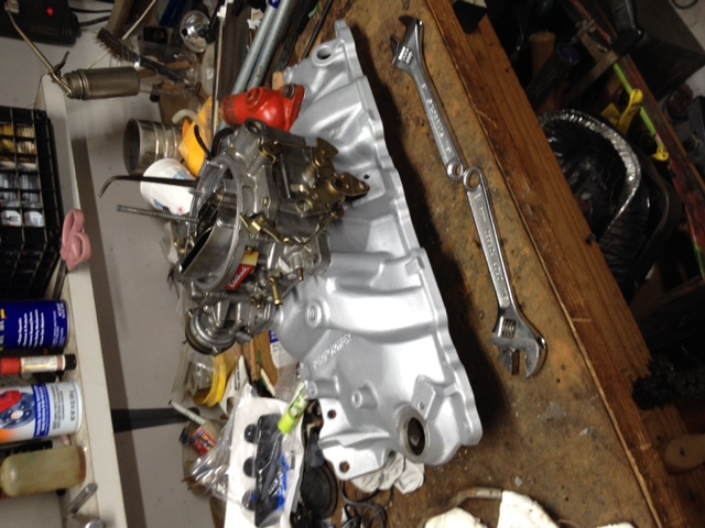

I cleaned and painted the intake yesterday. I also rinsed off the carb with carb cleaner. Here's what it looks like now...
Looking a little closer, I found a broken off bolt in a boss on the front of the intake. Someone had drilled and tapped it to a smaller size. If I remember correctly, this is the boss that is used to attach on side of the alternator mount.

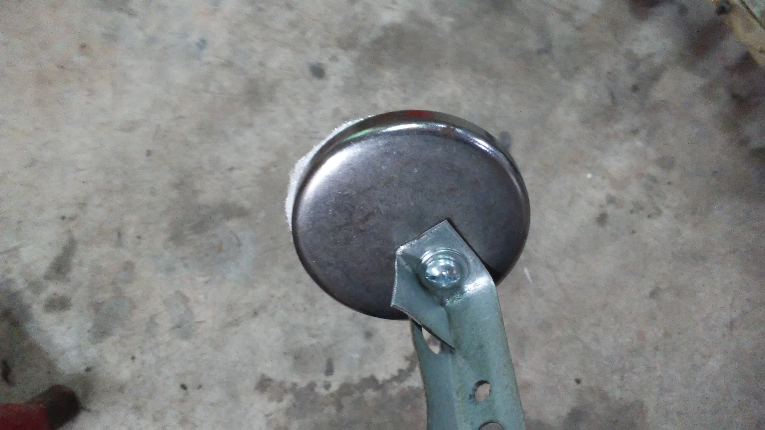

The Cherry Bombs with the header flanges seem perfect to me but we'll need to quiet them down to keep peace in the neighborhood. They're built with a perforated, approx 2", tube straight from the inlet to the the outlet.
Some exhaust goes straight thru the perforated pipe to the outlet and some goes outside the pipe, thru the fiberglass and thru the perforations into the tube and out. We'll use freeze plugs as caps to force more exhaust thru the fiberglass and perforations.
We'll drill increasingly large holes in the caps till we think we have a balance of back pressure vs noise. Should work, we think.

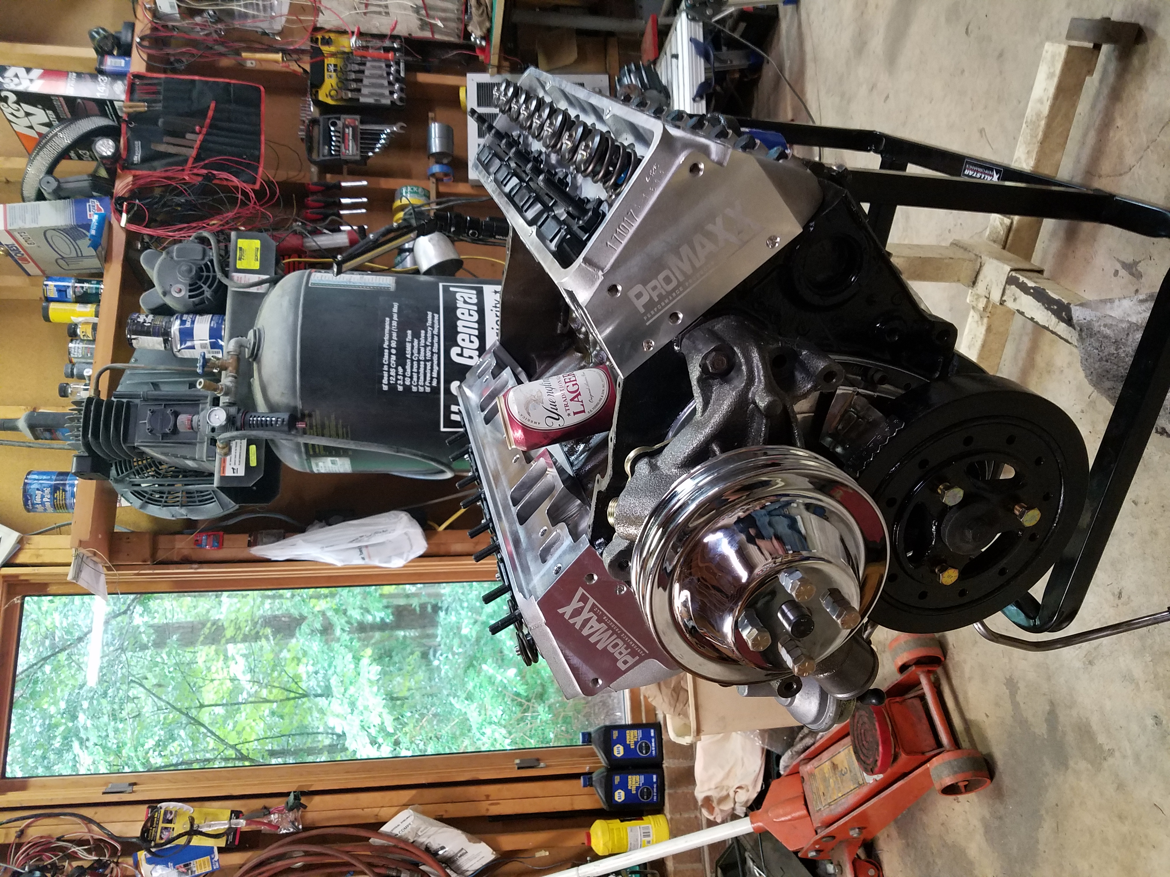

We have the heads, valve train, intake, balancer, crank and alt pulleys, alt, flex plate all installed. Well, actually, we HAD them installed. We put the oil in, temporarily installed oil pressure gauge and used my SBC oil primer tool to prime the oil system. But, NO oil coming up thru the push rods in spite of 20 PSI oil pressure with the electric drill. :shock: We removed the oil galley plug by the oil filter. LOTS of flow. Removed the galley plugs from the rear of the block and all is well there. Removed the damper, alt, brackets, timing cover and found some oil at the top of the lifters but still nothing going up the push rods. CRAP!!! So, WXO started searching his memory and the Internet and dredged up the answer. This priming tool https://www.summitracing.com/parts/mor- ... ent=Moroso won't prime the whole system, specifically not the valve train. WXO found the explanation:

We were concerned about leaks if we tried to install the timing cover and front pan seal with the pan in place. So, we ordered a one-piece pan gasket, timing cover gasket, and the good priming tool. They are scheduled to arrive Friday. We'll pull the pan and seal it up right.
WXO took the timing pointer, which covers the entire rim of the balance, home to shorten it. I ordered timing tape and two oil caps, also supposed to arrive Friday.
The test stand will use my engine cradle to mount the engine on WXO's cart. However, the starter interferes with one leg of the cradle. We're noodling up clearance solutions. Have three ideas about how to approach it. We'll also install some gussets on the cradle to handle the dynamic loads of a running engine.
