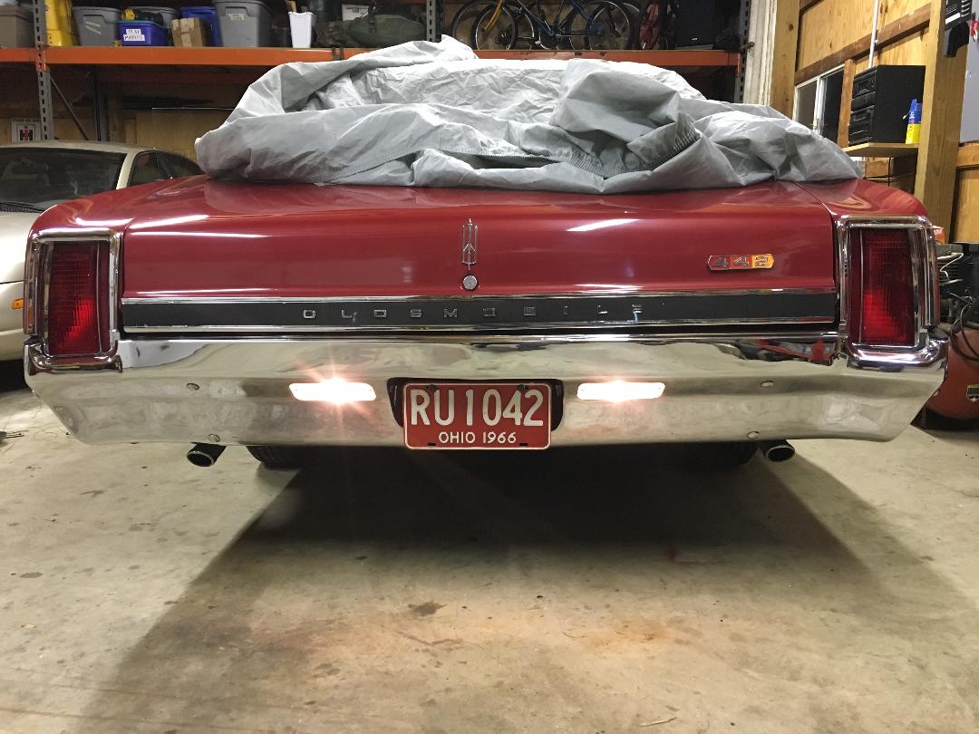

Success! I finally installed the reverse light switch. The kit we got had no instructions on how to
assemble or install the switch. Fortunately, there's this thing called the internet and guys are proud
of their work and photo it, post it, and label it "Muncie Reverse Light Switch". Very helpful! It took
about two hours to mount the switch to the trans and wire it up. The kit we ordered was for an
Oldsmobile, but came as a Chevy kit. The plug in under the dash had to be modified, but it's done
neatly and won't ever fail, so I'm satisfied. Here's a pic of the car in reverse on jackstands, for the
first time with reverse lights on!
