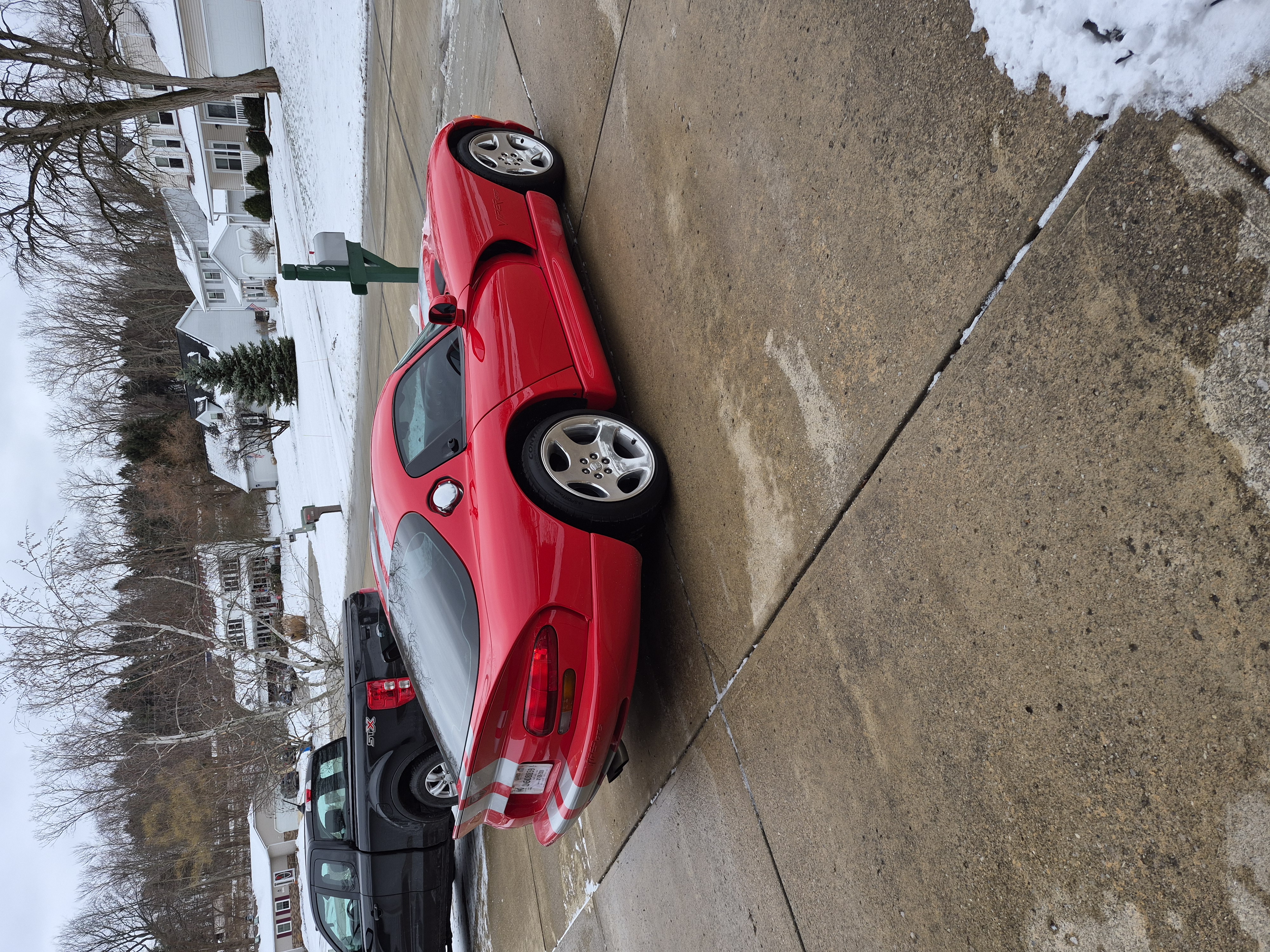

32V and I went to look at it in person on Saturday the 6th. It was a SUPER nice car, and I was really surprised how much I liked the red with silver stripes. I checked it over pretty well, sat in it, and started it up, but did not drive it due to weather, and I wasn't convinced I was going to make an offer on the spot. But I did take a picture to stew on over the weekend. Once Monday morning hit, I knew I was going to at least make an offer on the car, and called the dealer first thing. After a couple back and forths, we were $2500 apart and I stalled the negotiations. As I thought more and more about it for the next couple days, I was really going to be upset with myself if I let it go, so I called back to reopen the talks. We basically split the $2500 in half and called it a deal.
Fast forward to Friday, Dec. 12, when MostMint helped me pick the car up. Despite the crap weather we've been having early in the season, I was able to at least find a day where the roads were dry, despite being coated in white salt dust, so I decided it would be easier to just drive it home and hose it off than mess around back and forthing with friends and their trailers. Thanks to Dave and Kevin for both offering though!
So the first time I drove the car was after it was paid for and on my way home... This did not turn out to be a bad thing though as I made it home with no issues. Except that the dealer sold me a very expensive car with less than 1/8 tank of fuel. :lol:
I'm really looking forward to next spring when I can take this out and really just start to enjoy it. As of right now, I really don't see anything that will need to be done to it between now and then except to keep it dry. Should be a fund Summer of 2026!

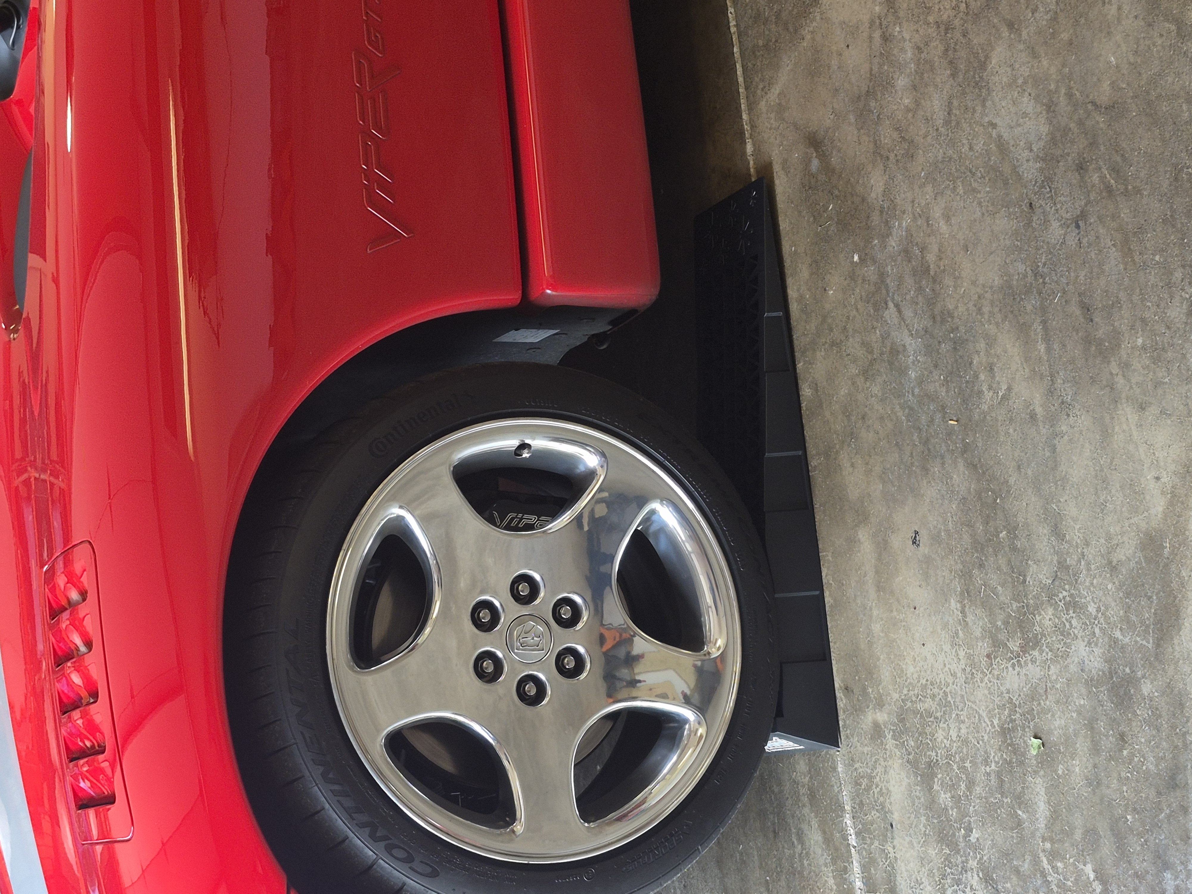

Just random pics of the Viper.

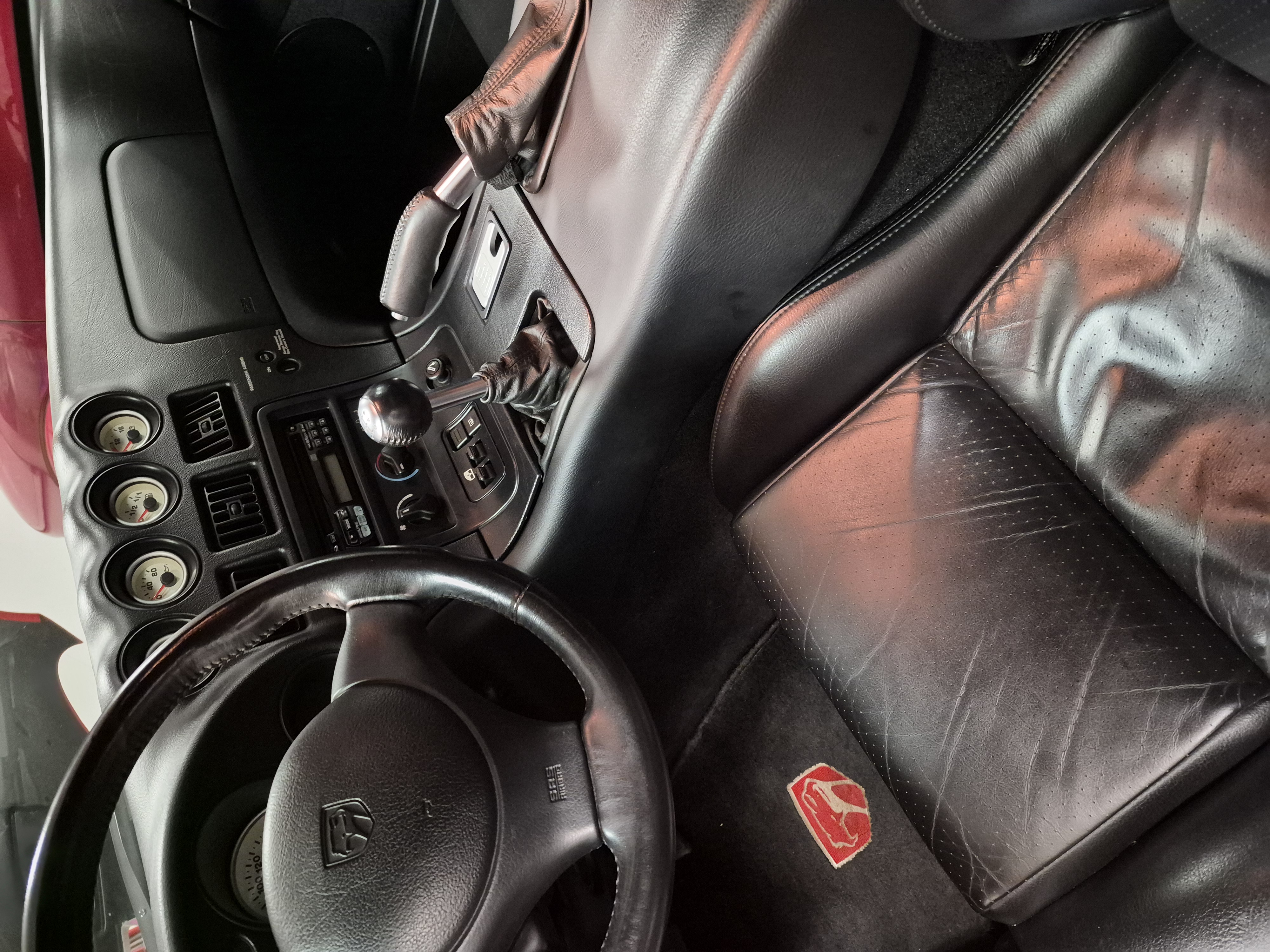

Yep, no nannies at all. Not even ABS yet. No cruise control either, but power windows and A/C were standard. Even has a CD player. Looks aftermarket, but they just stuck an Alpine single DIN in there from the factory. I really like the whole race car vibe of the car.
I did order an OEM shift lever and knob off ebay. It currently has a super short knub of a shifter that in the short time I drove it, seems to make an already knotchy shifter even tougher to manage. Most everyone wants the shorter throw on these and most get changed, but I think I'll really like the stock one better for regular driving.

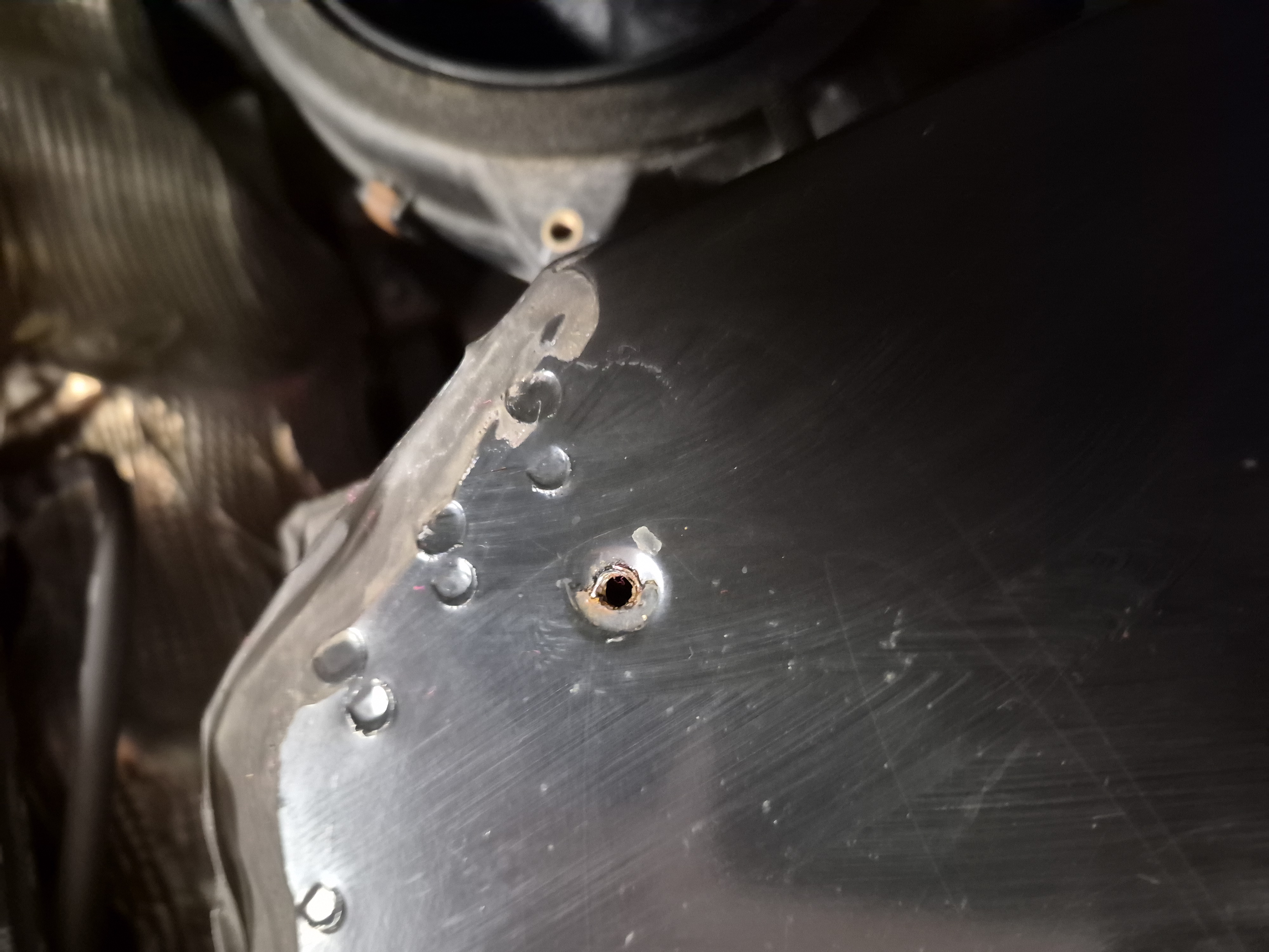

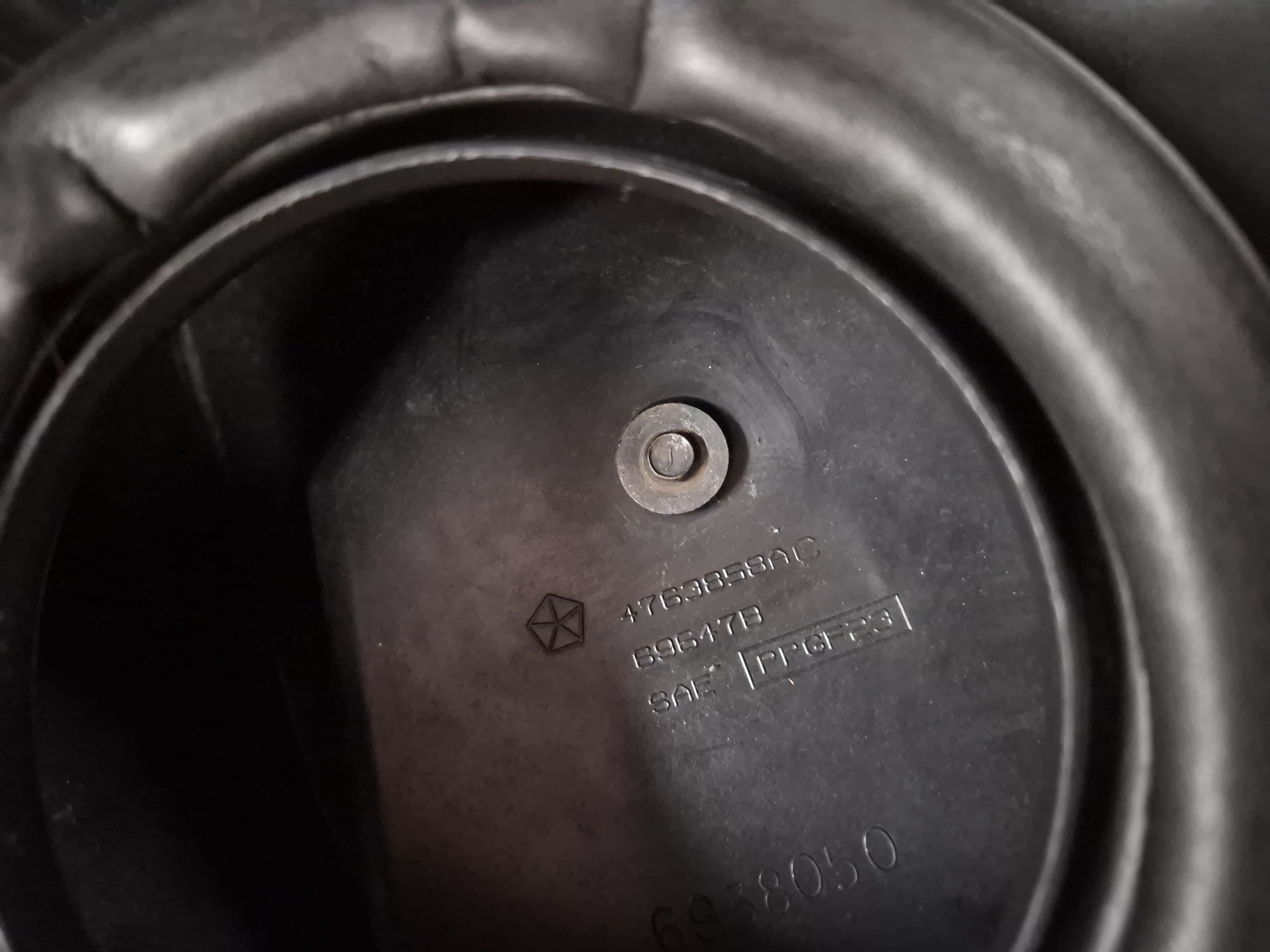

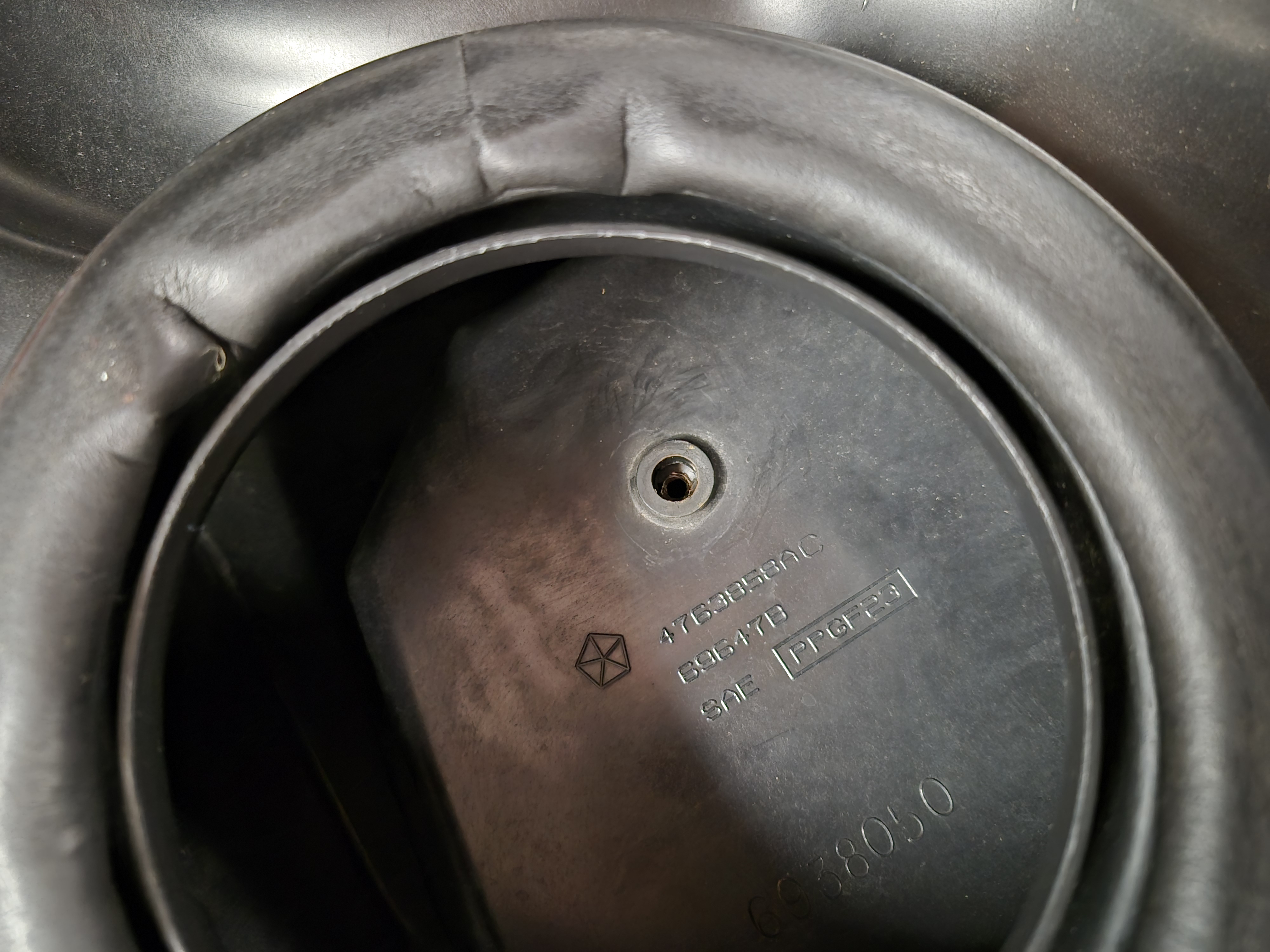

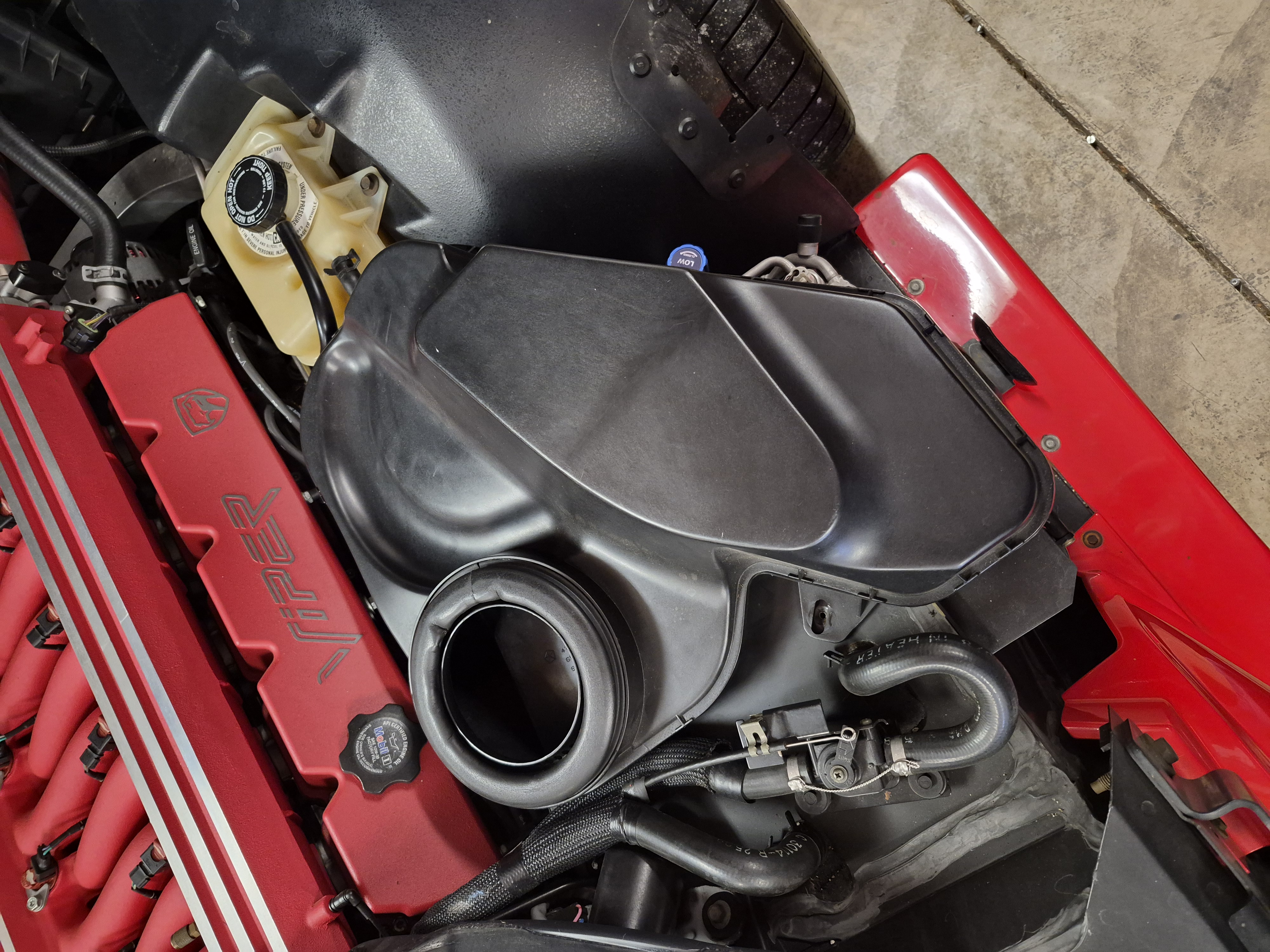

When I pulled the floor mats out of the passenger compartment, the floor under the passenger's side one was soaked. I learned this to be a common problem with these letting in outside water, and there's likely a drain by the HVAC inlet that is the culprit.

The problem was not a plugged drain hole, but a self threading screw that is directly under the outside opening in the hood that let's in fresh air for the HVAC. When I took this inlet box off, there was still water surrounding the screw. It's kind of a low spot there. So I got the black RTV out, smeared the screw, washer, and the point where the upper box meets the lower box. Im pretty sure that problem is cured.

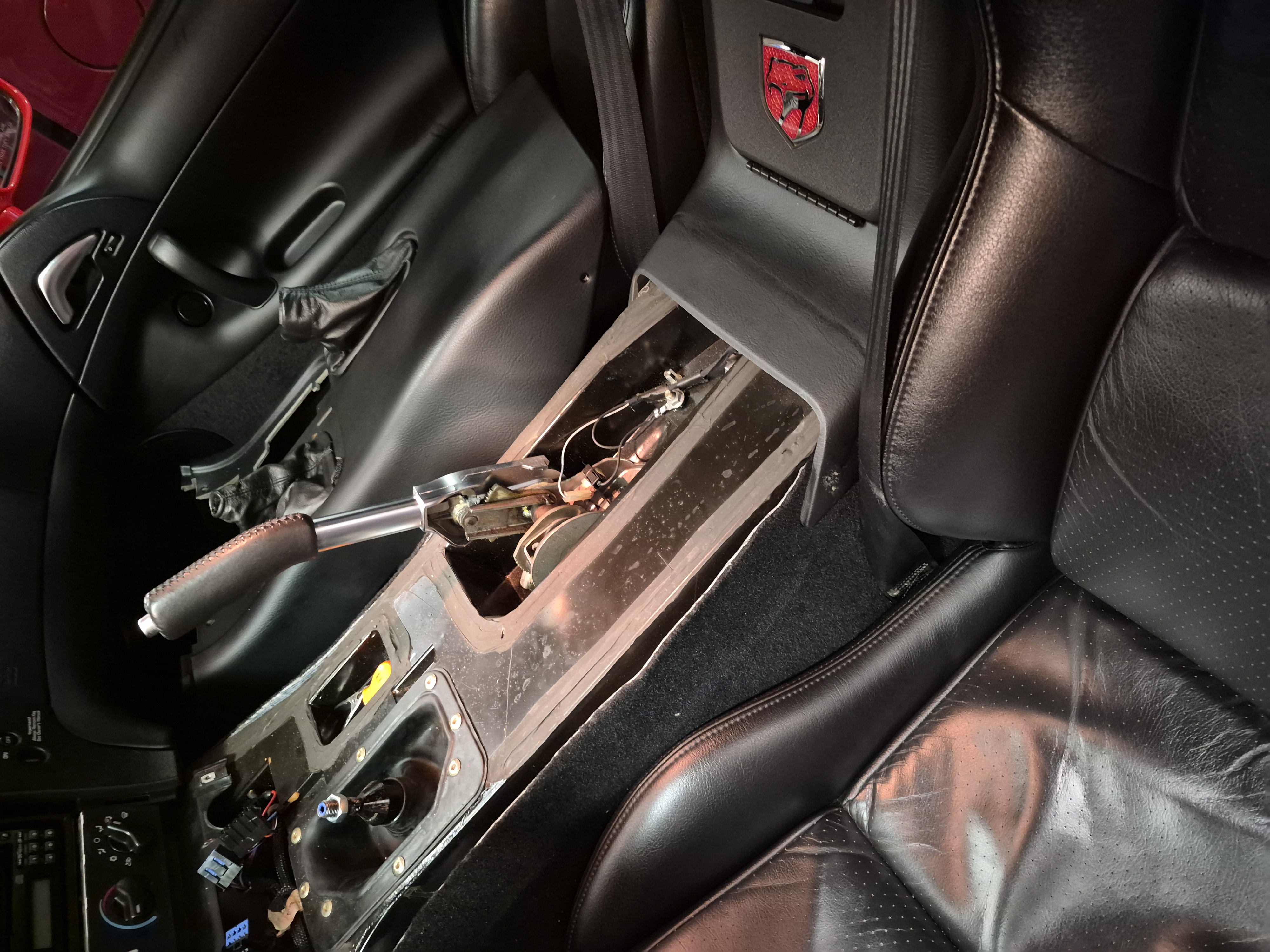

The OEM shifter lever finally arrived and got installed today. The aftermarket shift knob had a set screw on it that I did not see initially which made removal pretty baffling. It was hidden right where the leather boot was resting. After I finally got it removed, I had to chase a couple threads I boogered up, but no big deal. I did have to make a trip to the hardware store for a 1/2-20 jam nut to hold the new, original style shifter in place.
After some minor disassembly and reassembly of the center console and trim, and some thread chasing, everything went back together smoothly and I'm very happy with the result. This will be a great improvement in driveability IMO. I also put the trickle charger on it to top off the charge.

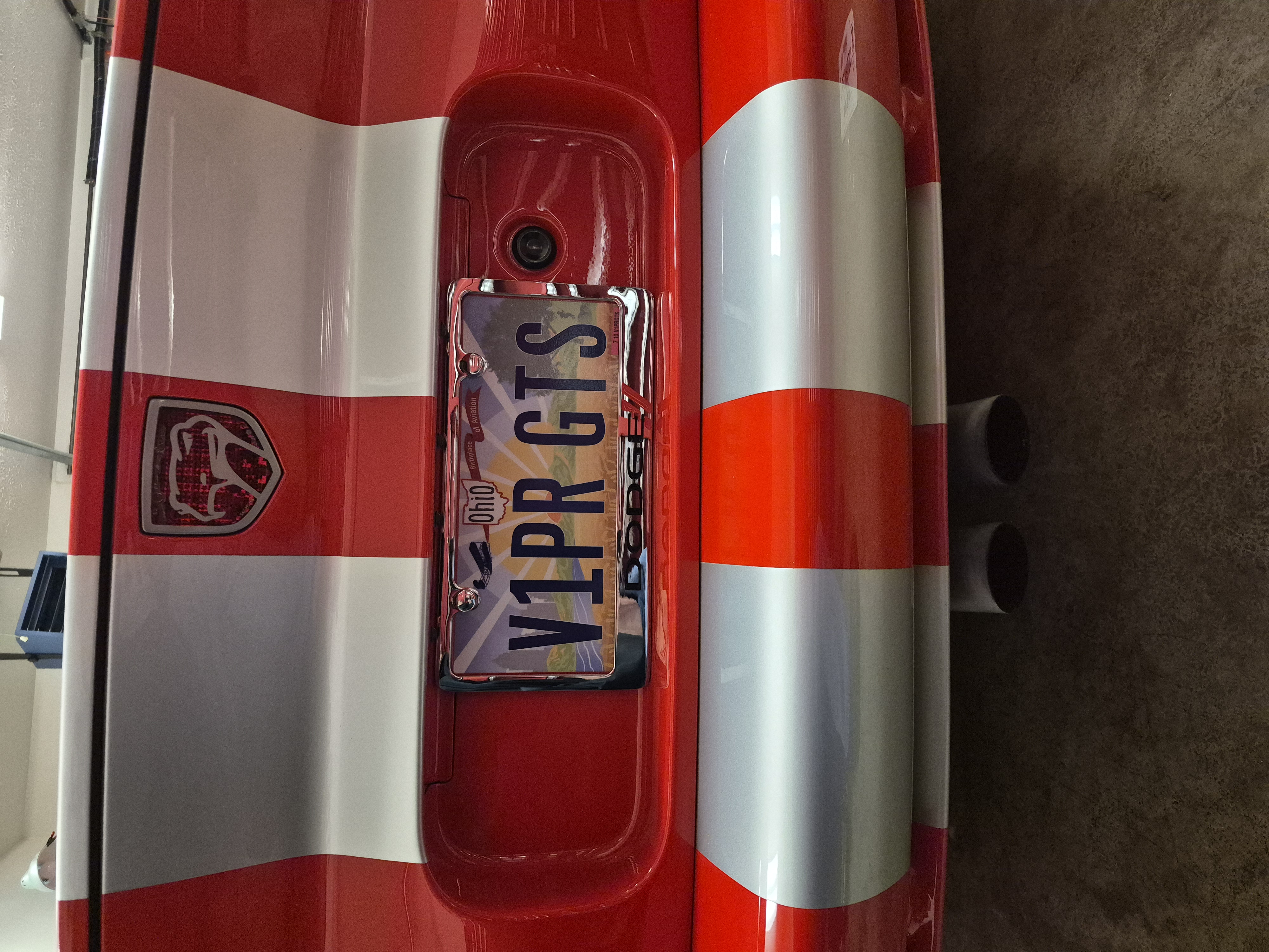

The Viper got it's new license plate and frame. Turned out pretty well I think.

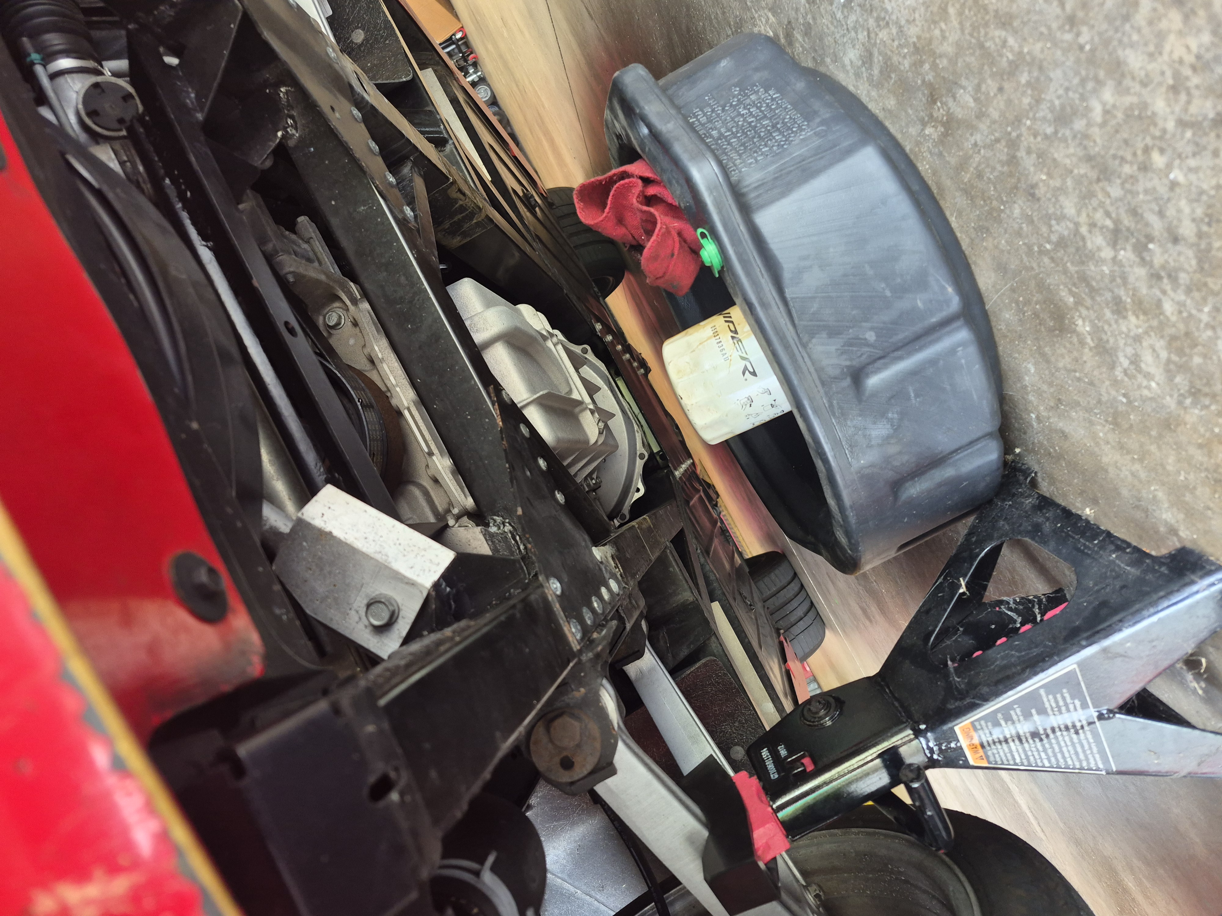

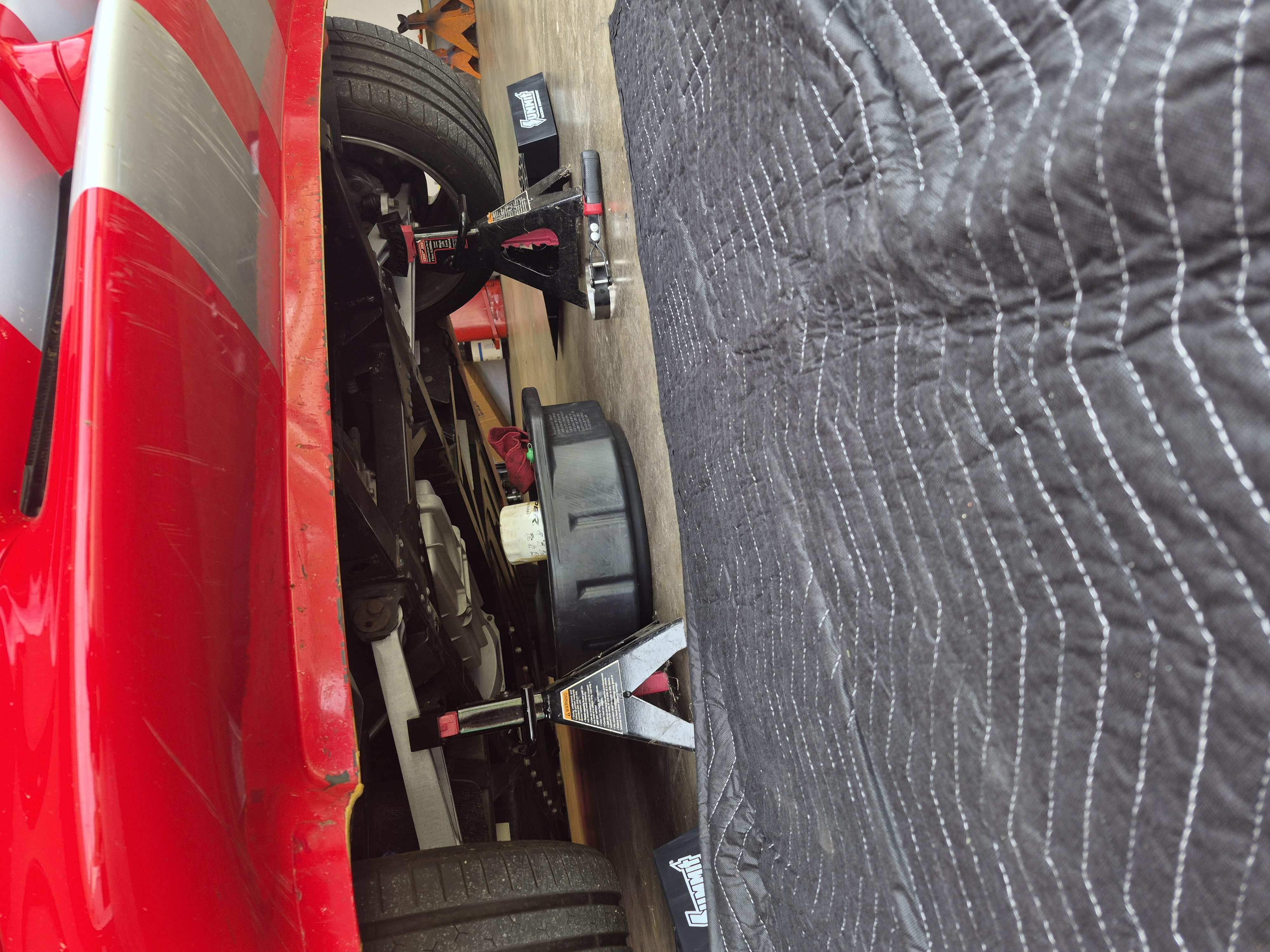

Today I changed the oil. I wasn't sure how old the oil was that came in it, and it was reasonably dirty, so I did it. Everyone says to use this specific MOPAR oil filter and not the store brands because the Viper has noticeably higher oil pressure that will open the bypass on most filters. The car did have the correct filter on it already which was a good sign. I put synthetic Castrol 5w-30 in it. There are a hundred different oil recommendations but this is what I went with. If the motor stays quiet I'll stick with it, if it gets ticky I'll go thicker. End of the day it's just a pushrod truck motor. A lot of guys run diesel oil in thiers... Since this thing will technically have a pretty easy life, it won't need anything special. Changing the oil was as easy as any other car, but it does take over eight quarts. And using the Summit brand drive on ramps made getting a jack under it a simple task.
Now I'm ready to drag it I think.
