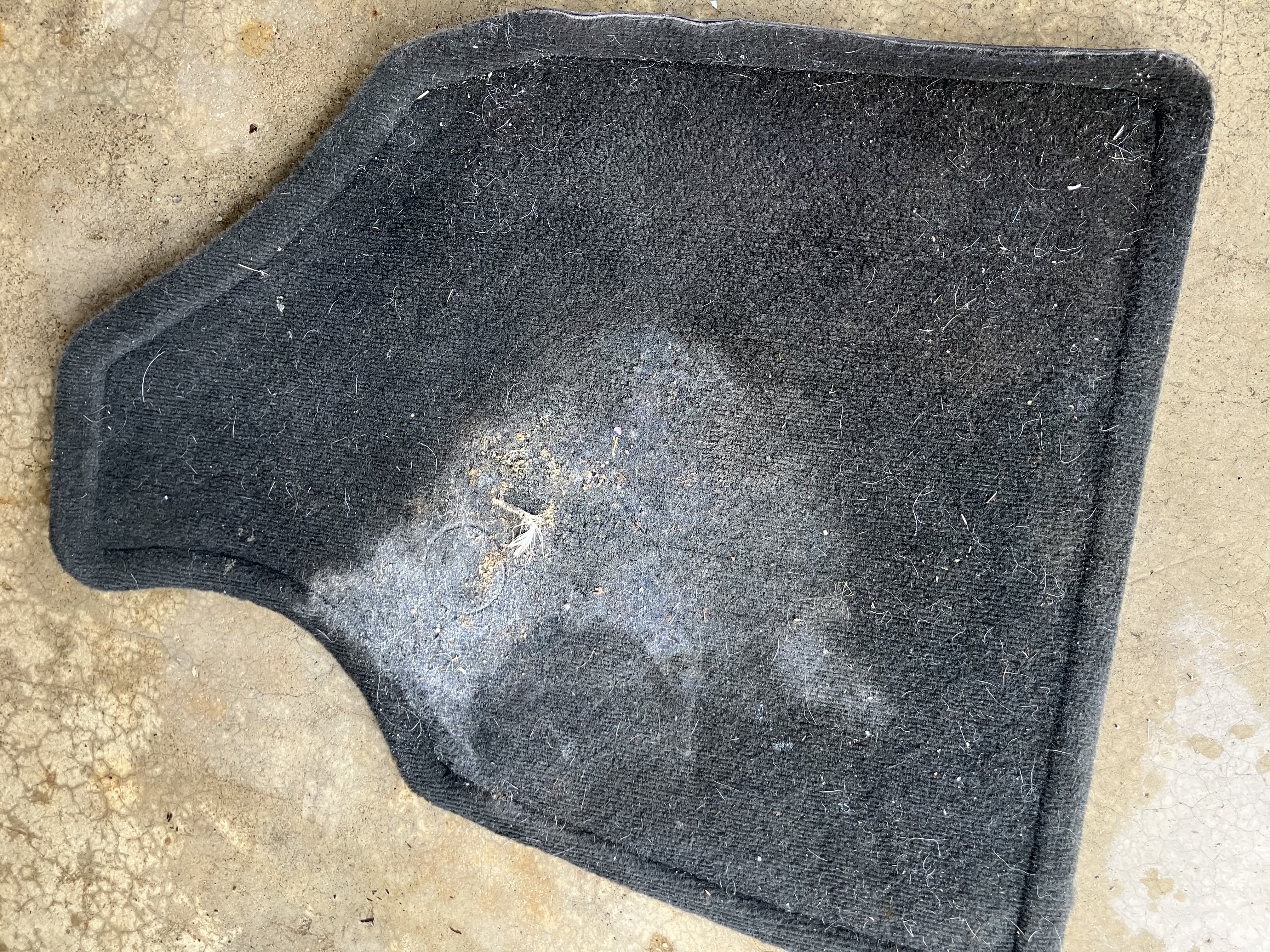

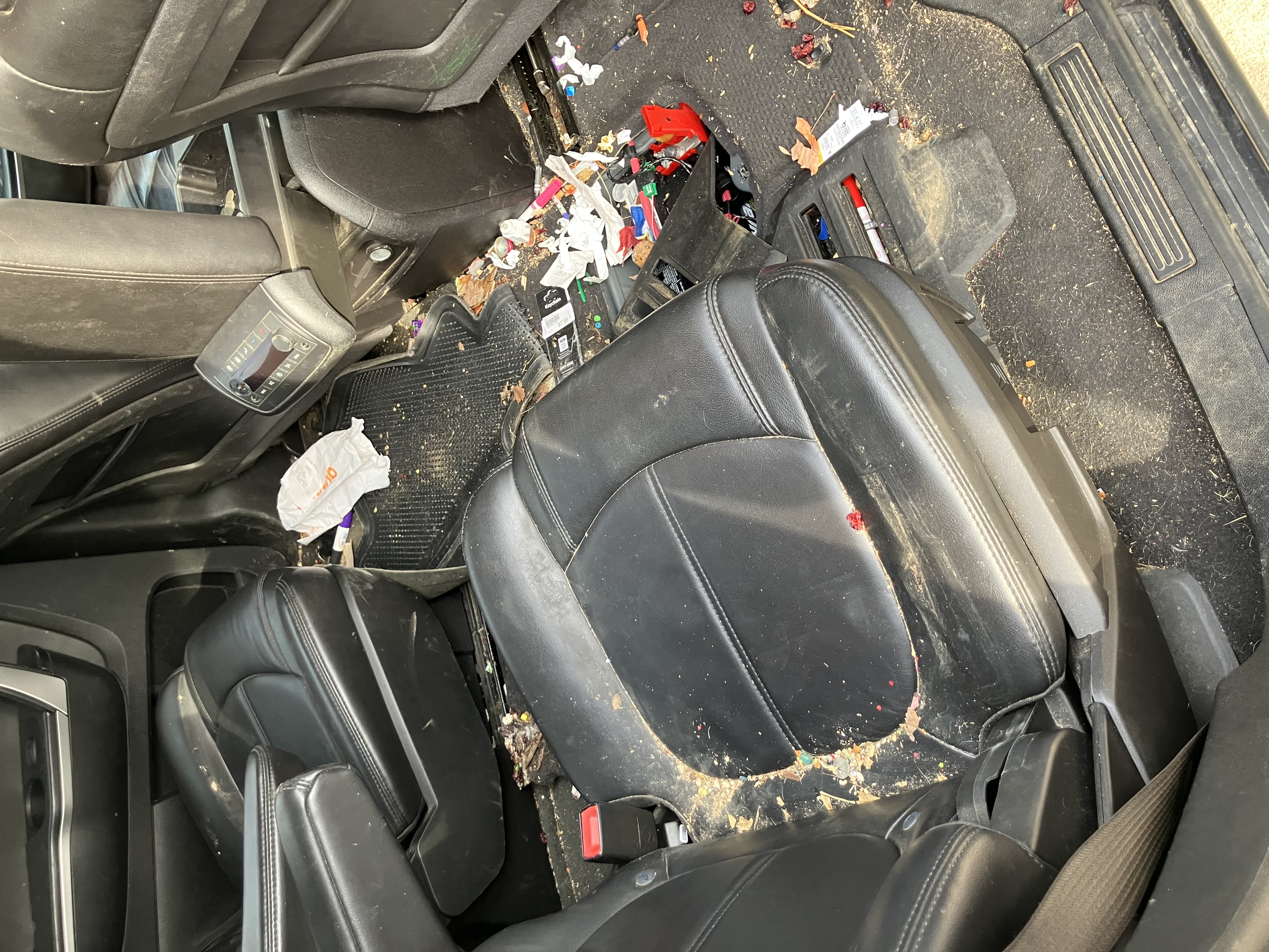

So the first thing I did was clean up the interior some. Nothing fancy, just cleaning up all the misc trash, vacuuming, and washing up the front mats. The passenger mat had some goo on it which turned out to be laundry detergent that took forever to wash out.

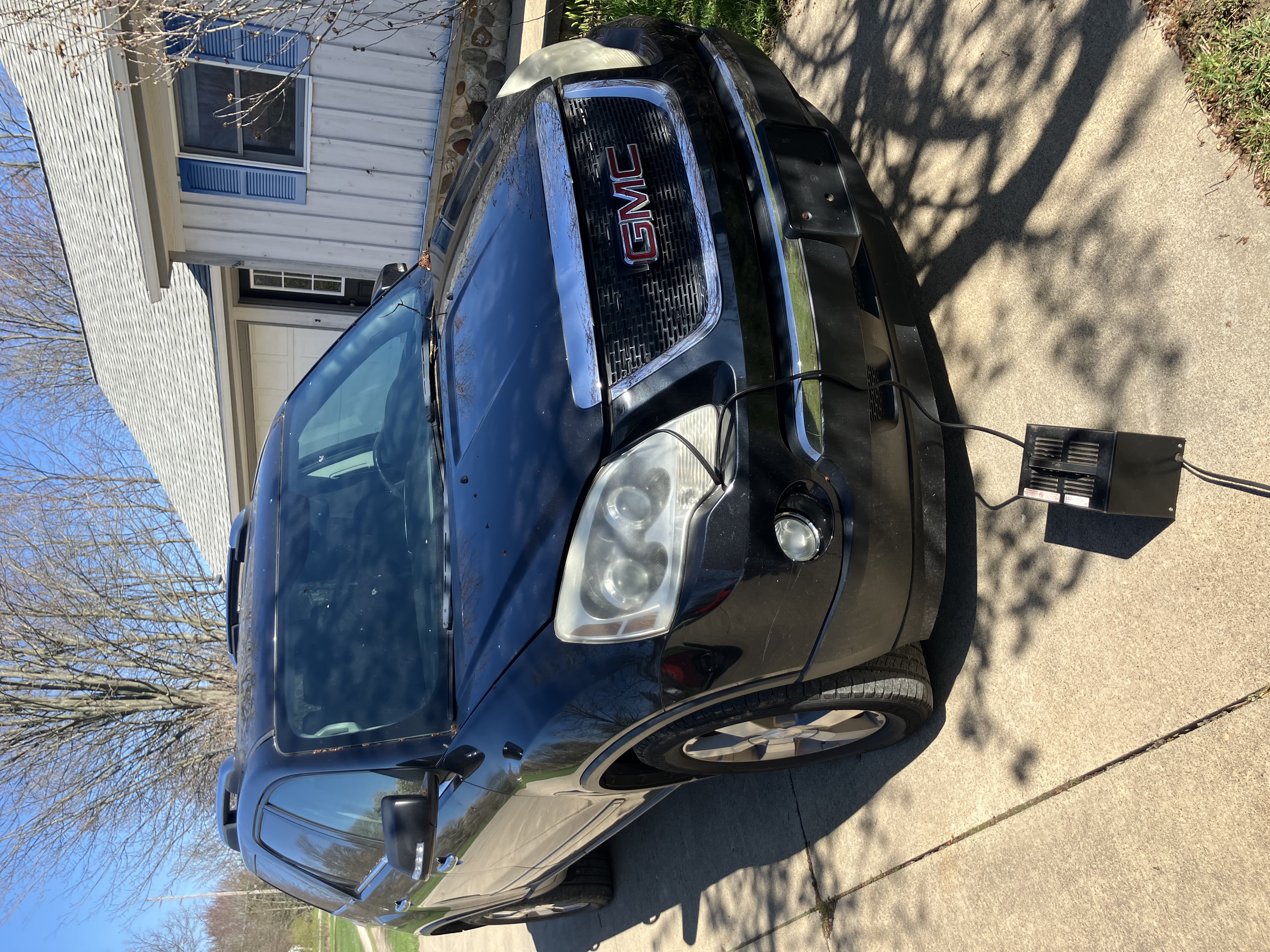

After putting a charge into the battery I hooked up the scan tool, and found no engine codes. After that I couldn’t resist, so I tried to start it. Prior owner was hesitant as he seemed to think the timing chain might be out of time and didn’t want to damage the valves. It cranked but no start. The next step was to put a little starting fluid, and with it the engine fired right up for a few seconds. After that I started looking at fuel pressure, which did not show up on the pressure gauge. That led me to check the fuel and while the gauge was 1 tick above E, adding a couple gallons showed real pressure at the schrader valve. Still no start though the battery wore down fairly quickly.

The next day after the battery was charged I reconnected the fuel pressure gauge and tried it again. Fortunately it started right up and idled. Fuel pressure over 40 psi. I moved it up and down the driveway and let it run for 20 minutes. There is some ticking under the hood. While the check engine light was not on, it did have a P0008 code as an active code.

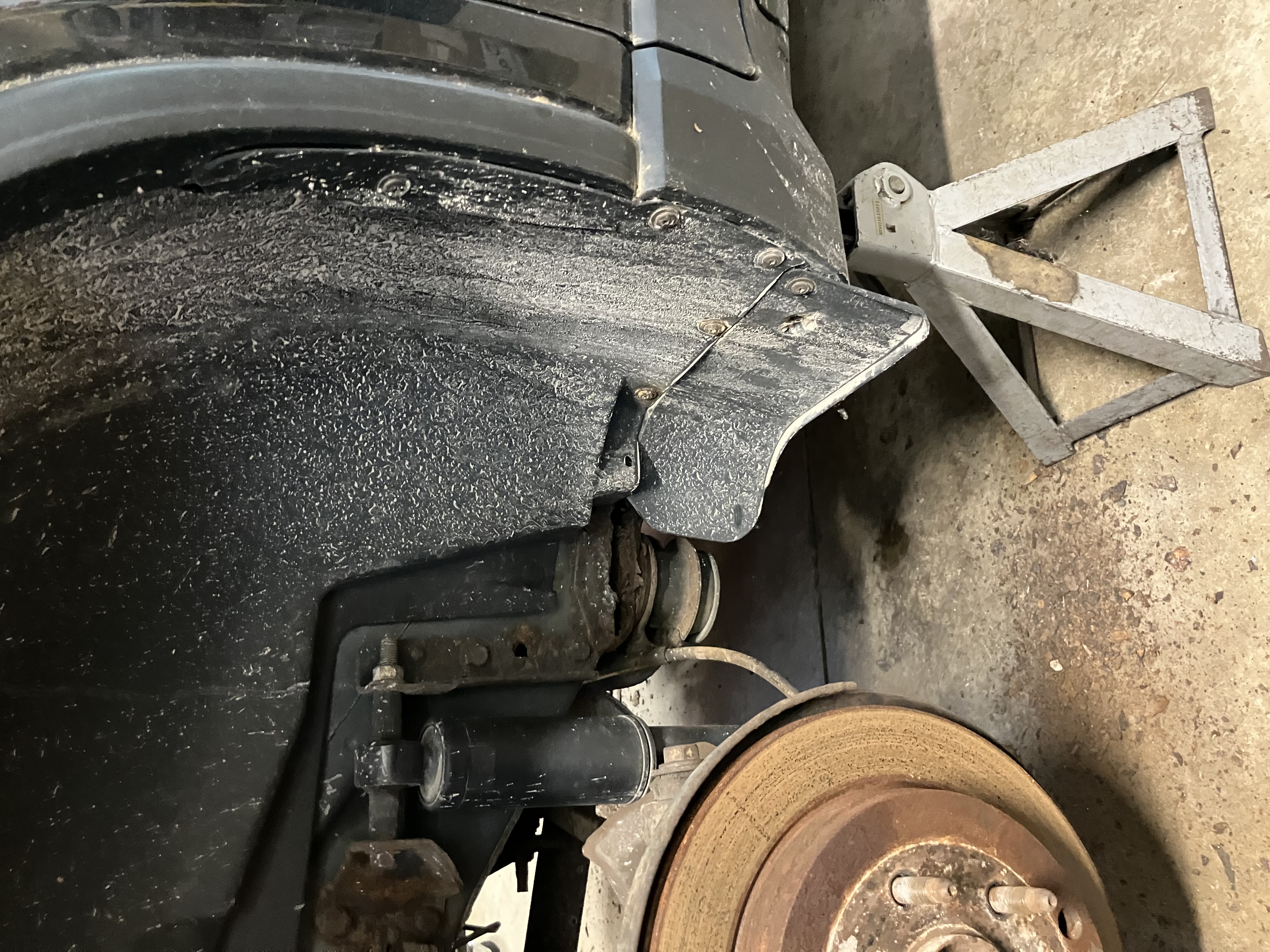

The rear spring bump stops were broken. Since Kurt will surely overload it I decided to go after this small project.
Taking off the rear wheels uncovered some sketchy looking parts of the chassis. I took the inner fenders off to get a better look, but it was pretty bad on both sides. Before starting on repairs I decided to check the rest of the frame and found two spots (under the front door on both sides) that just disintegrated when I went after them with a hammer. This vehicle is deceptively nice on the outside but its falling apart underneath. I'm not sure if I'll sell it as is, part it out, or maybe find another that needs repair, but with 198k, extensive frame repair, and a difficult timing chain replacement ahead I am sure this one will not get fixed on my watch.
