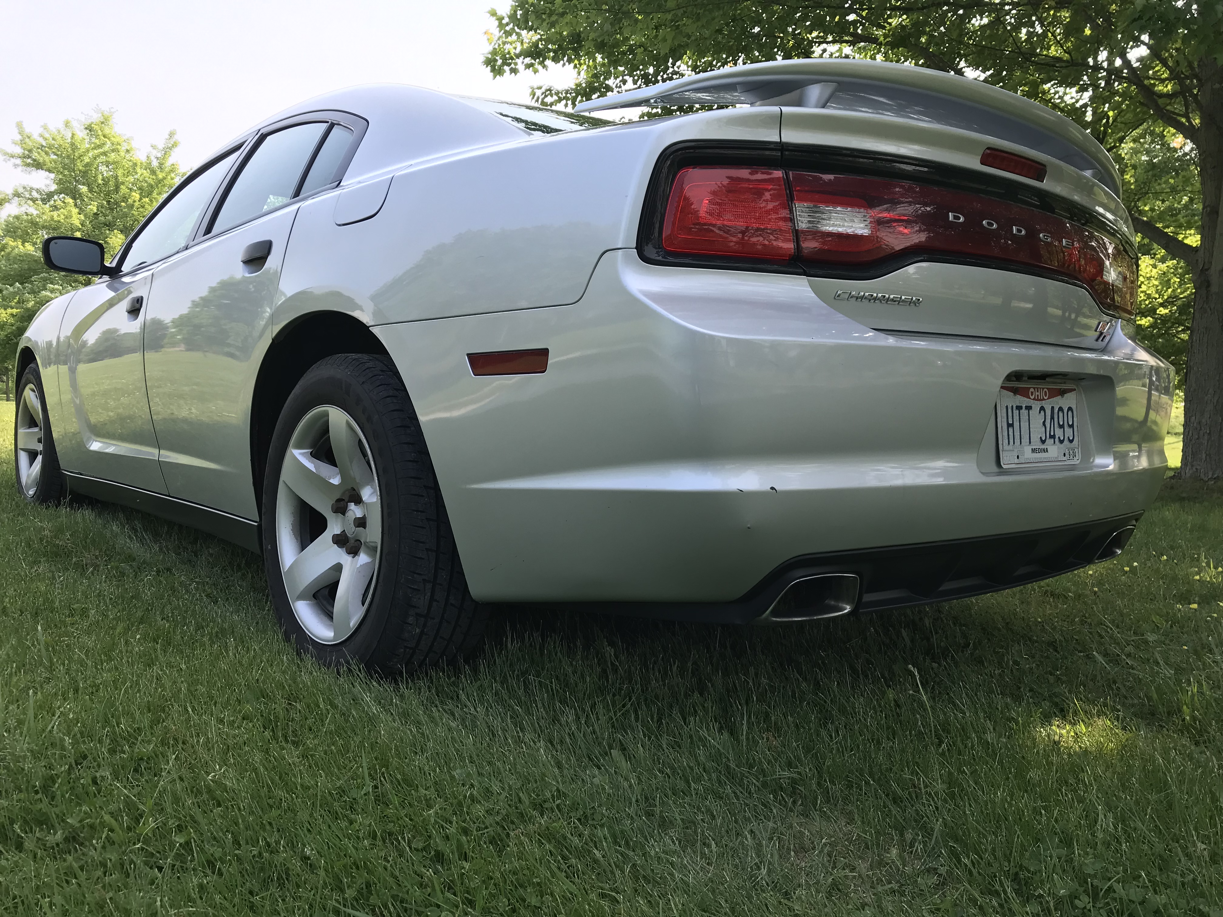

Re: 2013 Dodge Charger Police
Some pics. Still a couple minor details to address

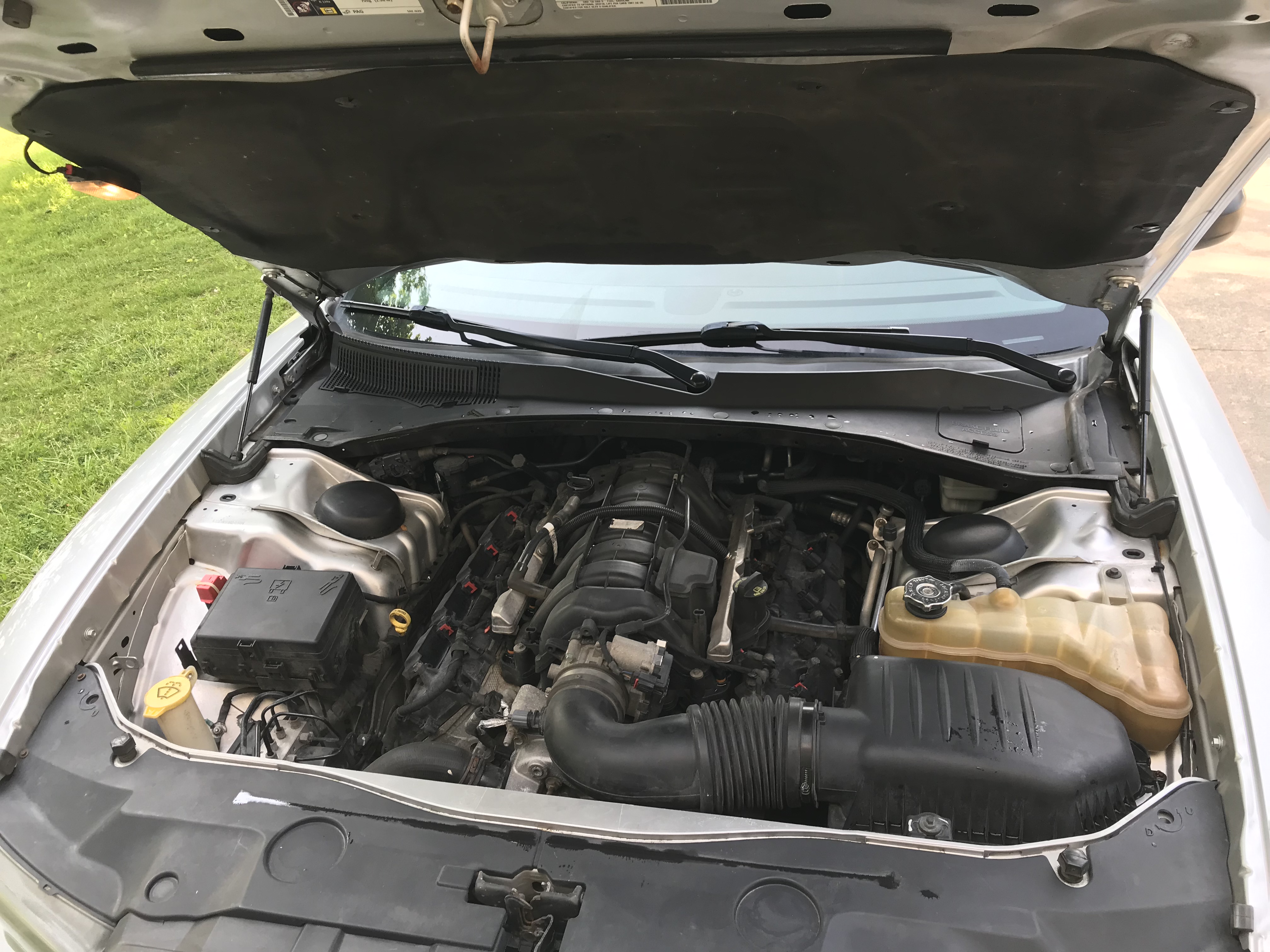

Replaced the evap solenoid as it was occasionally kicking a P0455 code. The part was < $30 and it lives in the engine compartment.
The air bag light is on. I have no idea what is causing it - will have diagnostic tools available shortly. Rachel said it goes on and off whenever it do chooses. It was off when it showed up here.
