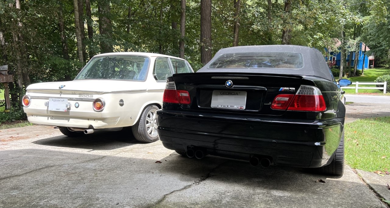

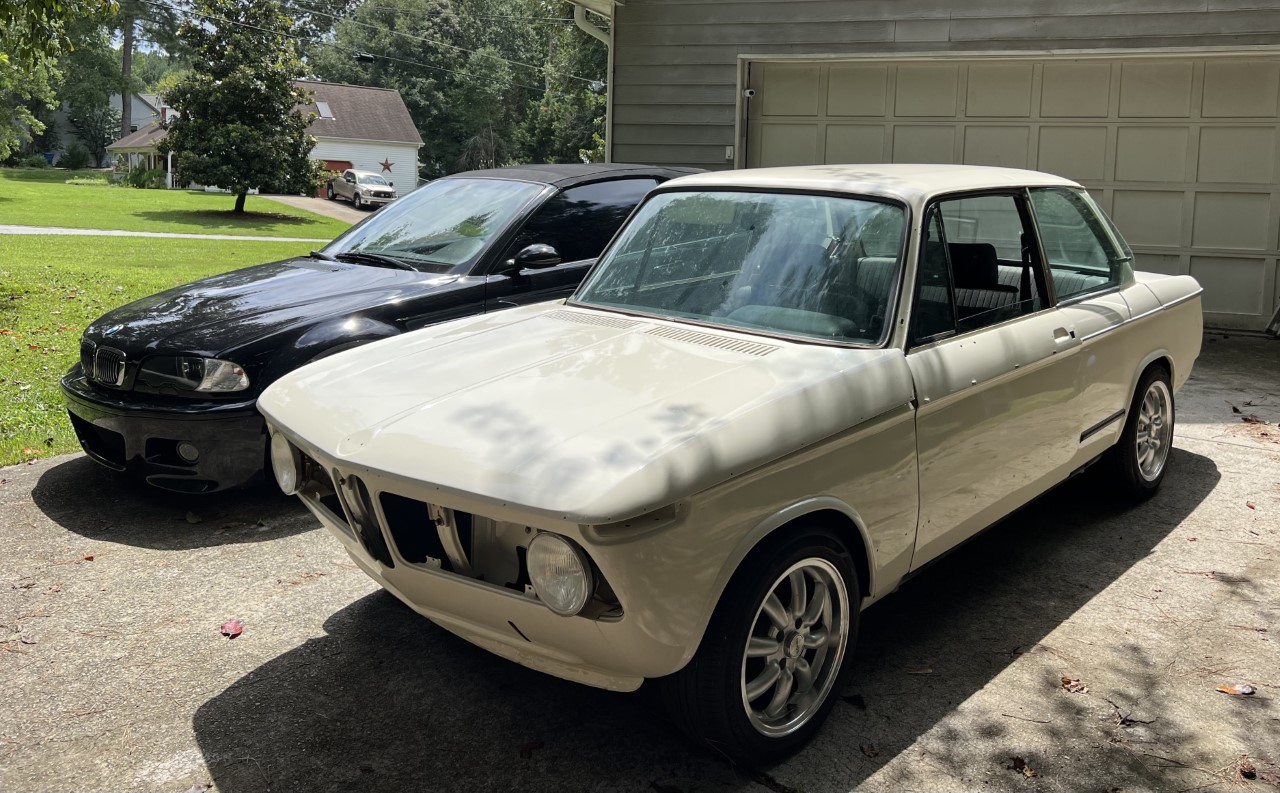

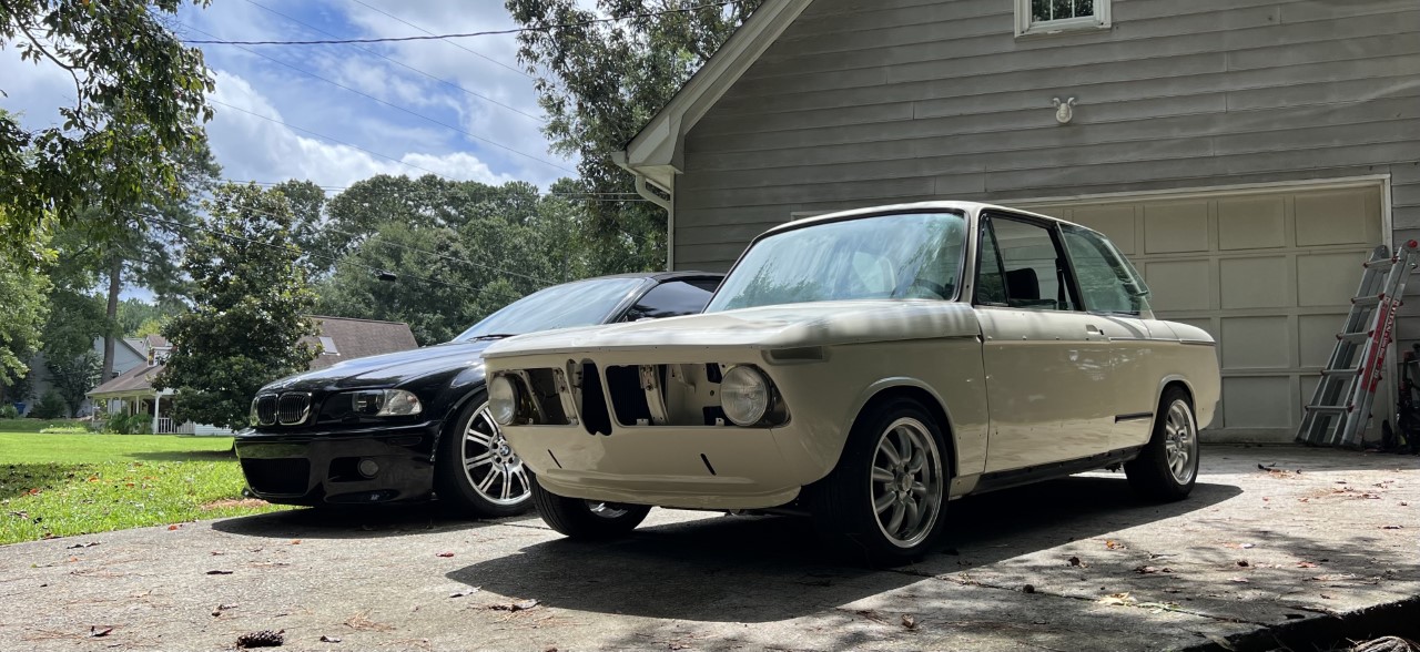

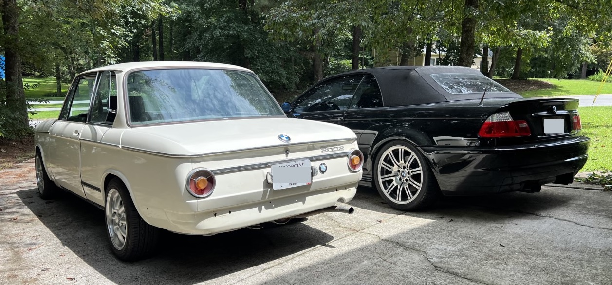

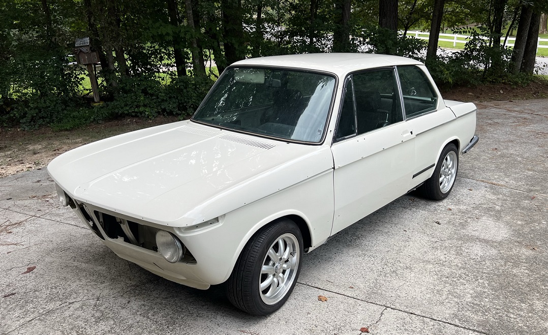

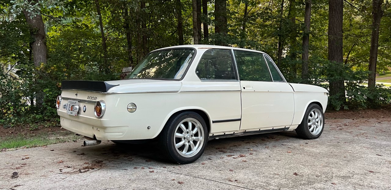

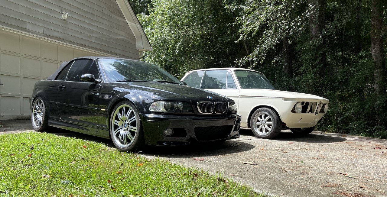

a few driveway shots.

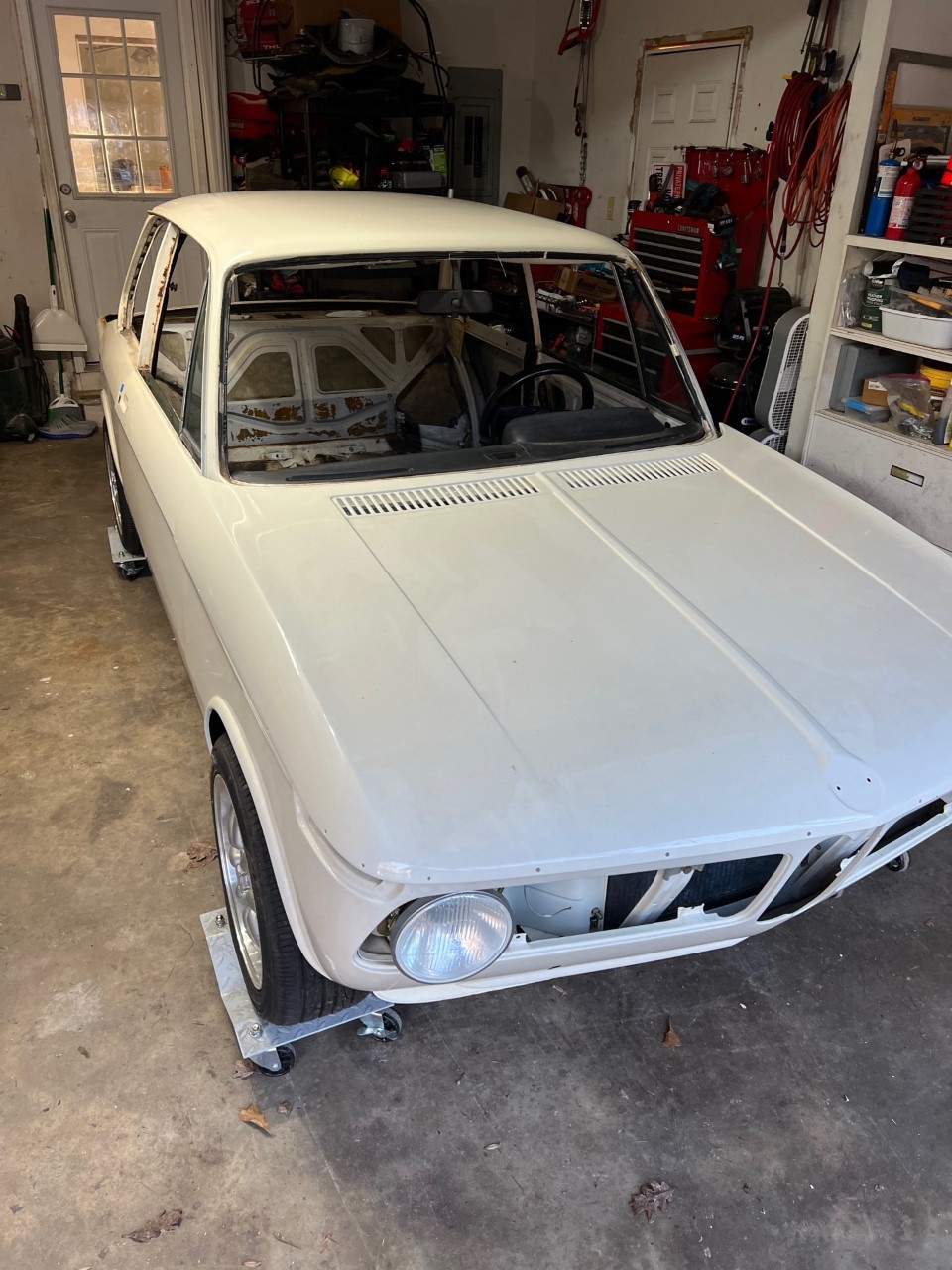

I have decided to finish dis-assembling the car and repaint it.
Posts: 3021
Re: 1970 BMW 2002 - roundie # 48
Don't like the color? Is the paint bad? Paint looks OK in the pics

The car has a lot if chips and such. It had a new nose put on it from a minor accident. So only the front of the car was repainted. Since it is already half apart, now is the time to do it. I hope to try and take the car to the next level.

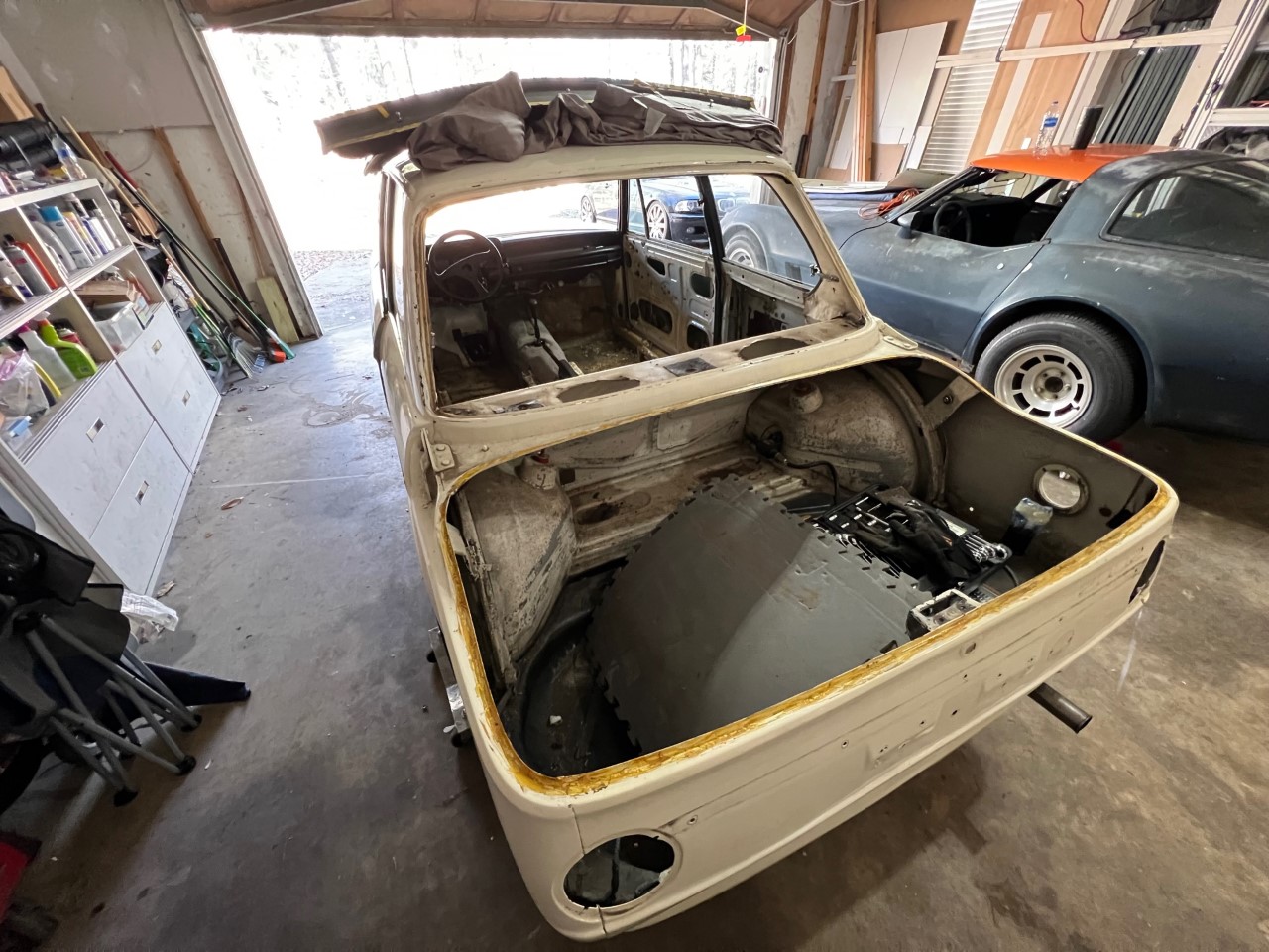

all the glass is out.
all the weather stripping is off.
all the molding is off.
a couple minor things I want to address then off to the body shop and paint.
I'm excited...............

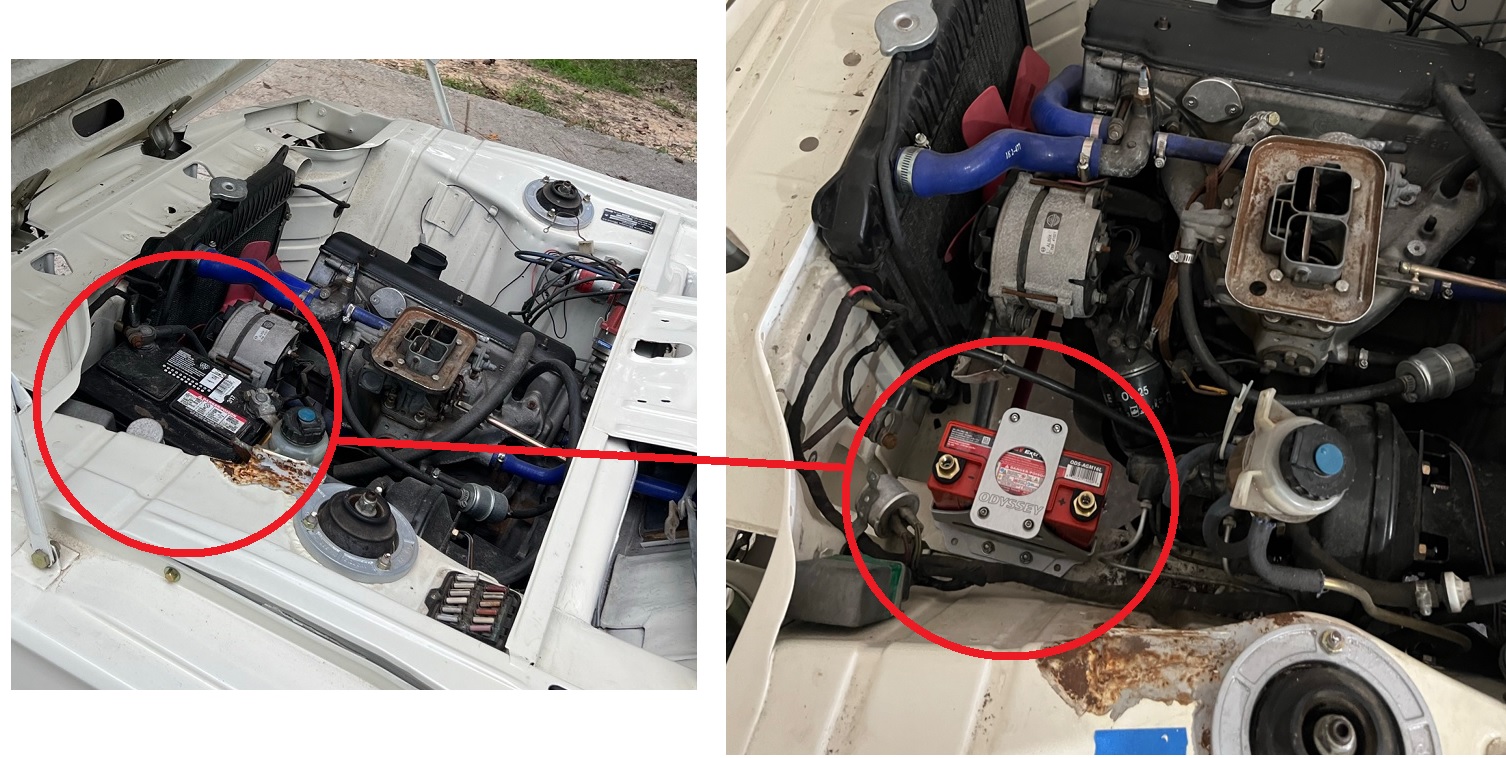

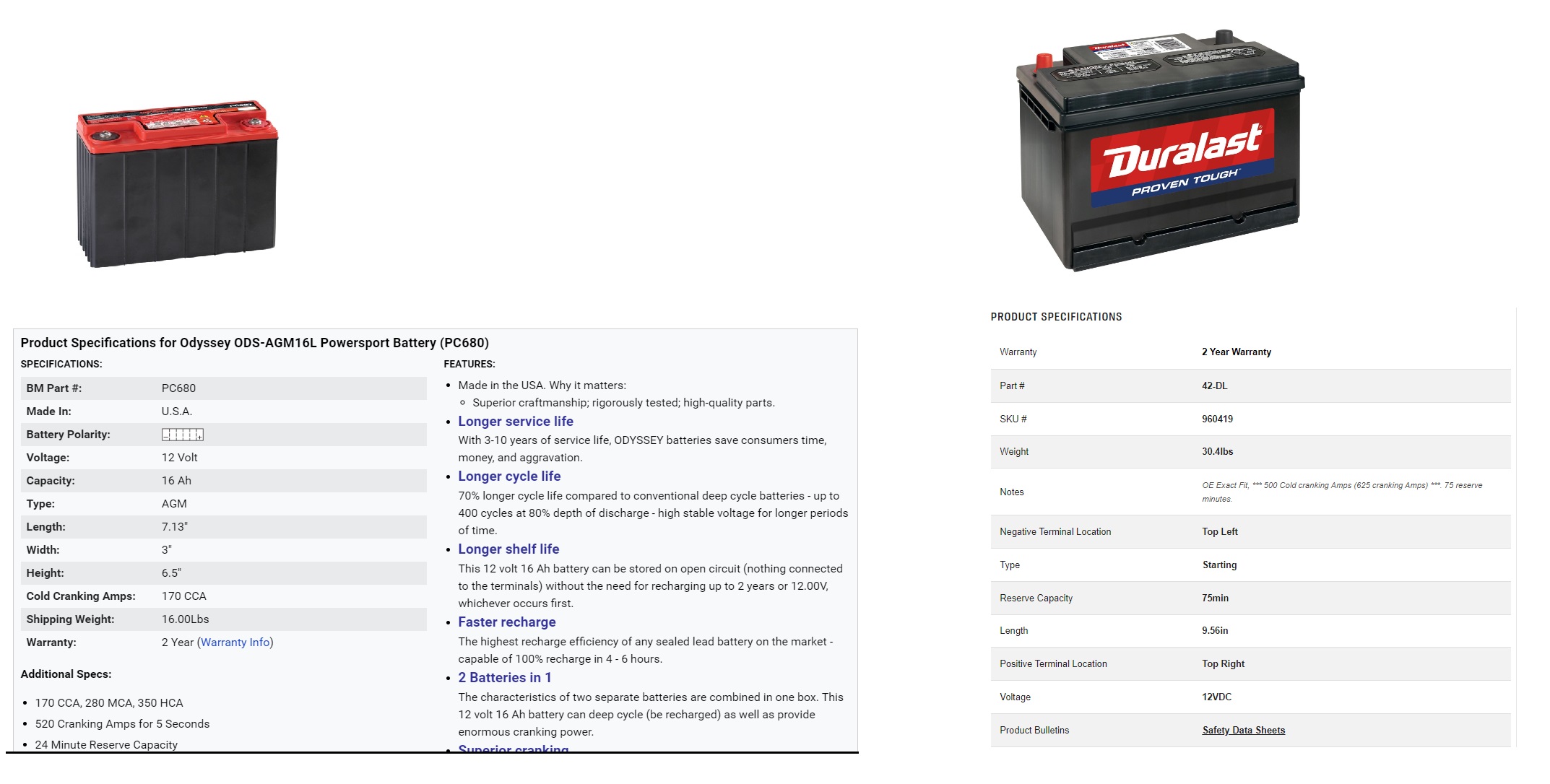

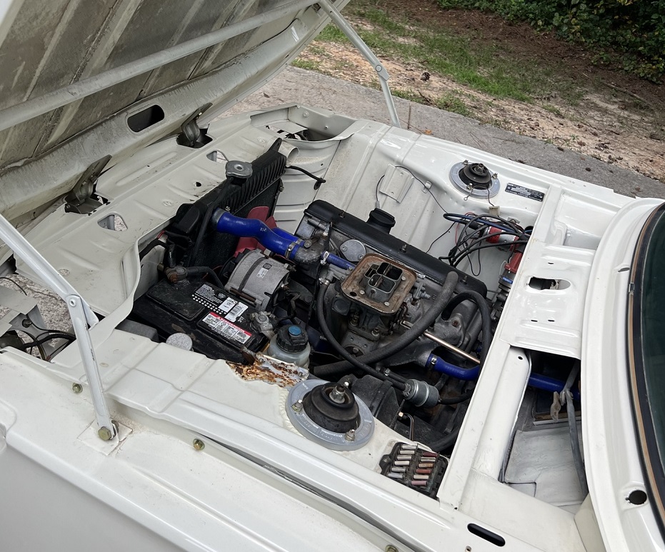

UPDATE ENGINE BAY
I decided I hated the large ugly standard type battery.
After a little research, Mazda MIATA guys like this small AGM battery.
I just need to figure out how best to isolate it and mount it in the engine bau.
I think it looks great.

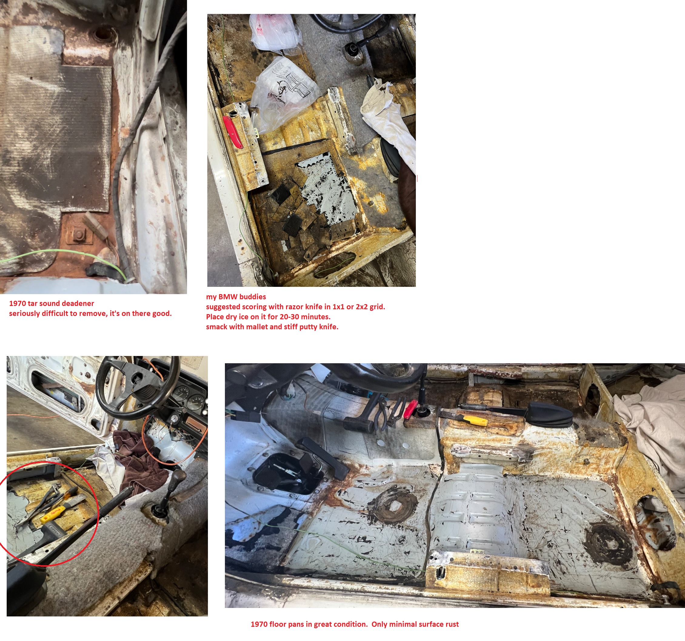

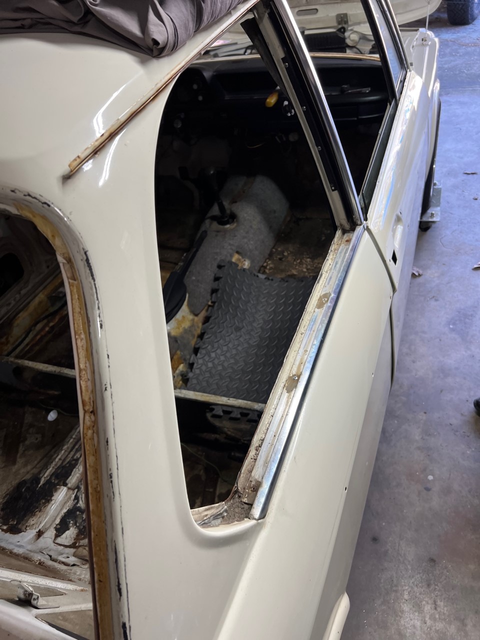

UPDATE FLOOR PANS
I decided to do banging and scraping on the interior before paint.
Then I discovered the tar panels were STUCK.
I was at that time thinking to put the new kilmat directly over the old.
My BMW buddies here changed my mind.

How much weight savings did you get from that battery too? I'm guessing at least 15lbs. That tar flooring seems like a terrible job, but the floor looks sweet underneath.

Basement Paul wrote: Sun Jan 22, 2023 10:32 am How much weight savings did you get from that battery too? I'm guessing at least 15lbs. That tar flooring seems like a terrible job, but the floor looks sweet underneath.
The dry ice made very easy work of the removal.
About 14 pounds
