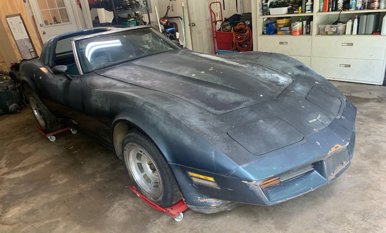

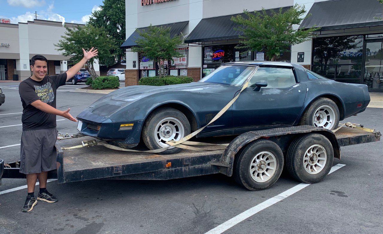

Today Alex and I purchased a project car. He really loves the "shark style" corvette.
I will put up more data in a week or so.

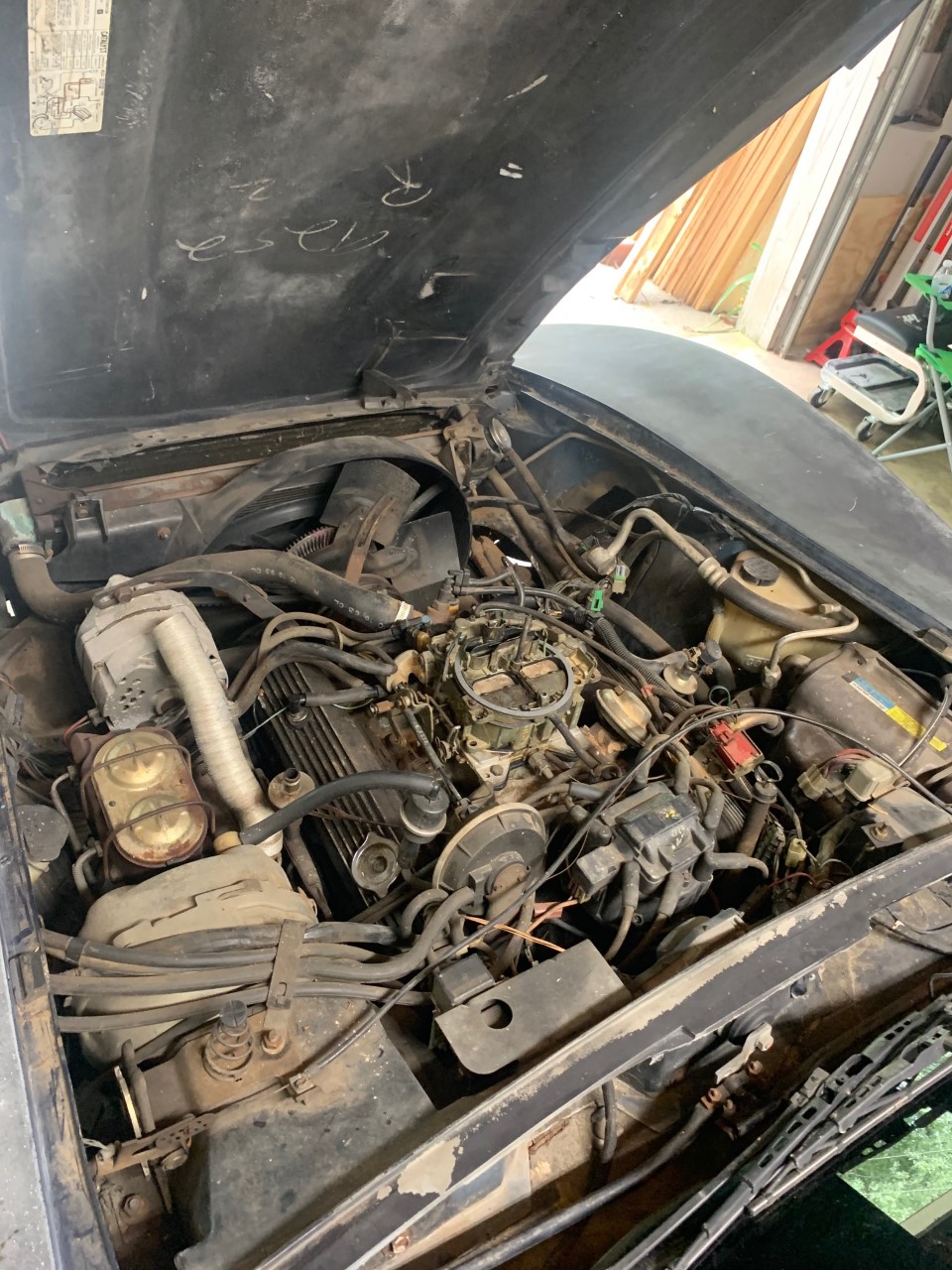

I received the new fuel lines from Ecklers and the QJet kit from Quadrajetparts.com yesterday. Hopefully I can rebuild the carb and get it running.
Once it runs, check the brakes. Rolling it off the trailer they were SUPER soft. THEN to see if the transmission shifts.
IF all that works out, Alex can move on to learning everything. I want him to have a project that can move under it's own power.

the car runs (sort of) kind of idles on it's own. Probably going the Holley Sniper EFI route as he says he wants to keep this car. The important thing is it has oil pressure and I didn't hear any knocks.

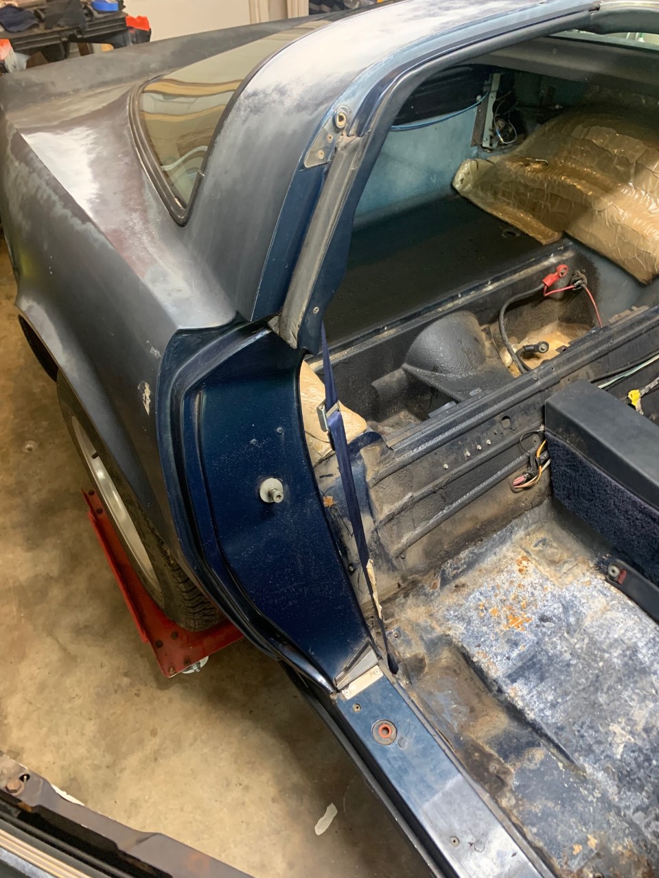

I then gutted the interior to see what we were working with. There is some surface rust but that is it. So now Alex and I are working on a budget.

well maybe "running" is a stretch. it starts, idles for a minute or three. then dies. touch the throttle, it dies. leaks a tiny bit of gas from the filter bowl even though everything is tight. BUT the up side is no knocks and 38 -40 psi (on the oem gauge) of oil pressure.
https://youtu.be/VagJStcCaLk
I got it idling longer than this but you get the idea.
Re: 1981 corvette
Have you done a compression or leak down test? The video sounds like it's missing on a cyl or two.
